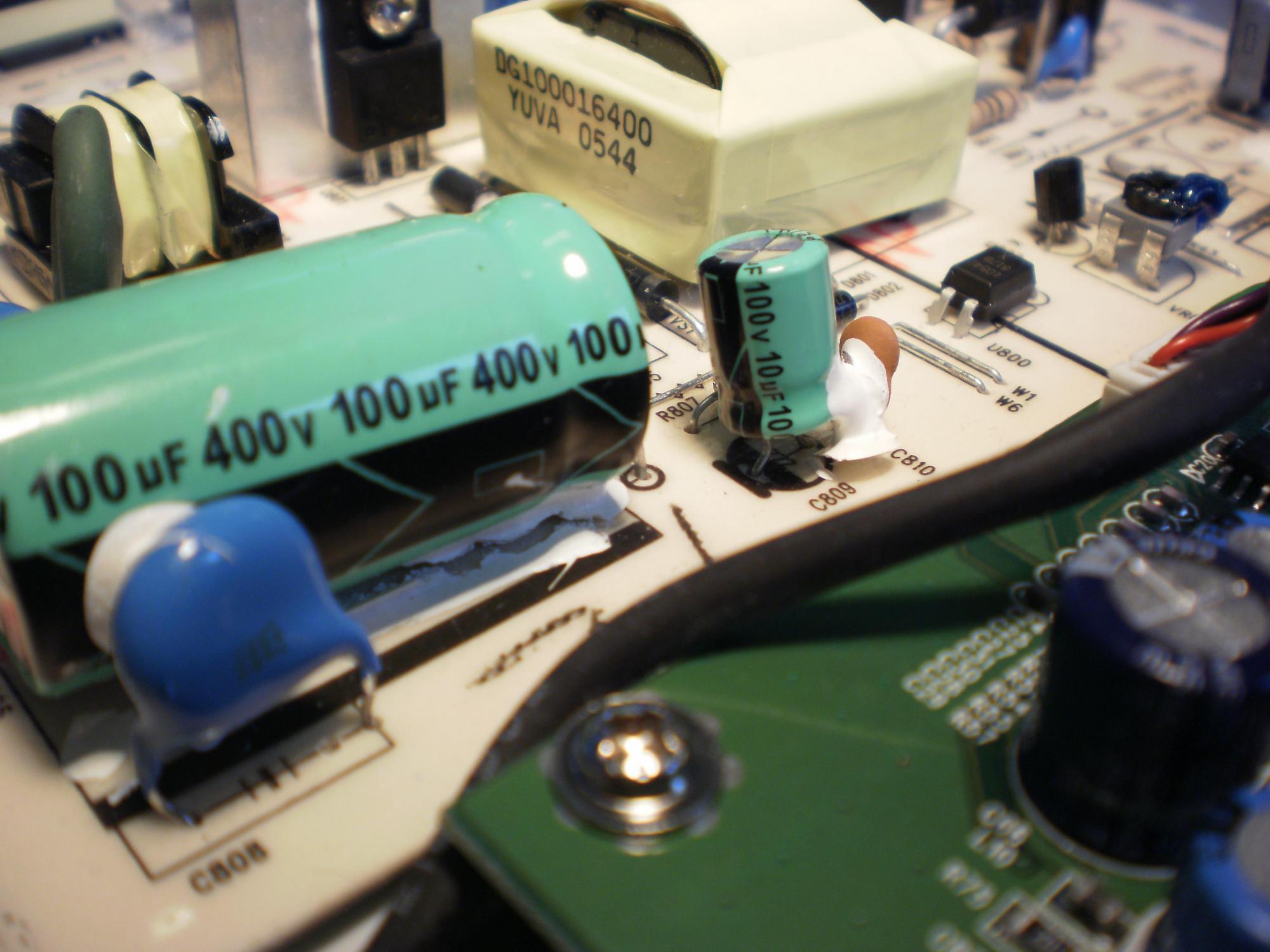

Neovo F-419 no power.
  • playman
    replied
    Re: Neovo F-419 no power.
    Originally posted by jetadm123
    I'm assuming that when you see "0" on your resistance readings, that means zero ohms? If yes, it means you have a short. Regardless, you should replace D801 because it's the wrong part.
    I'll get to that ASAP
    when I say 0 all I get on the screen is
    Code:
    "1    . "
    Like i'm not probing anything.
    Remove Q801 from the board and repeat test to verify your initial readings.
    I did the same testing as earlyer and have the same readings.
    black on pin 2 red on pin 3 gave me some 20-60 for a split second. (changes every time I check it)(made a tipo in earlyer thread, black was on pin 2 not 1)
    I tested like this,
    Black pin1 Red pin 2 and 3
    Black pin2 Red pin 3
    R800 seems a bit high, but other parts could be affecting your reading. Remove it from the board and repeat test.
    It mesures about 5 then rapidly drops to 1.1 but after few secs it then drops to 1.0
    PS.
    My DMM is a cheap one.
    when put on 200ohm setting I get 0.8 ohms when shorting pins.
    Leave a comment:
  • jetadm123
    replied
    Re: Neovo F-419 no power.
    I'm assuming that when you see "0" on your resistance readings, that means zero ohms? If yes, it means you have a short. Regardless, you should replace D801 because it's the wrong part.
    Remove Q801 from the board and repeat test to verify your initial readings.
    R800 seems a bit high, but other parts could be affecting your reading. Remove it from the board and repeat test.
    Leave a comment:
  • playman
    replied
    Re: Neovo F-419 no power.
    Originally posted by jetadm123
    C809 is the 10uf 25V startup cap, which read 0 volts when you measured across it. Correct?
    Actually it's 10uf 100V, but yes it measured 0v
    Originally posted by jetadm123
    With power off do the following:
    1) check the fusible resistor, R800, .2ohms 1W, to see if it's open.
    2) check R807, D802 and Q801 for shorts.
    R800= 1.1 @ 200ohm on DMM
    R807= 15.6 @ 200ohm on DMM
    D801= 78.1 @ 200ohm on DMM it reads 78 for a split second then 0
    D802= 17.6 @ 200ohm on DMM
    Q801= 0
    black on pin 1 red on pin 3 gave me some 70 for a split second.
    I tested like this,
    Black pin1 Red pin 2 and 3
    Black pin2 Red pin 3
    Additional info: you mentioned that you replaced D801,PS1010R, with a RGP10D. The PS1010R is rated 1000V@1A. The RGP10 is rated 200V@1A. Add checking D801 for a short to your list.
    I think it's broken, but I was so sure that I had equalent replacement part.
    Oh well, that teaches me to pay more attention.
    Leave a comment:
  • jetadm123
    replied
    Re: Neovo F-419 no power.
    Additional info: you mentioned that you replaced D801,PS1010R, with a RGP10D. The PS1010R is rated 1000V@1A. The RGP10 is rated 200V@1A. Add checking D801 for a short to your list.
    Leave a comment:
  • jetadm123
    replied
    Re: Neovo F-419 no power.
    C809 is the 10uf 25V startup cap, which read 0 volts when you measured across it. Correct?
    With power off do the following:
    1) check the fusible resistor, R800, .2ohms 1W, to see if it's open.
    2) check R807, D802 and Q801 for shorts.
    Last edited by jetadm123; 05-09-2011, 05:32 PM.
    Leave a comment:
  • playman
    replied
    Re: Neovo F-419 no power.
    Sorry, check the green one. I can't see C809 from the angle of the picture.
    No no the fault is mine, since I took the shot slightly tilted.
    Put your red probe on the positive leg of the small green cap C809 cap. Put your black probe on the negative leg of the small green cap.
    I've allready done that.
    anyway I checked the C810 and got 0 reading but for a split second I got the - sign on the DMM.
    And if I'm not mistaken, the black part of the circle on the PCB means negative, right?
    Leave a comment:
  • retiredcaps
    replied
    Re: Neovo F-419 no power.
    Originally posted by playman
    The green one is C809
    Sorry, check the green one. I can't see C809 from the angle of the picture.
    Put your red probe on the positive leg of the small green cap C809 cap. Put your black probe on the negative leg of the small green cap.
    Leave a comment:
  • playman
    replied
    Re: Neovo F-419 no power.
    Not quite correct.
    U7 is the reset controller for the processor on the signal card. If it is bad the processor will not start, and the power LED will not come on. You WILL still have the normal voltages out of the power supply.
    PlainBill
    That was exactly what I thought.
    Yay +1 for the newbie
    Leave a comment:
  • playman
    replied
    Re: Neovo F-419 no power.
    Okay, let me add more detail and try again.
    1) Put multimeter to 20V DC if manual.
    2) Disconnect all boards. We are just going to test the power board alone. Put back all screws on the power board.
    3) Put your black probe on the ground screw. Use the ground screw next to cap C848 (upper left hand corner in your picture). This will be your secondary ground.
    4) Put your red probe on each pin on connector P803.
    5) Report measurements for each pin.
    If you still get 0V DC for all the pins, then measure the DC voltage across capacitor C810 (green small one next to the largest one). Put your black probe on the negative side of the cap and red probe on the positive side.
    Report and note if the voltage is steady or fluctuating. C810 plays an important part of the startup process for the SMPS. The SMPS generates the secondary voltages that go to P803.
    I still got 0 reading from the pins.
    The green one is C809 and then brown circle is C810 ( I belive)
    anyway I checked the C810 and got 0 reading but for a split second I got the - sign on the DMM.
    Some one unknown came to me, and thought it would be funny to startle me,
    while I was testing it, so I accedentily touched the big cap, wich created some sparks, but I checked it afterwards and it gave me 321volts.
    So I hope I did not do any damage to it. having a double heartattack is not funn
    Leave a comment:
  • jetadm123
    replied
    Re: Neovo F-419 no power.
    Not quite correct.
    U7 is the reset controller for the processor on the signal card. If it is bad the processor will not start, and the power LED will not come on. You WILL still have the normal voltages out of the power supply.
    PlainBill
    Ah, thanks PlainBill for sending me on the path to enlightenment.
    Leave a comment:
  • PlainBill
    replied
    Re: Neovo F-419 no power.
    Originally posted by jetadm123
    Hopefully, you read the link I provided. If U7 has failed, it prevents the power supply from starting up, which results in zero ouput from the power supply.
    Not quite correct.
    U7 is the reset controller for the processor on the signal card. If it is bad the processor will not start, and the power LED will not come on. You WILL still have the normal voltages out of the power supply.
    PlainBill
    Leave a comment:
  • retiredcaps
    replied
    Re: Neovo F-419 no power.
    Originally posted by playman
    I might have done this wrong, but this is what I did.
    Okay, let me add more detail and try again.
    1) Put multimeter to 20V DC if manual.
    2) Disconnect all boards. We are just going to test the power board alone. Put back all screws on the power board.
    3) Put your black probe on the ground screw. Use the ground screw next to cap C848 (upper left hand corner in your picture). This will be your secondary ground.
    4) Put your red probe on each pin on connector P803.
    5) Report measurements for each pin.
    If you still get 0V DC for all the pins, then measure the DC voltage across capacitor C810 (green small one next to the largest one). Put your black probe on the negative side of the cap and red probe on the positive side.
    Report and note if the voltage is steady or fluctuating. C810 plays an important part of the startup process for the SMPS. The SMPS generates the secondary voltages that go to P803.
    Leave a comment:
  • sabre504
    replied
    Re: Neovo F-419 no power.
    U7 on pic
    Leave a comment:
  • jetadm123
    replied
    Re: Neovo F-419 no power.
    Originally posted by playman
    ah thanks for that, I'm getting blind apearently lol
    but since the PCB did not give any volts out of it, i'm going to
    wait until I can see what's going on there.
    Hopefully, you read the link I provided. If U7 has failed, it prevents the power supply from starting up, which results in zero ouput from the power supply.
    Leave a comment:
  • playman
    replied
    Re: Neovo F-419 no power.
    Originally posted by pedro
    It's east-north-east from the NE corner of U6, half-way to the connector. It's in a SOT-23 style body, only three pins on this device.
    ah thanks for that, I'm getting blind apearently lol
    but since the PCB did not give any volts out of it, i'm going to
    wait until I can see what's going on there.
    Leave a comment:
  • playman
    replied
    Re: Neovo F-419 no power.
    Okay, now let's check cold side for secondary DC voltages at connector P803.
    Put your multimeter on 20V DC (if manual). Use a ground screw for your black probe (ground). Put your red probe on each connector pin. Report DC voltage measurement for each pin.
    I might have done this wrong, but this is what I did.
    I had the PCB on the table(not connected to the screen), only electrical wire connected, put the black prope
    into the earth wire from the socket on the PCB, wich connects to the screen metal sceleton.
    Then probed the 7 wires with the red probe, and got 0 reading on all of them.
    was that a right way to do it(or one of them)?
    Update:
    I just plugged the board into the screen, with everything connected.
    and all the wires gave 0 reading.
    Last edited by playman; 05-06-2011, 04:37 AM. Reason: Updated the new findings
    Leave a comment:
  • pedro
    replied
    Re: Neovo F-419 no power.
    Originally posted by playman
    Hi jetadm123
    I was not able to find the U7 chip, I must be blind
    It's east-north-east from the NE corner of U6, half-way to the connector. It's in a SOT-23 style body, only three pins on this device.
    Leave a comment:
  • playman
    replied
    Re: Neovo F-419 no power.
    Originally posted by jetadm123
    Had a quick look at the schematic. Apparently, your monitor has a reset circuit, which if faulty, can cause the problems you describe.
    1) look at the link below, it describes a acer monitor with the same problems you have and describes the function of the reset circuit:
    https://www.badcaps.net/forum/showth...ghlight=max810
    2) the chip on your board is U7, part # MCP809-300 and is located on the logic board.
    3) please post a photo of the logic board.
    Hi jetadm123
    I was not able to find the U7 chip, I must be blind
    any way here are the fotos you asked for.
    sorry for the flash on the picture.
    Leave a comment:
  • retiredcaps
    replied
    Re: Neovo F-419 no power.
    Originally posted by playman
    I finally was able to check the cap, it mesured 320v
    Okay, now let's check cold side for secondary DC voltages at connector P803.
    Put your multimeter on 20V DC (if manual). Use a ground screw for your black probe (ground). Put your red probe on each connector pin. Report DC voltage measurement for each pin.
    Leave a comment:
  • jetadm123
    replied
    Re: Neovo F-419 no power.
    Had a quick look at the schematic. Apparently, your monitor has a reset circuit, which if faulty, can cause the problems you describe.
    1) look at the link below, it describes a acer monitor with the same problems you have and describes the function of the reset circuit:
    https://www.badcaps.net/forum/showth...ghlight=max810
    2) the chip on your board is U7, part # MCP809-300 and is located on the logic board.
    3) please post a photo of the logic board.
    Leave a comment:
  • Caly411
    burned mosfet wich has written on top "I6 GUE 8v1507"
    by Caly411
    Hi, Im having a similar problem with my Acer Nitro 5 AN517 52, took it to repair and they said that the problem was a burned mosfet wich has written on top "I6 GUE 8v1507".
    There is written PQB12 on the motherboard right next to it.
    Does anyone know if there is soemthing similar I can buy to replace it with?
    Seems impossible to find theidentical mosfet online.
    08-30-2023, 10:48 AM
  • cacko85
    Asus R520U wich type od ssd ??
    by cacko85
    Hello folks
    Laptop Asus R520U problem with instaling ssd drive, laptop come with 2.5" hdd drive, but there is slot for ssd (M.2 I think) I put SAMSUNG 500GB SSD 980 Pro M.2 PCI-E NVMe, but can't be recognized in bios or windows
    I don't have any other type of ssd to try, maybe the bus is sata3 not pci-e ??
    Any info ?? tnx...
    08-13-2021, 03:07 AM
  • Malcolma172
    Philips 42pfl6008s/12 red led comes on for a second and then goes away but 3.49v stay active
    by Malcolma172
    I was trying to repair my tv wich previously had a blinking red led 2 times and it kept going. After shorting the sdm the blinking led changed 5 slow blinks and 3 fast ones wich in the service manual meant error 53 / the fusion chip.
    After I heated the fusion chip with a hairdryer for 5 minutes it started working perfectly but after a day it stopped this time no led blinks even in sdm mode.
    After probing the psu I have 3.49v and for 1 second I have at least 2 12.3v lines active the fusion chip gets warm in that second the led turns on and then the 12v lines start losing power...
    07-23-2025, 01:20 PM
  • ladharimohamed2
    Need bios toshiba satellite pro r50-b-15j
    by ladharimohamed2
    I need bios for toshiba satellite pro r50-b-15j motherboard faebsy2
    i have tried this :
    but no power
    and i tried this
    the laptop worked but asked for a password
    i have tried many with same motherboard name wich is FAEBSY2 A5A003954010 A but the laptop didnt turn on (no lights, no fan spinning)
    i have attached my original bios wich has been corrupted after a windows update (turn on but black screen)
    if any have the bios for the exact model name will be great "toshiba satellite pro r50-b-15j"...
    04-18-2024, 07:54 AM
  • Larchemont
    HP Elitebook 840 G1 BIOS Issues
    by Larchemont
    Hello Folks,
    i have a HP Elitebook 840 G1 with a locked BIOS and i have bought a CH341a (black PCB). My problem is that the Bios Chip reads 25Q128A 13ECO and i cannot find a profile for this chip in any of the software recommended in the guide threat in this forum. The chip cannot be detected wich i dont find too surprising, but i can read the chip with random other profiles selected.
    I have found a post in this forum in wich the user stated he was able to flash this exact chip with the CH341a and the testclip, but unfortunately this user is no longer active. In...
    08-21-2022, 07:24 AM
