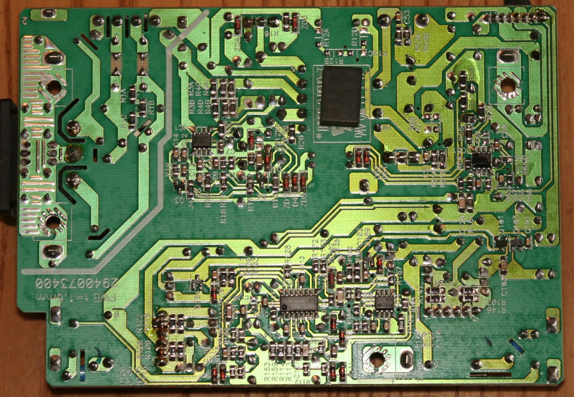

    Attaching some new photos, since my originals seem to not be working...

        This is a Royer oscillator; it's used by a number of manufacturers, most notably Benq (Dell and HP). There are several possible causes - bad solder joints on the transformer are the most likely cause but since you have soldered them we can eliminate that.
        The tuning cap - it looks like .1uF, 100V is another suspect, as is the zener diode. Don't substitute transistors - this circuit is fussy. And if one transistor is shorted always replace it's companion too.

          What would the companioin to Q110 be? Do you mean that I should replace all 3 transistors?
          The zener diode is ZD101 - any idea the value of that? I've never purchased a zener diode before, so I'm not sure what to order here.
          The box cap is a .18uf box cap. That I've ordered before, so I can get those.
          Anyone know where I can get the 1606 transistors?

            ZD101 is a location number, not a part number. It should be identical to the zener at ZD100. I don't have any idea what the part number would be.
            Q106, Q107, Q108, and Q109 are identical parts and are probably NPN transistors.. Q105 and Q110 are also identical and are usually FETs, which would explain why the 2SC1815 smoked.

              What are the part numbers stamped on Q105&Q110 on your good board?
                  They are B 1116's.
                  Anyone know where to get them?

                    That is probably a 2SB1116. That could be verified by doing a diode test on the pins of Q105.
                    Without knowing what country you are in, it is difficult to make a suggestion. It's specs (PNP, 80 volt, 1A, .75W, 120 Mhz) should be easy to match.

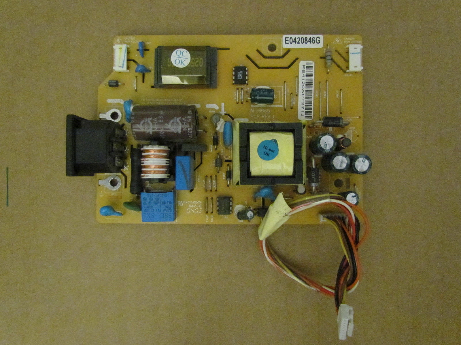

                                          hi guys, this thread got a different power board than the one i got here. Could anyone please tell me the exact part number of u101 because mine got burned that's why I'm having no power/ dead set.
                                          i know i have to post another thread but i cannot just yet because I think I'm just a newbie here and I'm guessing this is my first post/reply. So please pardon me.
                                          Anyway I'm attaching a pic I downloaded from Ebay.
                                          The 8-pin IC on the bottom is the one that i need to be identified. Thanks..
