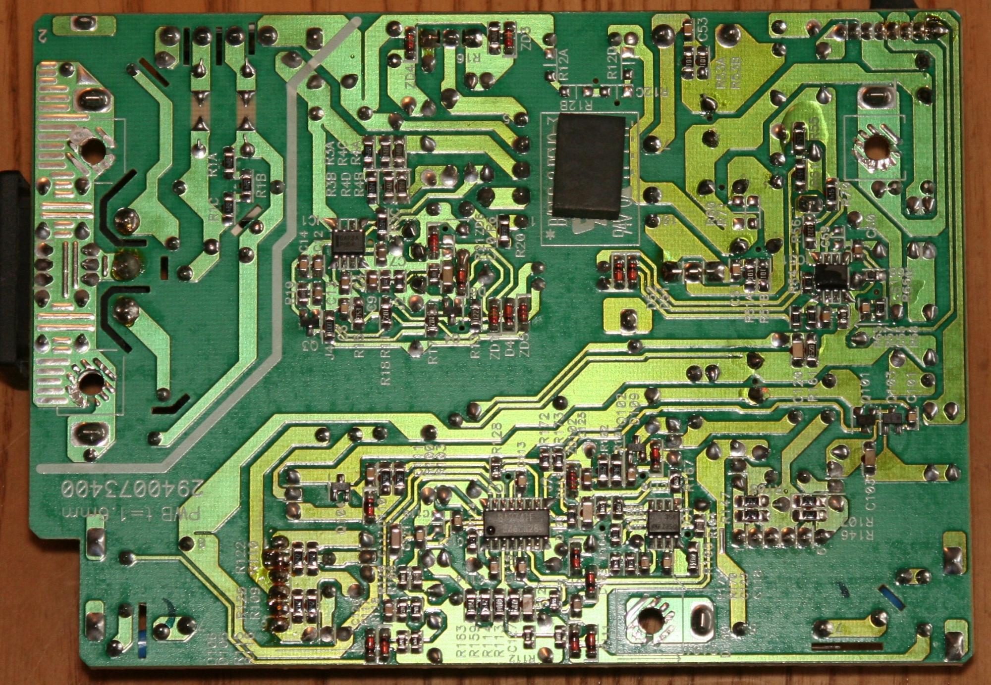

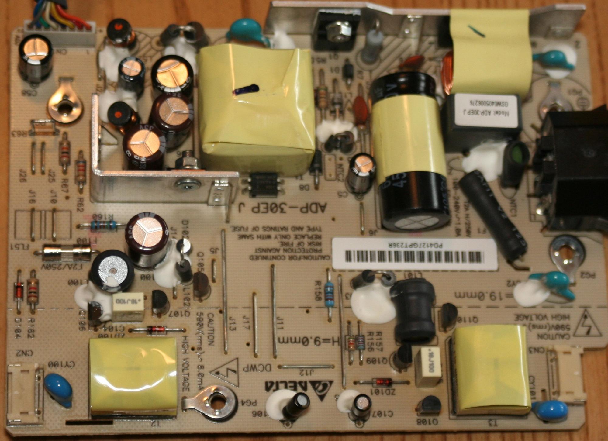

    Dell monitor as descibed, with '2 seconds to black' issue. Image is still there, CCFL's and screen tested on a sister montior with sucess, as well as the image board. The problems lies in the inverter board. I've already replaced all caps with a value of more than 10uf.
    What next? Pics attached.

      Also I don't know if it's just me,but I am unable to open up your photos.

        It looks like pins 7 and 8 from the pictures which I can open.

          Where are pins 7 and 8?

            See inverter transformers T2 and T3. Turn the board upside down and the pins 7 and 8 are marked on the solder side.

                              Okay, I've made a bit of progress here on the diagnosis. I pulled a spare CCFL from the sister monitor and found that it fired just fine in socket CN2 on my ailing inverter board, but it would not fire in socket CN3. So, I've narrowed down my issue to that half of the lighting circuit, anyway.
                              So what's next? Look at the transistors? I see 3 of them there in that half of the circuit: Q108, Q109, and Q110. I believe they're 2sd1616, based on the 'D1616 A' I see printed on them. I'll replace them if someone can point me to a suitable Digi-Key substitute.

                                      Q110 shows a CE short. The other 2 transistors do not show shorts all 6 ways.
                                      I will swap a transistor from my working board to see if that brings this inverter to life, unless one of the transistors in my stash will be a suitable replacement? I have some 2SA1015's or some C1815's - would either of those work?
                                      -STG

                                        I pulled Q110, and immediately I knew why it had a CE short - the transistor was smoked pretty good. It was tough to see since the side that blew out was facing towards the inductor L101. I replaced it with a 2sc1815 I had in my spare parts bin and test fired the monitor.
                                        *poof*
                                        Q1110 smoked again.
                                        So, something else is wrong. Taking a close look, it appears that pins 3 and 4 on transformer T3 (same socket that wont light) have pins with solder that is dangerously close together. If those pins were bridged, could that be causing my problem? I see both pins share the same pad on the printed side of the PCB, so I'm inclined to say that it doesn't matter that they're bridged. Besides, I used my meter to test the same 2 pins on the other transformer (T2) and those pins show continuity. In fact, all four pins 2,3,4 and 5 all show continuity.
                                        What's causing the transistor at Q110 to burn up?
