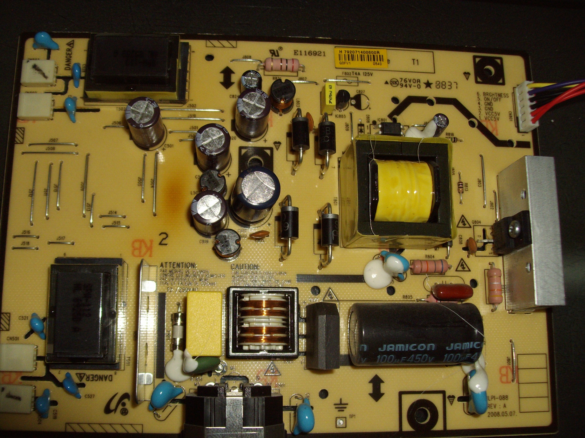

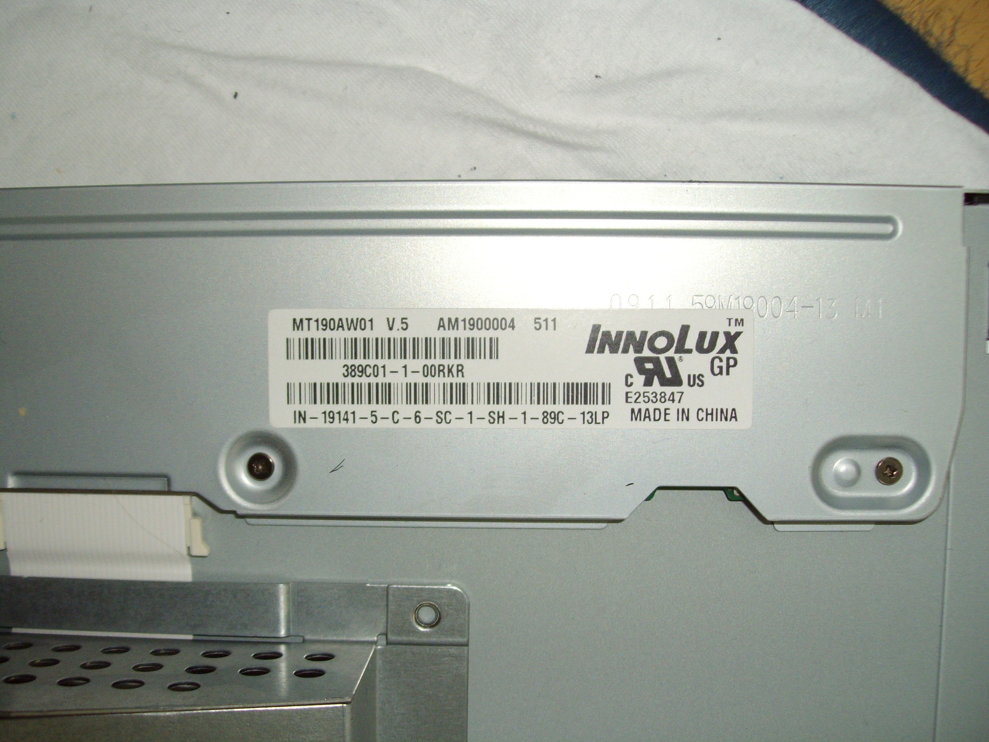

    Hello, got this Display from a Friend.

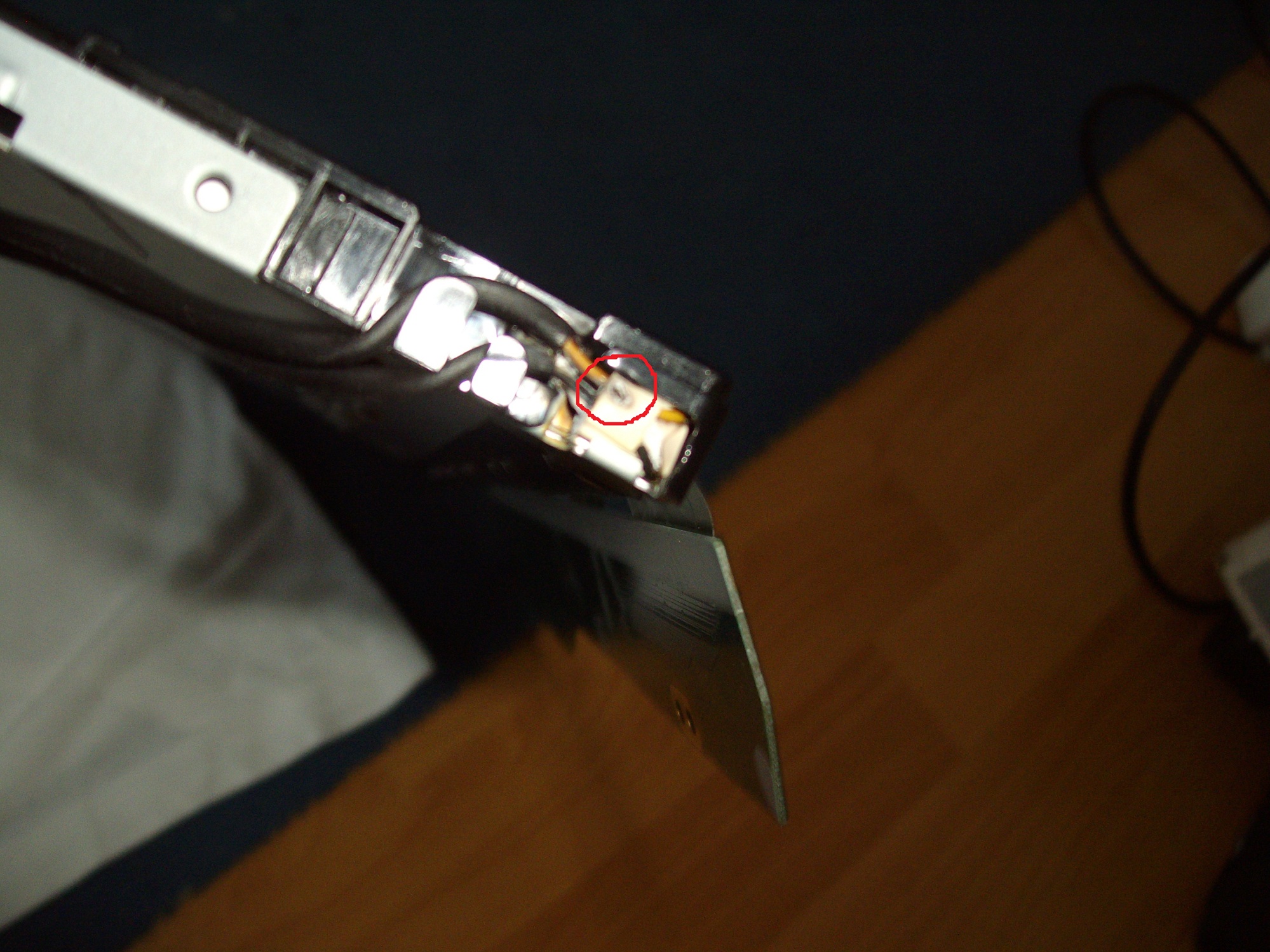

    The problem is, that the Backlight shuts down after 2-5 seconds and even in this 2 seconds it is poorly lighted. I can see the picture in background.

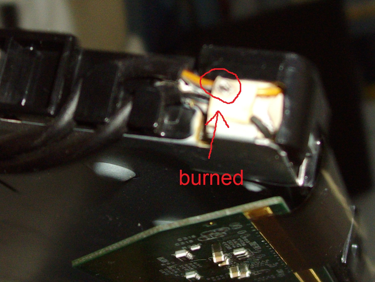

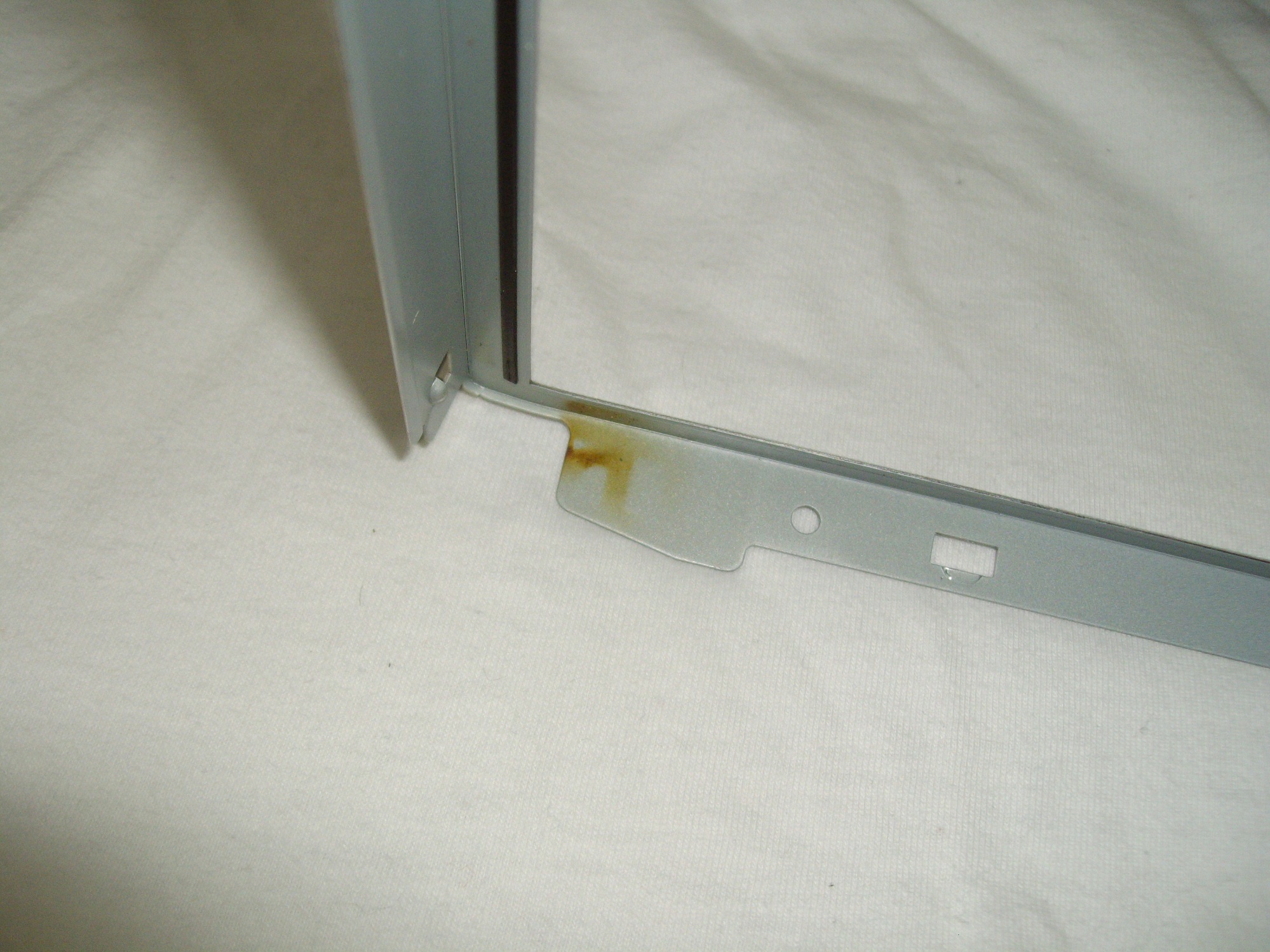

    I managed to open the screen and took a closer look at the power board. One cap was a bit strange, so i replaced it. Later i took a closer look at the panel and found a burned connector. It was so hot that the metal frame got a bit burned color. I think that the backlights are dead, so i would need a few tips how to change the ccfls and which one i should order...

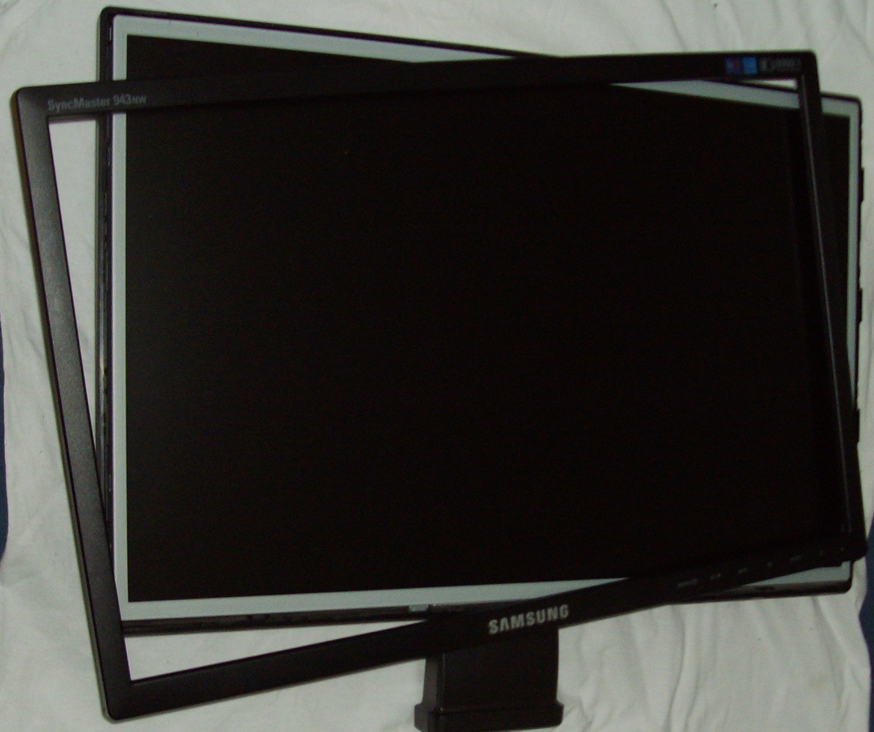

      thanks dude, but my problem is, that i dont know how to get to the lamps.
      I dont want to damage the screen. So perhabs anyone had this screen and could post a picture or two.

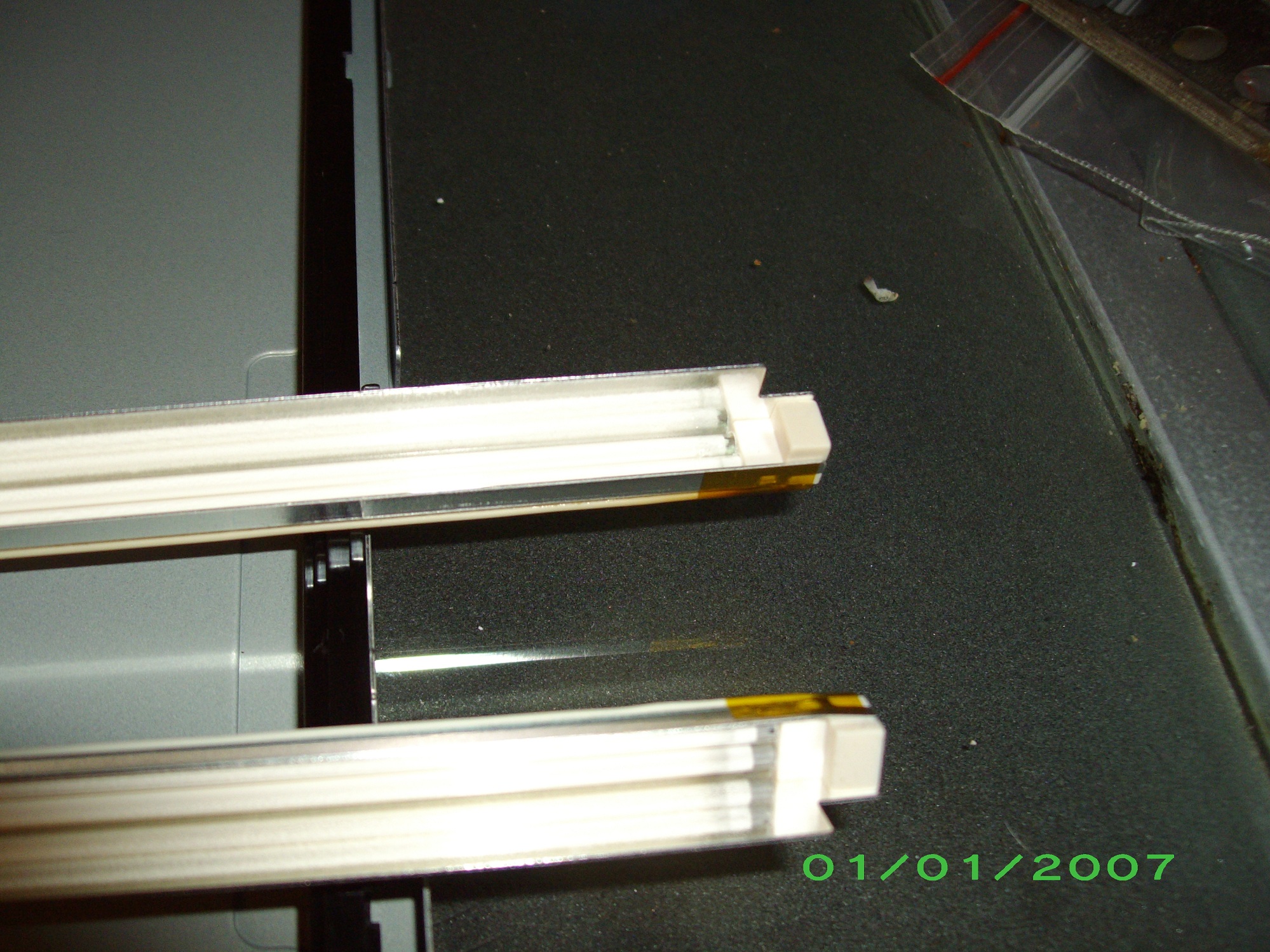

        I am sure there pictures or video out there some ware. But it's really self explanatory.
        There is a sturdy metal frame around the lcd, The thin LDC panel is next. There is a black plastic frame that keeps all the diffusers in place. There is a very thick piece of plastic in the metal framework that the CCFL channels slide over. Just go slow and don't force anything, keep everything in order as you disassemble. I think dust and stray hairs are going to be your biggest problem.
        There are some panels that the CCFL channels simply slide out.
        If you could find a LCD with a damaged or broken panel it would give you an idea what you need to do.
        Most of the newer LCD are all alike And you are going to be surprised how easy it is

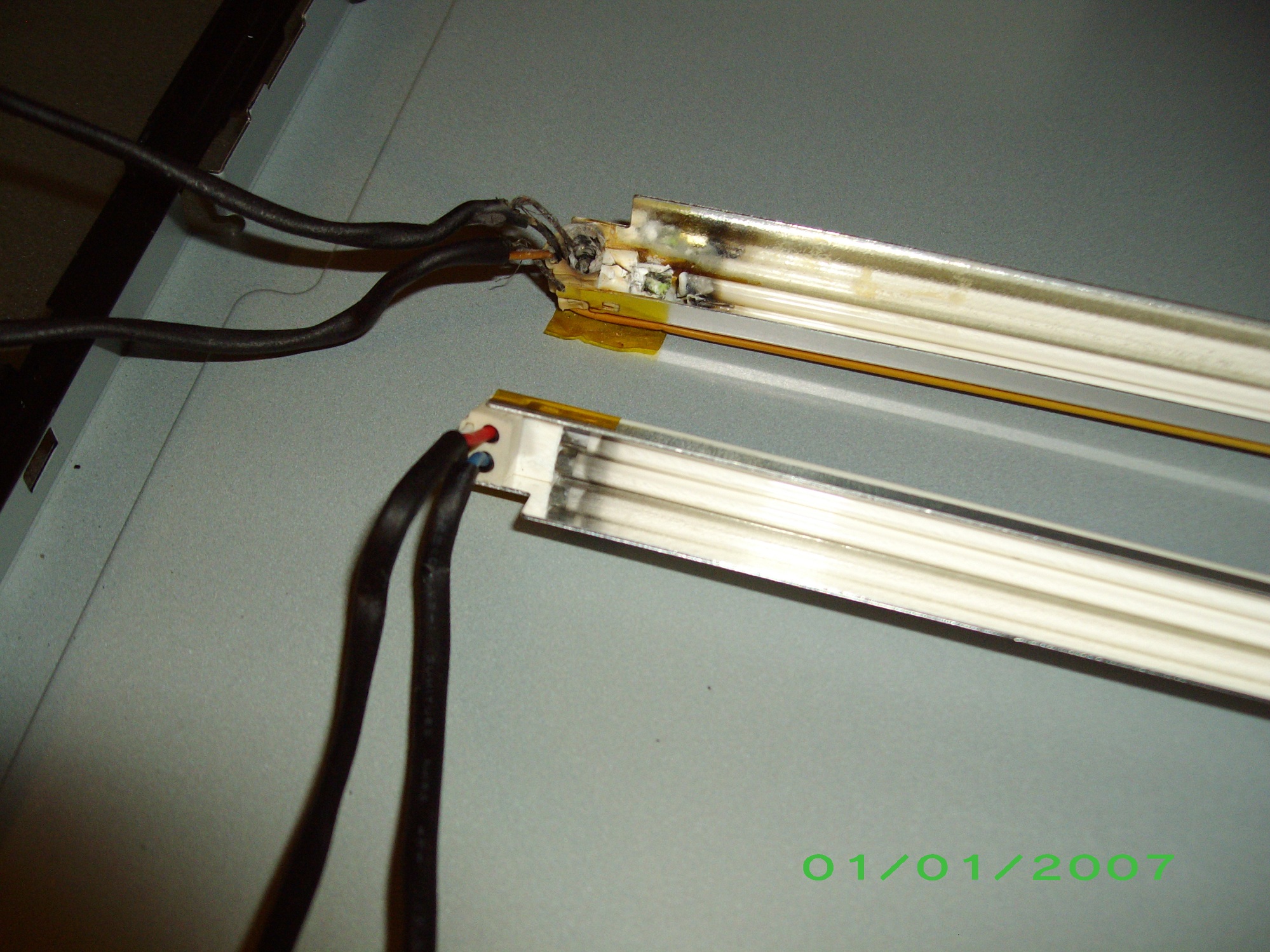

                Ok, i got it
                Do i need now 2 or just 1 replacement ccfl? Or should i change all 4?
                  Re: Burned Backlight - Samsung 943NW
                  That doesn’t look good, Dose the other CCFL assembly look the same?
                  Whatever I do, I consider it a success, if in the end I am breathing, seeing, feeling and hearing!
                    no, the other 2 are looking fine and working. As i can tell by the 2second lighting.
                      I would say you could get by replacing 2 CCFLs.
                      You could be sure if you had another panel by plugging in 2 CCFLs from the other panel, and see if the lamps stay on.
                      I would also suggest ordering some new silicone end caps, some members have used RTV silicone I find that rather messy and then I have to wait for it to set up.
                      Edit
                      I would say for sure test with 2 other good CCFLs to make sure the others are OK

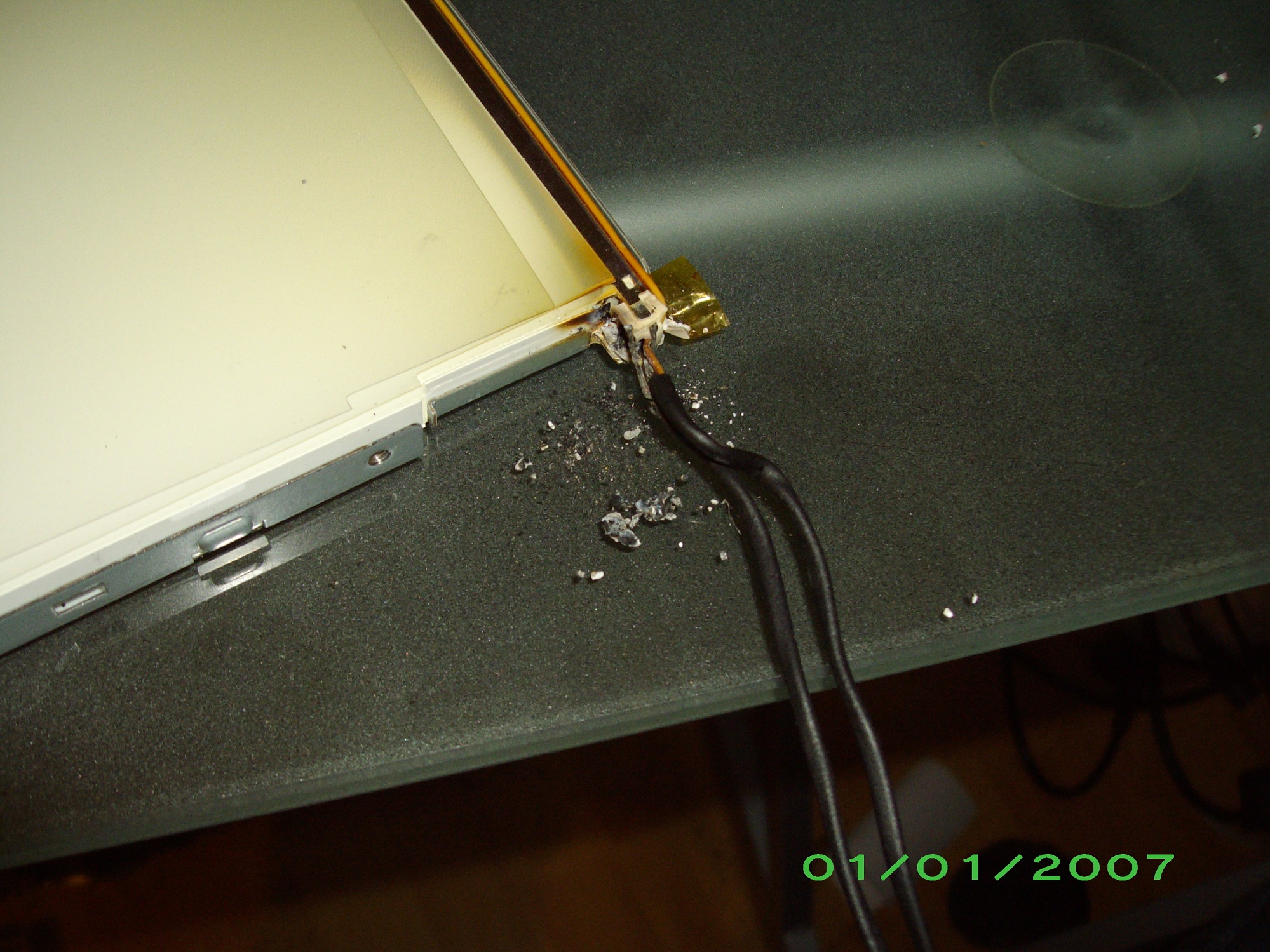

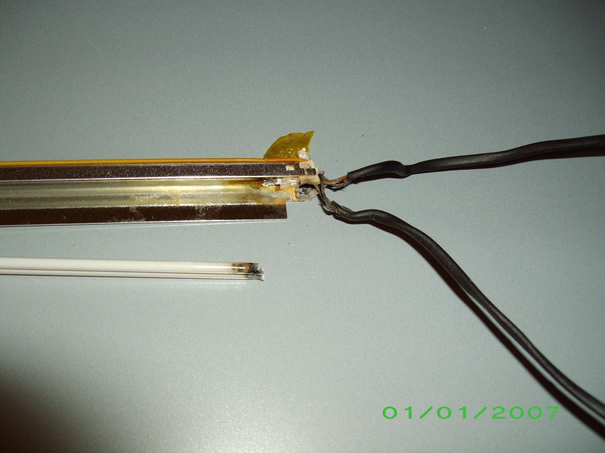

                                  I got one last problem, where i can buy these ccfl rubber things? 2 of 4 are burned in the panel... (see pics above)
                                      All 4, i looked today in the daylight and saw that the other 2 are a bit black at the ends, so to hell with them. I dont want to have the same work in 2weeks, just because i want save a few bucks now.
                                      I think the problem with the universal ones is, that they dont fit. I need a double rubber and i didnt saw any on the internet.
                                        As long as the diameter is the same you can make them work,I have used them.
                                        Still Email them and see if they have the double ones.i would think they would.
