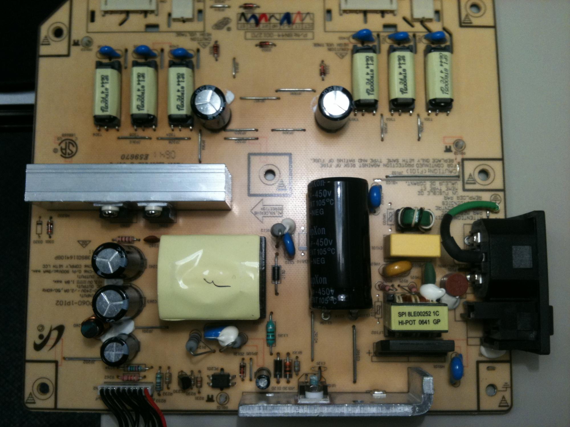

    Hi All.
    Great forum!!! I thought you had help me resolve my problem however after changing the caps im still no further forward.
    The story is:
    I have a Syncmaster 205 BW. For some time is been sat around due to it not working. The blue power light comes on but no picture. No flickering or anything just total bleak darkness
    So i though i'd see if i could fix it. Took the back of and sure enough some of the caps were swollen. So today i've replaced 5 of them. The 4 1000uf ones and the "other" one. Leaving the big hitter one and the very small one alone.
    After putting it all back together i have exactly the same problem. No change what so ever.
    So....
    Could i have done something wrong? ie cooked the Caps with the iron. It's quite a nasty one and i'm by no means a pro.
    Or is there anything else it could be and what can i do to test it?
    Thanks in advance
    Matt.

        Okay, this is how it goes....we need to see good focused photos of the top and bottom of the entire power supply board. Also, a photo of the logic board would be good. Multiple power supplies from different manufacturers were used on this monitor and trying to second guess what you have without photos is painful. By now, you've probably figured out that members telling you to check something without really pointing out where that "something" is located, just adds to the confusion and wastes everyone's time. Plain and simple, we need to see what you're seeing in order to help.

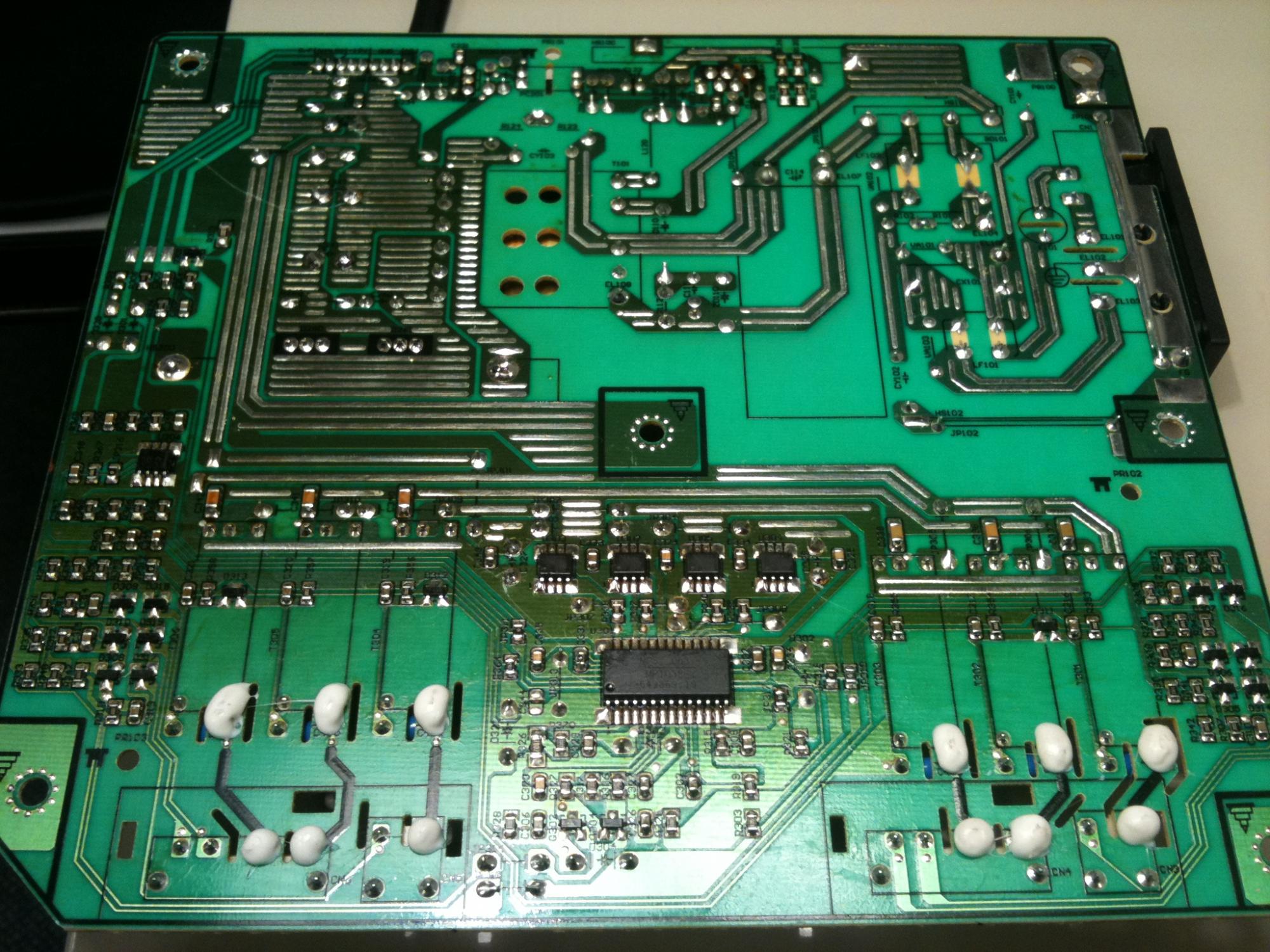

          Re: Samsung syncmaster 205bw
          [/ATTACH][/ATTACH]
          Hows that??
          Caps changed are the 3 on the left and the two top center.
          Is the fuse the round red thing just behind the power switch and socket?
          • jetadm123
            • 2169
            1) What brand and series caps did you use as replacements? Ideally, you should also have replaced the small cap, since it is part of the startup circuit.
            2) You say you used 1000uf caps as replacements. Was that the value of the original caps also 1000uf?
            3) With the monitor connected to a running computer, if you shine a flashlight against the dark screen can you see a faint image of the desktop?
            4) There are two devices mounted on the heatsink on the left side. These output the 5V for the logic board and LCD panel and 12V-14V for the inverter section. With your meter set to DC volts, measure the middle leg of each device and report voltage readings.
            5) Yes, F101 is the main fuse, but it's probably ok, since you're getting the power light.

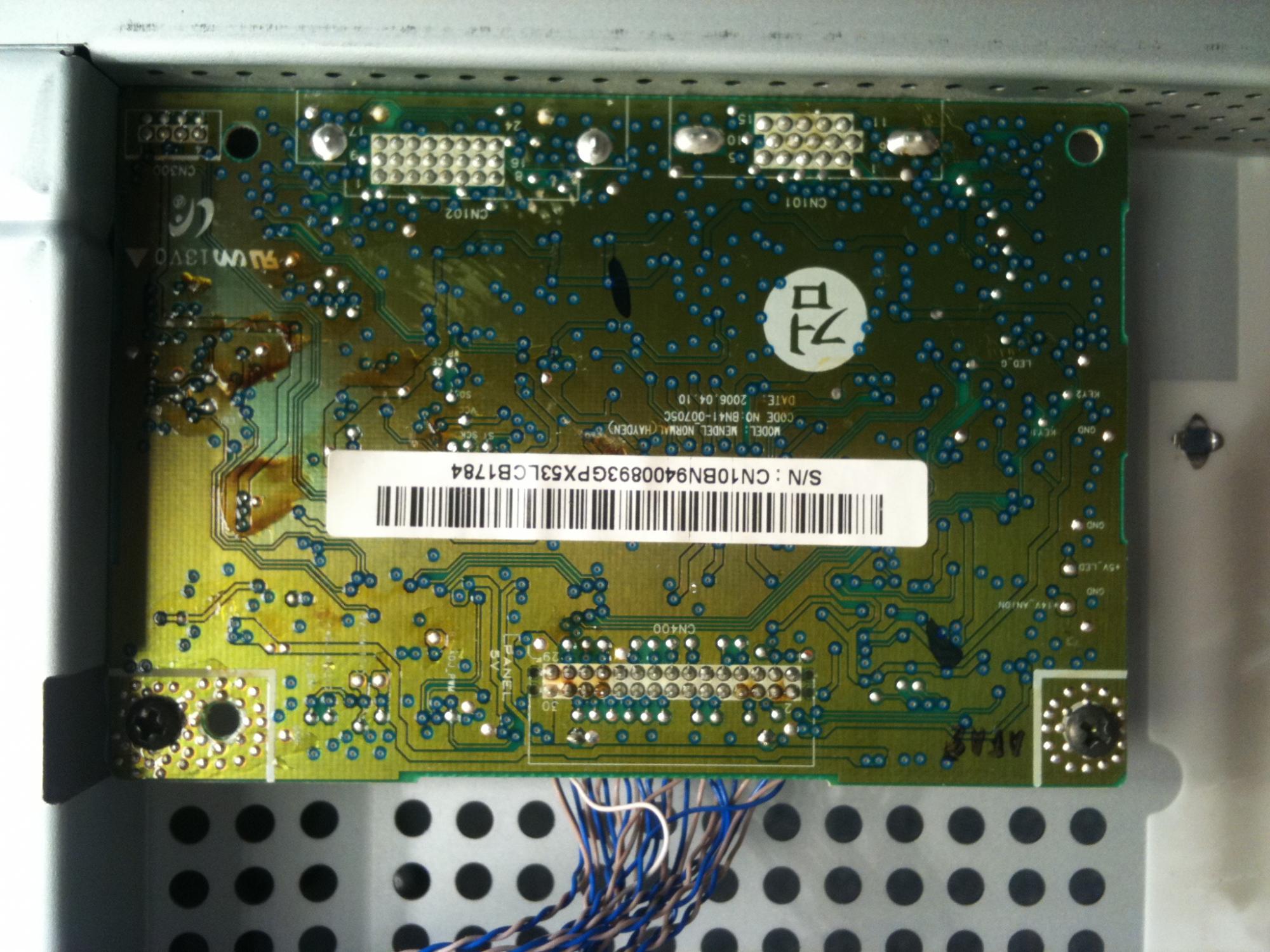

                                        Hello again, thanks for your tips! I tried pressing the main processor and other elements of the main board but nothing changes the output. I also checked and shaked the LVDS cable (video cable to the panel) with no success.
                                        And i would assume a defect with the LVDS cable or the panel itself couldn't explain the failing LCD buttons.
                                        Here some pics of my boards:
                                        Hope they are detailed enough?
