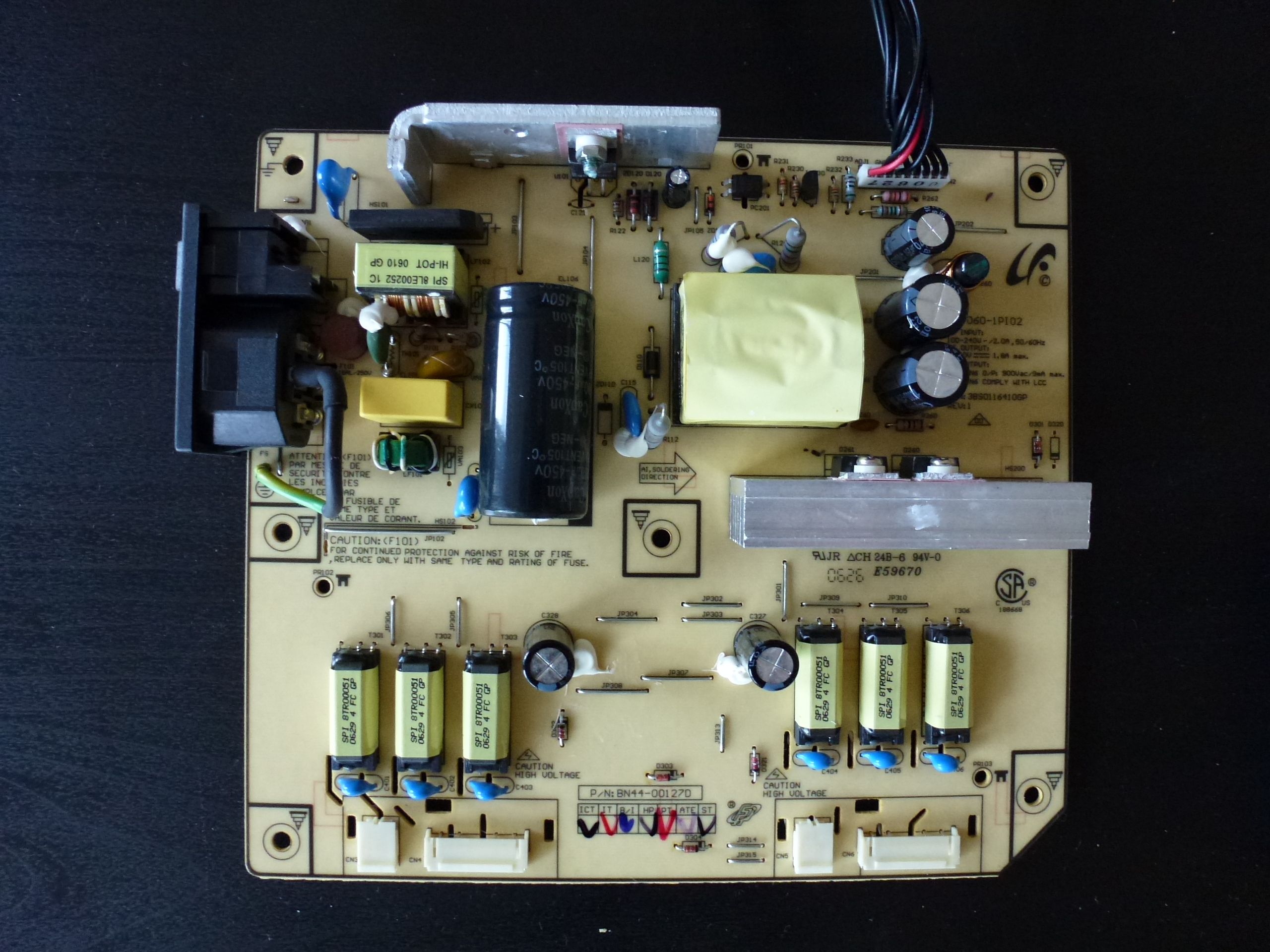

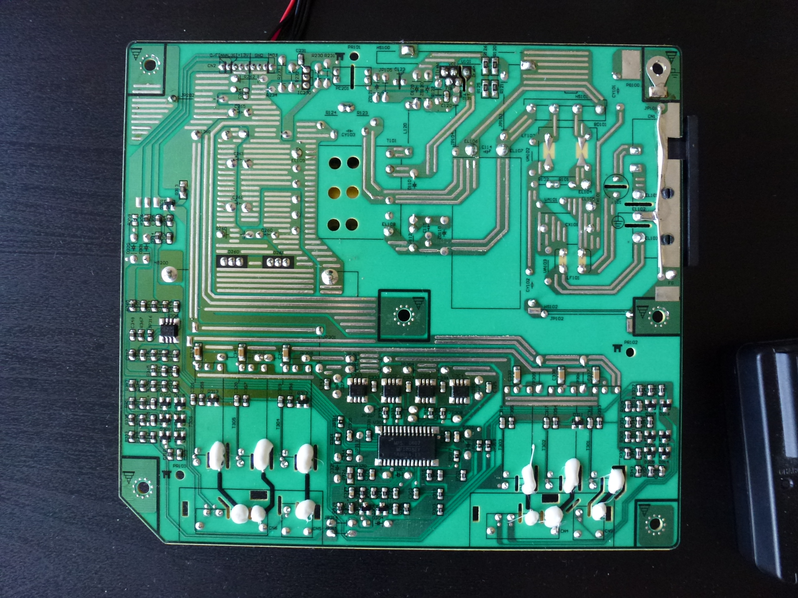

        So I'm having the same troubles, solid blue on the power light, no display or response to buttons. My computer does recognize it as a display when it's plugged in. I haven't switched out the capacitors, but I'm not seeing any bulging, and the earlier posts that say they switched and saw no change worry me. I've attached the pictures, any thoughts on a move forward is mighty appreciated. This is my first shot at fixing a monitor, hoping to get it working...

          Can you see image with flashlight?

                  If you still cannot see anything than possibly the signal board is bad as long as not only the backlight does not work but also there is no image at all.

                    Check that the PSU is supplying all the rails it should be, and they are correct. Check any regulators on the logic board and make sure they are working too
