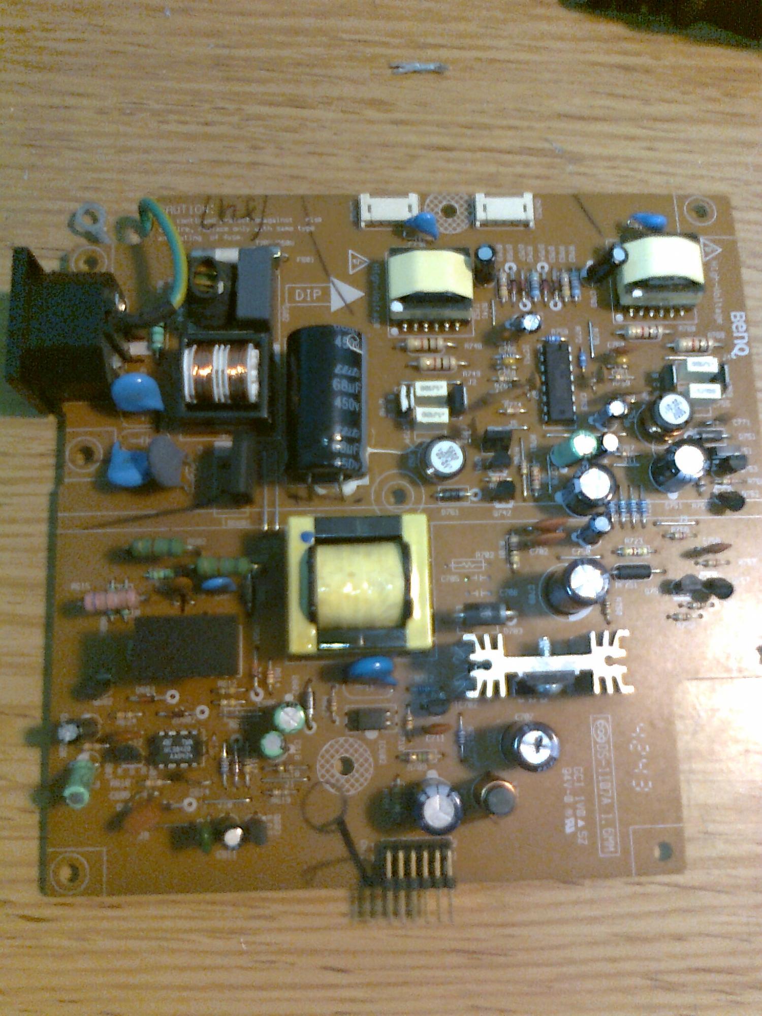

    Hi every one.
    Was looking for a solution to fix my monitor, and found this website. Maybe some one can help me pls?
    I have a Benq FP531 15" TFT Monitor that is faulty. The problem with the monitor is that when swiched on, it will only display a pink picture and some horizontal lines.
    Could this be faulty caps? or transistors pls?
    Thanks!

    The pink picture could indicate bad CCFLs. Standard first step - open it up and attach pictures.
        PlainBill
        ok. will take pictures later today and post them.

            Re: Benq FP531 - Pink Screen
            Hello
            attached are the pics of the MB and Picture.
            The pink picture will go after 2 seconds, then a black screen will follow. after this, the green LED will change to orange (no input)
            There are also some horizontal lines in the pink picture.
            Any replies will be greatly appreciated.

              vertical lines and pink? sounds like it might be a bad panel
