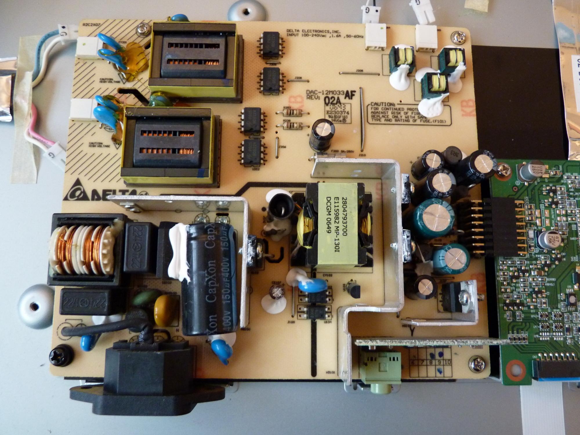

    I have received an Acer AL2017 that has no power whatsoever. The power button does nothing and no green or amber light comes on. Apparently the monitor was on and working, the screen flickered and then it was dead.
    The power board and caps look good to me, nothing blown or bulging.
    Here is a picture of the board
    Can someone make any recommendations on where to start?

    Do the basics first: with power off and monitor unplugged, set your meter to resistance, test the round black fuse directly behind the main power connector. Fuse should read no more than 0-2 ohms. If this fuse is ok, then with power on, measure the voltage across the 150uf,400V cap. If you're in the USA the voltage should be around 165 VDC.

      See these two threads here:
      https://www.badcaps.net/forum/showthread.php?t=7803
      https://www.badcaps.net/forum/showthread.php?t=12014
      In the second thread, I had the same problem with nothing happening when turning the screen on, and the guy I sold it to fixed it by replacing the small starter capacitor near the main primary capacitor.
      I still have a list of all the capacitors I used to repairt it, if you want I can give you the relevant part numbers for Digikey.

        Hmmm...... after about 30 minutes I figured out how to test the round black fuse. It measured .012 ohms.
        Can't say I'm anywhere comfortable in testing with live power, again a noob with a multimeter. However, with no power that big cap 150uf, 400v did test out with 166 ohms. Not sure if that helps or not.
        There is a glass fuse around the middle of the board(F200) and it is not blown.

            The fuse looks good, but measuring the resistance across the large cap is of little use. Eventually, you'll probably be asked to make some voltage measurements. Even if you are asked to measure a low voltage, high voltage will be present at all times. Seriously, this is not the type of board to learn electronics on, especially if you're not willing to work with high voltage.

                        The absence of the green power LED doesn't necessarily mean it is a power board problem. The logic board is what controls the power LED.
                        To narrow down which is at fault, you will have to make a DC voltage measurement at the connector between the power and logic board. This is usually low DC voltage like 19V DC or less. The logic board voltages are usually 5V DC or less.
