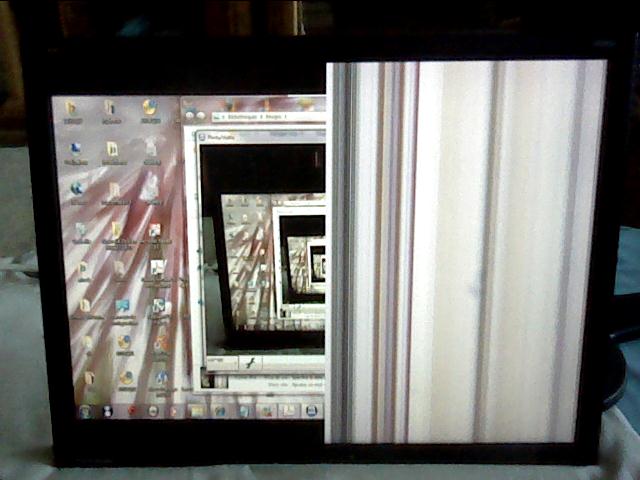

    My viewsonic vp201b screen starts well with good displaying and after 10mn ( when it temperature becomes rises ) 2/3 of the screen fluickers and goes blank or black ... i've posted an image of the screen.

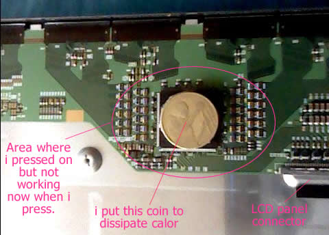

    But i've opened it and reached to the LG Philips LCD IC and when i pressed it whith my finger ... it stops the troublshooting and screen displays correctly ... i don't understand !

    What exactly are you pressing on when it works? A photo would help too.
    It soulds like either a bad solder joint or a dirty connector.

      this is the photo like you ask me ... now pressure has no effect ... i've cleaned the LCD connector and well plug it and the screen have worked correctly around 30 mn (most time of correct working) ... and the troublshouting reappears ... the components are too small to verify solder jonctions ... an idea ? please share with me.

        Hmm the chip you pressed on is pretty close to the connectors that connect to the panel, so that makes it a bit tough. Have you tried gently pressing on the black connections at the very top of your photo?
