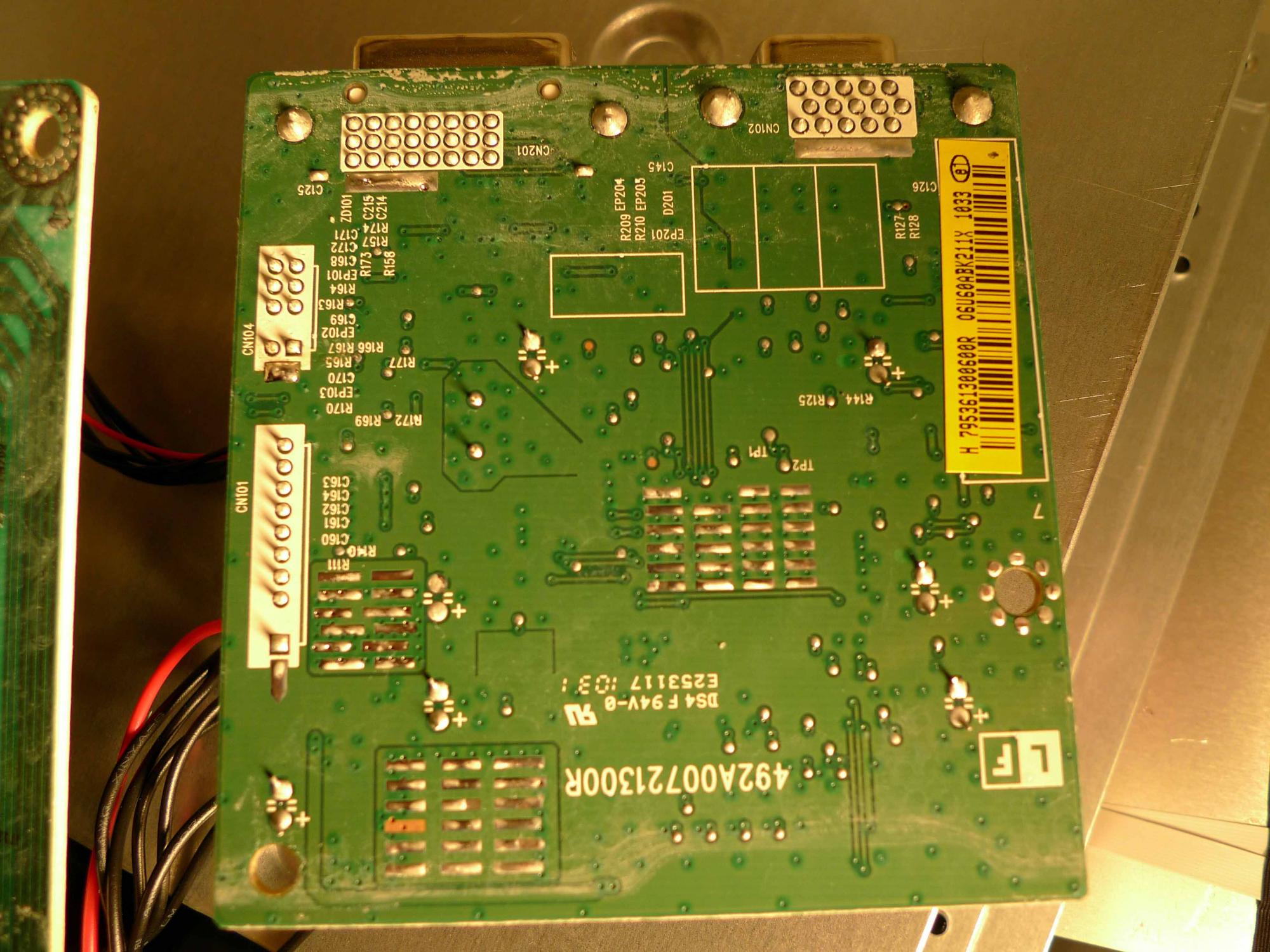

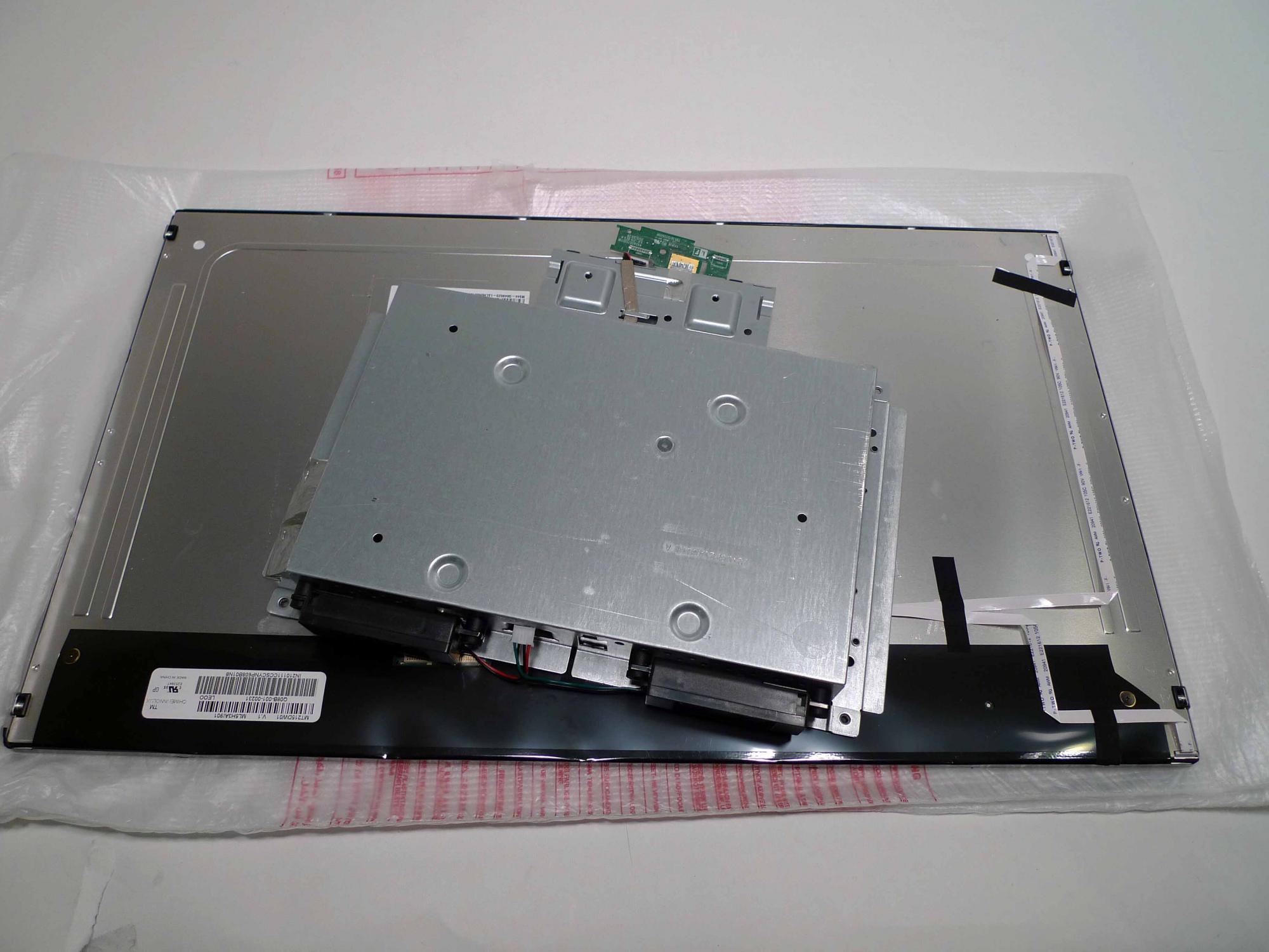

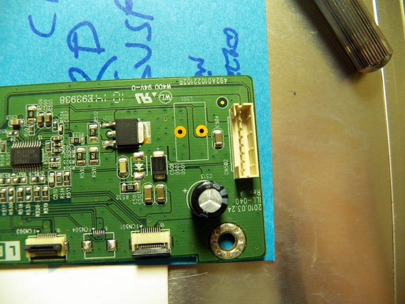

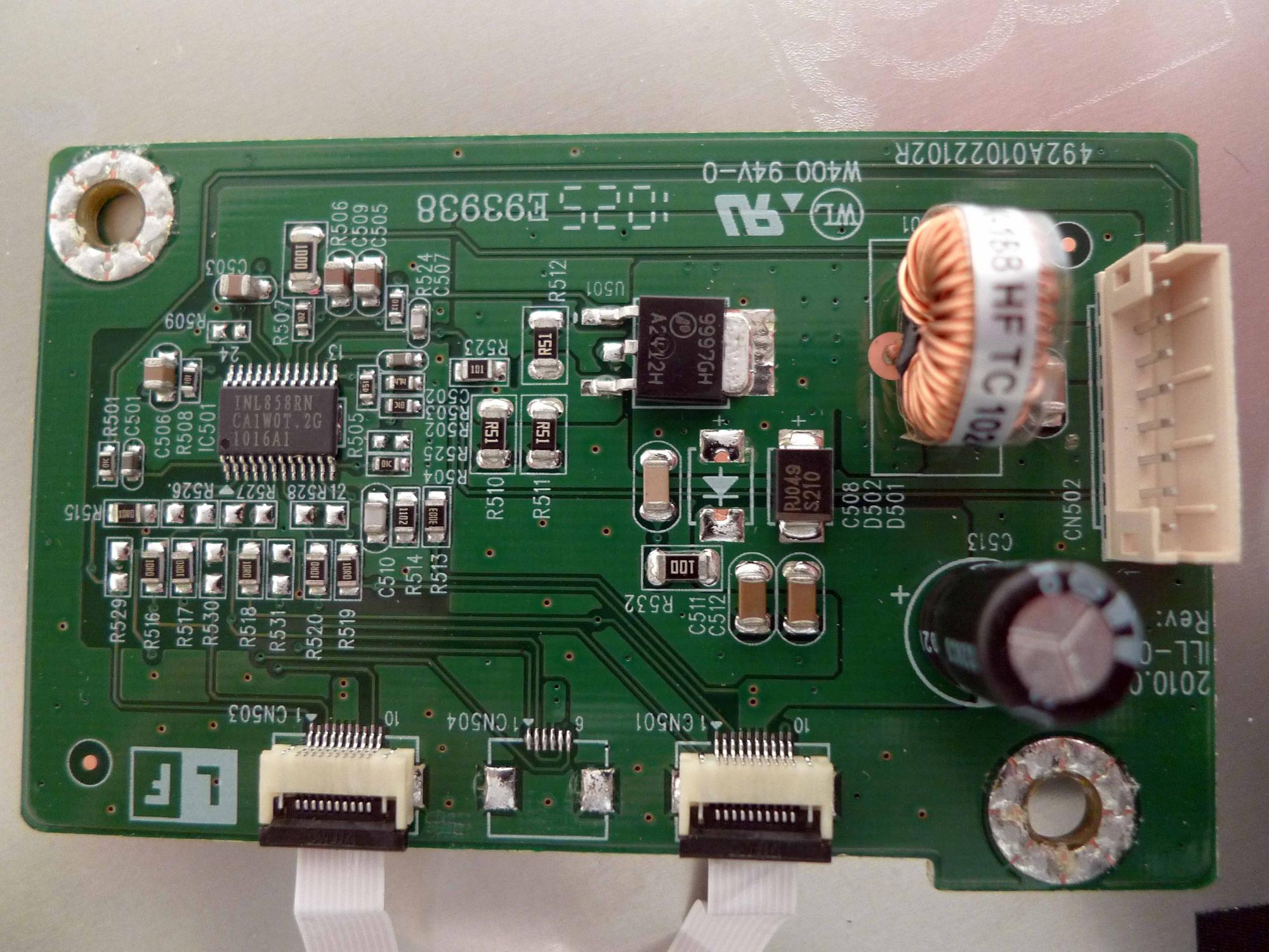

    First LED repair which will be quite exciting yet nervous cause this model is only 6 months old and I did a few basic google searches and so far no real information on repairs. Taking this thing apart was a real treat cause it is alot thinner than traditional monitors and has 3 thin ribbon cables running to the panel. Not to mention there is a 3rd board in the little chassis.
    Symptom: Plug in, now power, no light, no nothing.
    So far for visual inspection, no blow caps or cold soldering or board burn marks.
    Even though I know what I should check, I'd like to take a systematic approach to repairing this monitor to get practice rather than jumping to the obvious. So, if anyone has a list of 'to-dos' that would be greatly much appreciated.
    (Sorry for the bad pictures, didn't want to set up my normal lighting tonight to take 6-8 pictures. BTW if you click on the pictures below, it will open a window within this one, click on it again and it will open the picture in the new tab, and you can click on it again to get a larger picture)

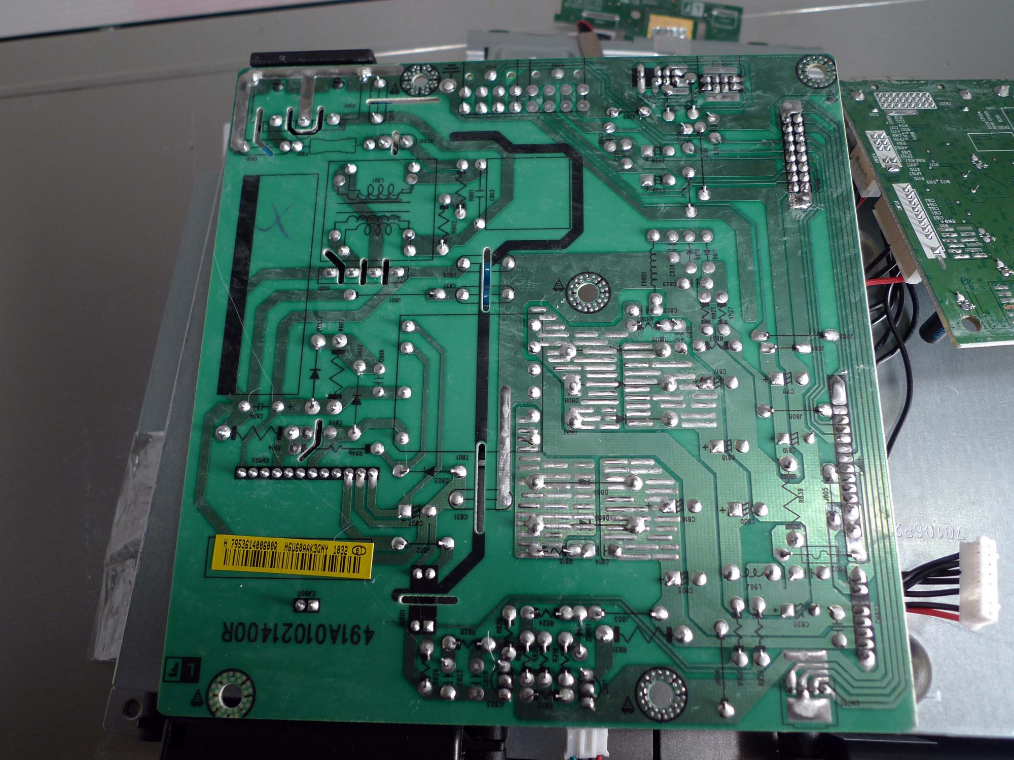

    Check for AC mains x 1.414 = roughly 165V DC voltage across the large capacitor (C804). If present, check for secondary voltages to the logic board. If not present, check for blown fuse or shorted bridge rectifier.

        For a 'totally dead' problem I usually check the output of the power supply first. If there is no output, I go check across the large cap. I prefer to keep the probes away from them whenever possible.
            PlainBill's method is safer. I now use aligator clips leads when possible for measuring the main filter capacitor.

              That mains cap would be a pain in the ass to find a replacement for. Looks like some custom made job.
              What is its rating?
