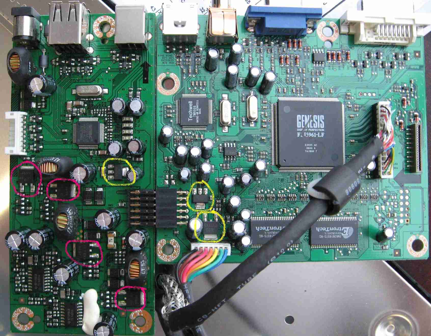

    No you don't have to unsolder anything. Measure everything as is first. If the readings are suspicious, then unsolder one leg.
    Yes, all those circled are diodes. To test a diode in circuit,
    a) put your multimeter in diode test mode
    b) put your black lead on one side and the red lead on the other - record reading
    c) reverse the leads - recording reading
    A good diode should read 0.3V to 0.7V in one direction and 0L in the other. If you get a reading in both directions, you will have to desolder one leg and retest to verify.
    Report all your measurements.

      Re: Dell 2007FPb No Power, Power and 1 icon (VGA) blinking
      OK, here are some results about question 3.
      I used 2 multimeters: my personal Mastercraft 52-0060-2 (cheap one, from Canadian Tire for 20$ bundled) and the office one Meterman 37XR.
      Mastercraft does not show eng units during diode test and the scale is weird. Anyway, here are the results:
      Code:
      Diode | Meterman read1 | Meterman read2 | Mastecraft read1 | Mastercraft read2
      FD1/2 |   0.145V  |   1.329V  |    122    |   Overrange
      FD3/4 |   0.143V  |   1.256V  |    120    |   Overrange
      FD5/6 |   0.142V  |   1.543V  |    119    |   Overrange
      FD7/8 |   0.141V  |   0.737V*  |    122    |   1085*
      * means that with red lead to cathode it shows 1085, than I removed one lead and put it back and the next reading is 1020. Remove a lead and put it back - it shows 780..800. That's weird.
      4. 4 transistors J598 are good, no shorts between 1-2-3.
      6. 5 fuses on USB board are good (F1-F4, F19).
      Where are voltage regulators on 4. and 5.?
      Any ideas? Also, why two different meters shows different numbers?
      I will post next readings soon.
        4. If J033 is voltage regulator then it's OK, no short.
        5. If J023 and J032 are voltage regulators then they are good, no shorts.
            The voltage regulators (in yellow) will have to be tested to see if they output the correct voltage. Even though they are not shorted (which is good), they need to output the correct voltage.
            With power on and lcd plugged in, use a ground screw for your black proble. Put your multimeter on 20V DC. Then put your red probe on each pin of the voltage regulator. Report all voltages.
              For diode testing, some multimeters use OL or "1" to indicate out of range. As long as the diode doesn't show the same reading in both directions, it is likely to be good.
              On this board, the diodes could be in "parallel" so the multimeter diode test threshold may not be enough to trigger the "0L" on the Meterman.
              I had a Meterman 15XP, but I gave it away to a relative for business use so I'm familiar with the Meterman brand. I have used an autoranging Canadian Tire multimeter.

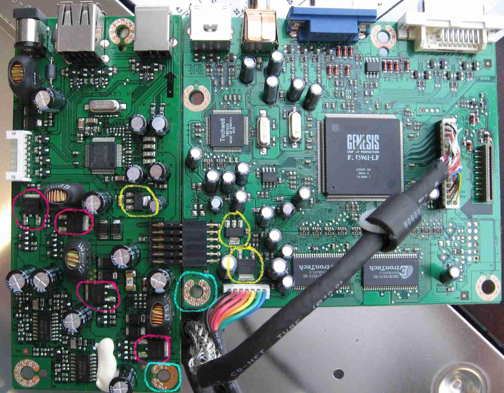

                Do you mean ground screw on the metal base of the monitor (kind of AC ground, yellow-green wire) or ground of each voltage regulator?
                  Example of ground screw on each board circled in light blue.
                    I can see these screws. Should they be connected to the monitor metal base which is connected to yellow-green ground wire? In this case I cannot reach the pins of the regulators.

                      OK, here are the results:
                      Code:
                      Regulator |  G  |  O  |  I  |
                      J023   |  0V  | 1.79V |  3.32V |
                      J032   |  0V  | 2.49V |  3.32V |
                      J033   |  0V  | Unstable| Unstable|
                      Unstable means the voltage changes from 1V to 3.5V all the time.
                      J033 is the one on the USB board.
                        #31
                        J023 and J032 look correct. 1.8V and 2.5V DC are "normal" output voltages for a voltage regulator (3.3V DC is another popular one). There is something wrong with voltage coming into J033. It should be a steady reading.

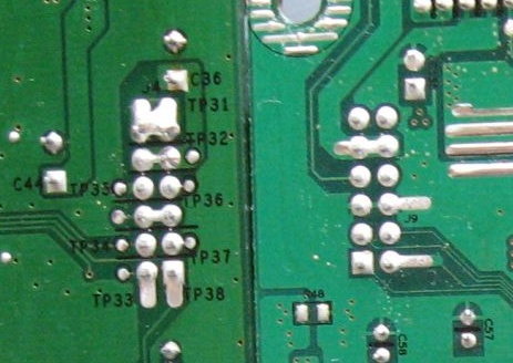

                        There is a 12 pin U shaped connector that connects the logic and USB board.
                        Number them 1-12 on the USB board anyway you like. VERY CAREFULLY, measure each pin and report the voltages. Put your multimeter on 20V DC. Do not let the red probe slip as you may cause a short. Put the black on a ground screw again.
                            12 U shape contacts to Ground:
                            Code:
                            Contact Pair    |  Voltage
                            TP31        |  18.82V
                            TP32        |  -0.01V
                            TP33...TP36     |  3.32V...0.00V
                            NoName (Ground)   |  0.00V
                            TP34...TP37     |  0.03V...1.54V
                            TP33...TP38(Ground) |  0.03V...-0.01V
                            Any ideas? What is the next step?
                            Thanks.
                              Those voltages look okay on the U connector.
                              I suspect J033 is bad. The possibilities are
                              1) J033 itself is bad.
                              2) The components (possibly capacitors) feeding the voltage to J033 are bad.
                              Question. What is the full part number for the J033 chip? I know it is a voltage regulator, but I don't know what the output should be to find a replacement.
