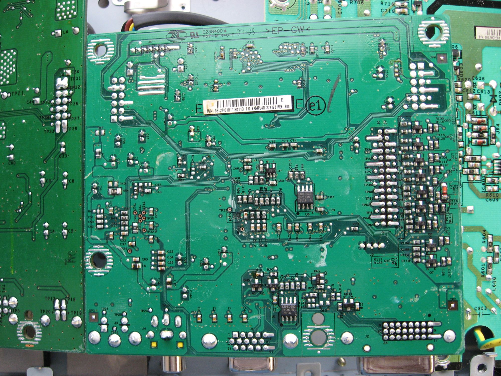

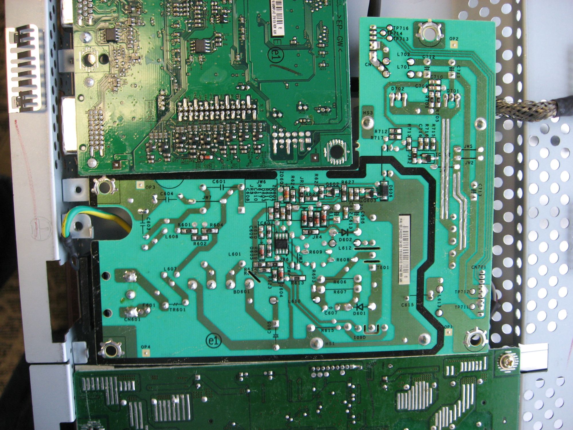

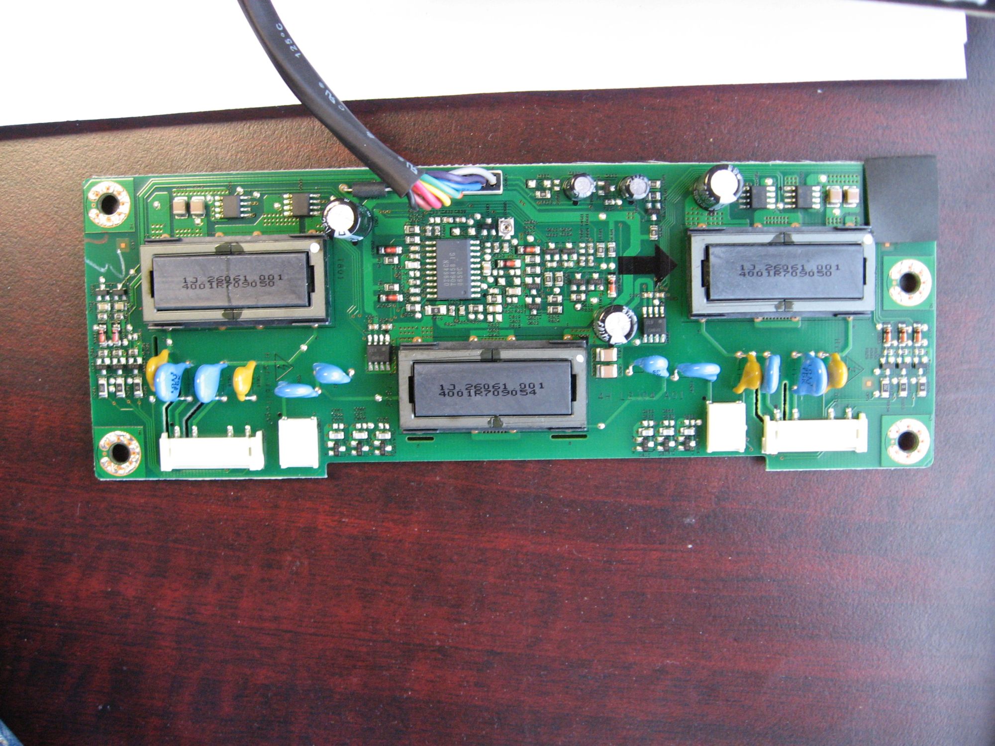

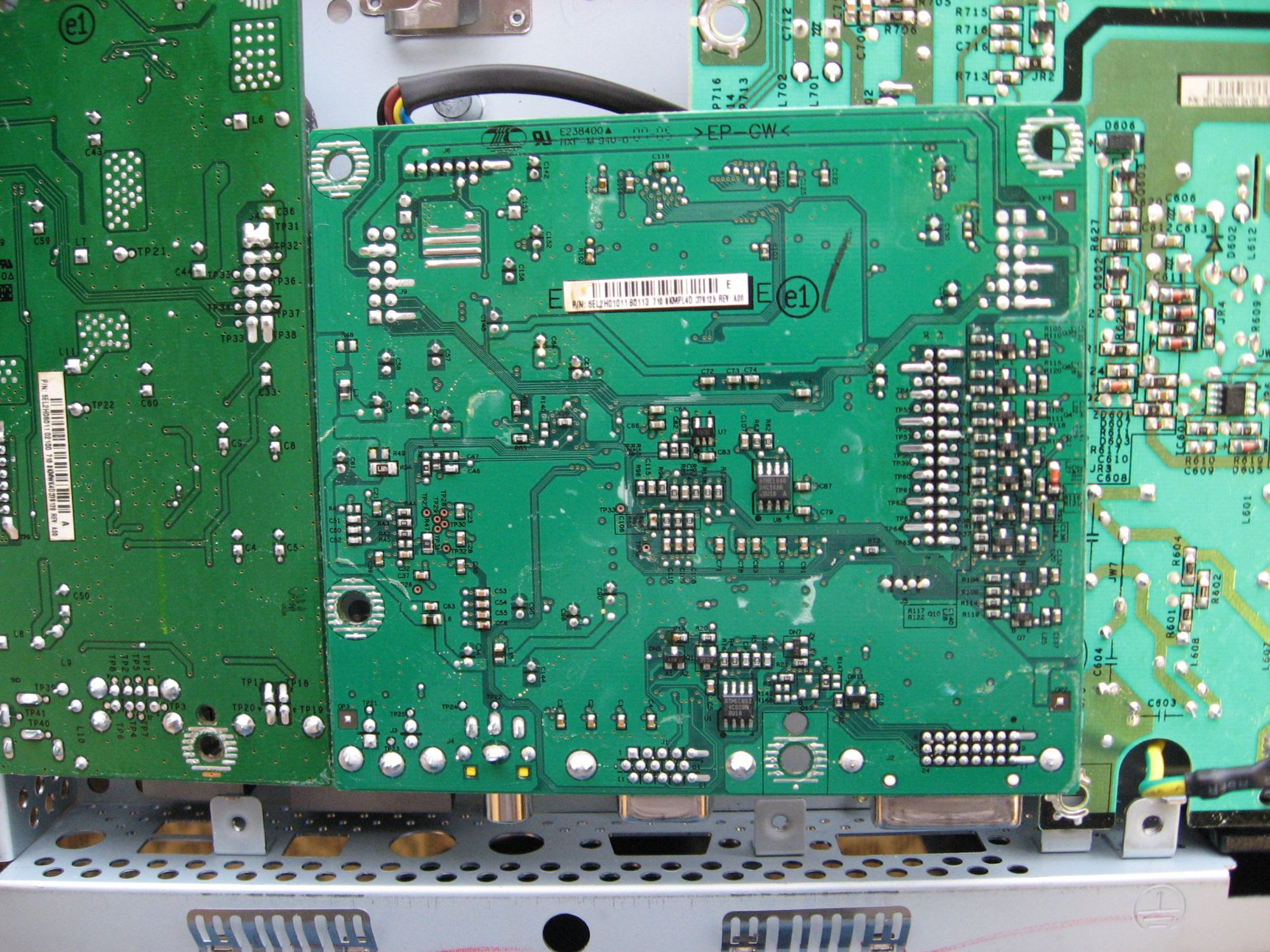

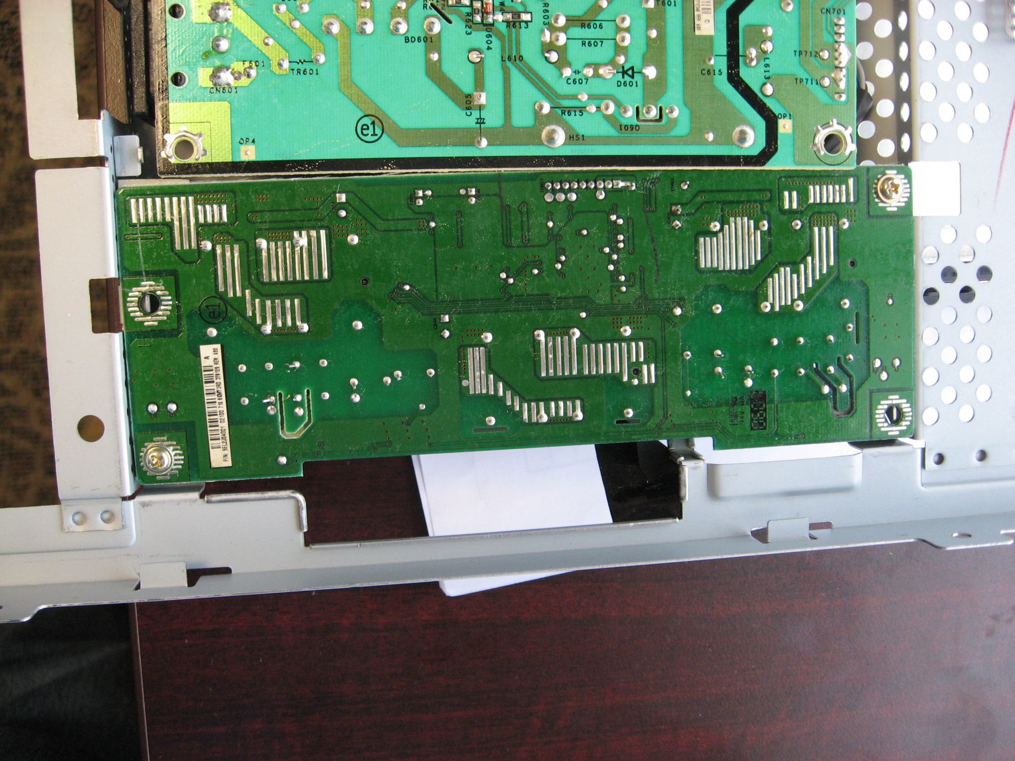

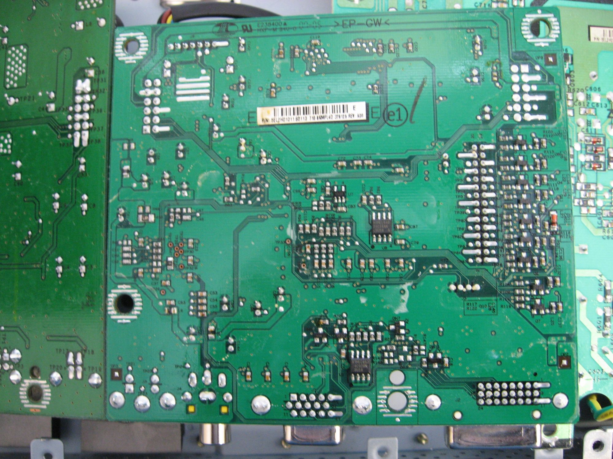

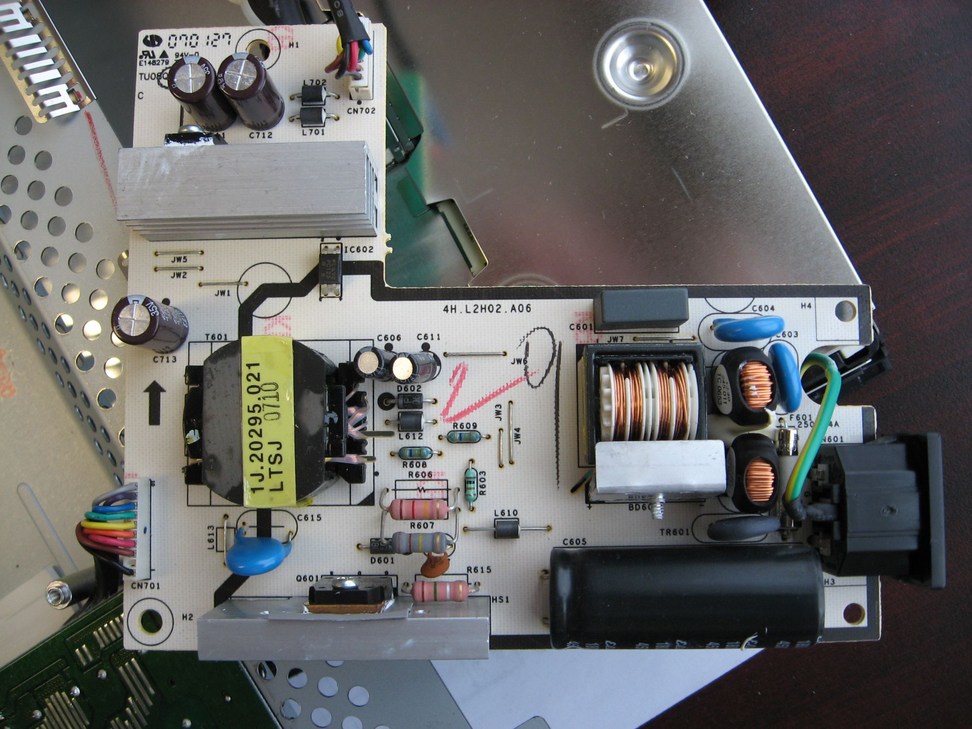

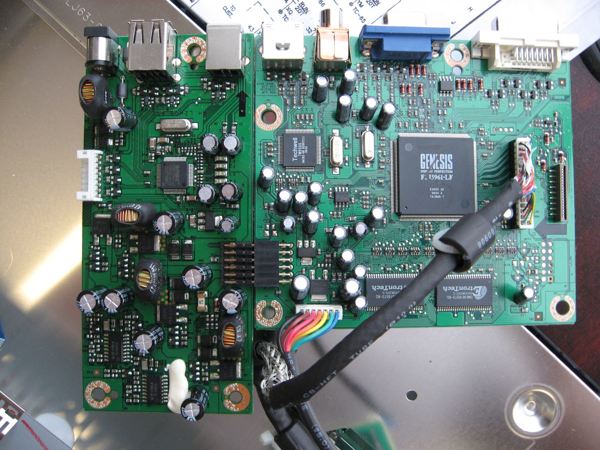

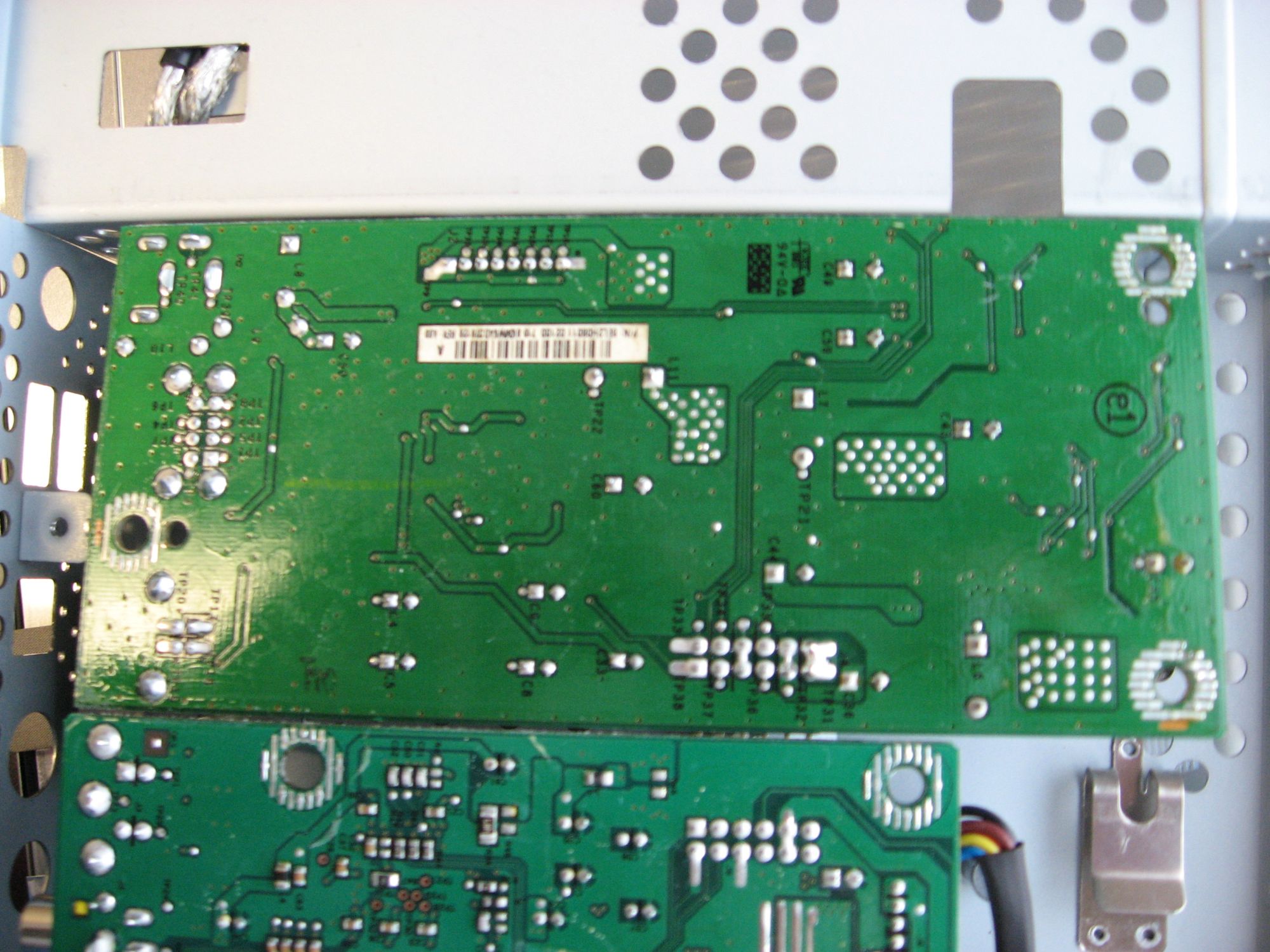

                Re: Dell 2007FPb No Power, Power and 1 icon (VGA) blinking
                Hi all again,
                Sorry for long absent.
                Here are the pictures (see below).
                I have some basic soldering experience.
                Any ideas what can be wrong or what should I check first?
                Thanks.
                  Yes, do you have a multimeter? Do you know how to use it to measure resistance and DC voltage? If not, we can provide instructions.

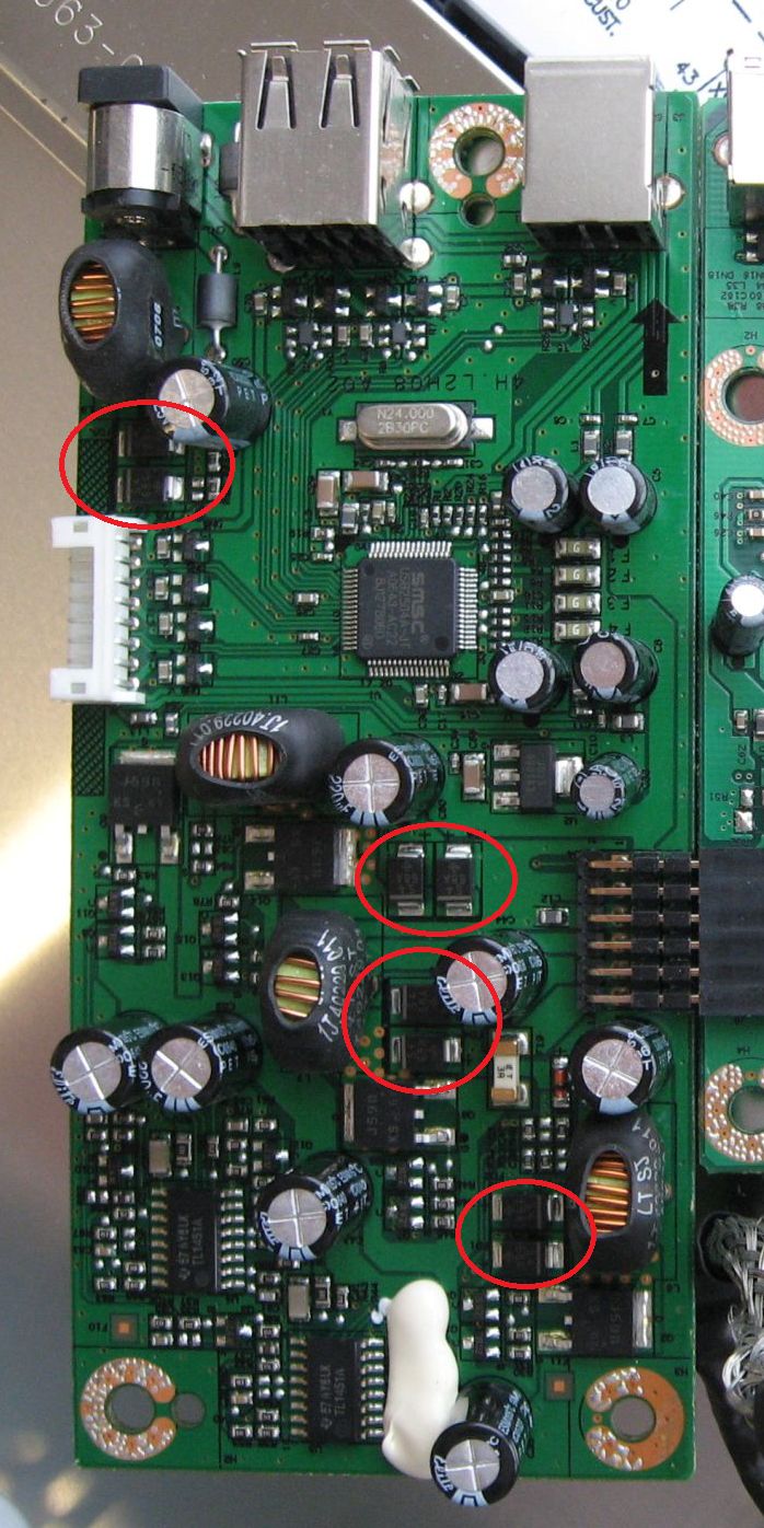

                      Okay, on the power board, there is connector CN702 which connects to the logic board.
                      1) Measure and report all the DC voltages for each pin/color.
                      2) On the logic board to the USB board, there is a 12 pin U shaped connector. Measure and report all the DC voltages for each pin. Careful not to short out anything here.
                      3) On the USB board, there are a number of diodes (I count 8). With power off and lcd unplugged, test them "in circuit" to see if they are bad with the diode test function.
                      4) There are 4 voltage regulators on the USB board. With power off and lcd unplugged, test to see if pins 1-2, 1-3, and 2-3 are shorted. Any ohms reading under 30 suggests a short.
                      5) There are 2 voltage regulators on the logic board. With power off and lcd unplugged, see if they are shorted.

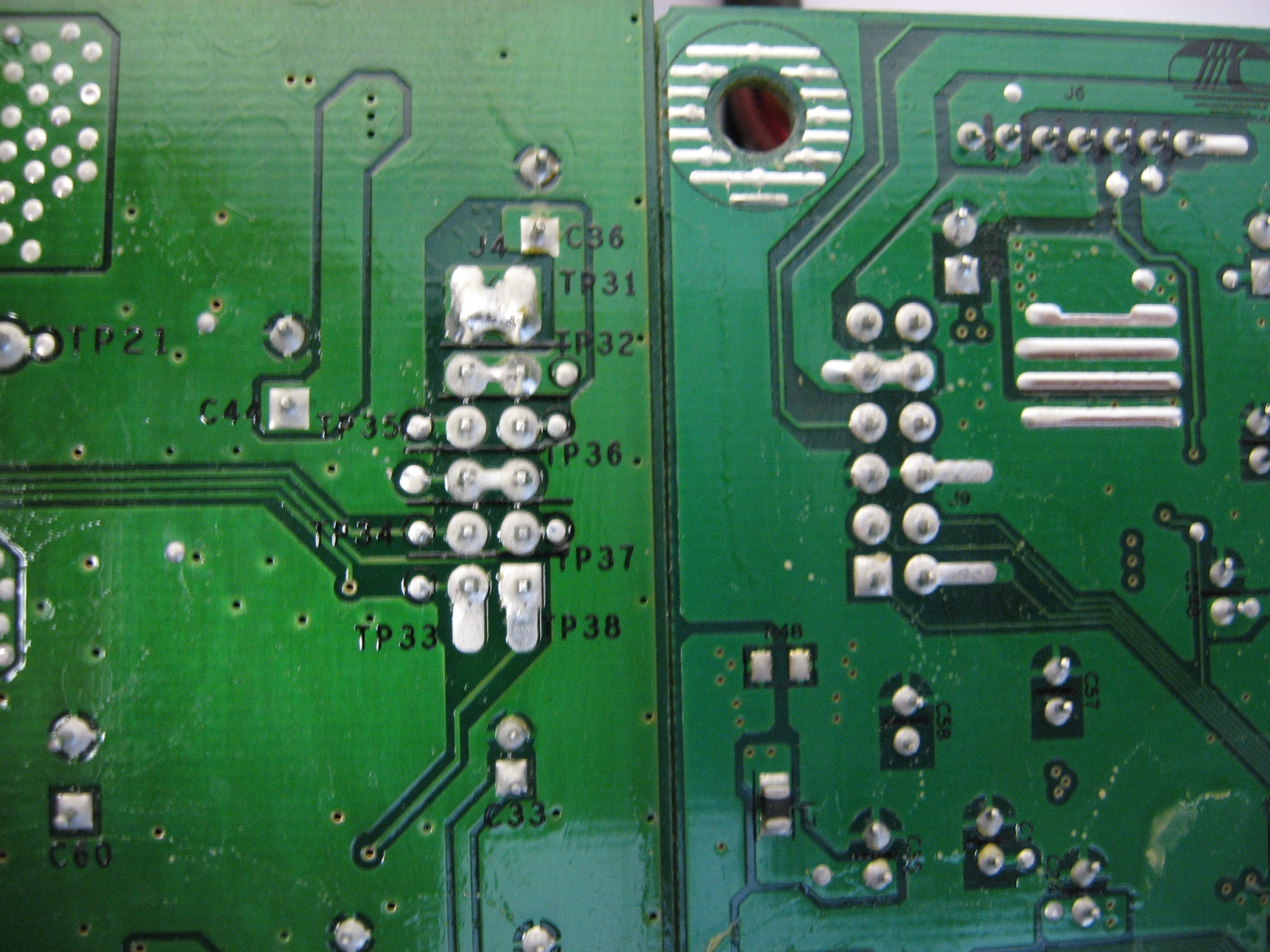

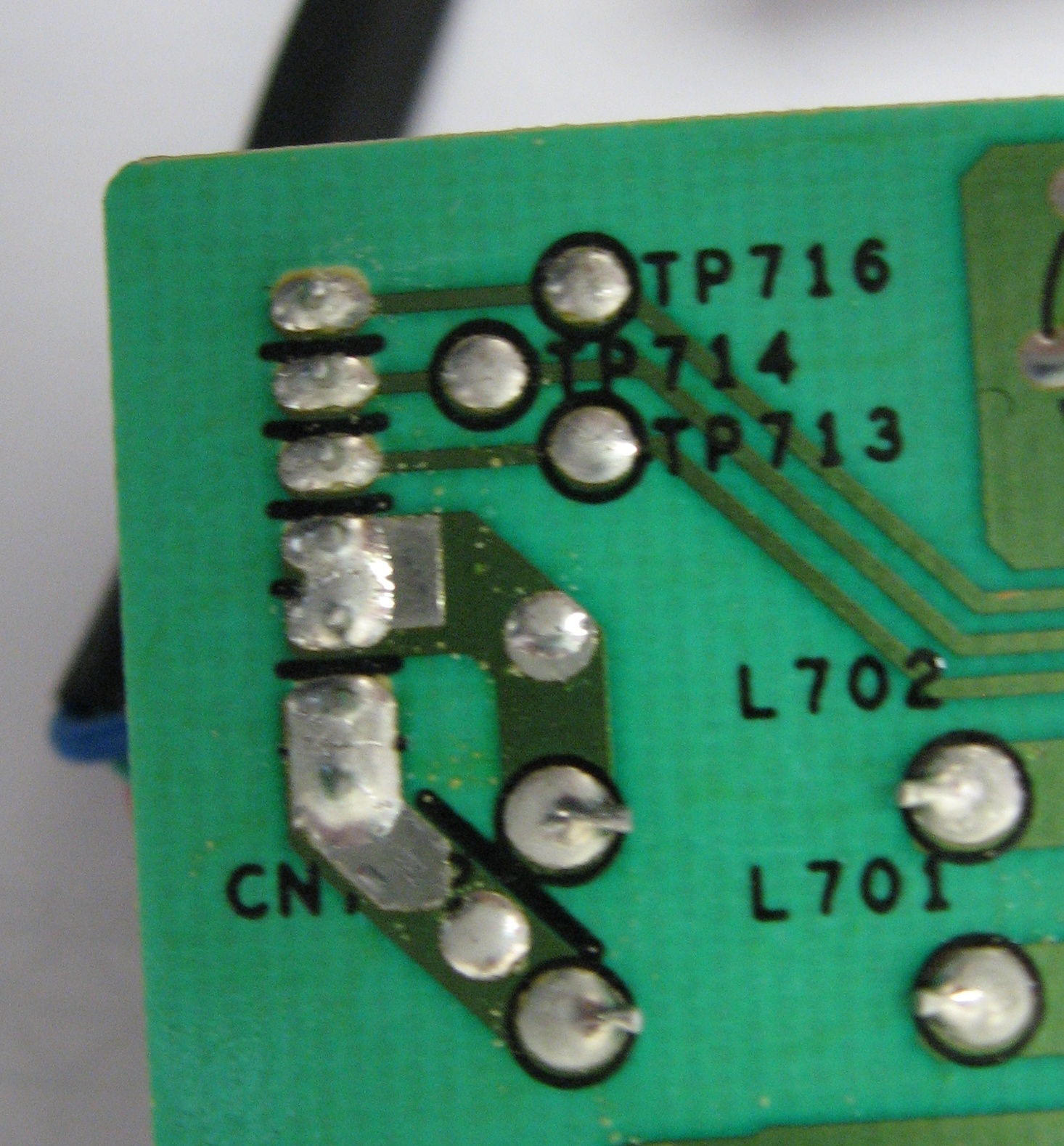

                              I am back.
                              Here are first results.
                              1. On CN702 connector everything is:
                              CN contact - Noname contact - 18.84V
                              CN contact - TP713 - 18.84V
                              CN contact - TP714 - 18.09-18.84V (unsteady)
                              CN contact - TP716 - 18.84V
                              See the first attachment.
                              2. U shape connectors, 12 contacts:
                              TP31 - TP32 - 18.88V
                              TP31 - TP33 - 18.84V
                              TP31 - TP34 - 17.07-18.84V (unsteady)
                              TP31 - TP35 - 15.55V
                              TP31 - TP36 - 14.70-18.00V (unsteady)
                              TP31 - TP37 - 17.32V
                              TP31 - TP38 - 18.88V
                              See the second atachment
                              I think the voltage should not be unsteady there. Is there anything I can check at this point or just to keep going to number 3?
                              Thanks a lot.

                                  Voltages should all be stable and around 19V DC. This could indicate a problem with the caps on the power board being bad. For now, proceed to steps 3-6.

                                      • tboxxx
                                        • Feb 2011
                                        • 21
                                        Hi Retired,
                                        Here (http://www.elexp.com/t_test.htm) it's said that to test "in circuit" I will need to unsolder one end. I will try tomorrow again.
                                        Just to confirm you were talking about the diodes I selected with red ovals in attachment?
                                        Thanks.
