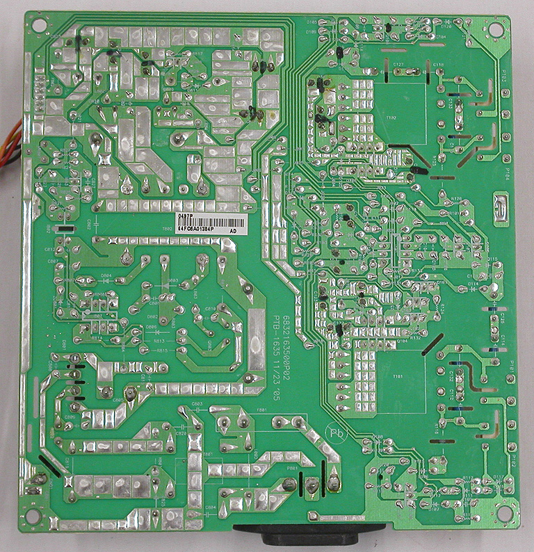

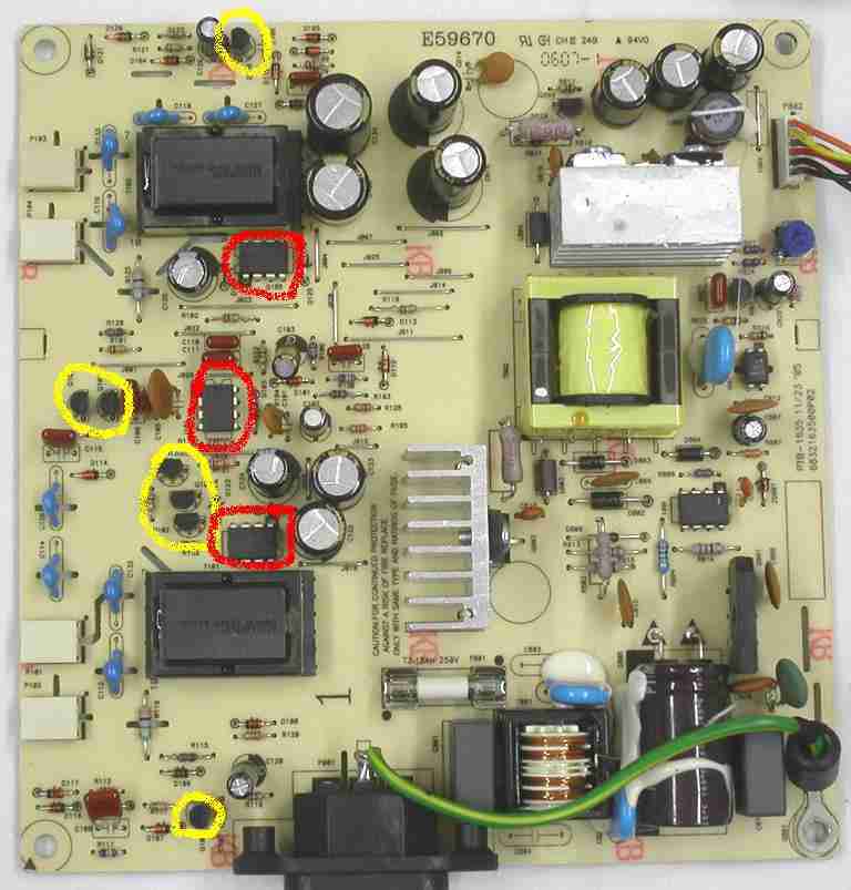

    Received an HP L1906 - no power. Popped off the back and found several bulging caps. Recapped the power/inverter and power came on - but not backlights. LCD shows faint image - swapped lights to test and still nothing. Connector to logic board - brightness measured 2.67v, on-off 3.25v, 5.17v on 5v connection. Voltage measured near inverter is 24v. Where should I check next? Thanks

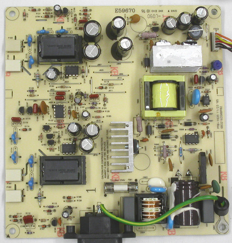

    If the backlights do not flash at all (even briefly), then it is likely you have shorted transistor or mosfet.
    Do all tests with power off and lcd unplugged. All tests can be done "in circuit". Set your multimeter to 200 ohms (if manual).
    For the yellow components, measure the resistance between pins 1-2, 1-3, and 2-3.
    For the red components, look up the part number and find its datasheet. Then test source-drain, source-gate, and gate-drain.
    Any reading under 30 ohms suggests a shorted component. To verify, desolder and retest.
    PS. Excellent clear focused pictures.

      The 4 pin dip circled in the middle is the PWM IC for the inverter circuit. Don't worry about that.
      The driver transistors are the 4 pin dips closest to the inverter transformers.
      Get their part numbers and look up the data sheet for a pinout so you can test them.

        Finally had time to sit down and check things out. Items in red, P607 BD6F2P at Q104 & Q105 - checked pin 1 to all other pins, the only pin that did not appear open was 1 to 3, 15 ohms on Q105, 33 ohms on Q105. Q102,103,106,107 Transistors, K-610 C945p - appear bad, measured resistance between E & C, don't think there should be any - B to C was able to measure both directions. Q101, 108, 109 Mosfets 2N7000 G08 - not sure how to test these - they are marked S-G-D - tried to energize not sure I have the correct type of meter - just reading resistance seemed they were all high. Anyway, with a little help on what to order I would replace the transistors and mosfets. Thanks
            What are the numbers on Q104,andQ105?

              Q104 & Q105 are marked P607, BD6F2P. Thanks

                If you are looking for those, search Aop607
