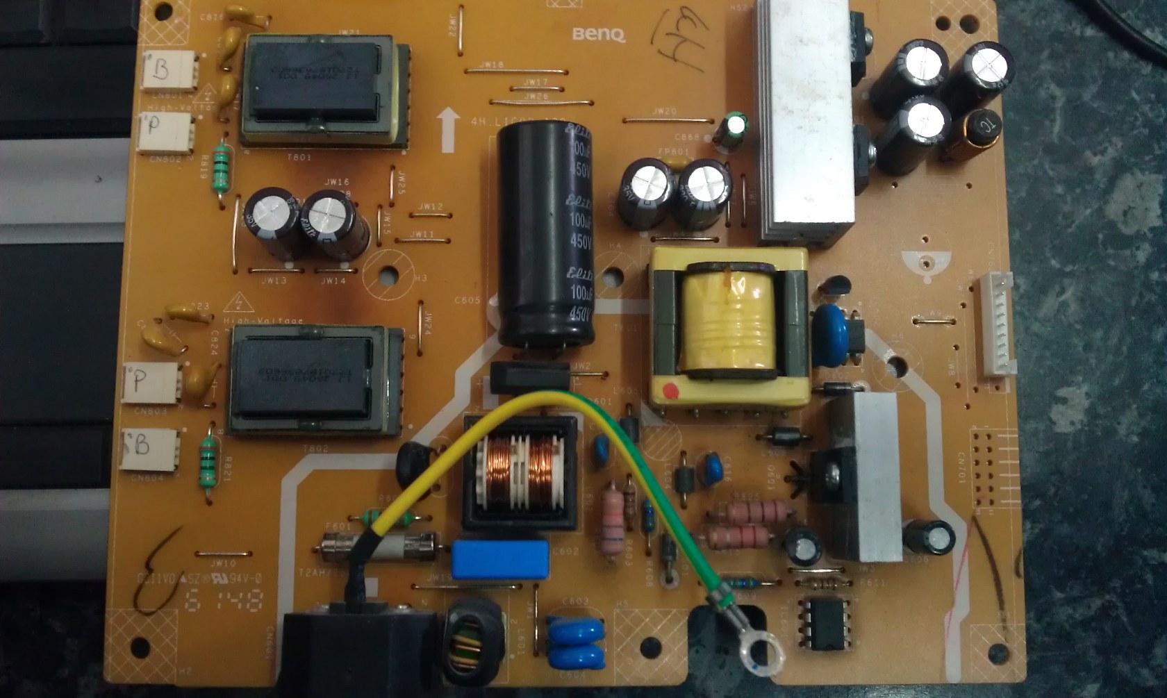

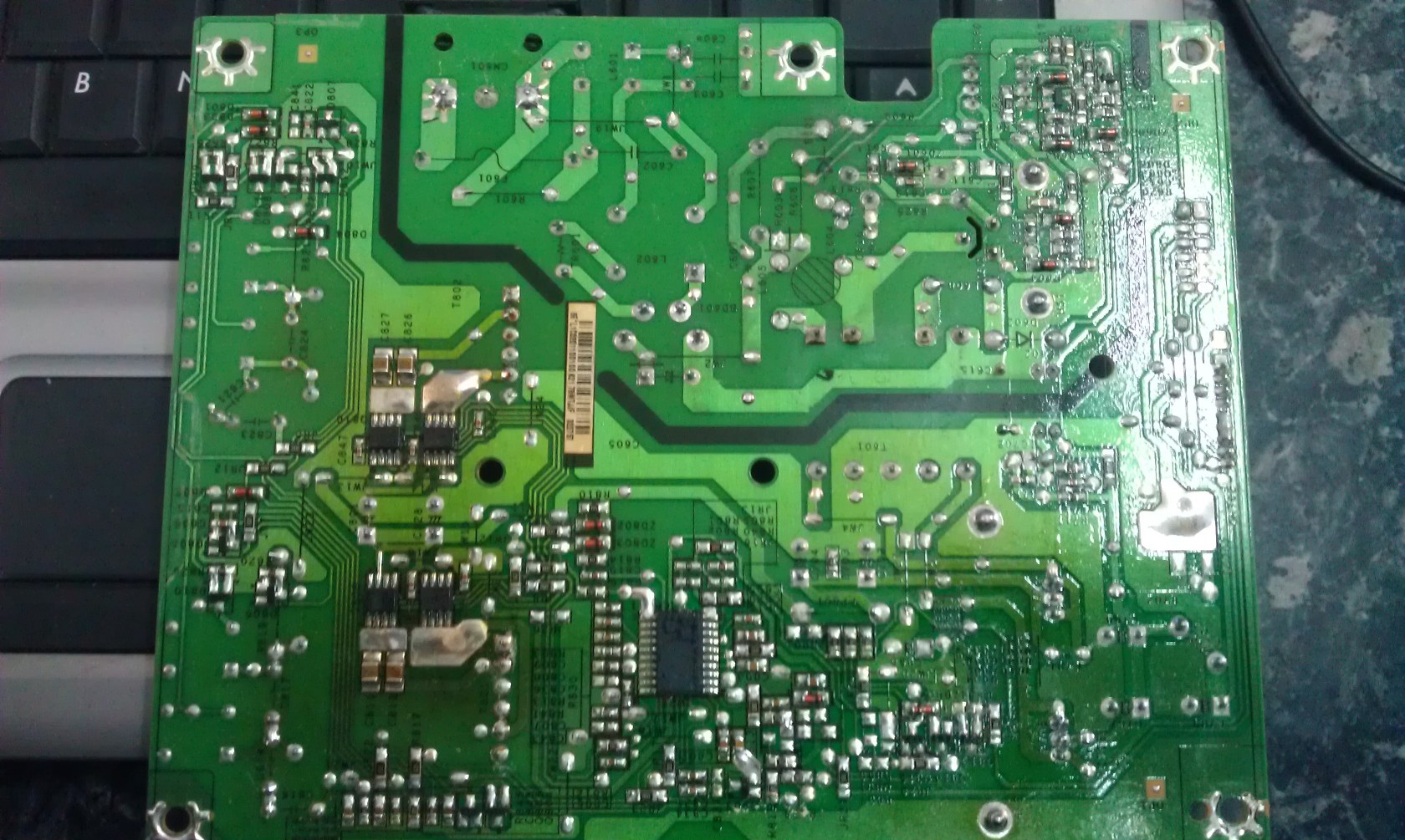

                Re: Benq Q7T4 / FP71G+
                HI guys first of all really great info on your site good work
                i have the same model the fp71g+ the only difference is the the board is differrent. i repaired already benq models but never saw a board like the one i have now,also i can`t find out the fault. i`m posting some pictures maybe you spot something. thanks in advance
                Chris

                  Can you please give a description of the problem/symptoms?
                  • speedcrs
                    • 4
                    #29
                    monitor is switching on showing benq logo ,then after 5 secwill switch off with power switch light changing color
                      Is the monitor attached to a video source? Changing color like it's going into sleep mode (like changing from green / blue to amber)?
                        yes attached to a pc that works normally on other screens.it switches on normally then switches of after few sec. it is not changing any colors.
                        i have fixed similar models to this but never this type of board
                          Sounds like 2 seconds to black - issues include bad capacitors, shorted transistors, bad ccfl's, bad wiring to the ccfl's, etc. The following post is a guide to troubleshooting 2 seconds to black written by retiredcaps.
                          https://www.badcaps.net/forum/showthread.php?t=10419
