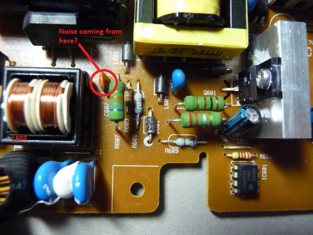

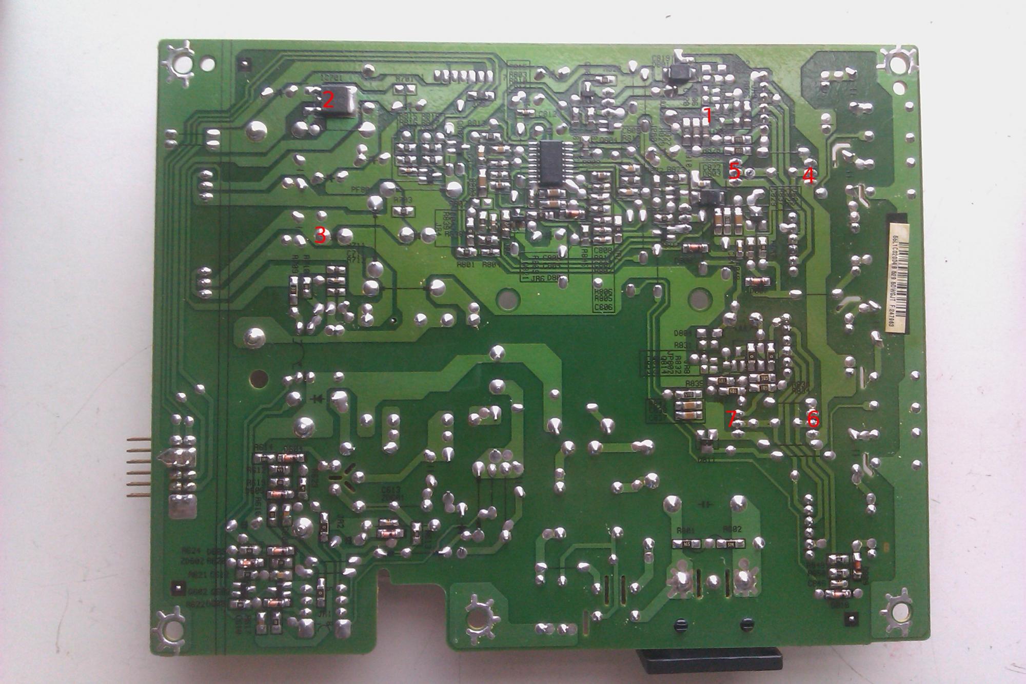

    Hey all, I have a FP71G which is turning off about a second or so after it is brought out of standby.
    Mains power to monitor > monitor standby
    Push on button > power led turns green and display turns on (Benq logo displayed)
    2 seconds later > monitor returns to standby.
    Interestingly, there has always been a slight high pitched whine from this monitor whenever it was on standby. Not really knowing much about the internals of a computer display I ignored it. It seems that this has come back to bite me on the ass.
    Pulled the thing apart and it appears that there is nothing visually out of order (solder, connections etc all look perfect). The only thing I have to go on is the sound.
    Scenario 1:
    Plug mains in > high pitch to slightly lower pitch (is this the sound a bad capacitor makes as it attempts to charge?)
    Unplug mains > (if video driver board is attached (the one with the input ports)) the pitch goes up and down as it appears something is discharging.
    (If video driver board is detached) the pitch goes up and up over a period of about 20 seconds, then all over the place for about 3 until it “dies”
    Scenario 2:
    Plug mains in
    Push power button (whether the boards are connected to the LCD or not does not appear to matter as far as this sound is concerned, so all this testing was carried out with only the two boards and the bezel buttons connected.
    Quick (less than a second) discharge sound, followed shortly by two similar sounds, then silence for a second, then back to standby noise/condition.
    This can be repeated over and over with the same outcome.

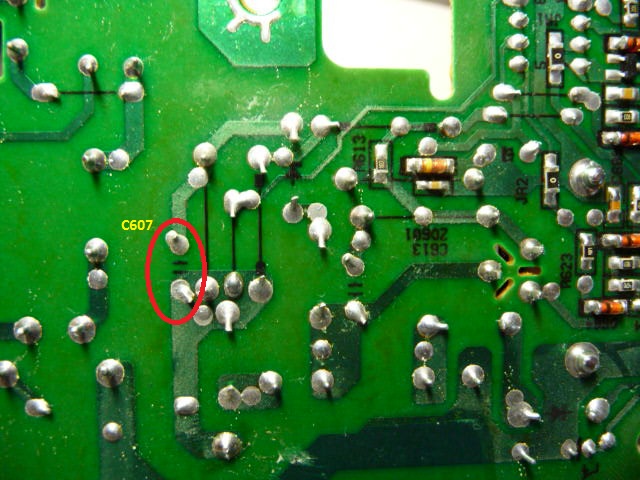

    The charging/discharging noise appears to be coming from capacitor C607 or somewhere very close nearby. I wouldn't suspect the resistors (they have been tested and are fine), the diode is working, but there are two small silver cylindrical components (L605 and L604) which I cannot identify. I believe it is C607, but sound can only get you so close. Who knows, it could be coming out of the side of nearby transformer(?) L602.
    Please see the attached pictures of the nearby circuitry.
    Any ideas? I don't have an ESR meter, so I can't test the capacitor.

    While you didn't show a picture of the entire board, we have seen enough of these Benq boards to know that
    a) you must resolder all the inverter transformer pins
    b) resolder the c5707, fu9024 pins
    A high pitched whine could be the first warning sign of a capacitor going bad. My own guess would be C511. I had a horrendous whine and it was due to the small cap even though it wasn't bloated.

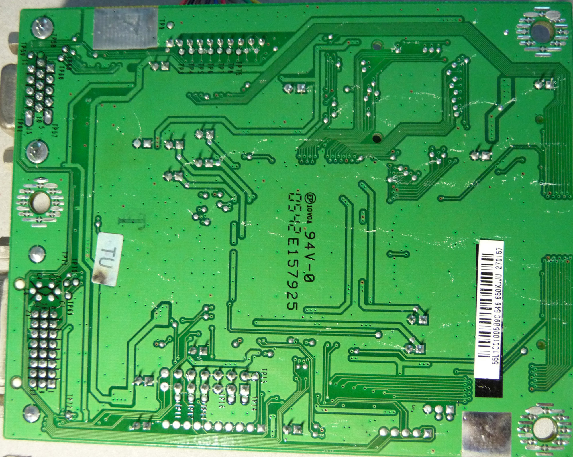

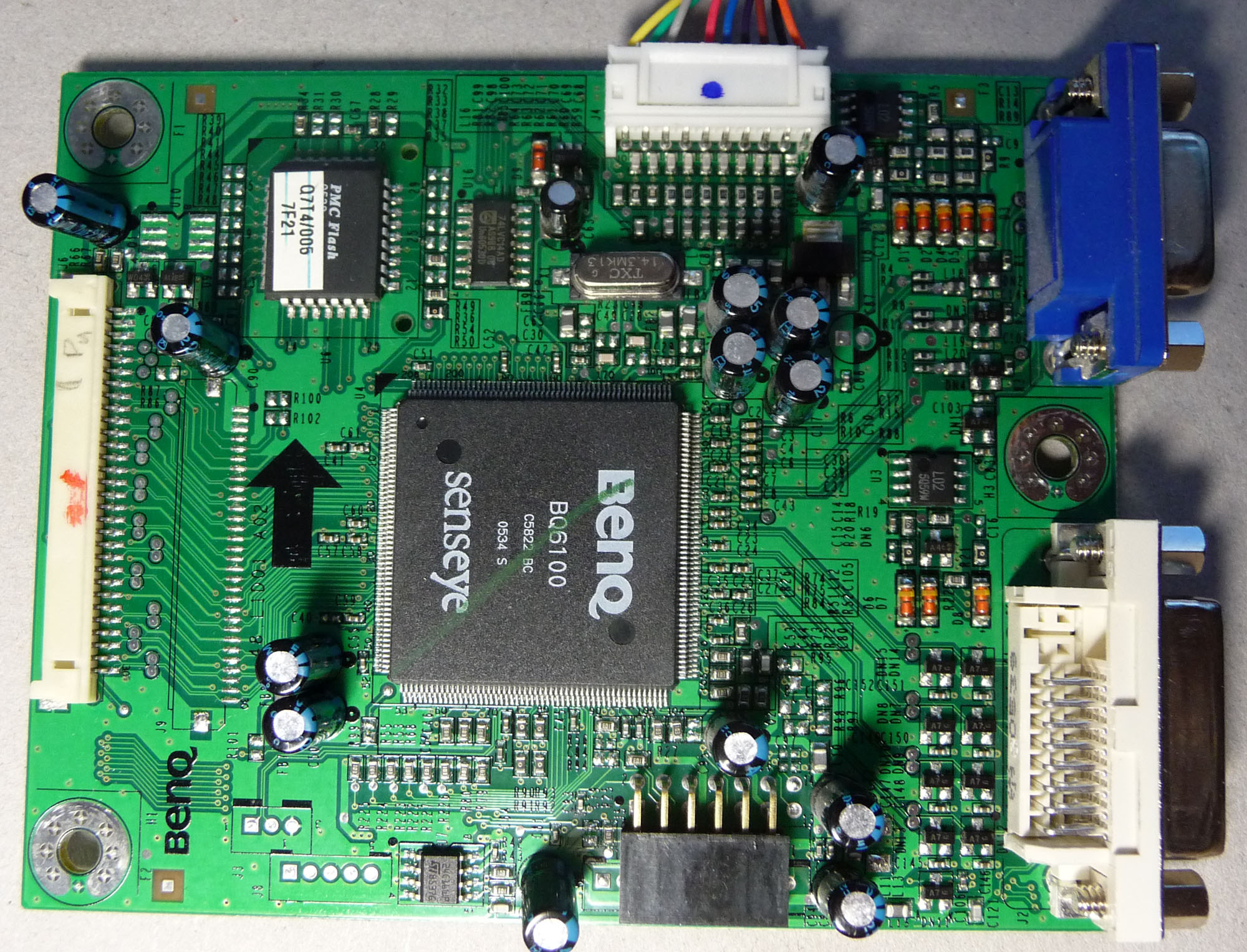

      Good pictures, but your description isn't clear. You could be describing normal operation, two seconds to black, or a monitor which is not recognizing the video signal. A SMPS power supply will generate some noice; this is normal.
      I would suggest supplying several additional pieces of information.
      1. Attach top and bottom pictures of the power supply and the logic card. Make the resolution as close to 2000 x 2000 as possible. We've spent too much time troubleshooting monitors with 'no visible bad components', then seeing several obviously bad caps when pictures were supplied.

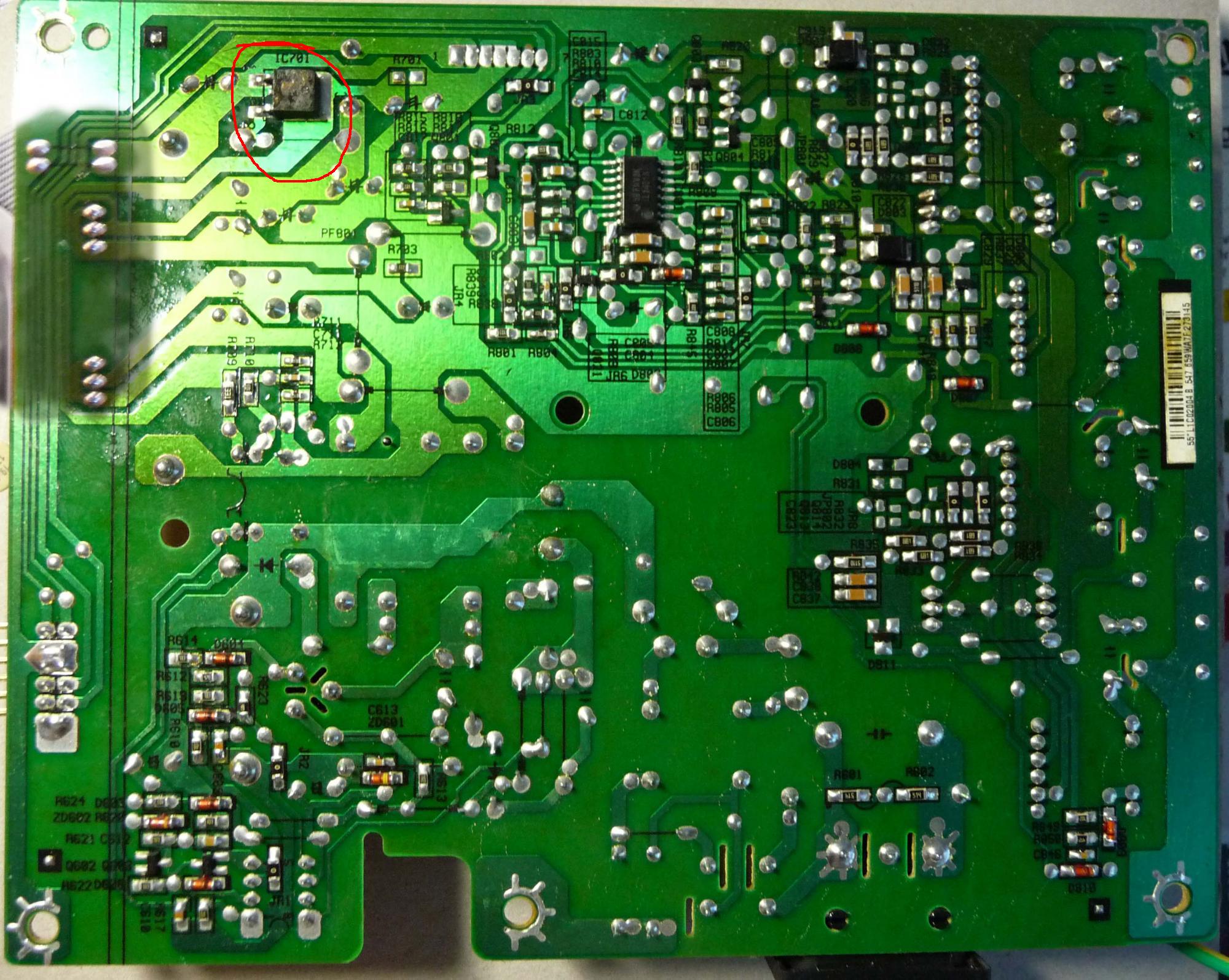

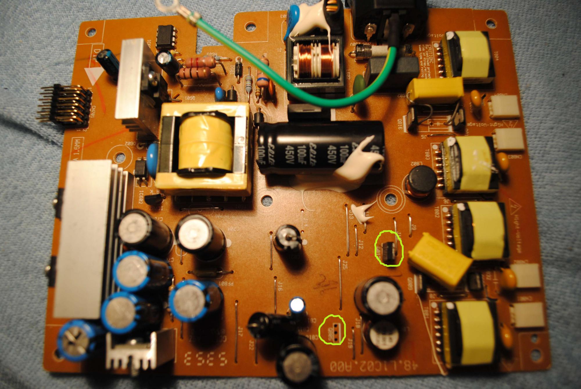

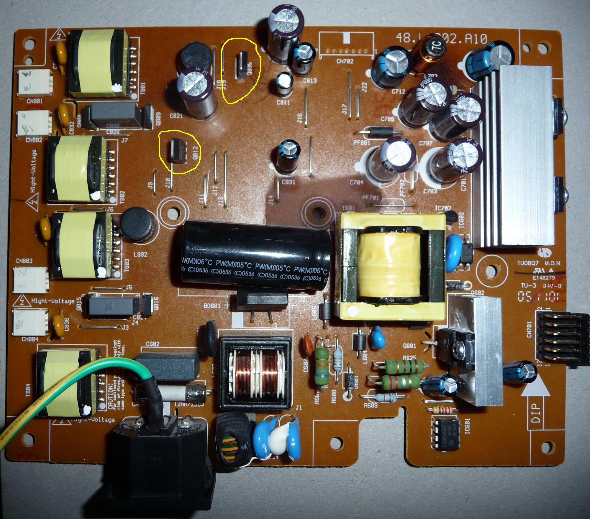

          Hi i have had the same problem on a board exact same model
          Did the usual and replaced all 4 5057 +2 x fu9024
          Noticed on your board pics a burn mark same place i had on mine
          have circled in red on mine i used another fu9024(as i couldnt read numbers on it ) to replace this as i was informed that did the same function
          Obviously i had to trim middle leg but Plainbill or Retiredcaps may be able to tell you correct part number

            Hi sorry just read your other post
            The 9024's are circled in yellow

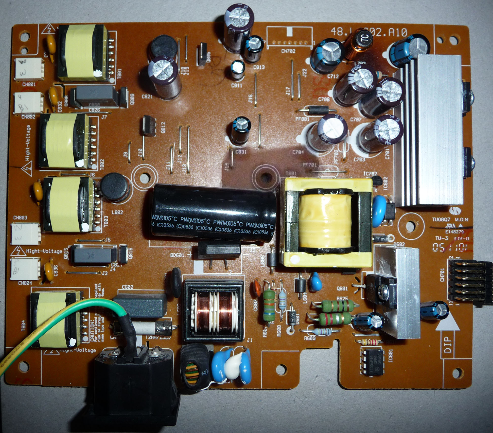

              Darn good pictures. Sabre504 has provided some information. I would suggest also measuring the resistance across the leads of Q808, Q809, Q815 and Q816. Odds are one or more of them are shorted.
              A common scenario is shorted transistors in the inverter cause the power supply to overload and shut down. Usually the supply will try to restart, but that is not always the case.

                  I get a resistance of around 1 ohm over the emitter and base of Q808 and Q809, as compared to much more (5k ohm) over Q815 and Q816. I guess that’s a short in 8/9 if ever there was one! Q812 and Q805 also check out alright (25k ohm E --> B).
                  All the other similar transistors appear to be ok and seem to have good connection (visual and electronic check). Retiredcaps, PF801 = 1ohm. If it’s a fuse, I’m assuming that’s ok?
                  Sabre504, IC701 tests ok – plenty of resistance between pins. I think it’s some sort of adhesive on it rather than a burn mark?
                  So are these transistors that are shorted “c5707”’s, or
                  “fu9024”’s? Or are they actually the same thing? My guess is the 4 x Q808/9/15/16’s are c5707’s and the two Q815 and Q816 are fu9024’s. But it would be a real pain to get the wrong part!
                  Once I can ID replacement transistors I will get some off eBay, as well as a cheap 60W soldering iron, some wick, and rosin core solder (found a nice low cost store in Taiwan). Gosh it’s been a long time since I’ve soldered anything now that I think about it!
                  So how exactly am I supposed to avoid soldering transistor pins together, seeing as they are so close?
                    Definitely shorted. Replace both.
                    Yes that fuse is good if it reads 1.0 (unit) of ohms. That 1.0 ohms should be on the right hand side of your multimeter.
                    "1" on the left hand side of the multimeter means out of range or infinite. That means the fuse is blown => bad.
                    Both my autoranging meters using 0L to indicate out of range. Manual meters using "1" on the left hand side of the display.
                    If you look at the chips, they are written right on there. If not, the Q812 and Q805 are the fu9024 fets. The Q808/809/815/816 are your c5707 transistors.
                    I have done this repair and you need a fine tip on the soldering iron. It isn't that difficult as it seems.

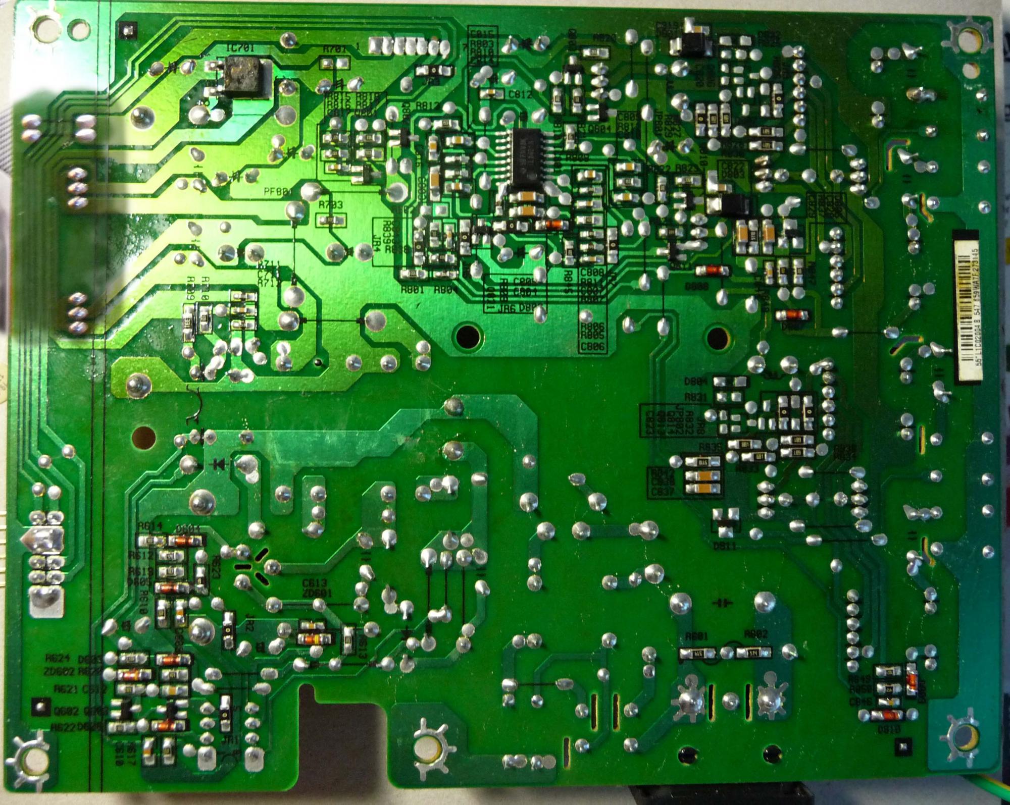

                      IC701 there is definite scorching on the opposite side of the board
                      So maybe it has already been replaced once

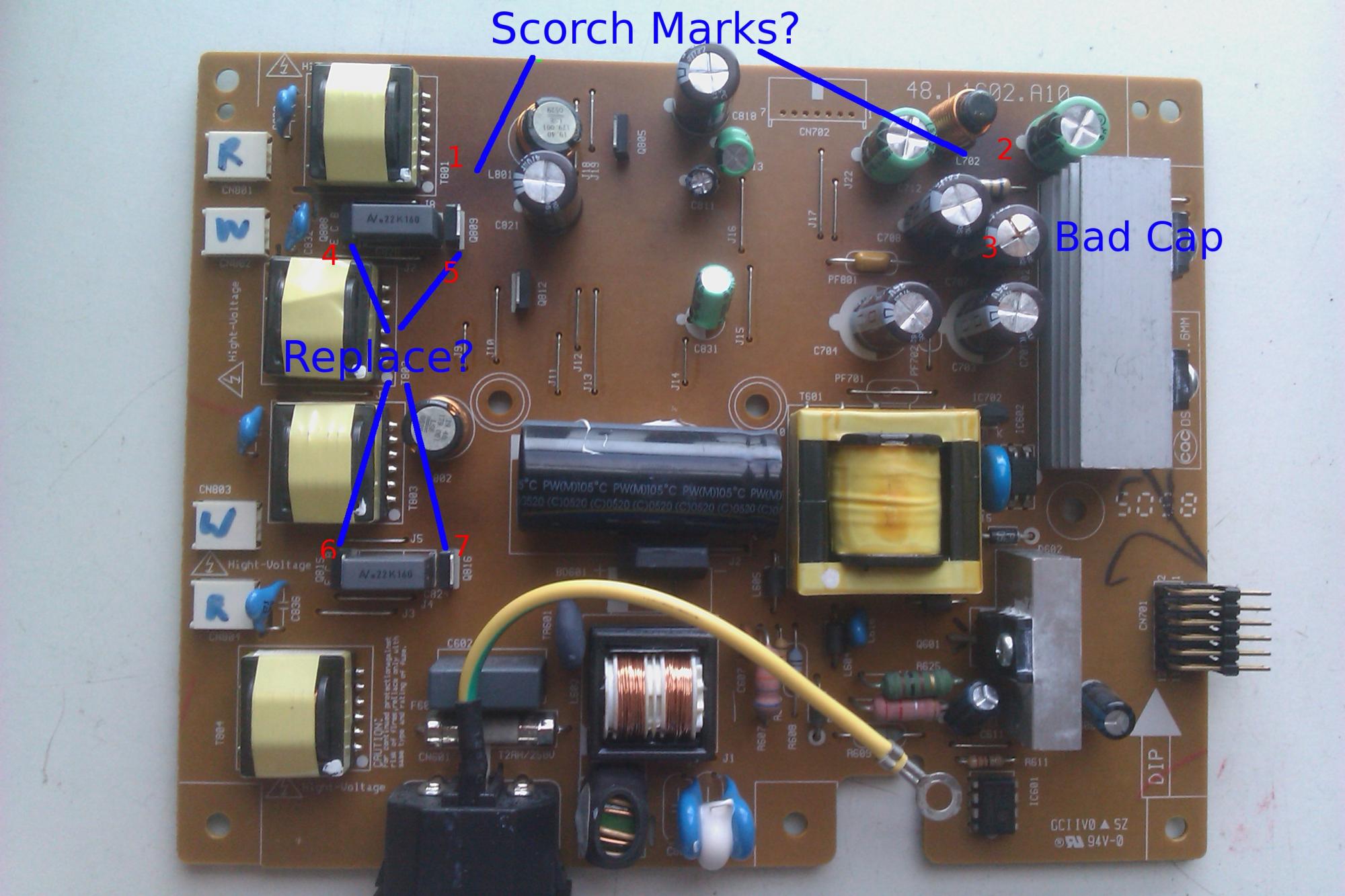

                                  I stumbled across this searching out the reasons for the exact BenQ monitor issue mentioned here. I have four of the same monitors all with the same problem.
                                  This will be my first real attempt at this level of electronics so I'm trying to cover all my bases and making sure I do everything right.
                                  I've numbered some points in the attached images to make this a bit easier.
                                  I ran the test scenarios suggested by PlainBill with the following results:
                                  A: Computer off, monitor off, VGA cable in, IEC out.
                                  When the IEC is attached the monitor does nothing.
                                  When the power button is pressed the LED lights up green, the POST screen flashes up for half a second, then the screen and LED go black.
                                  B: Computer powered on
                                  When the computer is switched on the monitor does not respond at all. After a minuet I pressed the monitor power switch, which provided the same results described in 'A'
                                  C: LED state with blank screen.
                                  See 'A'
                                  D: Shining a flashlight on black screen.
                                  No image is visible.
                                  Sabre504 mentioned scorch marks and having to replace IC701, labelled '2' in my pictures. What is this part and are the scorch marks significant? There is a second scorch mark on my boards, labelled '1' in the pics. What could have caused this one, and is it something to worry about?
                                  PlainBill suggests measuring the resistance across the leads of Q808, Q809, Q815 and Q816. I see these components have three leads. Which two of these should I measure the resistance across?
                                  Retiredcaps suggested to check and resolder C5707 and fu9024, as mentioned above, I'm not sure which leads to check.
                                  I have checked PF801 with a reading of 0.01. From what I understand that bad and needs to be replaced, correct?
                                  Driftwood

                                    Scorch marks at 1 & 2 - common for the Benq monitors from this time.
                                    Cap at 3. Should be replaced. This may be responsible for other problems.
                                    Transistors at 4, 5, 6, 7. Note the transistor at 4 has the leads labeled E C B. While they are not visible in the picture, the leads of other transistors are labeled the same
                                    Test 1. Set the DMM to the 200 ohm range. On each transistor measure the resistance E-C, C-B, E-B. Repeat for the other three transistors. Report the measurements.
                                    Transistors at Q805 and Q812. Make the same measurements.
                                    The reading indicates PF801 is good.

                                      If you need to replace any of the transistors, fets, or picofuses, search for "c5707 kit" on ebay. I purchased some myself for Benq boards.
                                      You must also resolder the inverter transformer pins.

                                        The chip 2 i mentioned looks to have burned out i have had this on one of these boards before , this one is not in any of the kits i have seen.
                                        But this can be replaced with an FU9024 but you will have to trim the legs
                                        unless you can find the correct replacement
