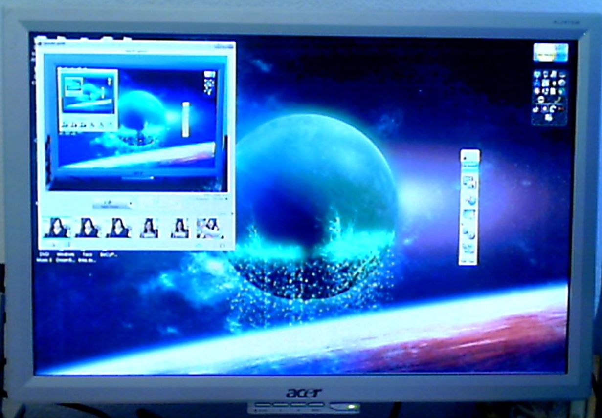

    Replaced U17 in my first surface mount repair ever, and here is the result. I ended up using a part number of AP1084D33L-13.
    My sincere thanks to selldoor, jetadm123, and BadCaps in general for helping me through this; couldn't likely have done it without you and you helped an old tech feel a lot better about herself!

      Well done ! another saved from the tip.
