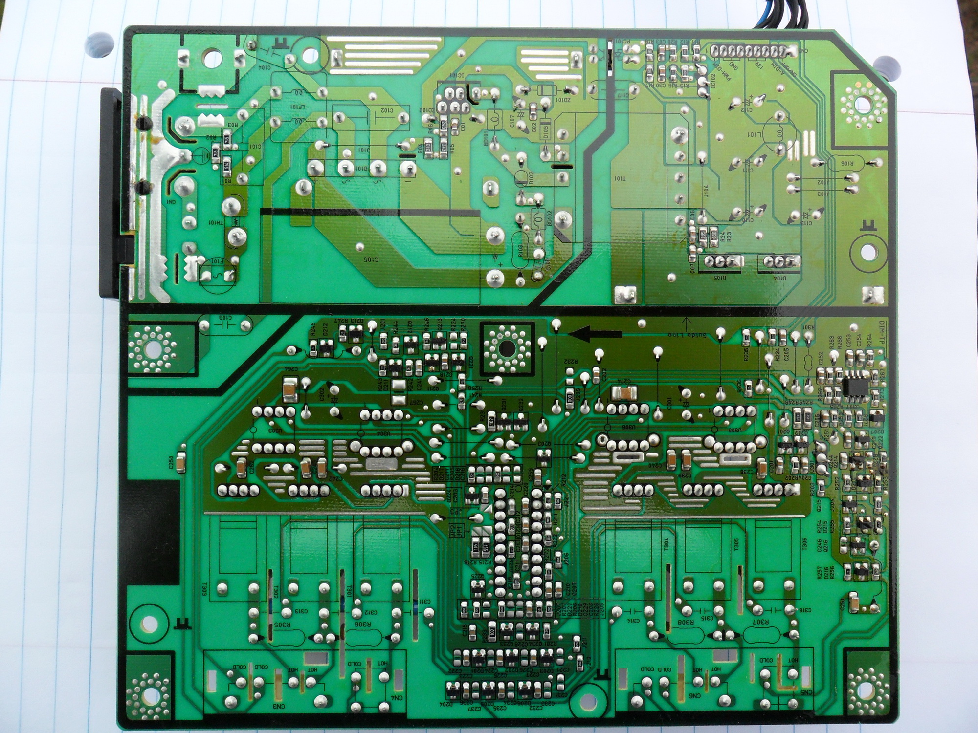

    I have 2 of these and they both are dim and flicker. They were manufactured Jan. 2006 and Feb. 2006. So I opened them up and sure enough they have bulging caps. They both have the same power/inverter and logic boards. The boards are IP-58130A but the difference is the caps on the power boards, c301 and c302 are 820uf 25v on one and 330uf 25v on the other(samsung's cap de'jour I guess).
    What should I replace these with 820's or 330's or can I use something else?
    Unless there are signs of someone opening up the monitors previously, I would replace the caps with the same uF per board.
    Assuming these are the correct dimensions ...
    For 820 use Panasonic FM at
    http://search.digikey.com/scripts/Dk...name=P12391-ND
    For the 330 use Panasonic FM at
    http://search.digikey.com/scripts/Dk...name=P12386-ND
    Don't forget to replace C107 as well on both boards.

      Re: Samsung Syncmaster 214T
      Hi i have had the same with 2 x 22" power boards
      one running 820's the other 330's
      I changed like for like replaced 820 with 820 and 330 with 330
      Check the size of the 820's they used 20mm x 10 on some 17" and 25mm x 10 on some of the larger lcds
      I thought it was odd that the same board had different caps but they worked fine once replaced and still do as far as i know

        Both of the above are good examples why we always ask people to post pictures of their specific boards and not to rely on someone's picture or configuration. It is not uncommon for manufacturers to change components or even entirely different boards, but keep the same model number.
          I'm going to replace all of them except the big one. The 820's are too tall, need something 20mm or shorter c110 and c111 are 820's also c112 is 330. I'm going to check digikey for FM or FC. I have a Nichicon PW for C107.

            IThe 820's are too tall, need something 20mm or shorter c110 and c111 are 820's also c112 is 330. I'm going to check digikey for FM or FC.
            Panasonic FC is 20mm in height.
              I found Nichicons at 20mm also
              Had a 19" samsung once that used 680uf 25v and 2 820's at the transformers
              but had space to use 25mm tall ones laid on their side i found the Nichicons after the event

                The new Panasonic FR series 820uF 25V is 10x20mm according to
                https://cdn.badcaps-static.com/pdfs/...8154d53459.pdf
                but mouser has none in stock and 18 week lead time.

                  Just ordered the FM and FC's from Digikey, should ship tomorrow. A friend brought these monitors to me and said if I can fix them I could have one. Not bad for less then $20

                        Replaced the caps and both are working. Gotta love Digikey 2 days to ship from MN to FL via USPS.
