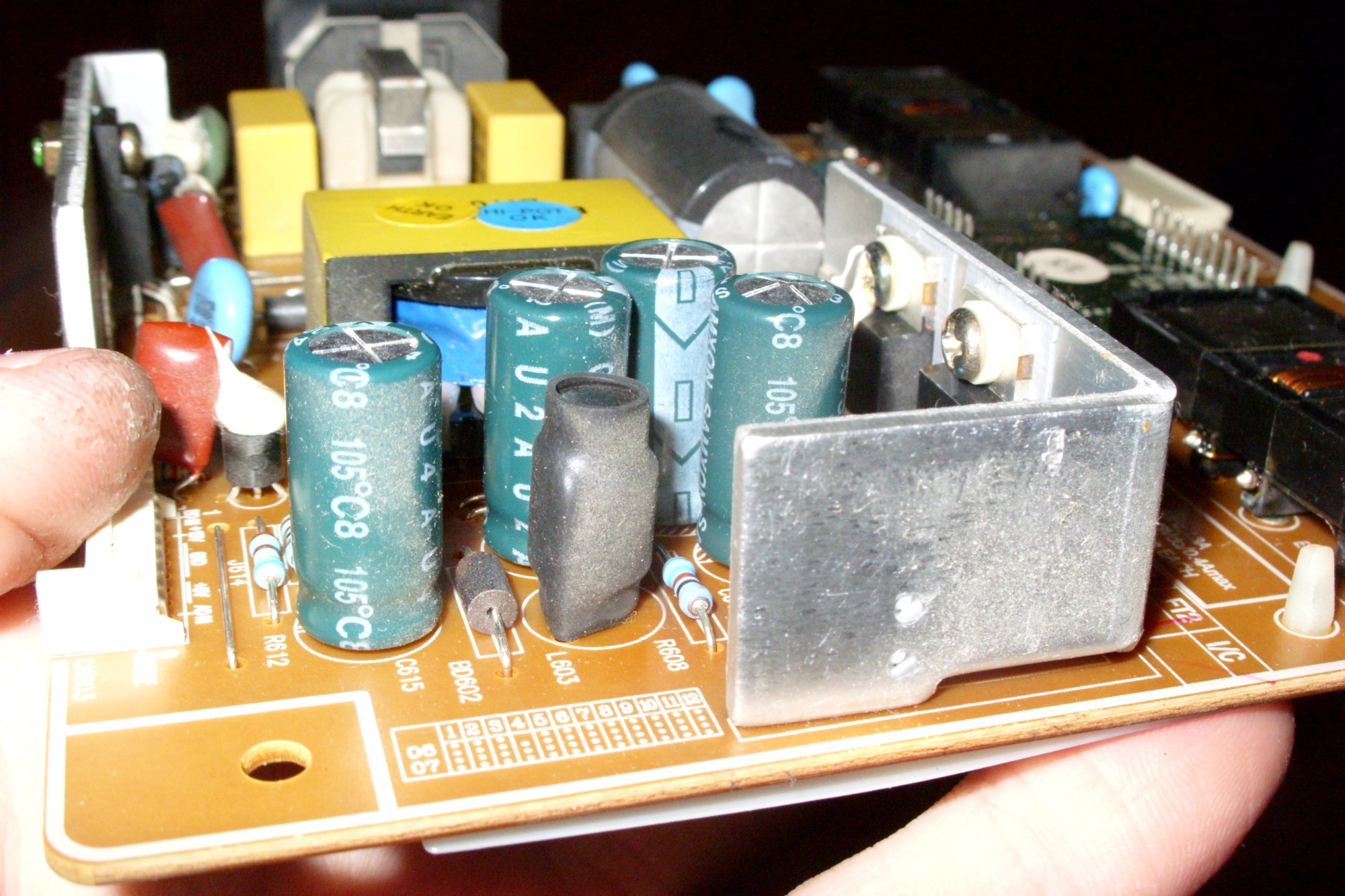

    50 bucks for this. Samsung Syncmaster 930BF, pristine condition, never opened. Fault: no power. Fix: ONE capacitor. First cap on the 5v rail, before the filter coil. Green Samxon, didn't bother to read the series. 16v 1000uF. Replaced with Nichicon PL 10v 1000uF. All other caps tested fine. I've seen the same type of Samxon cap gone bad in the same position, in a LG Flatron of the same size. Makes me wonder whether someone doesn't know how to read datasheets, or they do it on purpose. But who cares, it got me a cheap and easy to fix monitor, so i'm not complaining. Put the thing back together, and... we have power! But oh my it's got a buzzing power supply. A bit of lacquer will fix that tomorrow.
    I actually like it. The only problems are that i need higher resolution than the 1280x1024 this thing offers, and that it's too damn bright. But with the looks and the DVI input, it'll sell quickly for $100+.
    PS - yes i know i'm still on Vista on the main computer. Can't be bothered to upgrade it, that's planned when i'll be buying a new HDD.

    I don't want to rain in on your parade, but you paid way too much.

      Was expecting that kind of comment. Well, the economy in Romania is WAY WAY different from... pretty much anywhere else. The crappiest 19" LCD retails for $165 around here, and that's in online stores. For people who are dumpster diving, scrap iron or copper is the best they can get. One guy on a local auction site is selling 17" LCDs with missing boards or damaged screens for $30 and calling it an "awesome offer". No such things as monitors on the curb here.
      On topic: sharp eyes will notice another little mod besides that cap, post if you see it.

        I know, I understand. If I was in Romania, I would jump on it. But you're in Bucharest... I thought things were much better in that city. In any case my reasoning is that replacement capacitors would cost me maybe $15 after shipping, I certainly wouldn't have left them with the Samxon and what appears to be series "GF"... (I trust Samxon, but GF series is unreliable)
        So $65 for a screen, plus picking them up, is too much of a hassle. I have the luxury of waiting for deals to fall into my lap sometimes.
        So yea, I don't know how long the rest of those GF will last. That Flattron I told you about also had GF, they were ALL bulged. By the way, PL is not a suitable replacement for GF. You need United Chemicon LXY, LXZ, KY, Panasonic FC, Nichicon PW, PM, HE, or Rubycon YXG.
        I wouldn't sell it in the condition it's in. It's just not worth the hassle if it breaks down on the guy.

          In my case, replacement capacitors = free. I have enough of them around, and i don't have to pay shipping when i buy caps coz i buy them locally. Anyway, since you said PL isn't a suitable replacement, can you provide a datasheet? I couldn't find one for this series.
          As far as selling it goes, no one will blame me if it breaks down a couple years later, since monitors gone bad within the warranty period (or just afterwards) are common. I offer 6 months or an year verbal warranty to everything i sell or fix, so far nothing came back except that DV9000 laptop that i reflowed poorly the first time. It's been about 10 months since the second intervention on that, so all is fine with that one as well.
          Yes things are better in Bucharest... or at least used to till this government screwed EVERYTHING up.
          PS: I wonder, is there such a thing as custom firmware for LCDs? One of the main reasons i still use CRT monitors is that they can be dimmed very very low. None of the LCDs i've used so far (with the exception of a couple laptop screens) can be dimmed as low as i like for night use.

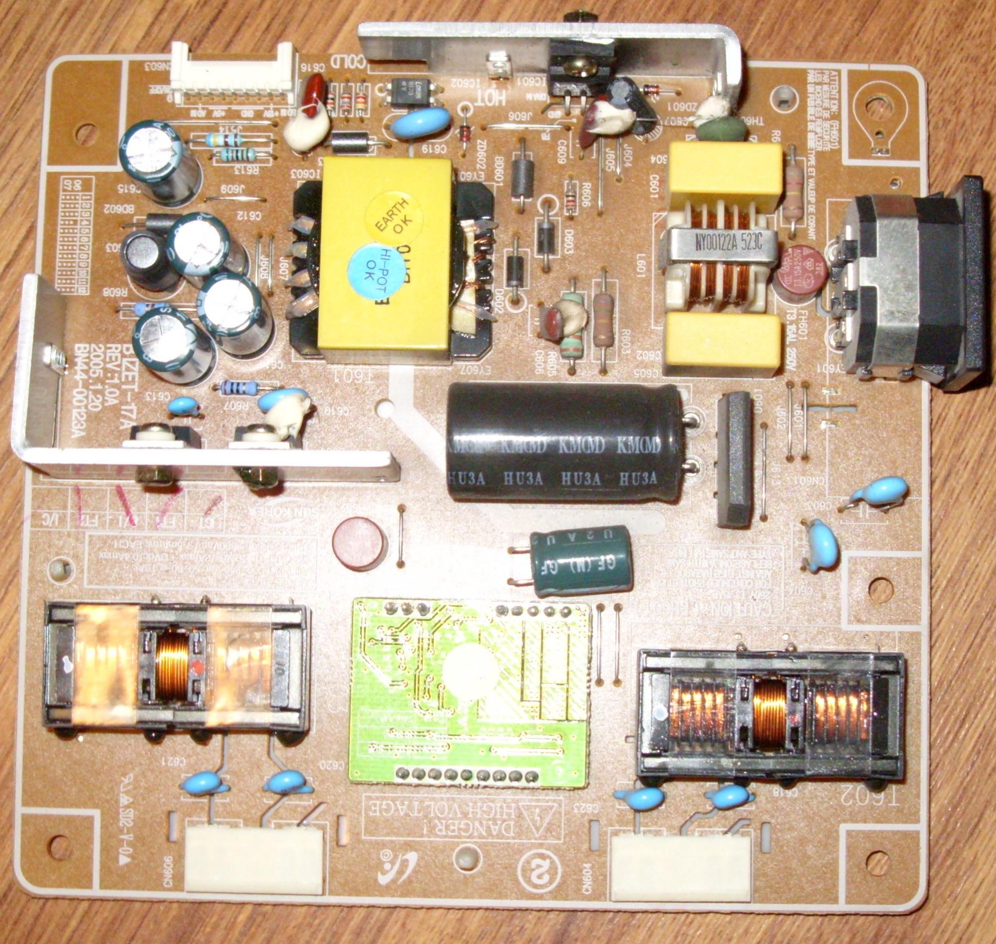

            Heh, I wish I could get those capacitors locally, only fake Chinese stuff around here, and it would take me an hour to get there by bus. I've heard of people playing with the firmwares, but I imagine the step would be to dump the rom chip that's on the logic board.
            The question is also how tightly can the controller "dim" the CFL bulb. Dimming CFL bulbs is not as easy as dimming regular lightbulbs. Give it too little voltage, and it won't start or it will keep flickering.
            Here's the spec sheet.
            edit: Ah, you're right! PL is indeed acceptable. It's been deprecated by PM since 2002. They probably just took out the lead to make it Rohs compliant or something stupid like that.
            edit 2: Actually I was able to get PL at my electronics store a while back, only really small values though.

              The Nichicon PL came from some server mobo iirc, but stores here do carry United Chemi-Con. And there's always Farnell for any special stuff. Edit: I see. Lower ripple current rating and slightly higher ESR on the Nichicon. I'll be taking it apart again to quiet the transformer, i'll see if i can find a better replacement then. But seriously now, i doubt it has to swallow 1A of ripple in this monitor. If it doesn't get hot, i'll just let it be.

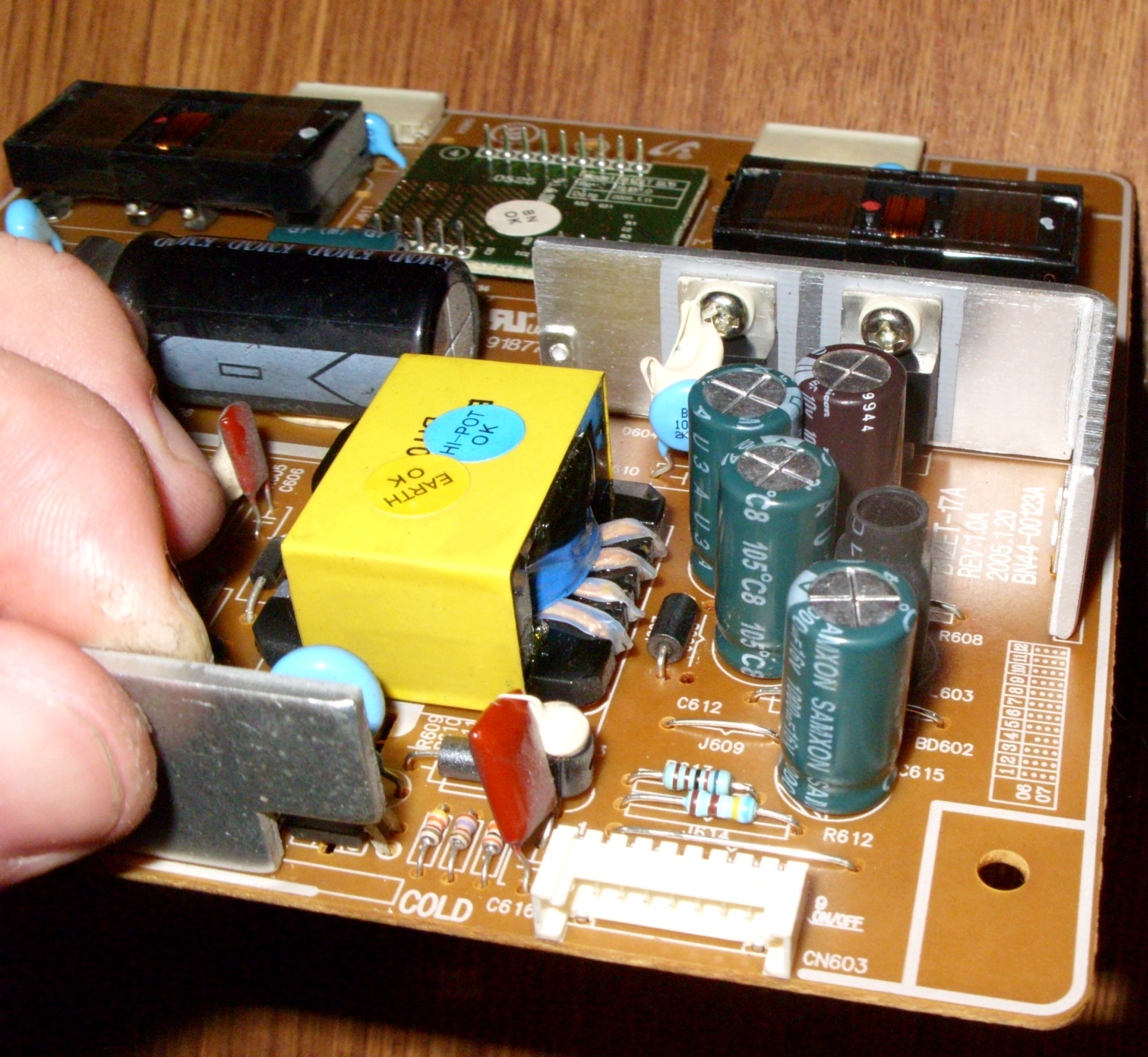

                        Fix: ONE capacitor.
                        Nice find and nice fix!!!

                              Okay back on topic. Lacquer didn't do anything, and a test with the bare boards running without the case revealed the true source of the buzzing. It's the panel itself that buzzes, more specifically the CCFLs (NOT the inverter transformers). It goes away when the brightness is advanced past 70%.
                              I just wish it'd been the other way round - in the day it's a lot more likely for the buzzing to be drowned out by other noises.

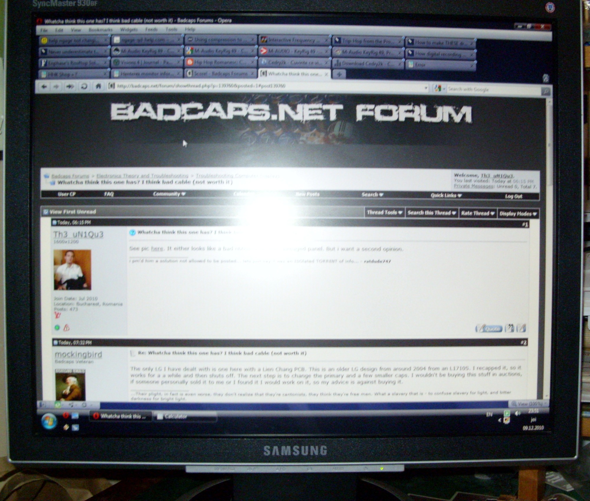

                                  It's leaving tomorrow for $92. Good job methinks. Gonna hunt for a 22" now.
