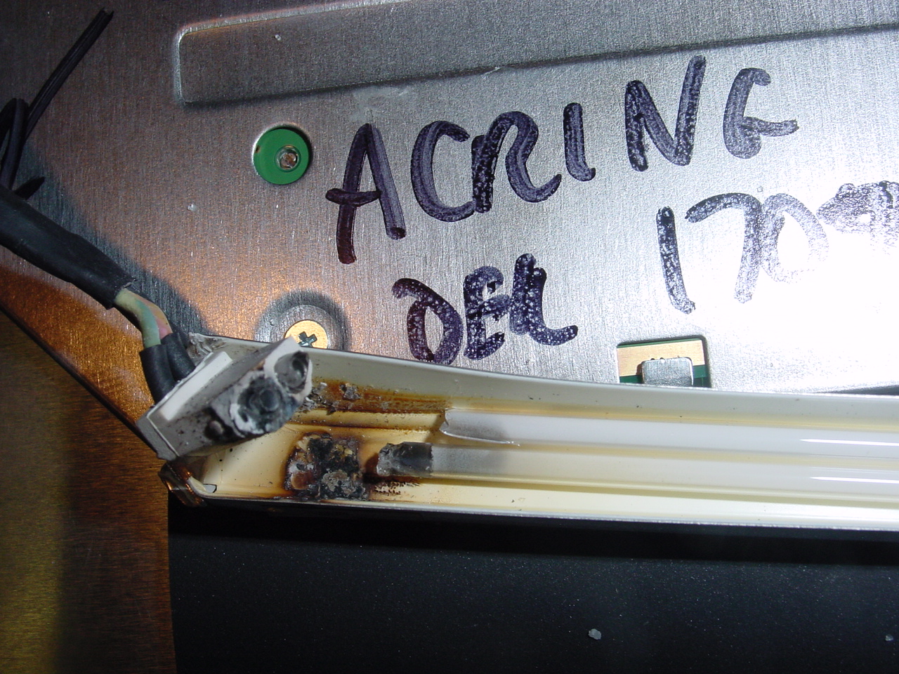

    Ok, I've now had 2 different Dell SE198WFP monitors with the same problem and I had to read numerous posts on numerous blogs looking for a solution before I actually figured it out, everything that I'd read suggested bad capacitors on the inverter board (and I'm sure that's an issue, but it wasn't mine). After replacing all of the caps on the inverter I still had the same problem.
    Long story short, I found (on both of my SE198WFP monitor's) that at least one of the four CCFL backlight tubes had a burnt wire on the end of it. Period.
    Now I'm not sure if this is a common problem with this monitor, but it was in fact the problem with both of mine, and after fixing these wires both monitors now work just fine :-) It seems that all four CCFL's have to pull the same amount of current or the monitor trips the overload and shuts down the inverter. I hope this helps!! And good hunting :-)
    You hit the nail on the head; one CCFL fault will shut down the backlights.
    I see quite a few monitors with CCFL wiring problems; it's usually where the small return wire solders to the CCFL.
    If you have A 2 second to black problem that's corrected when a known good CCFL is substituted, inspect the wiring very closely where it goes through the silicone end cap. If any discoloration of the wire is noticed there is a good chance you found the problem.

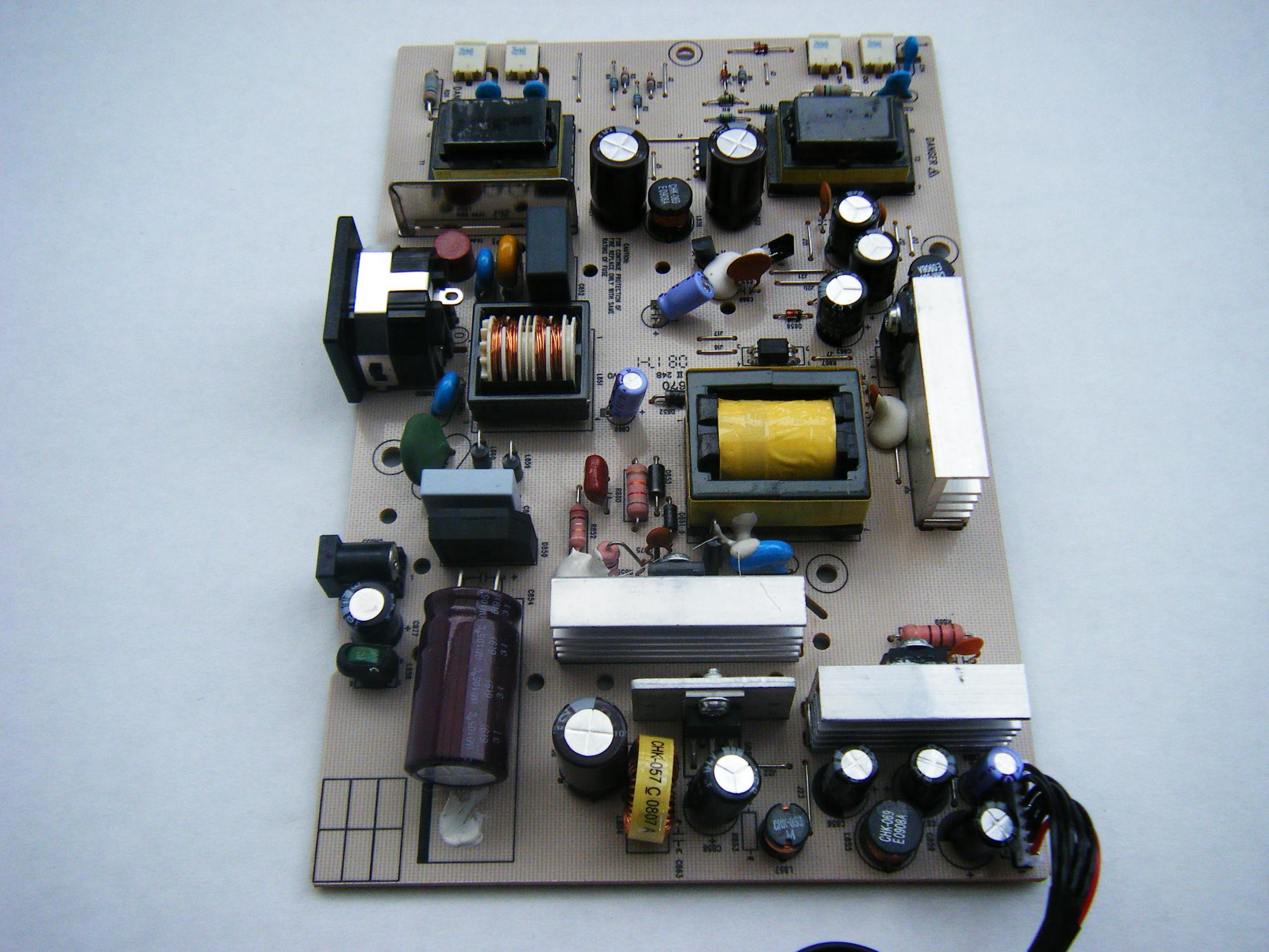

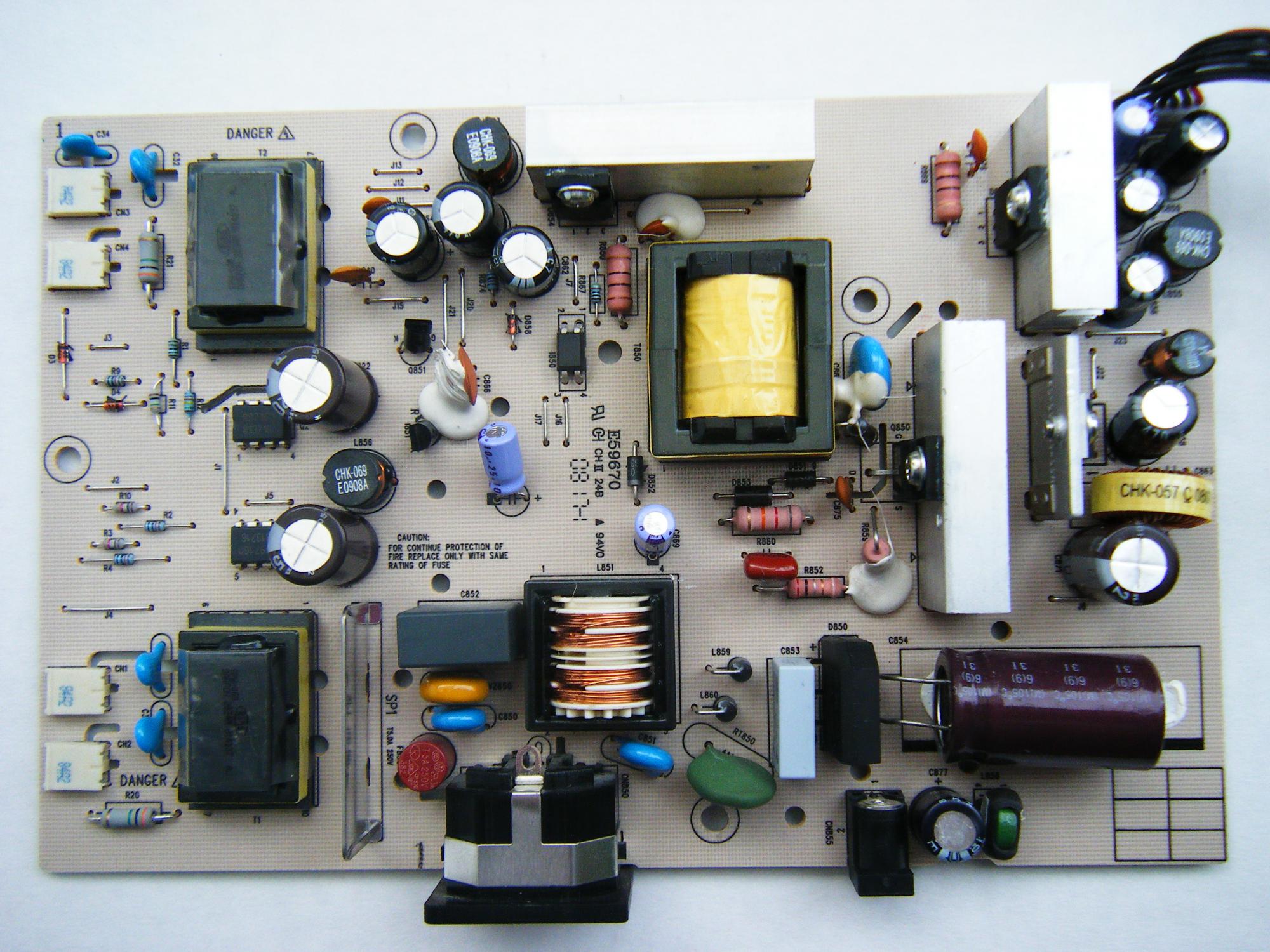

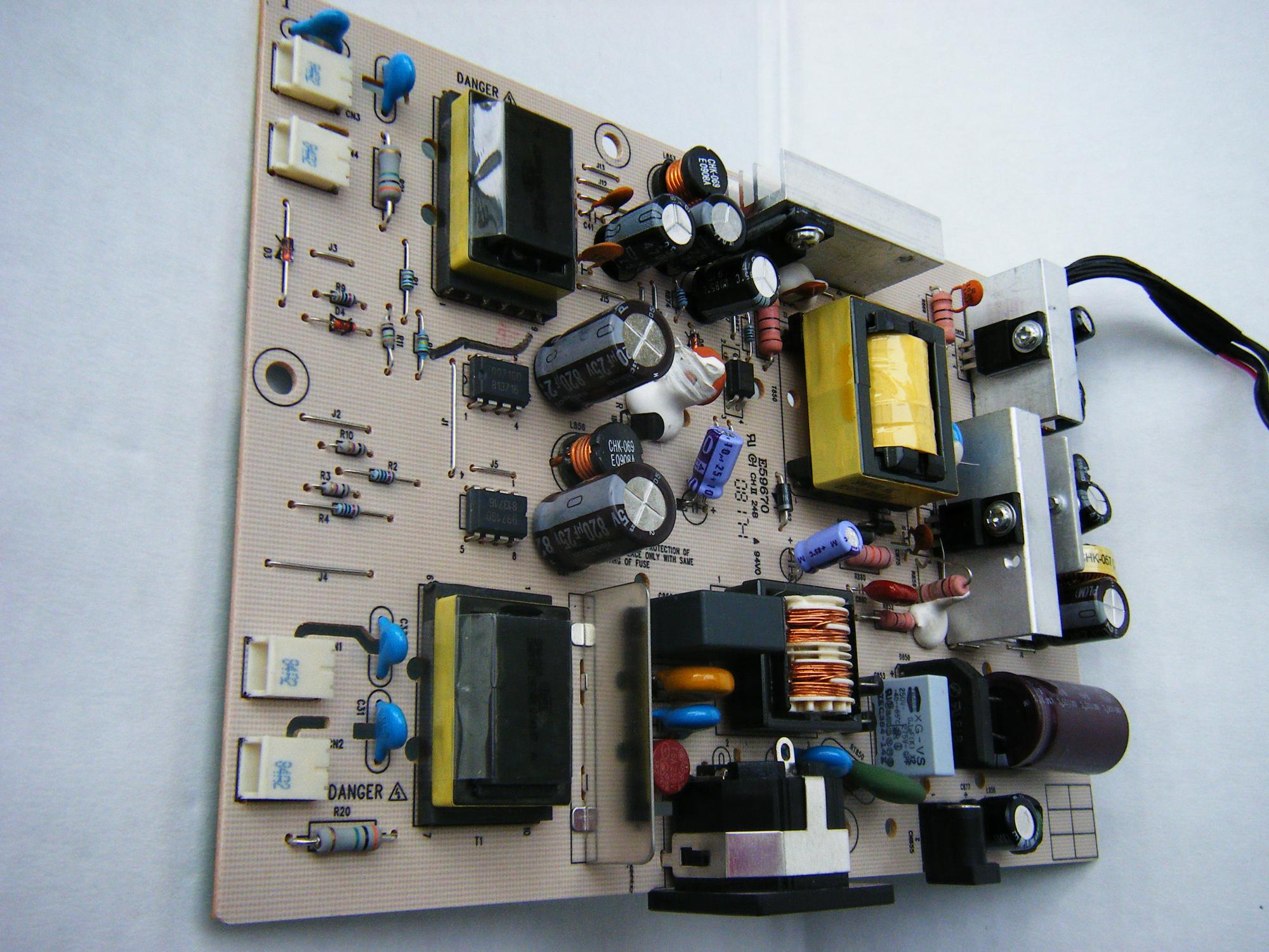

      Did you also try this with the monitors inverter, or better yet by hooking them to the inverter in another monitor? It appears that the voltage is not high enough to fully light them. I saw this when I was using an inverter with a much lower output voltage. If you got the same results, I would say the CCFLs are bad, the do have a pinkish tint.
      In the USA, CCFL Warehouse has the reputation for being a reliable source.
      PlainBill
      Hi PlainBill, thanks. You are right. The ccfls are still ok to work after testing by hooking them to another inverter, which can fully light them up. It appears that the old one cannot produce the voltage high enough. So do I need to upgrade the capacitor values? Like replacing 3 black 470uF ones to 820uF ? As it is the closest value that I have. Any suggestion, thanks.

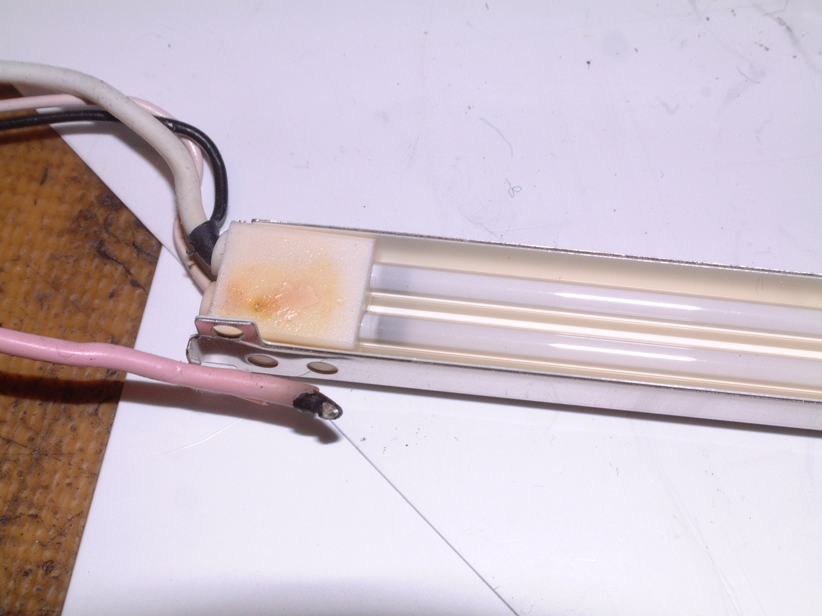

              Thanks. That helped--I hadn't thought of prying bezel from inside. A credit card sized mini scraper made it a breeze with no scratches or broken tabs. I slid the beveled edge between the screen and bezel and lifted straight up, working my way around the screen to the button corner.
              I got the backlight apart and found that a negative lead was indeed separated from one of the ccfl tubes. If that doesn't fix it, I'll check each ccfl with the resistor method.

                  Re: Dell SE198WFPf - Backlights go off after 2 seconds
                  Originally posted by budm
                  Can you clarify the "I'll check each ccfl with the resistor method." ? Thanks.
                  by the way, burnt out this bad?
                  I got idea from romansroad post but wasn't able to find the thread he mentioned.
                  Originally posted by romansroad
                  You can substitute a resistor for a backlight (search under this to see that thread). I would then sequentially go through the turn on steps with the resistor placed at each separate HV point. If the other ccfls stay on, then the one you faked out the PS board with the resistor is the bad ccfl.
                  No, not burnt at all. It just looked like it was a weak solder point that broke apart. I soldered it back and now it's working again.
                  This wasn't my monitor originally so I don't know if it was dropped or how else the wire could have separated so cleanly--especially packed so snugly in that end cap.
                    Here's a picture.
                    I had to slice the end cap in half to get it off. I was able to resolder the wire and get the silicone cap back on. Once I replaced the yellow tape that was around it and put the assembly back in the screen frame it was fairly secure.

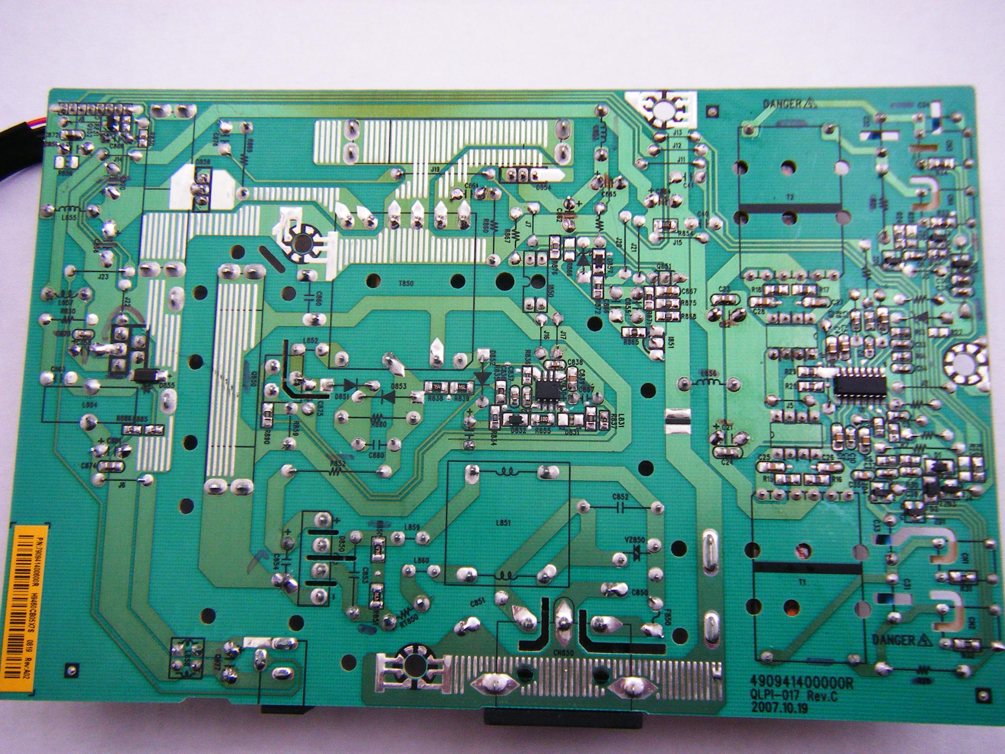

                      This thread came up for my search on a datasheet for a OZ9937GN. A 9937 is not the same as a OZ9938. I couldn't find a datasheet, but the brochure I've attached includes application notes with the pin-outs.
