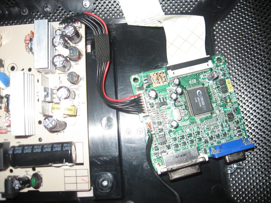

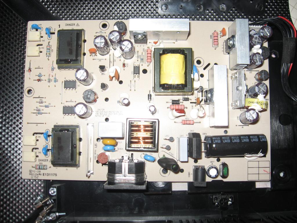

    Have a Dell SE198WFP 19" LCD Monitor. When turned on the back lights are on for about 2 seconds then they go off. There is still an image just no back lights. I've looked carefully over the power supply board (inverter board and ps board are integrated on this monitor), and i see absolutely no sign of bad caps, they all look great, no bulge at all or leakage. Could one still be bad without visible signs? I see many many posts elsewhere about people having the same problem with this monitor, but nobody ever posts if they find a solution.
    Oh and the monitor is not going into standby mode, the power light stays blue and like i said the image is still there, just no back lights.
    If anyone could clue me in i'd greatly appreciate it I can't even find any service info for the ps board that is in it.

      Well it would appear that the video board is doing its job, at least with the BLON. It works. It appears to be pin 4. When its off, no voltage, hit the power button, and no voltage until the backligh lights up, then it jumps to 3.33v and stays there but the bulbs don't stay lit up.
      Here is the voltage readings i got on the other pins.
      1 - 0.03
      2 - 0.0
      3 - 2.92
      4 - 3.33 BLON
      5 - 0.01
      6 - 0.01
      7 - 4.95

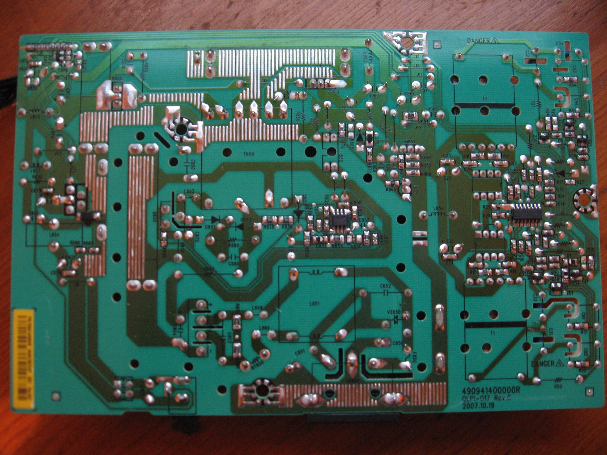

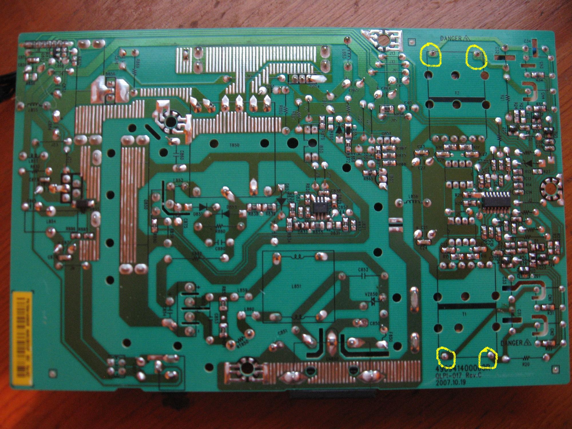

                    Another possible culprit is the CCFL controller. It's a 16-20 pin smd chip that's generally located under the power board. Please post a photo of the power board's backside. And what's the part number of the chip?
                      Re: Dell SE198WFPf - Backlights go off after 2 seconds
                      0Z9937GN is what it has for the ccfl controller, if you really want a pic i'll get it but its so small theres no way i could get a good pic of it.

                        Somewhere around retiredcaps has written an excellent tutorial on the causes of the 'two seconds to black' problem. I suggest locating it and reading it. Caps are first suspect; CCFLs and their wiring are second, transformer is third, one of the many components in the protection circuit could also be the cause.
                        Assisting in troubleshooting a problem like this is difficult because we depend on you to provide the hands and report the results of tests. Trying to do this without a good picture of both sides of the board is a waste of time. Note the links in my signature for directions on how to take good pictures.

                          so the CCFL controller is OZ9937GN
                            thank you for suggesting that tutorial, looks great will try it. I got a decent picture.

                                You can try what PlainBill suggested about the transformers. Try checking the secondaries of the inverter transformers, T1 and T2. With power off, take resistance readings across the points marked in yellow. They should be within 3% of each other.
                                Also, I can't locate the datasheet for the CCFL controller.
