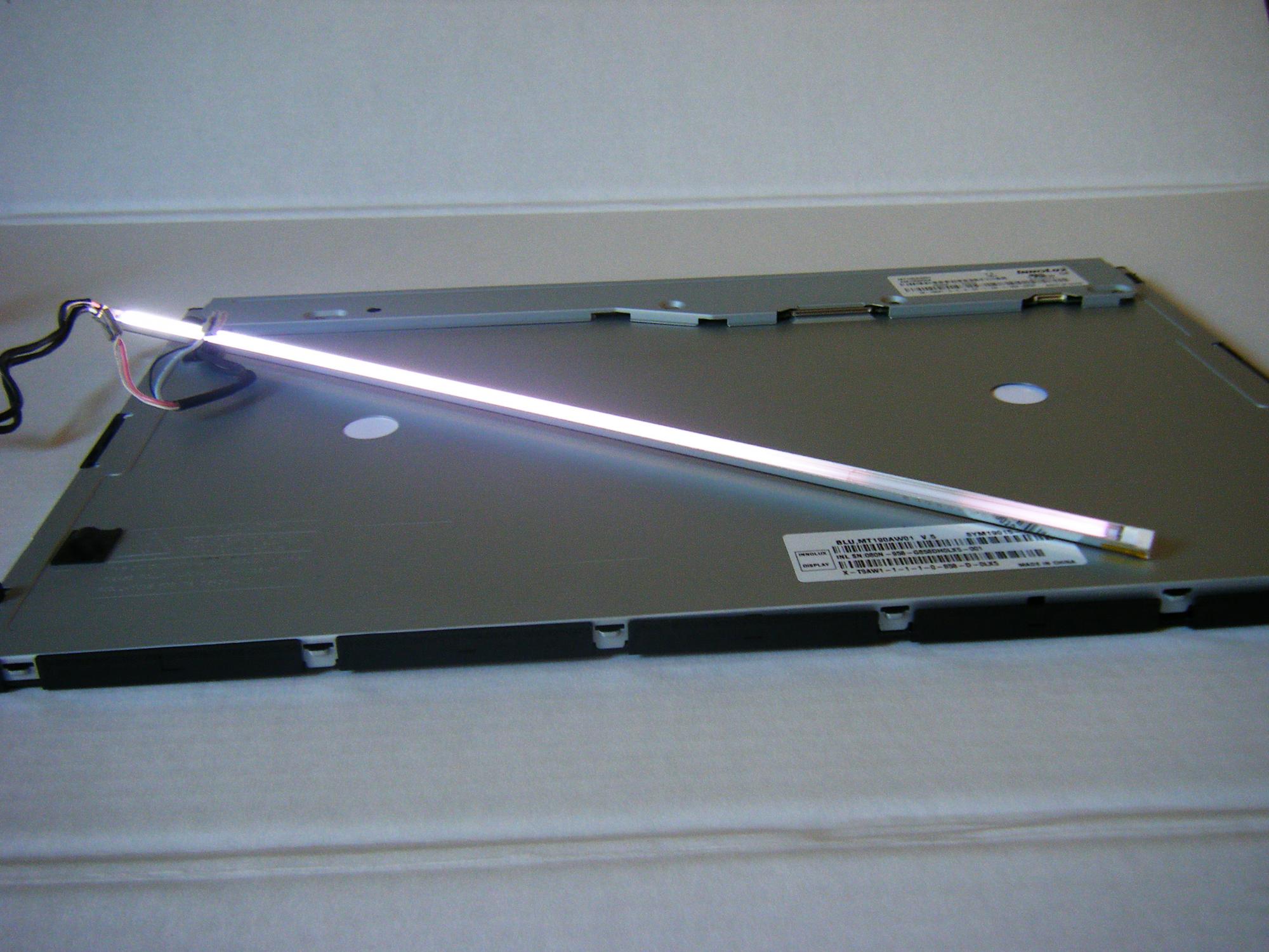

                                  I got the same model(SE198WFPf) Dell monitor and it has the same problem. The date of mfg is May 2008.
                                  But it looks weird.
                                  a) When set the brightness and the contrast to 50%, the backlight turns off after 1 or 2 seconds, but the power LED stays on, and u can see the shadow of the image.
                                  b) When set the brightness and the contrast to 100%, it can stay longer (about 30 minutes), then the backlight turns off.
                                  And have checked the power board and logic board, no sign of burn or bad-solder. Also checked all the caps and readings r ok. Then checked 4 CCFLs individually, all works fine, but not that even to spread onto the screen, the end side(opposite to the tube connector) is weak.
                                  Is that because the CCFL is getting old(but not dead yet), then the protection circuit shuts it off? Or the higher voltage power can activate the backlight much longer?
                                  Have no clue, any help would really appreciate.

                                    1. PLEASE, use standard English. Textese gives me a headache.
                                    2. Could you give me more detail on the highlighted sentence. Were the CCFLS connected to the monitor's inverter, or to a test inverter? If it was to the monitor's inverter, that indicates an output voltage problem. Were the CCFLs out of the LCD panel?
                                    Of course, pictures of YOUR power supply / inverter and of the partially lit CCFLs would be a big help. Attach using 'Manage Attachments' - below the text entry area.

                                      Hi PlainBill, thanks for the reply.
                                      I have taken the bottom ccfl out of the LCD panel, and tested these two tubes individually by a tester instead of the monitor's inverter. It can light up but begin to get red/pink, and part of the tube is dim. And when saw closely, found two ends have been burnt to black. No wonder the light spread unevenly on the screen in previous test. Right now, I'm pretty sure the ccfl is the culprit. But here comes to another question: Where can I get the right size CCFL? Cheers

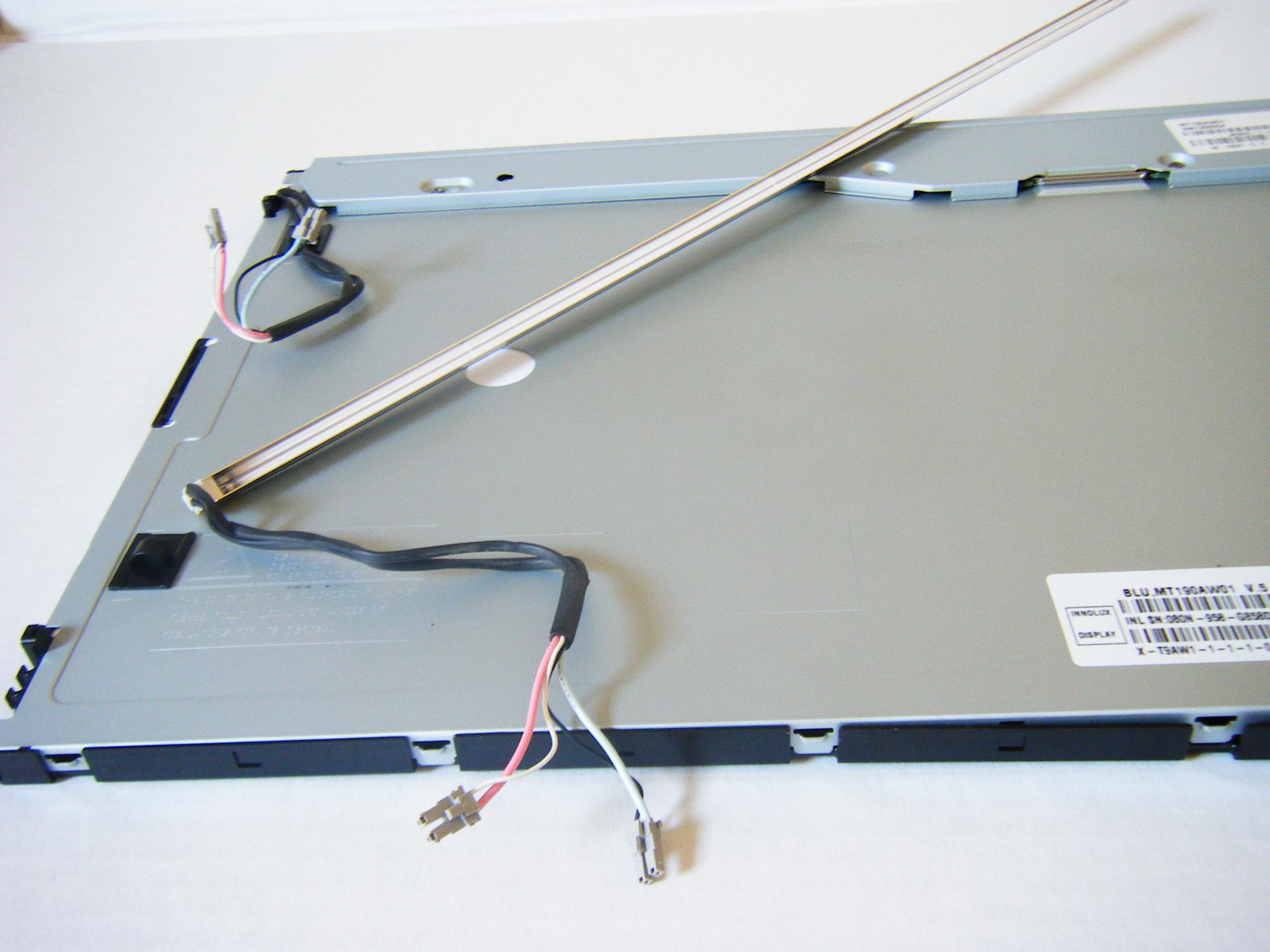

                                          Ok, I've now had 2 different Dell SE198WFP monitors with the same problem and I had to read numerous posts on numerous blogs looking for a solution before I actually figured it out, everything that I'd read suggested bad capacitors on the inverter board (and I'm sure that's an issue, but it wasn't mine). After replacing all of the caps on the inverter I still had the same problem.
                                          Long story short, I found (on both of my SE198WFP monitor's) that at least one of the four CCFL backlight tubes had a burnt wire on the end of it. Period.
                                          Now I'm not sure if this is a common problem with this monitor, but it was in fact the problem with both of mine, and after fixing these wires both monitors now work just fine :-) It seems that all four CCFL's have to pull the same amount of current or the monitor trips the overload and shuts down the inverter. I hope this helps!! And good hunting :-)
