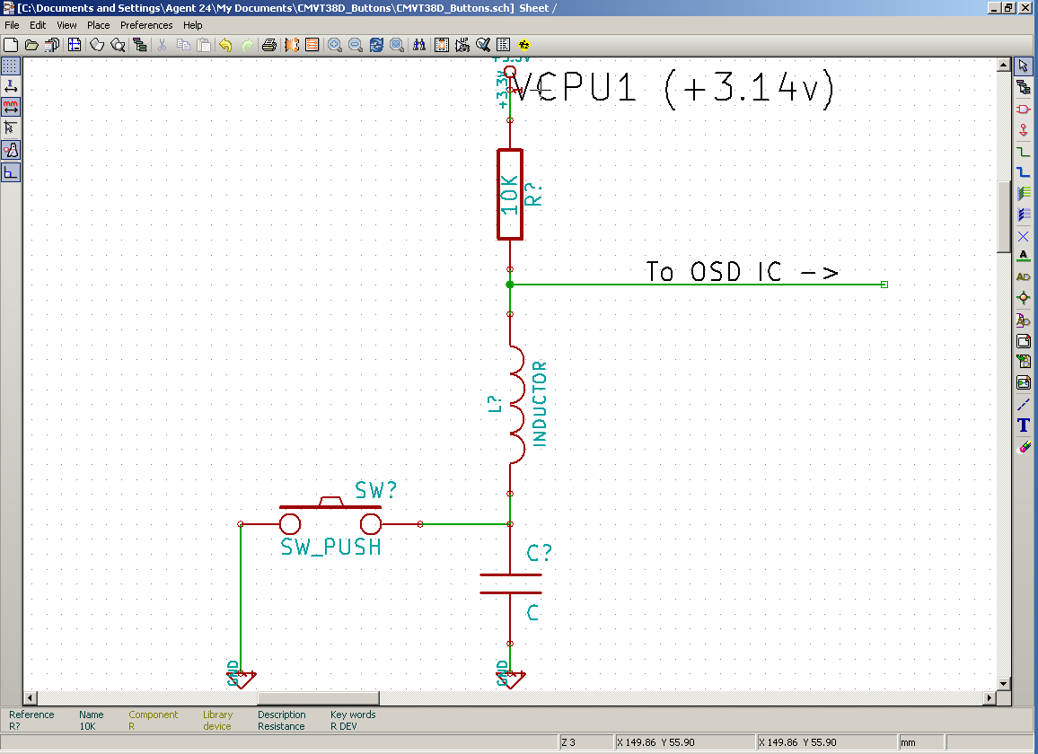

    So, I figured I might as well try to draw one myself (for the button circuitry - it is attached below)
    The schematic I have drawn is replicated for each button - each has this same circuit (but going to different pins on the OSD Controller IC, of course)
    Because there are 6 Buttons, Rx, Lx, and Cx are each made up from 2x 4-way arrays.

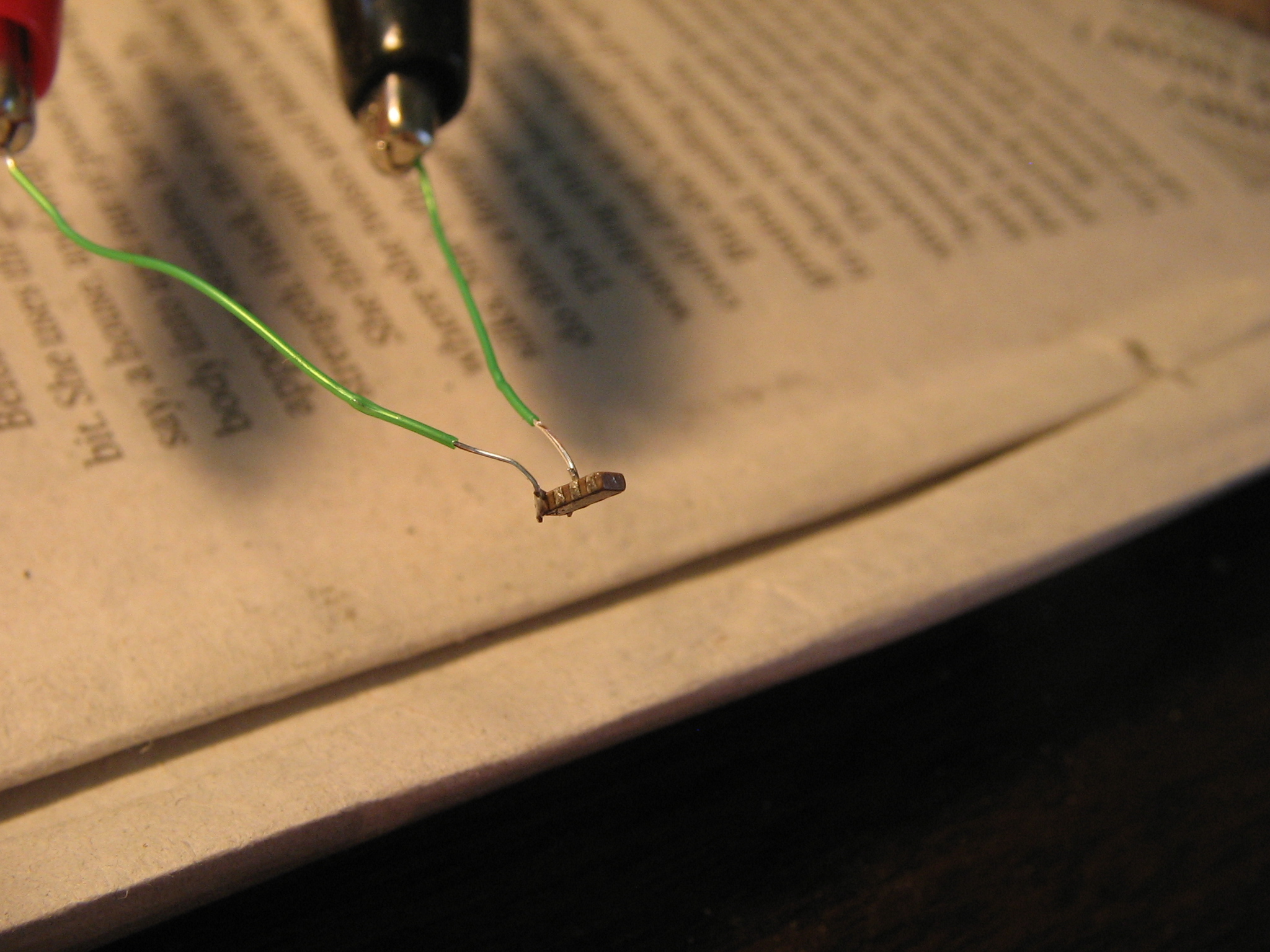

    While tracing the circuit I discovered that all resistors measured 10K Ohm (as they should have) except for the one related to the Auto Adjust button - it was a little low at 9.12k.
    Aha! I thought, well - it doesn't seem low enough to cause a problem, but I desoldered it and checked it anyway - 10k, no worries
    But why would it measure lower in-circuit?
    Back to the diagram. If i've drawn it and understand it correctly, only 3 other things could be the problem. The inductor, the capacitor or the IC. Assuming the IC is fine (because replacement is probably going to be impossible), the problem must lie with either the inductor, or the capacitor.
    The inductors all show less than 1 Ohm (taken in-circuit) (so they're probably not open-circuit? - but they may be short)
    The capacitors are more interesting (taken in-circuit):
    CP7 measures >2000k, 3.63k, >2000k, >2000k (relates to the Auto Adjust button!)
    CP8 measures (rises to) 120K, >2000k, 1.13k, (rises to) 120k
    I would have guessed all the capacitors should show infinity, so perhaps two of them are short, and two are leaky? I am just guessing there, though.
    I guess if they were, I would see issues with the other buttons though. But they all function (at least in activating the Auto Adjust feature) and they all show 3.1v instead of 0.86v for the Auto Adjust button.
    I know I should test them out of circuit but I don't really want to risk any damage as I don't know what I need to buy for replacements if that happened.
    But of course, if they are broken already, I still don't know what to buy
    Is there anything more I can do now?

      Congratulations on a good job of analzsing the problem. It's a welcome change from the "my neighbor replaced a capacitor on his monitor and fixed it, what capacitor should I replace on my monitor" question we deal with all the time.
      Out of respect for the effort YOU put in, I did a little research and checked the schematics for several monitors. I hit paydirt on the schematic for a Belinea 101910 monitor. It has the identical circuit, and calls for 0.1uF, 25V chip capacitors in the 0603 package. As an example, they are available from Digikey as catalog number 490-1575-1-ND, part number GRM188F51E104ZA01D. However, you can't order just 1, you have to buy 10 at $0.018 each.

          Wow! Thank you very much for that, PlainBill
          Now at least I know what I need to get - but it doesn't look like it will be easy
          The Belinea monitor uses a separate capacitor for each button, whereas my Chimei uses 2x 4-way capacitor arrays in a 1206 size package.
          Neither Farnell or RS-Components appear to sell these (not in 1206 size, anyway)
          I suppose I could use four single capacitors, but in that case I think I'll need a bit more practice before I attempt it...

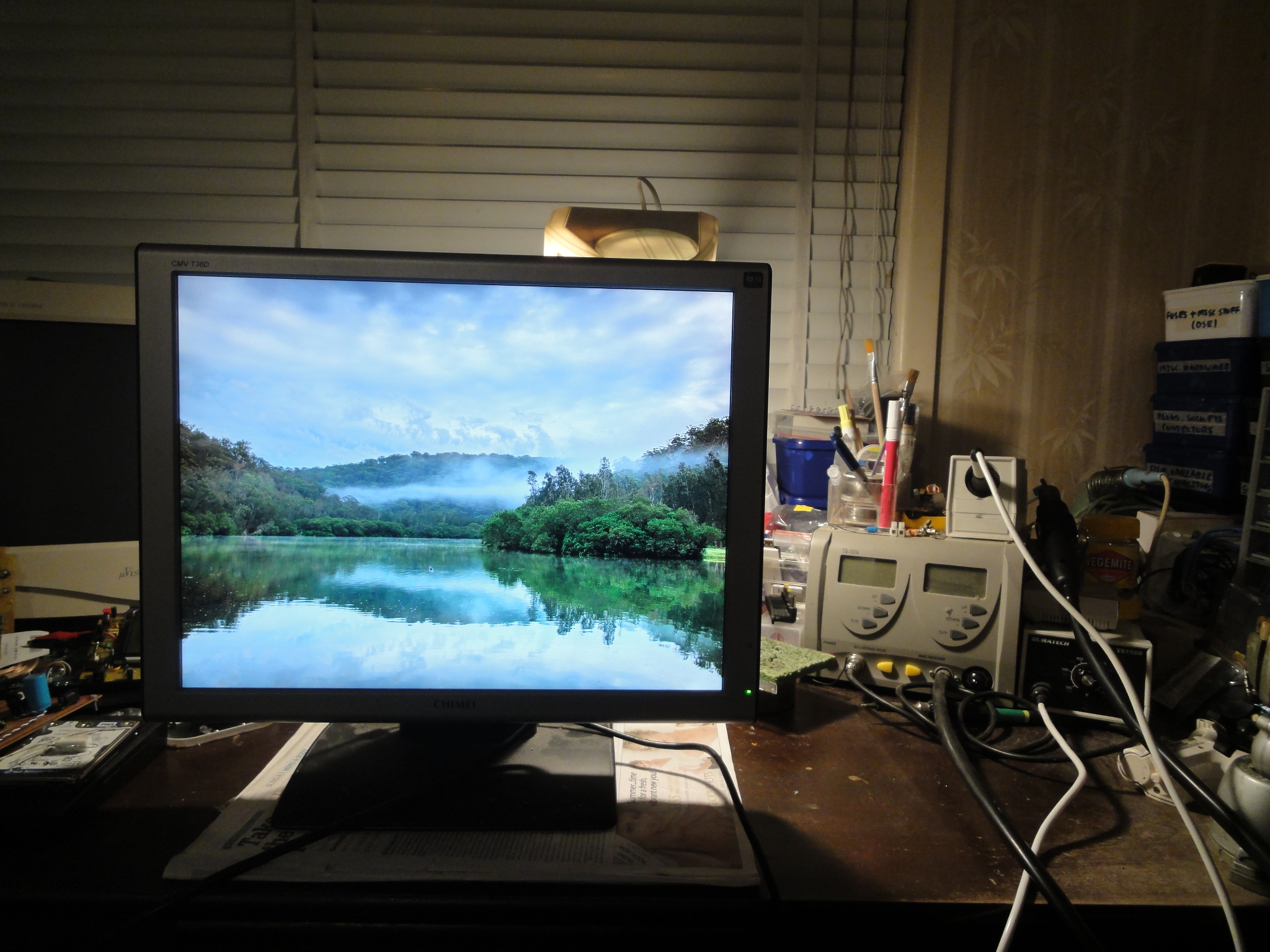

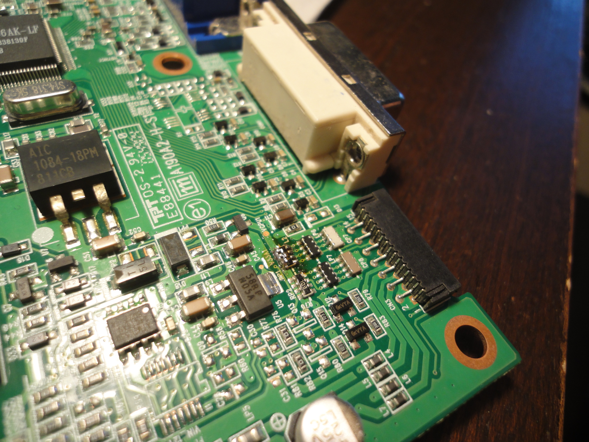

                        Looks like another thread I never finished... well, for anyone still tuned in, here's the end of the story – be prepared for some reading!:
                        Before I could get the new capacitor array, the thing died completely. I was using it and it just shut off, and wouldn't come back on again. Doubting the repair to be cost-effective and my own skills at SMD soldering at the time (It had been hard enough putting the resistor array back with the iron I had then) I put it aside and forgot about it. Then recently, I decided to tackle it again.
                        Firstly, I wasn't convinced that the capacitor array I had ordered originally was correct, as I had never had a schematic. I searched the logic board model number and came up with a Viewsonic service manual that had the exact same board. The capacitor arrays were specified as 100pF, not 0.1uF as was originally guessed.
                        I ordered the correct ones (third time's the charm!) from Farnell with my next order, figuring they were cheap so no loss if I couldn't repair the no-power fault, and then took a look at what had caused the total shutdown.

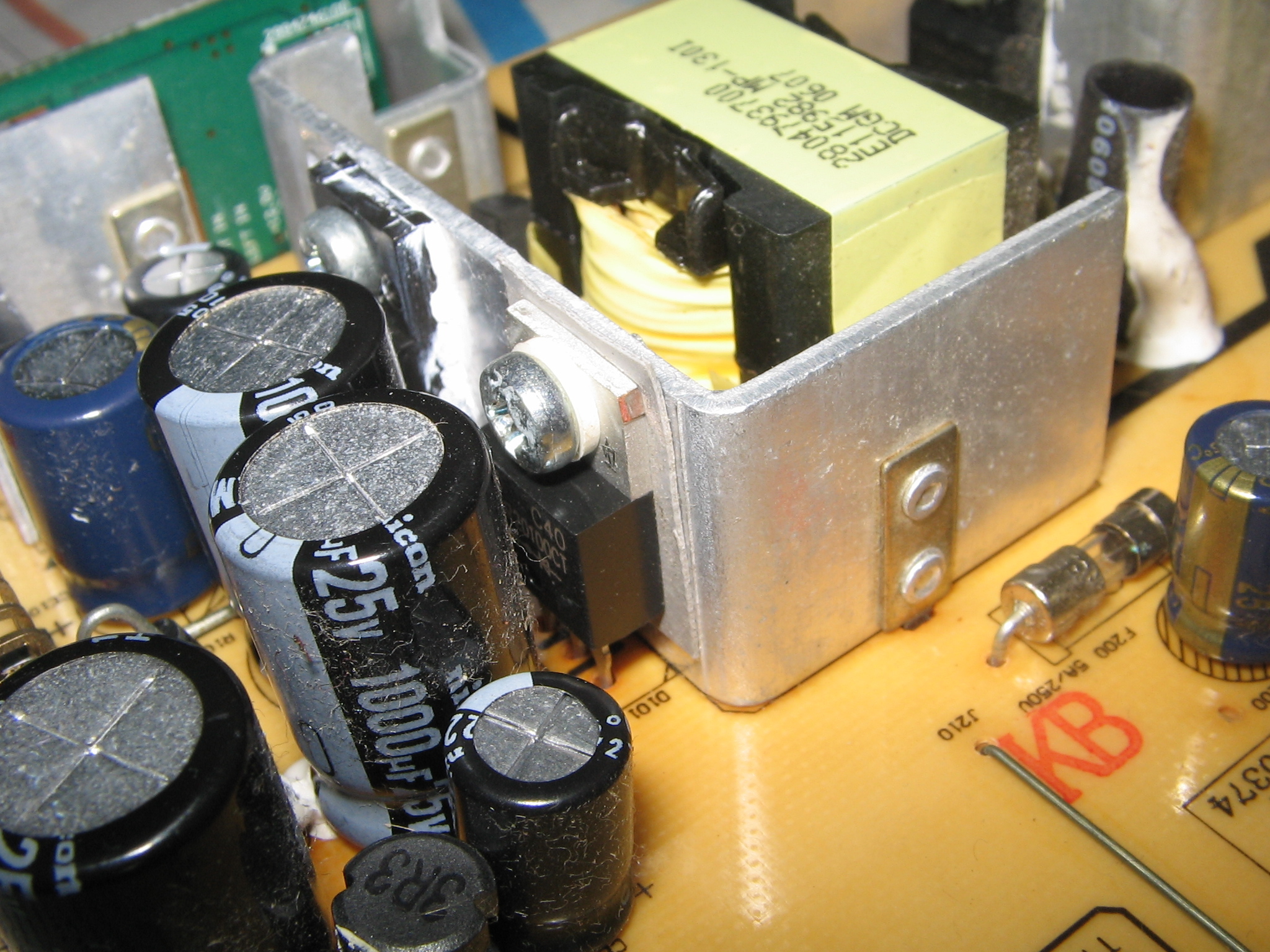

                        I started by measuring the voltages from the PSU, which is supposed to supply 12v and 5v to the logic board. The 12v rail was there, but to my surprise, the 5v rail was bouncing up and down around 2.4v!
                        I tried with the panel disconnected “just in case” but the symptoms did not change. At least I knew the panel was probably OK.
                        I thought something might have shorted on the logic board, but nothing was hot, and a resistance test across the 5v rail on the logic board showed nothing untoward, so I decided to take a look at the PSU instead.
                        I tried it without a load, and got fluctuating voltages on both rails and ticking, but I didn't much notice of that since a previously repaired LCD monitor PSU also power-cycled without a load. I then cobbled together some power resistors and hooked them up for a dummy load, and got even less power out of the thing than I had before.
                        As a last test, I hooked the logic board up to an ATX PSU and fired it up – and the power LED shone bright green!

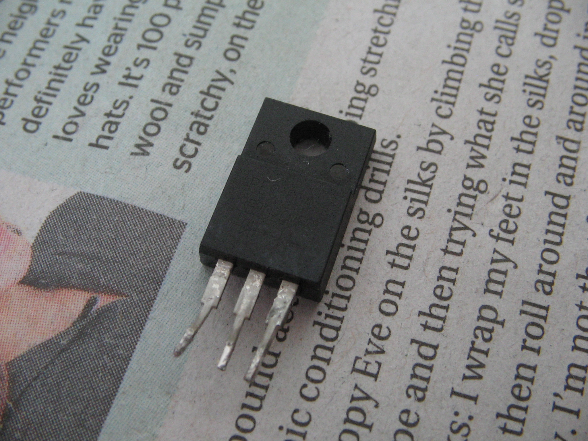

                        So, the PSU was looking like the problem. I wasn't sure where to look first, but I figured that to get anything out of it, the primary side had to be OK, so I looked on the secondary first. There were a couple of fuses and both tested fine. Then I went for the rectifier diodes as they were the next easiest thing to check and struck gold – the rectifier for the inverter's power rail had one side dead shorted!
                        The rectifier was an SB20200FCT; a 20A, 200v unit with plastic body. I found Jaycar sold MBR20100CTs for $2.80, which seemed like a good choice, aside from the non-insulated body, but that was OK as I have enough insulating pads and washers pinched from old crappy PC PSUs
                        The 100v rating was questionable at half that of the original rectifier but I figure there is no way I was going to need more than, say, 50v for an inverter so it's probably OK. In any case, they probably used that part for lower power dissipation with the plastic body. If anyone knows different though, let me know and I'll change it!

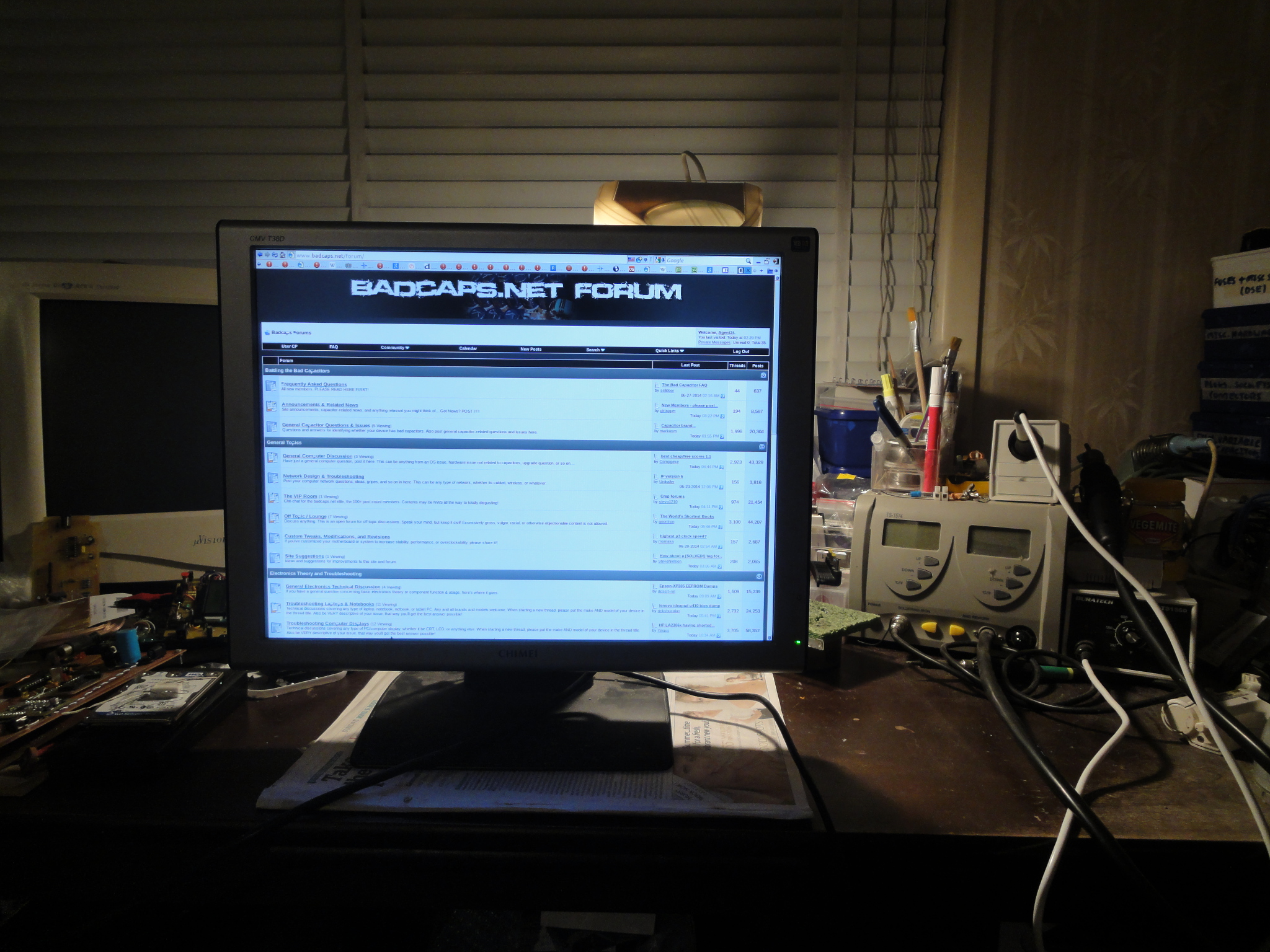

                        I installed the new rectifier, and initially powered up the PSU by itself in case there was some other fault, to avoid blowing up anything else. All rails came up, 5v steady this time, and the new rectifier supplying 20v to the inverter section.

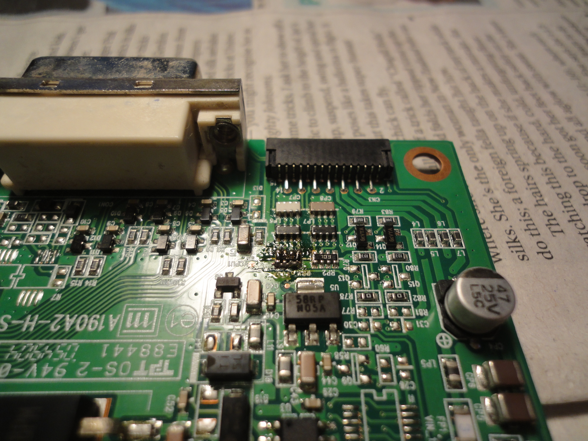

                        With the PSU issue out of the way, next up was the capacitor array. As previously found, one of the capacitors in this array was shorted or leaky or breaking down under load.
                        At the time, there was also the problem of my bad SMT soldering skills and equipment or lack thereof. However, now I have a hot air rework station plus a decent set of tips on a temperature-controlled soldering station and have had practice since then. At least with single components and the soldering iron.
                        But, I had tried arrays with the iron before and still had hard-to-deal-with bridges, so after watching this video: (https://www.youtube.com/watch?v=IgrEbJN8dcQ) I pulled out an old junk motherboard and had some more practice by removing resistor arrays and other SMDs and reinstalling them with the hot air and solder paste.
                        I still need a better solution to dispensing the paste, but I managed to get by with tweezers and a bit of dicking around... When I was convinced that I could do it, it was time for the real thing. The old capacitor array came off cleanly with the hot air and then I cleaned up the pads with the iron and solder wick.
                        After taking care to put a uniform but thin amount of paste on the pads (you really need a lot less solder on these arrays than with bigger parts) I brought the hot air in on slow speed, and reflowed the solder perfectly See the attached photo. (The new array is the white one) Also note the quality of the solder compared to my original job with a too-big iron!

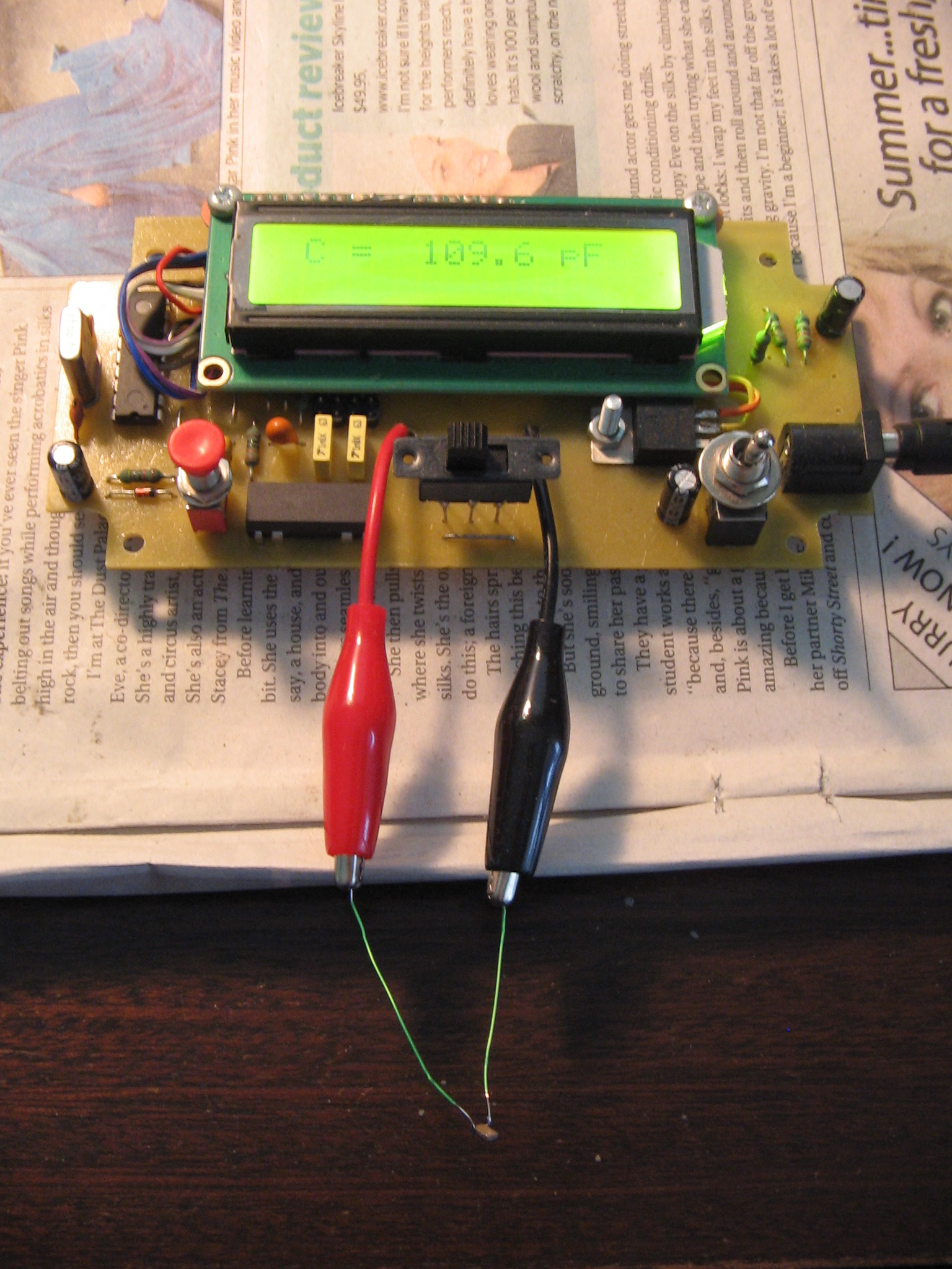

                        But, “does it work?”, I hear you say – well, let the accompanying photos speak for themselves.
                        (And in case you were wondering, yes, the capacitor array was indeed 100pF – also see my method for dealing with measuring the damn thing!)
