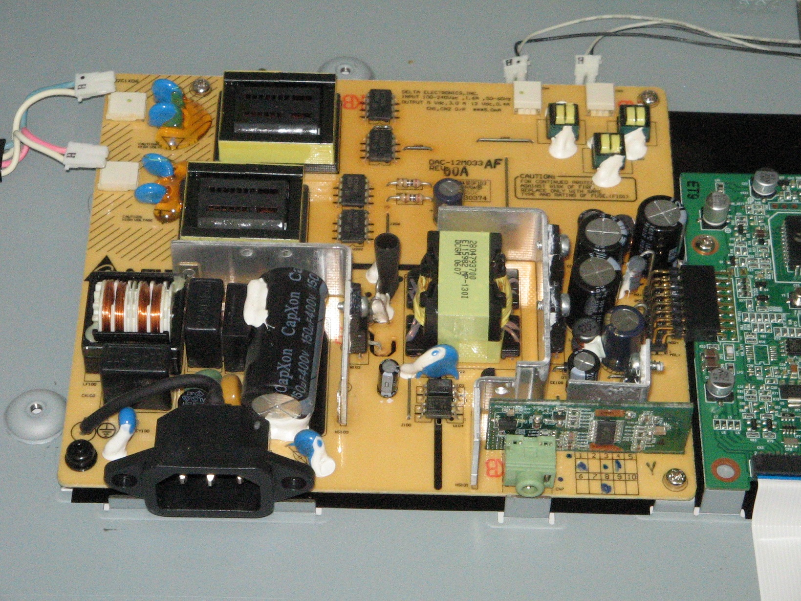

      Photos would help. What brand/series of caps did you use for the initial recap?

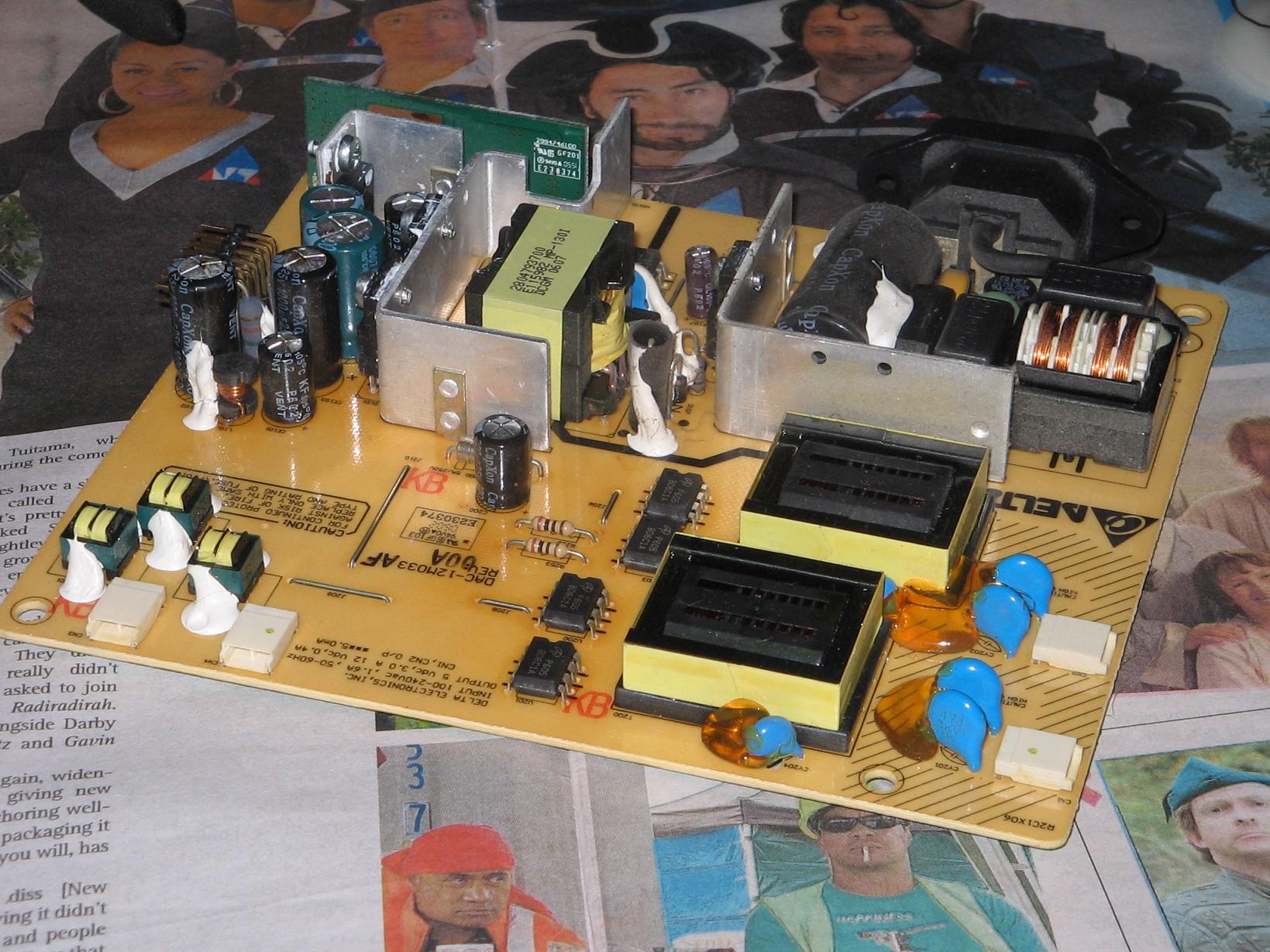

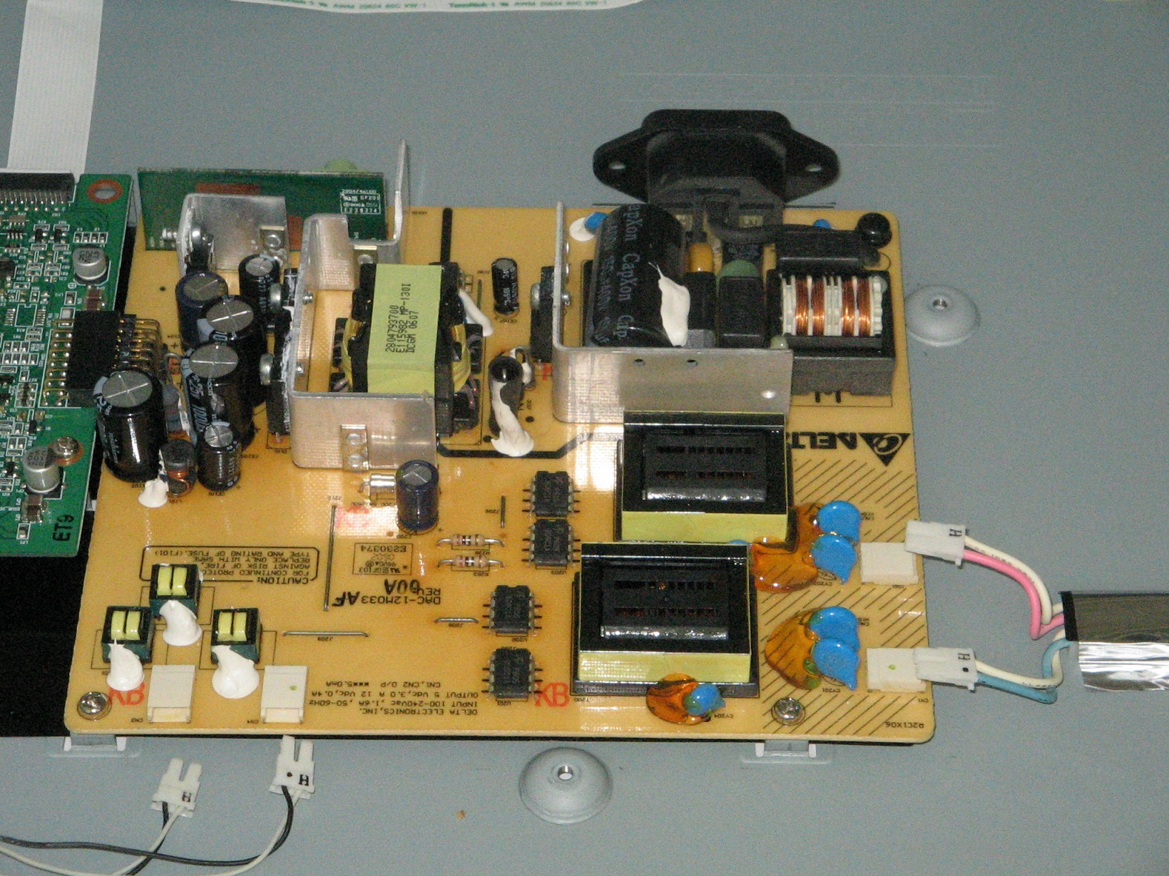

        Here's a picture of the PSU I took before I replaced the capacitors. I'll get some more photos later.
        I replaced them all with Panasonic FM and Nichicon HE except the little brown one which was Rubycon YXF I think.
        It's weird, because other than the button problem, the monitor still works perfectly.
        -David VanHorn

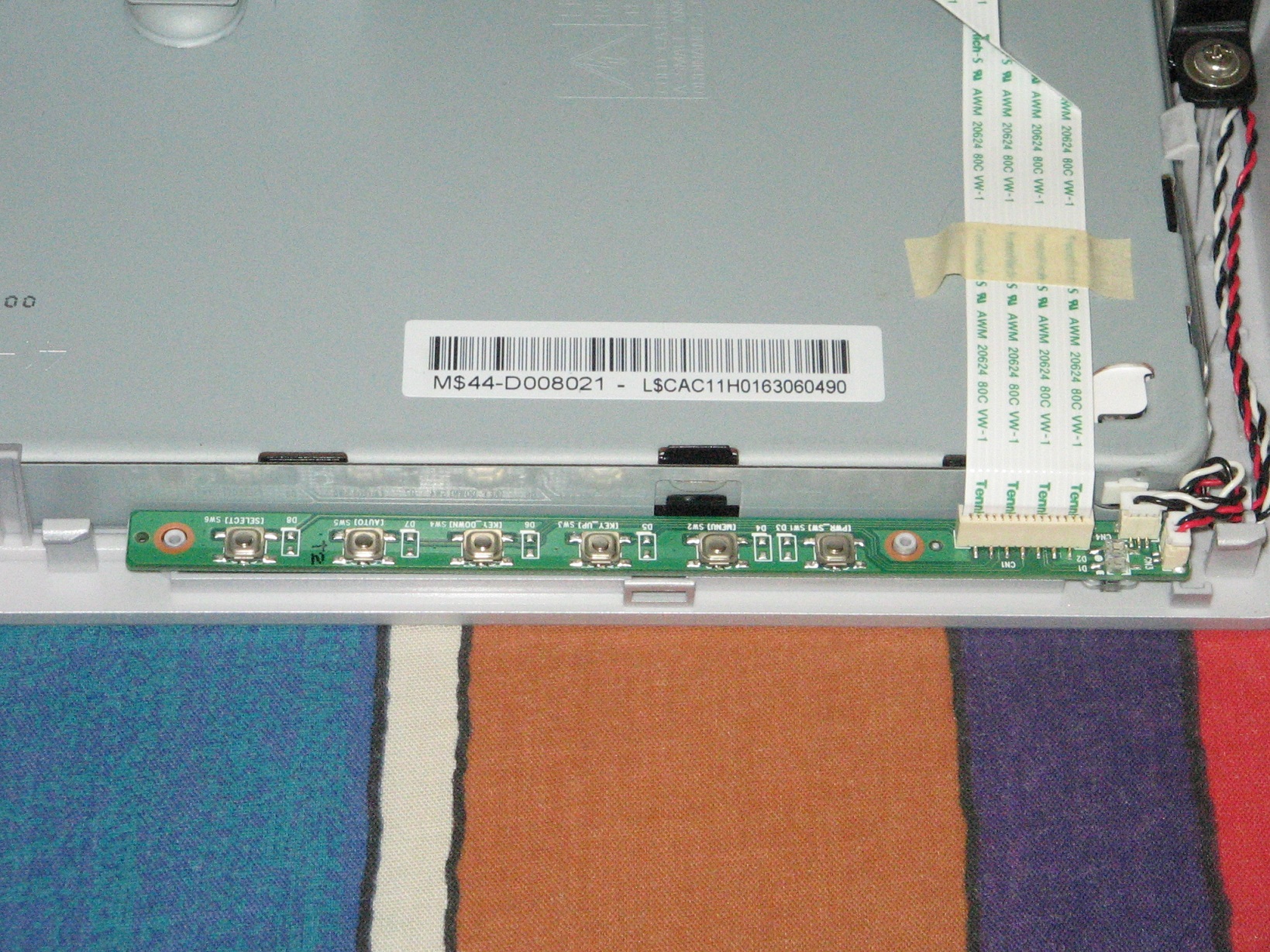

            1) Is the pushbutton board the standard push switch type or the capacitive charge type (picture would help)?
            2) Have you examinined the pushbutton board and made sure there are no bad solder joints or shorts between the pins?
            3) Try checking the switch (assuming it's the standard mechanical pushbutton switch) with your DMM for the "auto" button. Maybe it or another switch is stuck in the closed position.

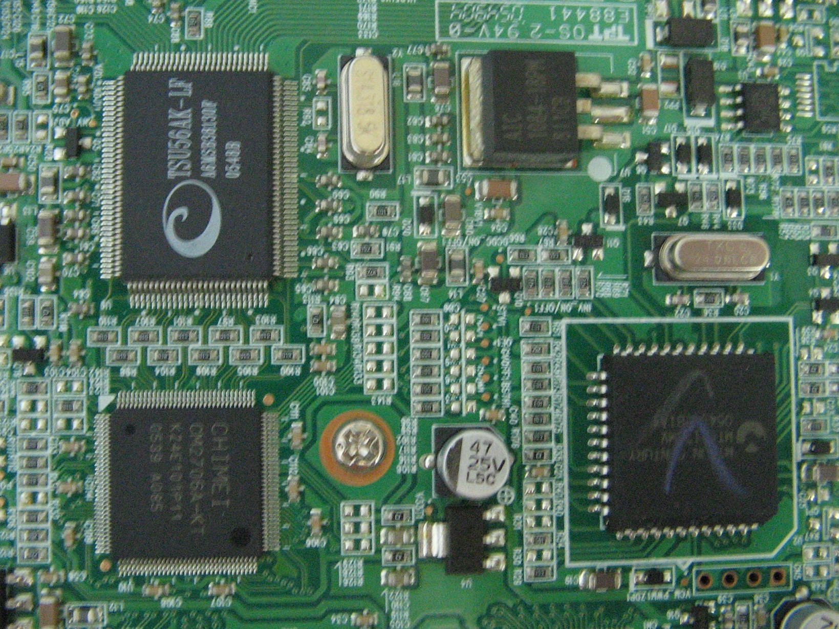

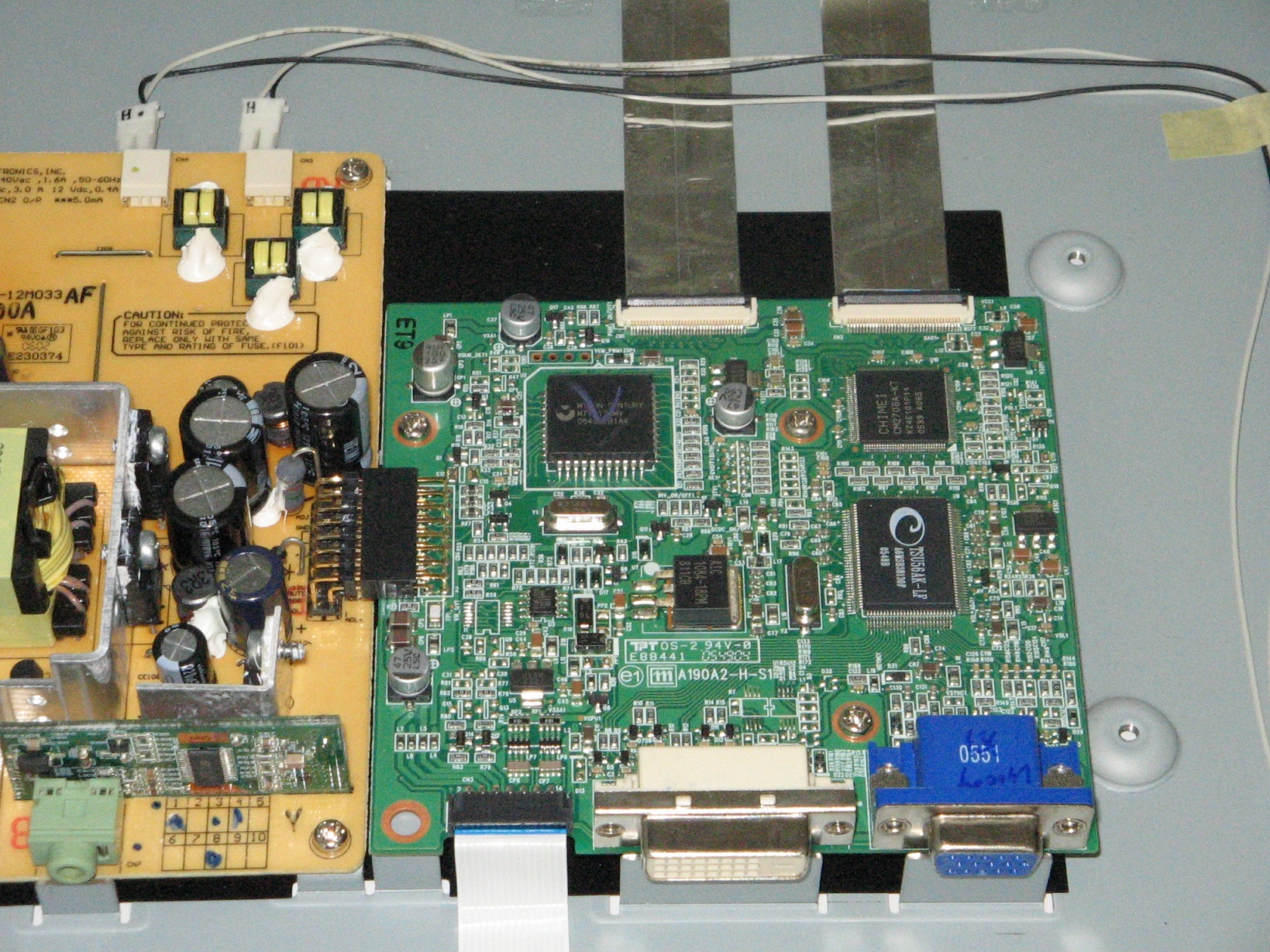

            4) Photo of the logic board would be good. Probably wouldn't hurt to check the voltage regulators on the logic board.

              Re: CHIMEI CMV T38D - Buttons stopped working
              This is what I did with the capacitors:
              C200 - 25v 220uF CAPXON KF -> Panasonic FC 25V 220uF
              CE101 - 25v 220uF CAPXON KF -> Nichicon HE 25V 220uF
              CE102 - 25V 1000uF CAPXON KF -> Nichicon HE 25V 1000uF
              CE103 - 25V 1000uF CAPXON KF -> Nichicon HE 25V 1000uF
              CE104 - 10v 1000uF TAICON PW -> Panasonic FC 10V 1000uF
              CE105 - 10v 2200uF TAICON PW -> Nichicon HE 10V 2200uF
              CE107 - 50v 22uf CAPXON GL -> Rubycon YXF 50V 22uF
              CE108 - 25v 220uF CAPXON KF -> Nichicon HE 25V 220uF
              I used Panasonic FC for C200 rather than Nichicon HE as with CE101\CE108 because I had it left over, rather than any particular reason.

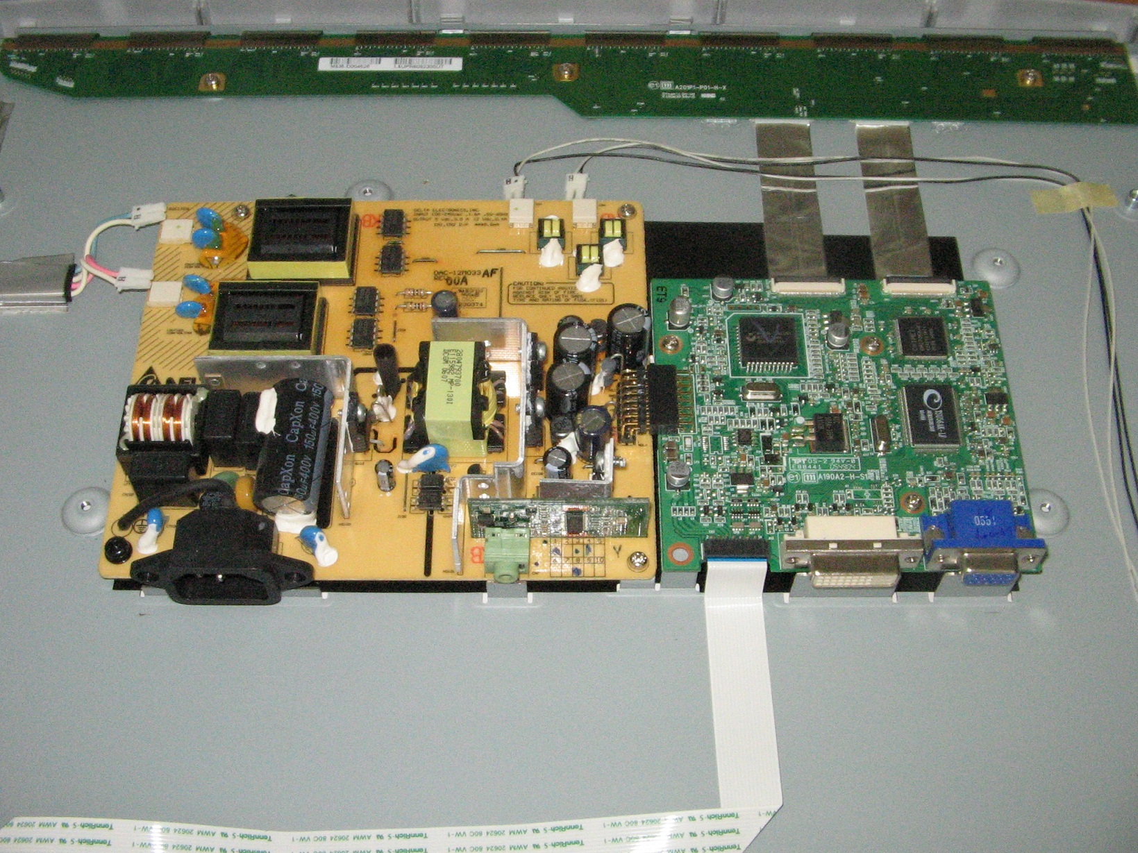

              jetadm123, here are the answers to your questions:
              1) Buttons are normal pushbutton types.
              2) Soldering is perfect, and they have worked perfectly previously
              3) DMM check shows all buttons to be working.

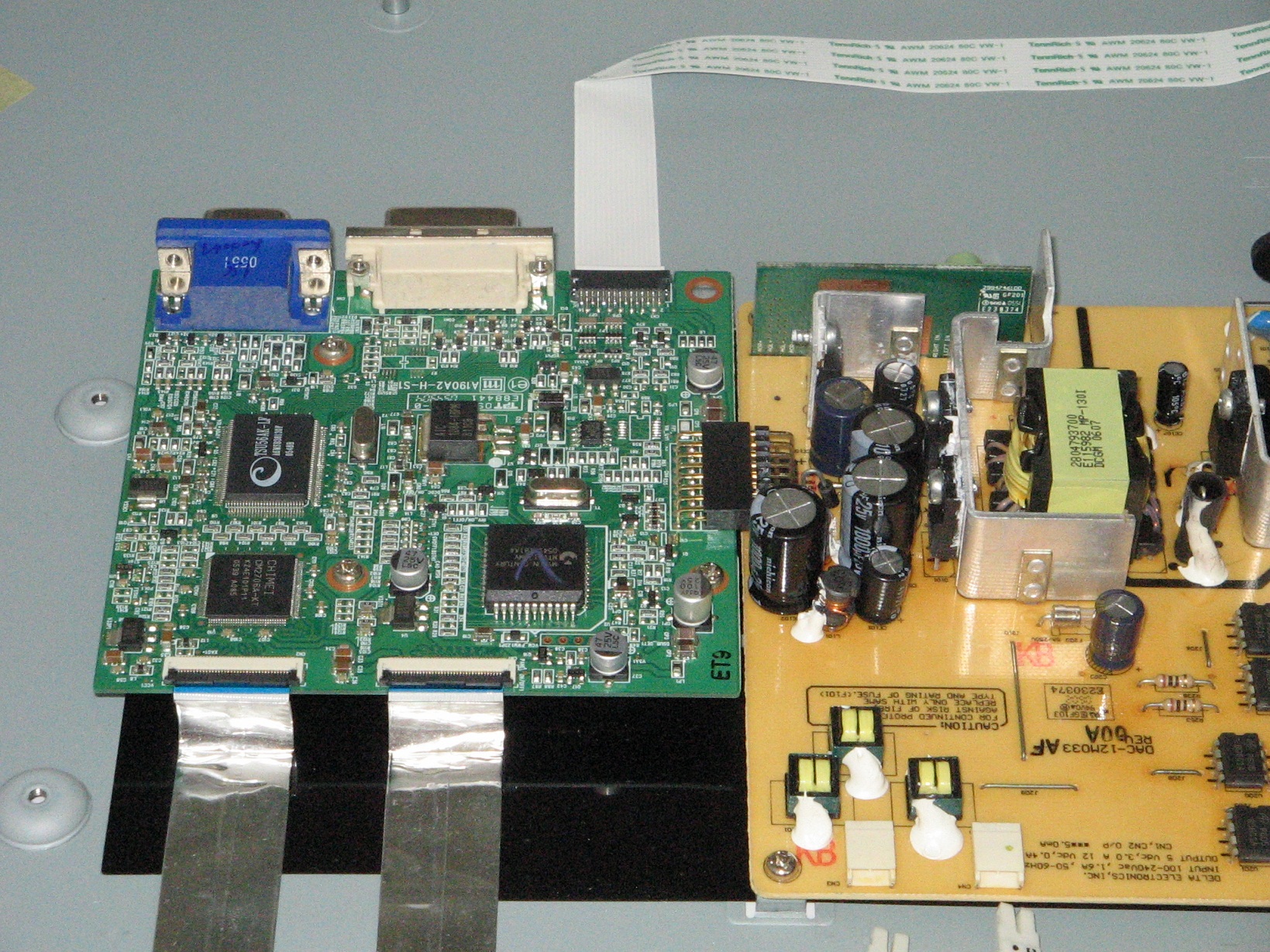

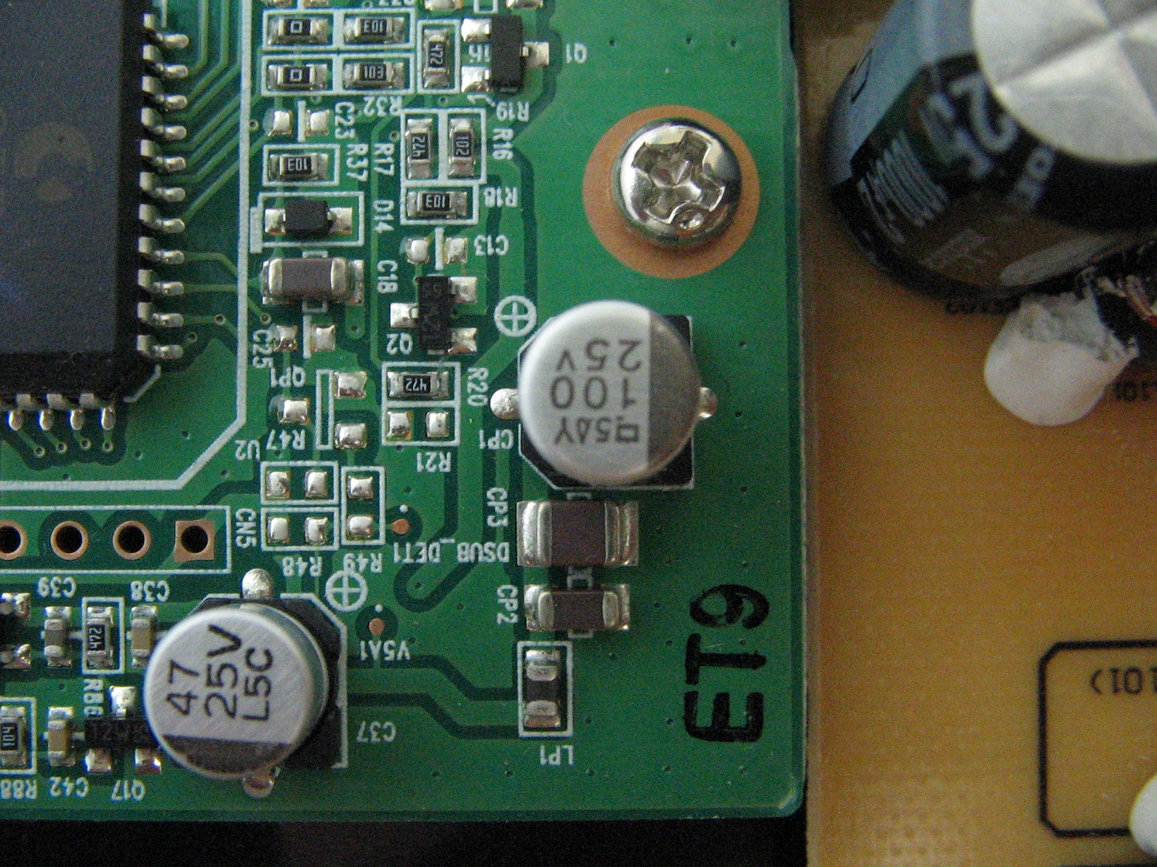

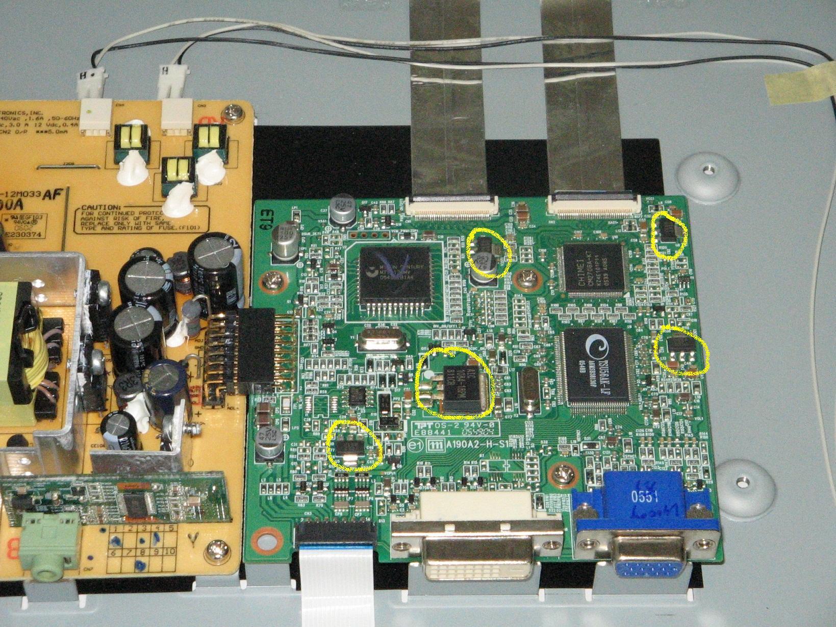

              4) Photos are attached as promised. What am I looking for RE: voltage regulators?
              There are Four SMD capacitors (electrolytic or polymer, I don't know) on the logic board. The last photo shows two values. One is 100uF 25v, the other 3 are all the other value, 47uF 25v. I do not know the brand or series. Should I replace these as well?

                          My guess is that the power supply is good, since you're getting the 12V to drive the inverter section. 5V is probably good and we'll verify this by having you check the voltage regulator(s) output on the logic board. I've marked in the photo what I believe are the regulators (I can't read some of the part numbers). The large one is a 1.8V? 5A regulator. I can't read the part # on the smaller ones, but they're typically marked 1117.
                          I do agree with you that the problem lies between the push button board and the logic board.
                            The four smaller ICs are marked:
                            58RP
                            N05A
                            The one in the middle:
                            AIC
                            1084-18PM
                            811CB
                            -David VanHorn
                              58RP
                              N05A
                              AIC
                              1084-18PM
                              811CB
                              Not sure what the 58RP's are.
                              Try measuring the output of the 1084-18. I'm assuming that 18 is 1.8V. Use datasheet below for pin config.
                              • Agent24
                                I see dead caps
                                • Oct 2007
                                • 4978
                                • New Zealand
                                For the 1084-18 (U7) I measured 4.39v on VIN and 1.80v on VOUT.
                                The others are indeed 1117's. LM1117MPX-3.3 corresponds to N05A in the datasheet.
                                Measurements are:
                                U4: VIN 4.96v VOUT 3.29v
                                U5: VIN 4.96v VOUT 3.29v
                                U6: VIN 4.95v VOUT 3.29v
                                U8: VIN 4.97v VOUT 3.29v
                                That all seems to be OK I guess - Though maybe the input of U7 is a little low?
                                -David VanHorn
                                  Measurements are:
                                  Output voltages look good. Have you tried taking voltage readings on the pushbutton board? Say, if you press one button, does the output voltage appear on any of the other push button outputs?
                                  Also, do we know that the ribbon cable connecting the logic and pushbutton is not internally shorted?

                                    There doesn't seem to be any 'output' from the buttons (or I don't understand properly) One side connects to its own unique track and the other side goes to ground.
                                    I measured 3.1v across all buttons except the Auto button, which measures 0.86v.
                                    A ribbon cable doesn't seem to be the kind of thing that would short out internally to me. I'll check it after dinner though...
