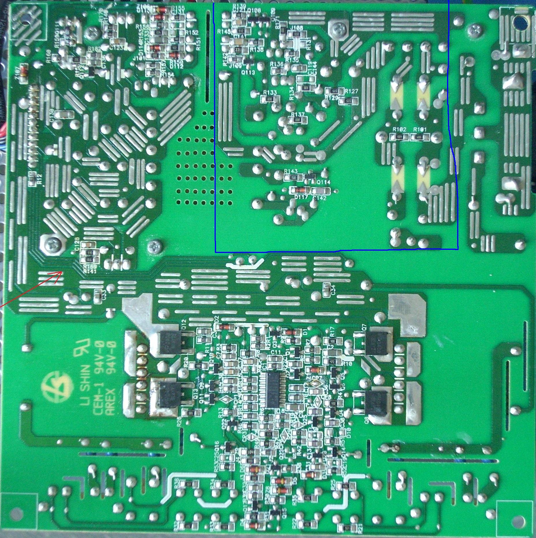

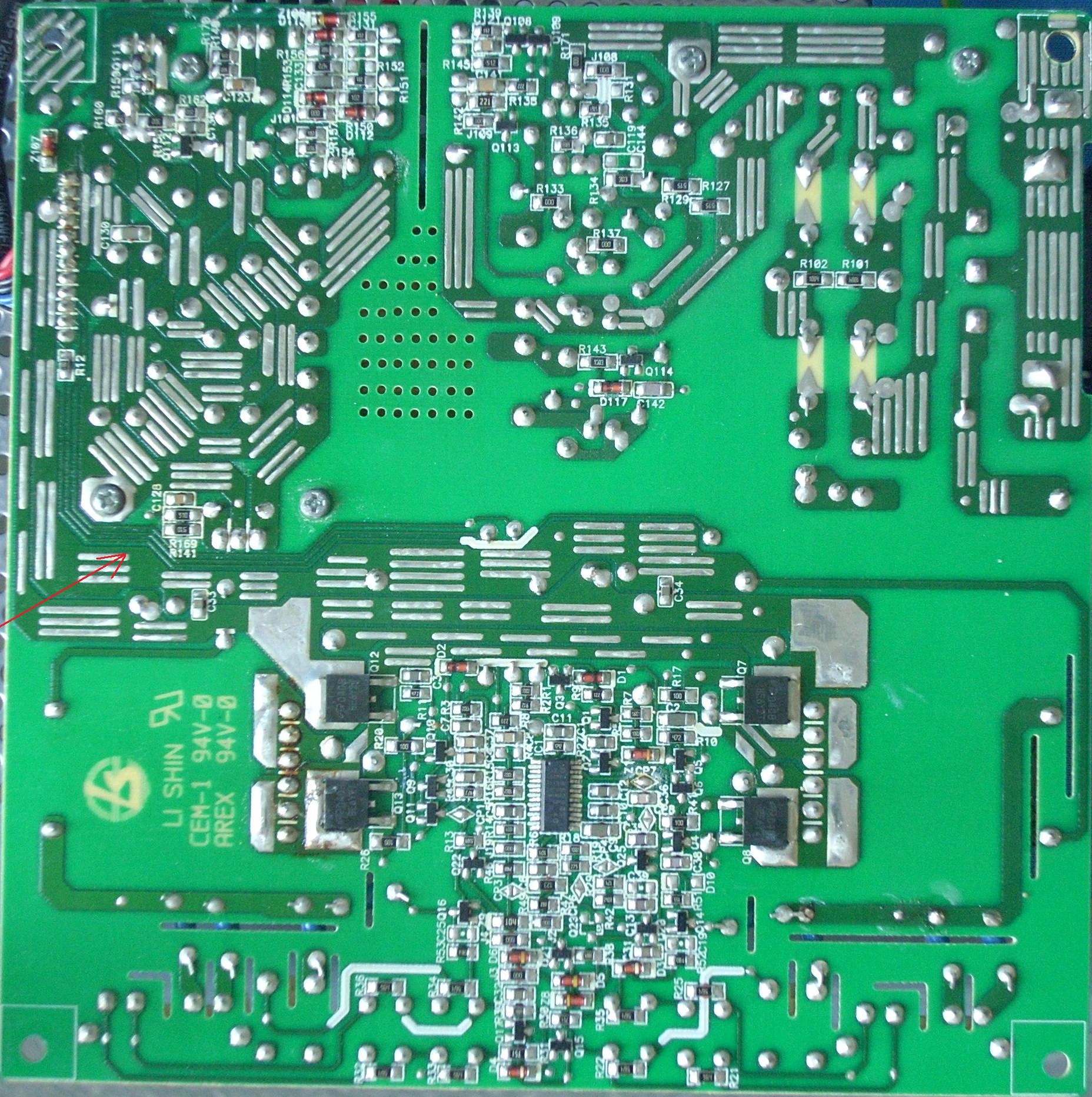

    Symptom/Problem
    When it first arrived, the monitor works fine with signal connected. Power led on, Backlight on with a touch of the on/off switch. After around 40-50 min or when it goes to standby, it will automatically shut down. No Power led on. Once it shutdown, I cannot turn-it on even after pressing the on/off switch many times. I will need to unplug it for a XX minutes (the timing gets longer as you do it again and again) & once re-plug it will then be able to works fine as normal. If I press the on/off switch to turn it off manually, it will behave the same way as above also (i.e cannot turn on & No power led light up). If I disconnect it from the pc (i.e Without any video signal), the ‘check video signal' box will appear BUT not moving. It will stay there until it goes to sleep mode & it will automatically shut down as above. Hope I am clear in my description
    What's been done :

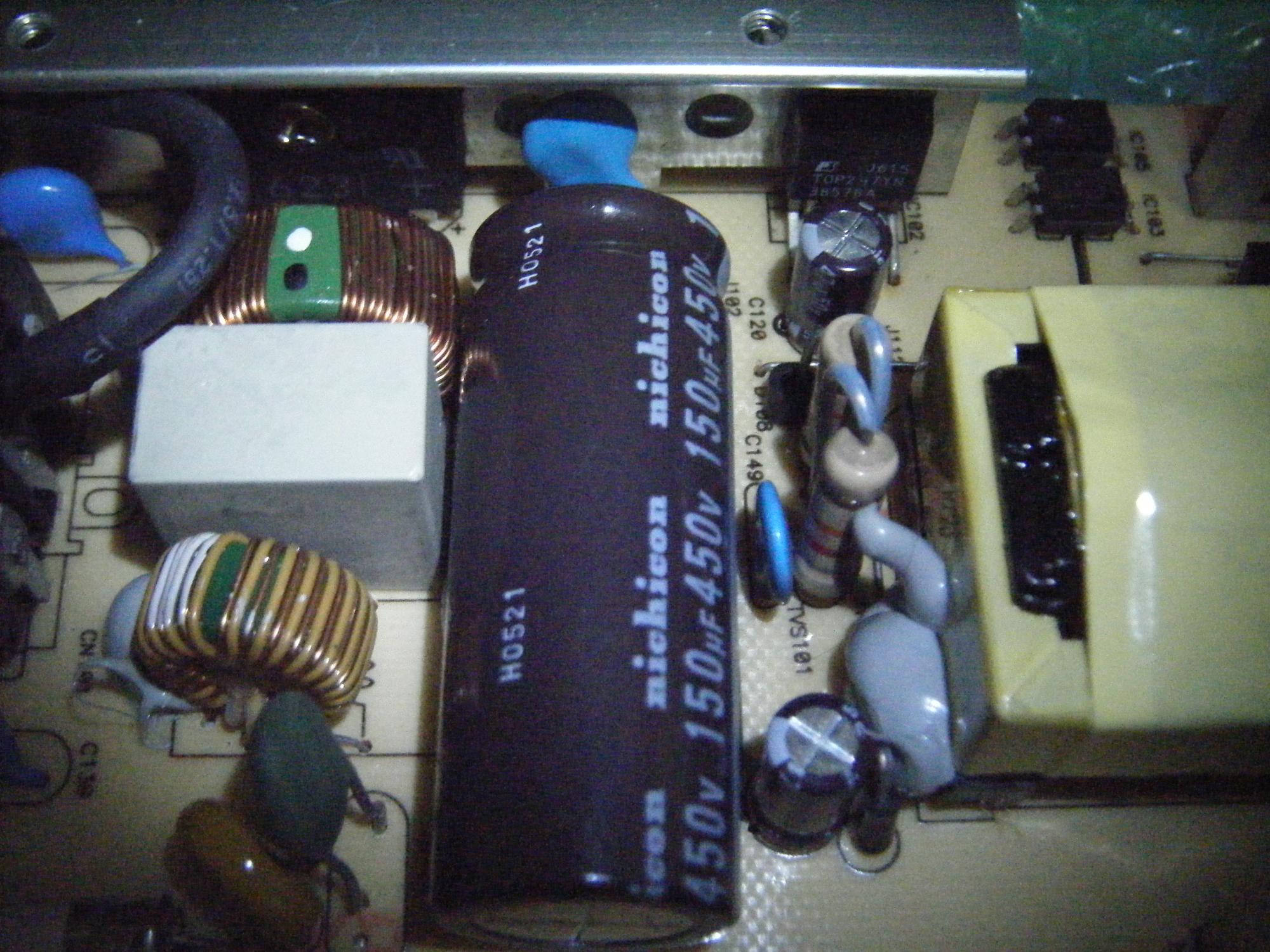

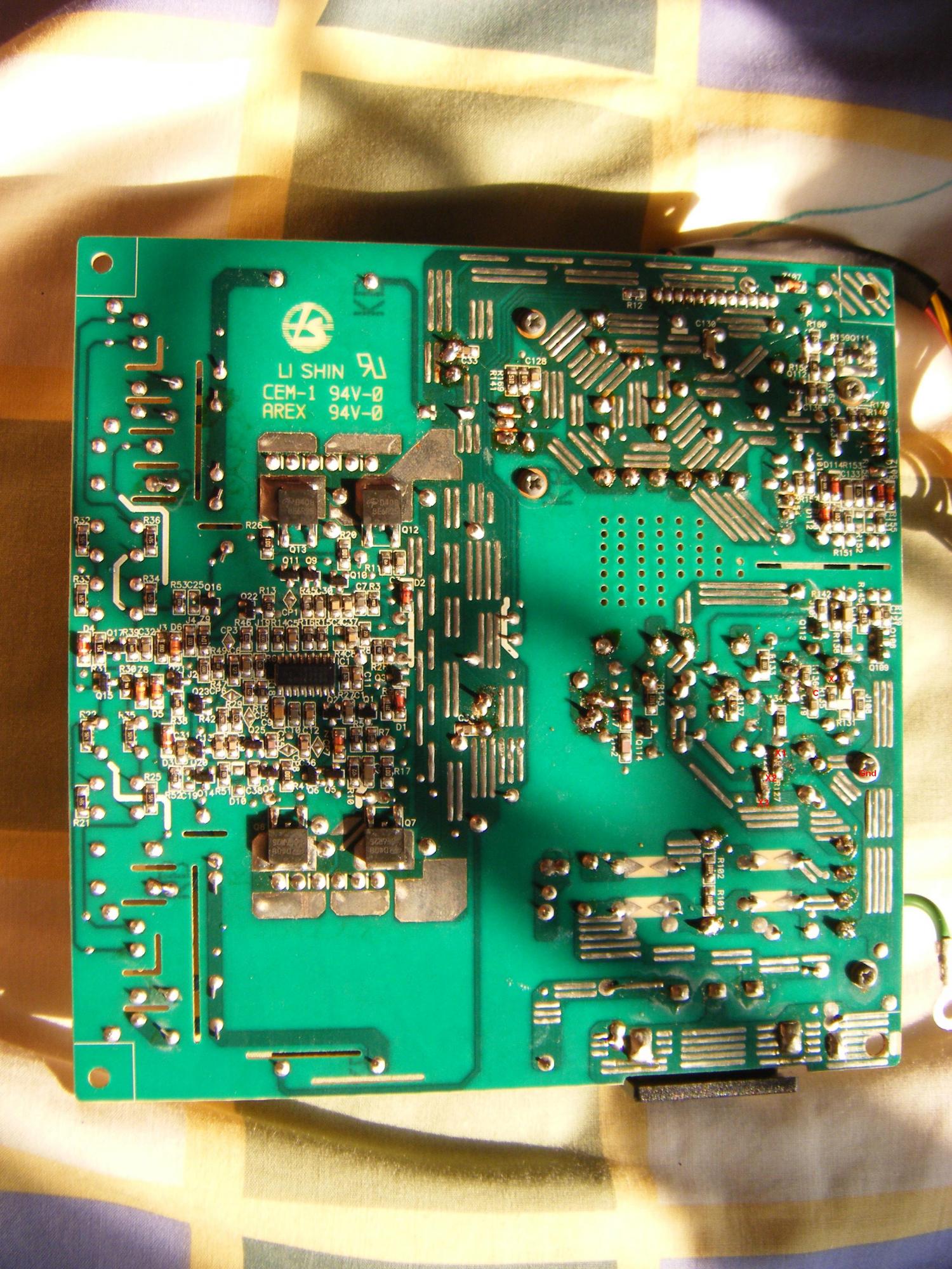

    1) Opened up the monitor and saw that the Power board, to me have been tempered with because I observed,
    1.1) some screws were missing or over thread
    1.2) 2 caps (470uf 25v) were ‘loose' from the glue (I believe someone have solder/re-solder them

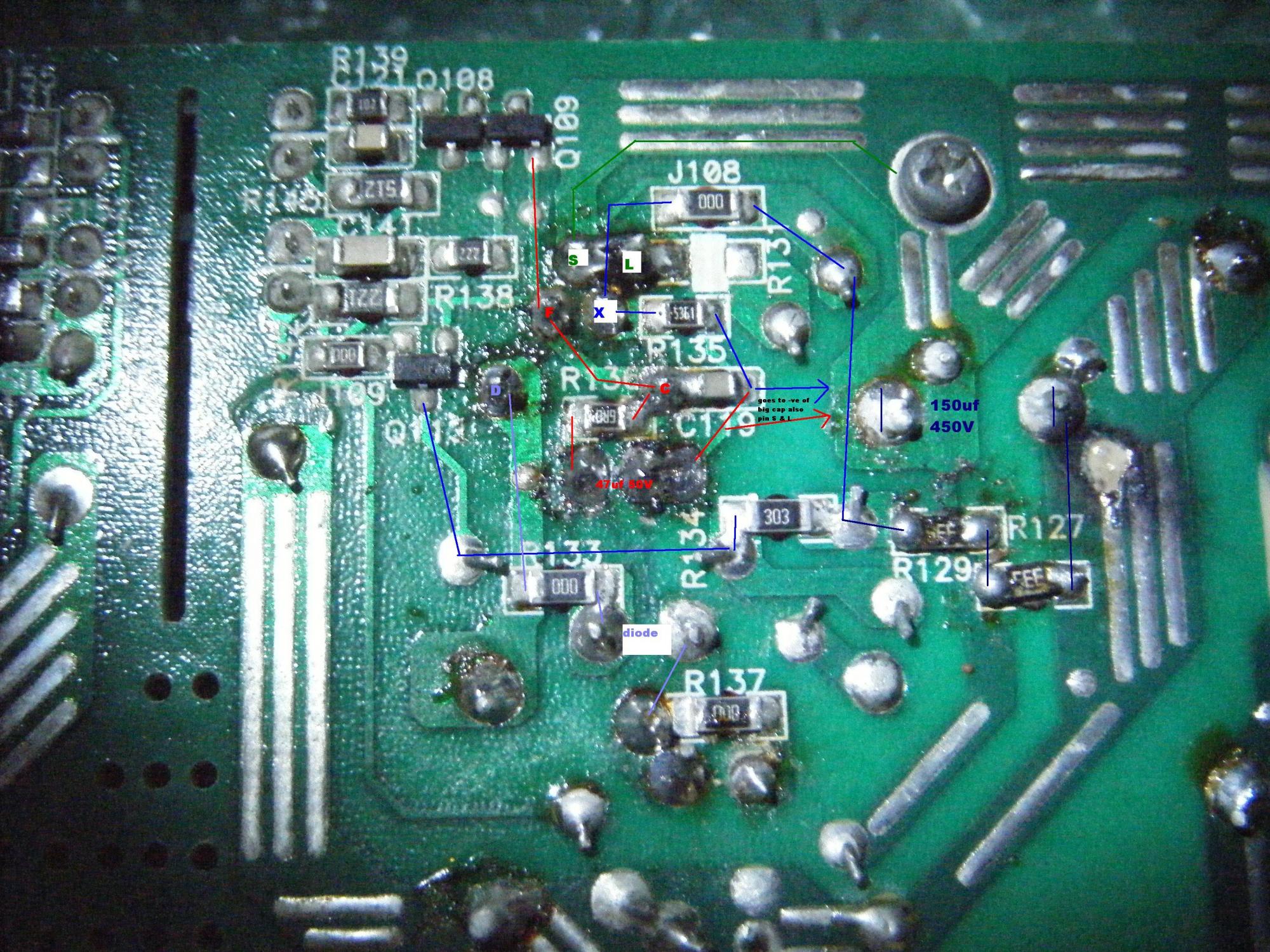

    1.3) and most crucially, there are ‘globs' of solders on the ends of smd resistors R127 and R129 and it seems to me they are unsoldered/re-soldered upon, and they are now slanted. Ok the thing is, if I follow correctly the thread by Capblown, Rev3 (same as my board) should be using smd resistor labeled 515 instead of 335 which is now soldered on this board. 335 smd resistor is used on the Rev2 version of the board.

    2.1) Replaced the electrolytic caps (except the Big cap & Rubycons ZLH 1000uf x4 & 1500uf x2 all 25v)
    - 470uf 25v x2pcs with Panasonic FM,
    - 47uf 50v x2pcs and 10uf 50v with Nichicon (PS) because that is what I have at hand for now.

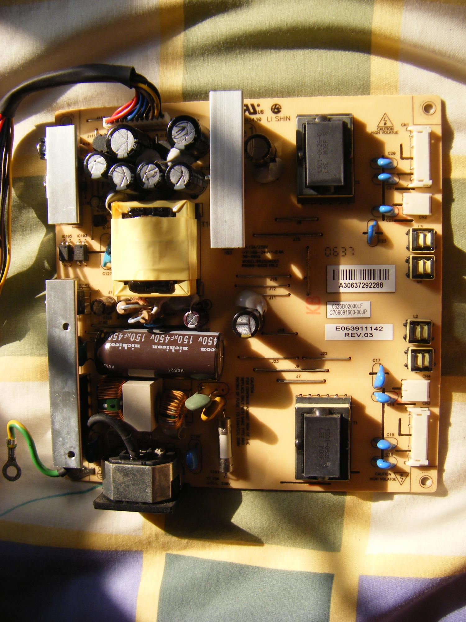

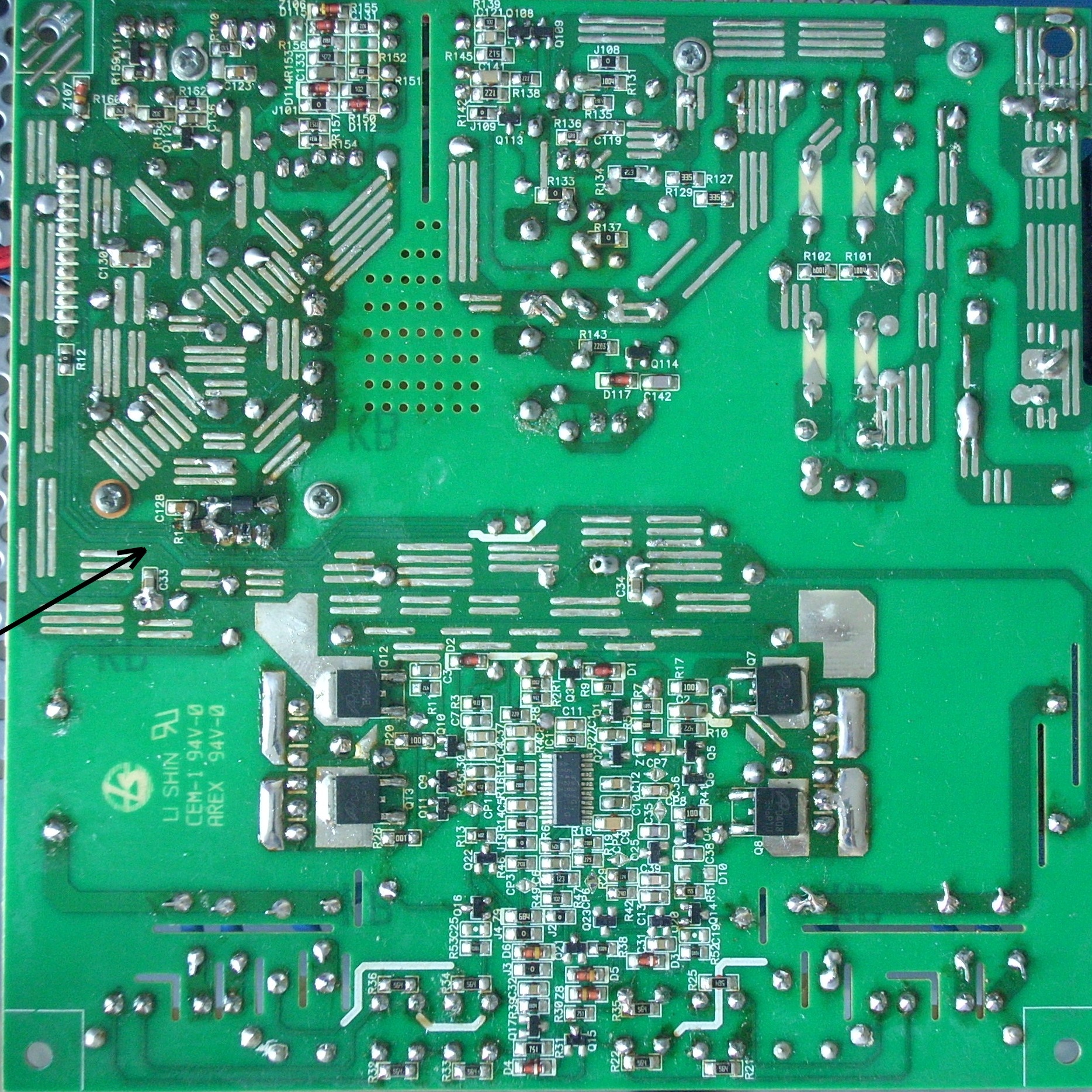

    4) Some differences that I noticed between my board & Rev3 from other thread
    a) as per 1.3, R127 and R129 should be using smd resistor labeled 515 instead of 335 (Rev2)
    b) R143 mine is labeled 2203 (Rev2) but the Rev3 in the thread looks to me to be labeled as 1203 or 1303
    c) Q23 is mounted (Rev2) unlike Rev3. However on this board Z9 is labeled 104 same with Rev3 while Rev2 is labeled 684.. hhhmmm,,

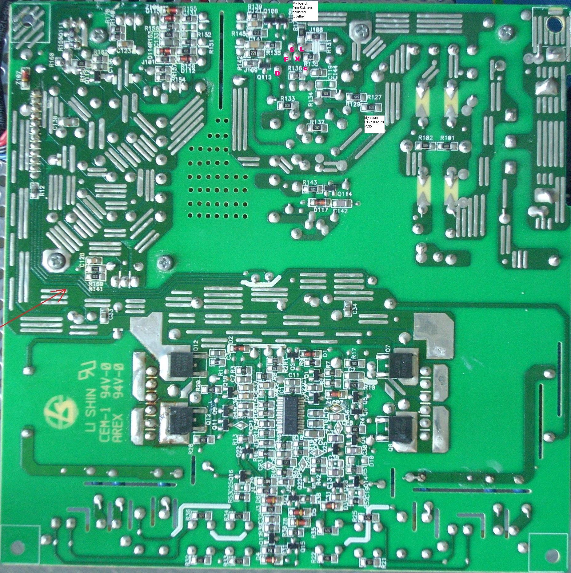

              > Rev2 – R127 & R129 are smd resistors labeled 335;
              R131 is smd resistor labeled 1004;
              Pins 2 & 4 of IC102 looks like they are not connected to each other in my eyes
              > Rev3 - R127 & R129 are smd resistors labeled 515;
              R131 is not mounted;
              Pins 2 & 4 of IC102 looks like they are connected to each other in my eyes using R171
              > My board - R127 & R129 are smd resistors labeled 335 (appear to be re-soldered);
              Pins 2 & 4 of IC102 looks like they are connected to each other in my eyes using just excessive solder
              FYI, I measured that R129 is shorted (connected) to Pin 3 (External current limit) of IC102.

                                Light bulb just went on - darn CCFL. The key must be pin 1. Where is the voltage source?
                                When you get a chance, I've marked off the area of interest on the bottom of the PC board. At a minimum I would like the pins of IC102 identified.
                                You had asked about hysteresis. The start-up circuit of an SMPS controller is designed with hysteresis. As the input voltage rises, the controller starts when the voltage reaches 16 volts. It will continue to operate until the input voltage drops below 11 volts. When the input voltage rises again it will start when it reaches 16 volts.
                                PlainBill
                                  PlainBill
                                  HAHA! I think we must change to LED lights now.
                                  I will try to findout later where the voltage source of Pin 1 is coming from.. I have the time anyway since my HP1905 is till not solved..In the meantime, I have marked the pins of IC102 in the pix attached. Also i have inserted some notes on the differences between the image & my board..
                                  Legend
                                  C = pin 1 (also internally connected to Pin 5)
                                  L = pin 2
                                  X = pin 3
                                  S = pin 4
                                  F = pin 5
                                  D = pin 7
                                  Many thanks on the explanation on hysteresis, boss.. Your explanation is much much clearer & easier to understand than the one that found through googgled just now... Appreciate it.. .. Can i nominate you for a Noble prize award or something like that?..

                                      Very correct. I have trace out in the attached photo the pins & to where they are linking to. Yes, Pin 1 is connected to cap 47uf 50V which i already replaced with Nichicon PS. Do you think I should replaced it again?. All i have spare now for this, is the same capacitor type no Panasonic. Unless you think I can replaced it with a 22uF 50V Panasonic FM i have lying around.
                                      The photo is only taken on some part of the circuits. My camera is not very good i guess to take a zoom out image with readable markings on the board. If a bigger area is needed to trace out the voltage source, I will re-take again. I also attach the top side.
