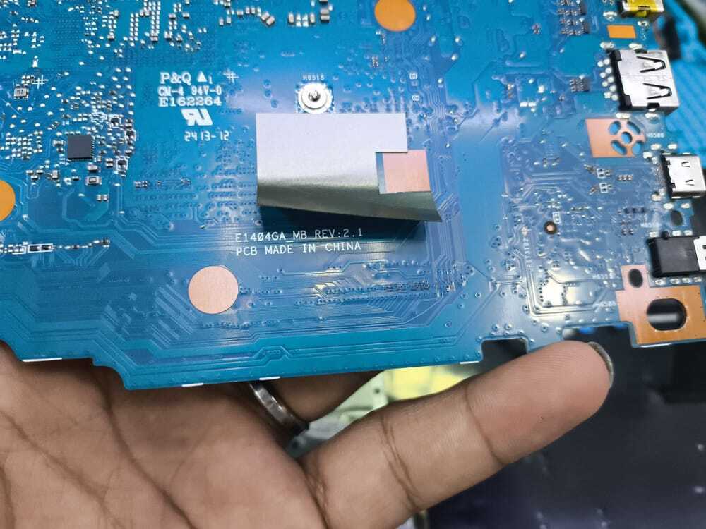

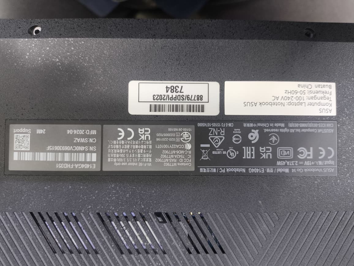

    Good day! I ask for help in this bios, first the bios have password and i've try to replace with another bios and the laptop wont detect SSD at all
    Asus Vivobook Go 14
    MODEL : E1404GA-FHD351
    CODE : E1404GA_MB REV2.1
    SN : S4N0CV06930615F
    CN : SWAZ
    MFD : 2024-04
    Thank you in advance!

                This is from different laptop, serial doesn't match, and it doesn't have password
                Originally posted by Draxywezz
                work but stuck on "input password" screen
                Please attach original backup with password, the password can be removed
                just little confused, why after flashing with another bios the NVMe SSD wont detect at all
                On Intel laptops you shouldn't flash a random BIOS from another laptop (same model) with initialized ME region, you'll have issues like SSD not detected, slow boot, etc
                Only the original ME region, or a clean (configured) ME region will work properly
