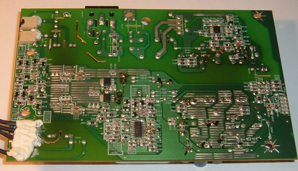

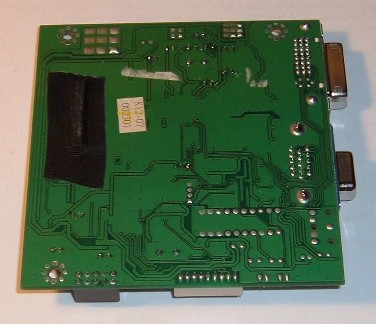

    Does anybody have any idea what I am dealing with. I'm just an electronics hobbyist and flying by the seat of my pants getting a lot of rug burn. LOLL
  • Wrog
    • Oct 2009
    • 472
    Re: Need help with my 900G
    Can't help with the rug burn, but let's see what we can do about the monitor! Post some pics of each board (top/bottom). Other information that will be helpful are the make of this monitor (Gateway?), along with which caps you've replaced and with what (brand/series). Do you have test equipment to help troubleshoot?

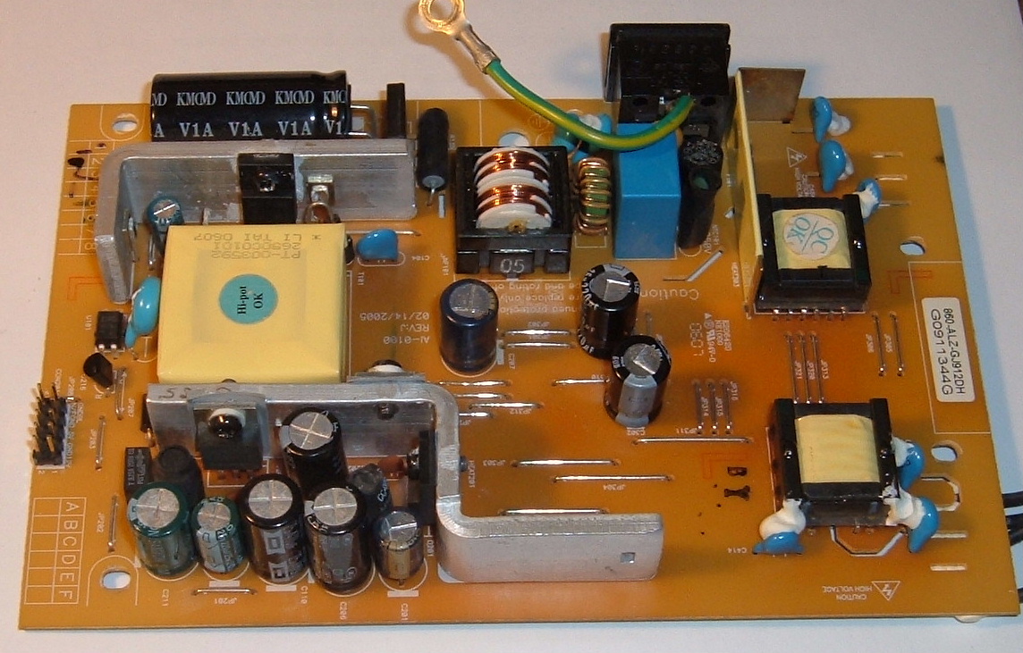

            Some comments in no particular order.
            1) In the lower left hand corner, the connectors look like they are marked with GND, and voltages. I can't make out the voltages, but I'm guessing they are the standard 5V DC, ON/OFF, and possibly 12V DC.
            With a multimeter, list, measure, report, and verify that all the voltages matches the legend on the connectors.
            One of these voltages could be out of specification.
            2) It is possible that your replacement caps 1 year ago are bad even though they show no visible distress. They can have high ESR (ohms). If I understand it correctly, when the caps warm up, the ESR drops and the monitor starts working.
            The only way to test the ESR of a cap is to use an ESR meter. These are expensive, $65+, so for the hobbyist, it is cheaper to replace the caps with low ESR caps like Panasonic FM, FC or Rubycon MCZ.
            I don't recognize many of your replacement caps and have no idea if they are low ESR caps.

              Okay I changed the caps that I changed a year ago and something good happened. I lost the slow power on light problem I had and now I get an instant power light on and off.
              I checked the power and I'm getting a steady 12v and a steady 4.92 on the 5v line.
              I am not getting any screen though. I let it run with the power light on for about 1/2 hour and nothing.
              Regarding the series of the caps I'm not sure what you mean by that. They are all 105 degree caps if that helps. With the exception of the one 35x470 that one is an 85 degree.

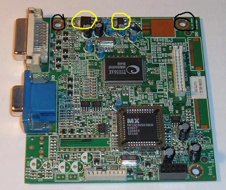

                        Welcome to the forum! The 12V normally supplies the inverter assembly and the 5V supplies the the logic/video card and LCD panel. Since you're getting no backlighting or image, it can be caused by several possible problems:
                        1) At the 5V and 12V outputs, check to see if there are any blown fuses on the top of the board, or surface mount fuses on the bottom of of the power board.
                        2) Possible short of mosfets used to generate the sine wave used by the inverter transformer(s).
                        3) Bad inverter transformer or CCFL controller chip.
                        4) Bad voltage regulator on logic board. It looks like you have 2 regulators on your logic card. I believe they are the two square 3-legged devices above the two black caps at the top of the board.
                        5) Also check for fuses on the logic card.
                        6) With power off, reseat connectors between power and logic boards.

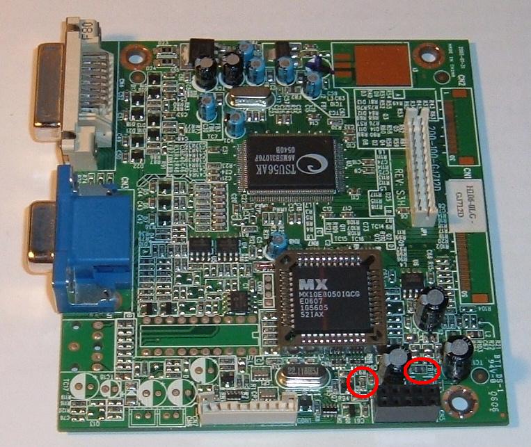

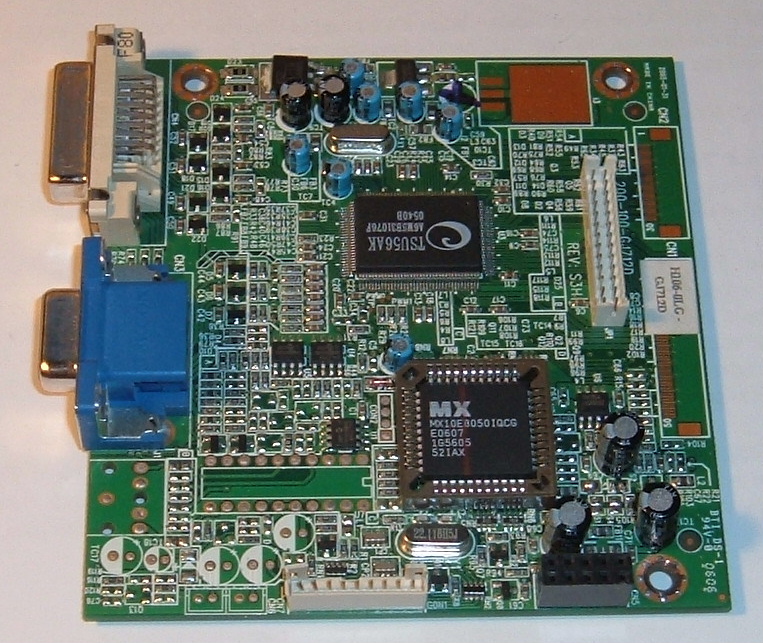

                          Would it be possible for you to send me pics of where these items are located since my electronic knowledge is limited?
                          You could use the pics I posted and just put arrows on them and post them back for not just me but for all those with the same limited knowledge.
                          Thanks in advance.

                            Voltage regulators are black, with 3 legs...
                              Originally posted by oldmanjohnson
                              Thank you for your response I do appreciate all the input.
                              Thanks in advance.
                              Here you are. There appear to be only two of them I've circled them in yellow. I've also circled two of the mounting holes in black. Use the metal around them for the ground lead.
                              Standard orientation on these is with the large mounting tab up, the three legs down, and the legs numbered from left to right (the tab at the top is usually connected to the 2 (middle) leg). Also, indicate the complete part number of the regulators. The voltage is usually included in the part number.
                              PlainBill
                                Not sure where to find these items.
                                Could you send me the board identifier numbers and I will track them down.
                                • jetadm123
                                  • 2169
                                  red circle-mosfets
                                  yellow circle-ccfl controller
