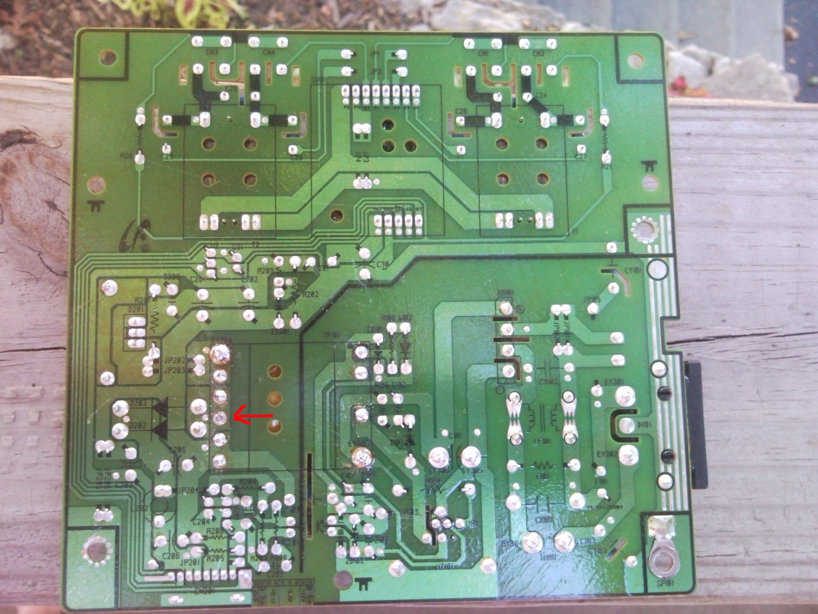

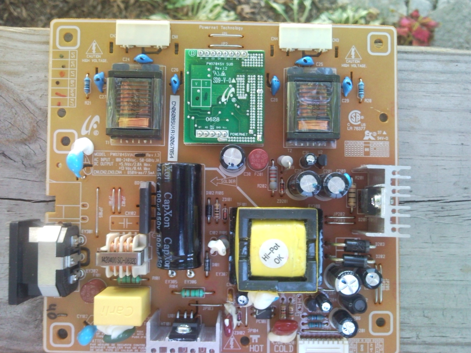

    This board is not outputting 13V. 5V is ok. I haven't done a lot with power supplies yet, other than replacing caps. I tested the transformer before removing it from the board with a ring tester, and the primary side was showing a short. After removing it from the board it tested good. So I think there is something shorted on the primary side. Test around and can't find anything.
    I happen to have a replacement transformer that was working in another board, so I try it. Before I removed transformer B from board B, it rang good. So I begin soldering transformer B to board A. Still trying to locate the problem, I solder 1 pin at a time, and check the ring tester to see where the short is introduced. When I solder the third pin from the left on the secondary side (see diagram) then the ring tester shows short. I have all the other pins soldered in and no short, but when I solder that last pin it shorts out (ring tester shows no lights).
    This seems really strange to me because the two center pins feed the 5V which is working... And even without that pin soldered the 5V still works. The only difference is I am getting a little less than 1 V on the 13V pin, where I was getting 0 before.
    Any ideas?

    Shorted diode on the 13V output?

      I cannot remember the last time I saw any transformer,in this position on a Monitor actually cause a problem.As Plain Bill said the fault would seem to be on the output side of the 13v supply,and have had failure of one or other of the diodes.

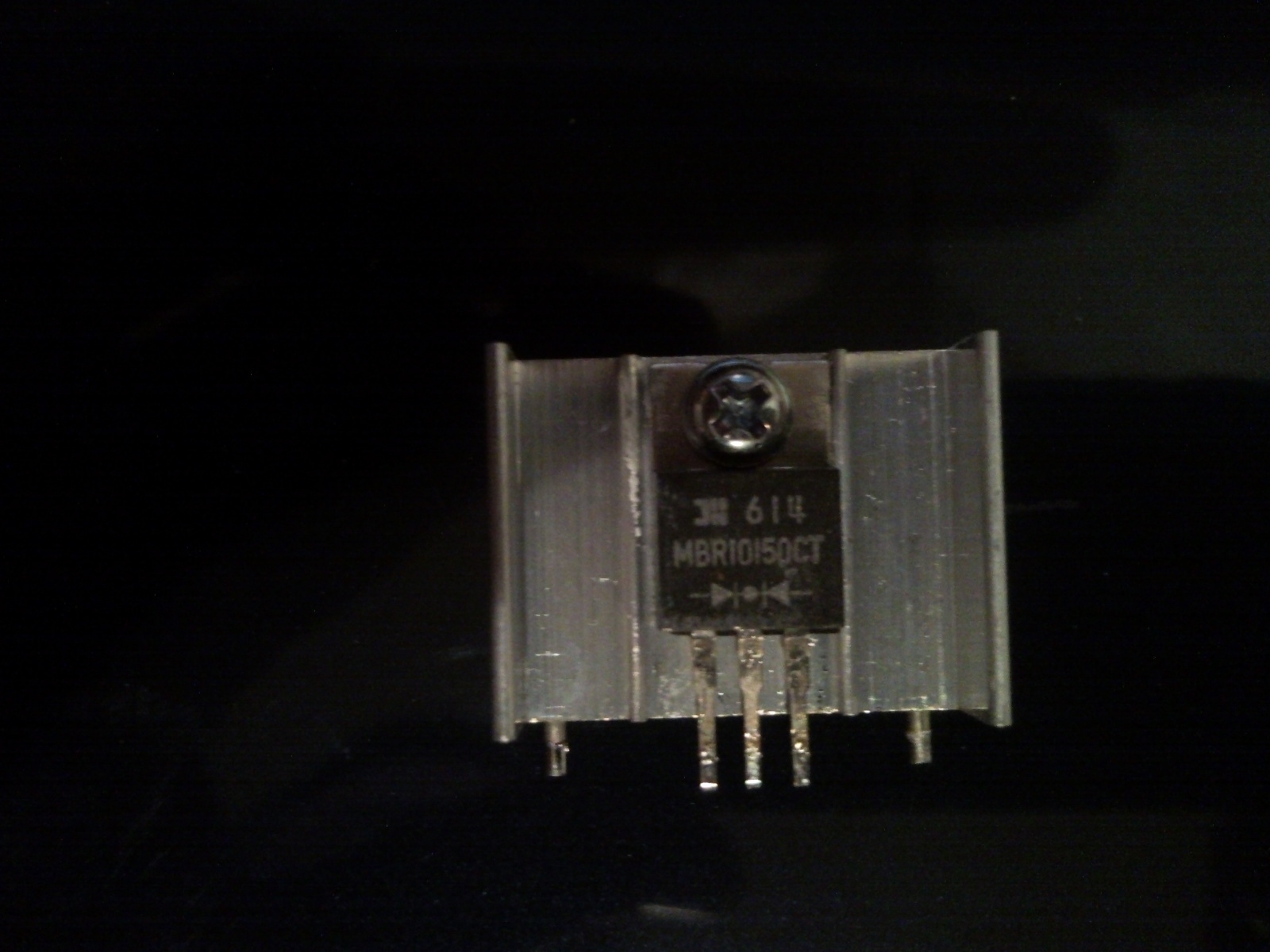

        I pulled the diode at D201. The transformer rings ok now. I think this is a schottky diode and when testing it the left side is always open circuit, which is different from the other side. So it appears to be toast.
        I found a datasheet that matches the part number, Attachment 1. Digi-key recommended the part in attachment 2. It has some different specs and I can't tell if it will work or not. If someone could take a look and let me know I will get one on order.

          The replacement suggested by Digikey is a slight upgrade from the original. It should work without any problems.
