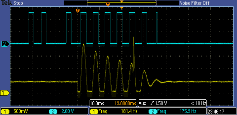

            Testing on oddball magnetics, some huge tube audio OPT and chokes, and small SMPS transformers.
            Can't get more than about 7 rings on small SMPS transformers and shorted turns brings that right down to 0-1 ring.

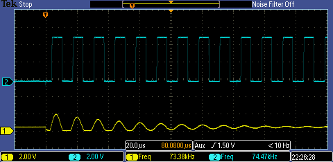

                  Bob Parker's Blue2 Ring Tester cannot be built, we have no firmware or PCB/Gerbers.
                  Lately when I need a ring tester, I just breadboard it using an Arduino. But it struggles for computing power with its fat library code.
                  So I thought go to a SAMD21 M0 or write it in assembly language for the '328 or '328PB. I can't decide.
                  Dany-K ring tester 2 added a meh comparator and pretty small excitation pulse, I haven't yet tried it.
                  I can't see what the minimum ring frequency is, you'd need for testing big magnetics. The ATtiny24 source code needs a bit of translation I guess.
                  I had a 12V 10A mains transformer and detecting a shorted turn on it not easy. You need a good sized pulse like 5V I find.

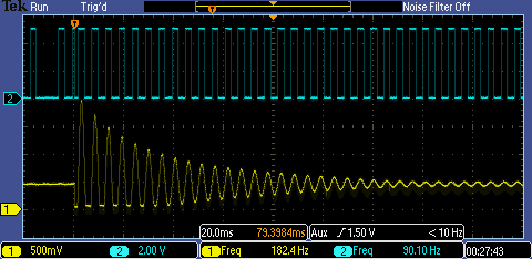

                      Tried out the circuit on a big ass choke, Hammond 193M rated 10H 300mA 63Ω weighing in at 10.5lbs/4.8kg.
                      You can see it rings for over 200msec which is a huge window. The comparator chatters a bit before and after. The spike is my S/W gate closing at the end (mosfet off). A 25msec gate dampens it fast and you get a wrong low ring count of ~8. Top blue trace is the comparator output, bottom yellow trace is output of the JFET.
                      I find you need more than a basic ring count because the magnetics being tested can have over 1,000,000:1 difference in inductance value. Then there is the effect of the shorted turns. uH matter for SMPS transformers and small inductors.

                              For a bunch of magnetics I have, I prove things by adding a shorted turn and compare the before/after ring counts.
                              Large 12V 10A 60Hz transformer gives: 11 rings (primary) at 930Hz, shorted secondary (at center tap) 7-8 rings (primary) at 10kHz on the breadboard.
