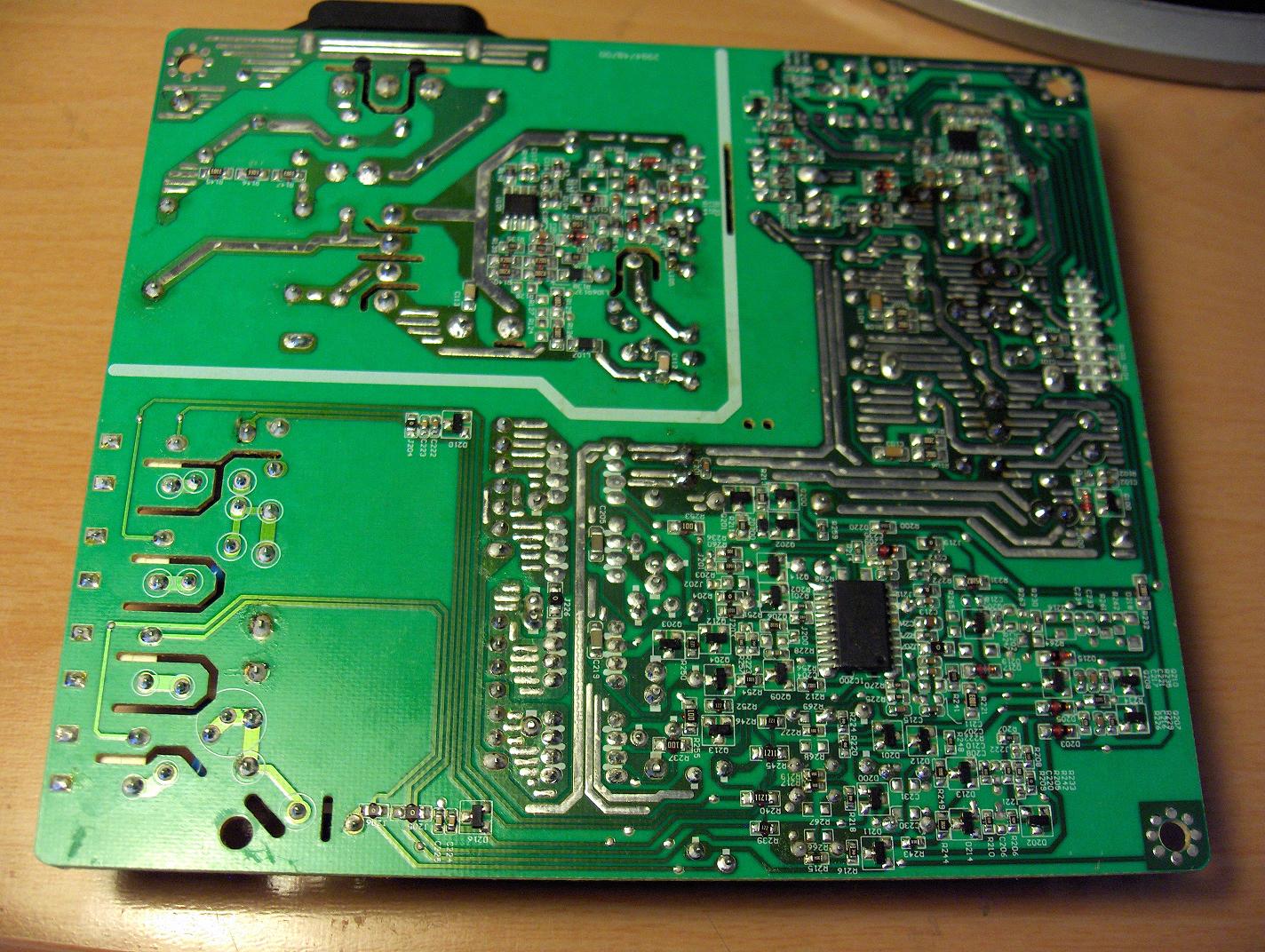

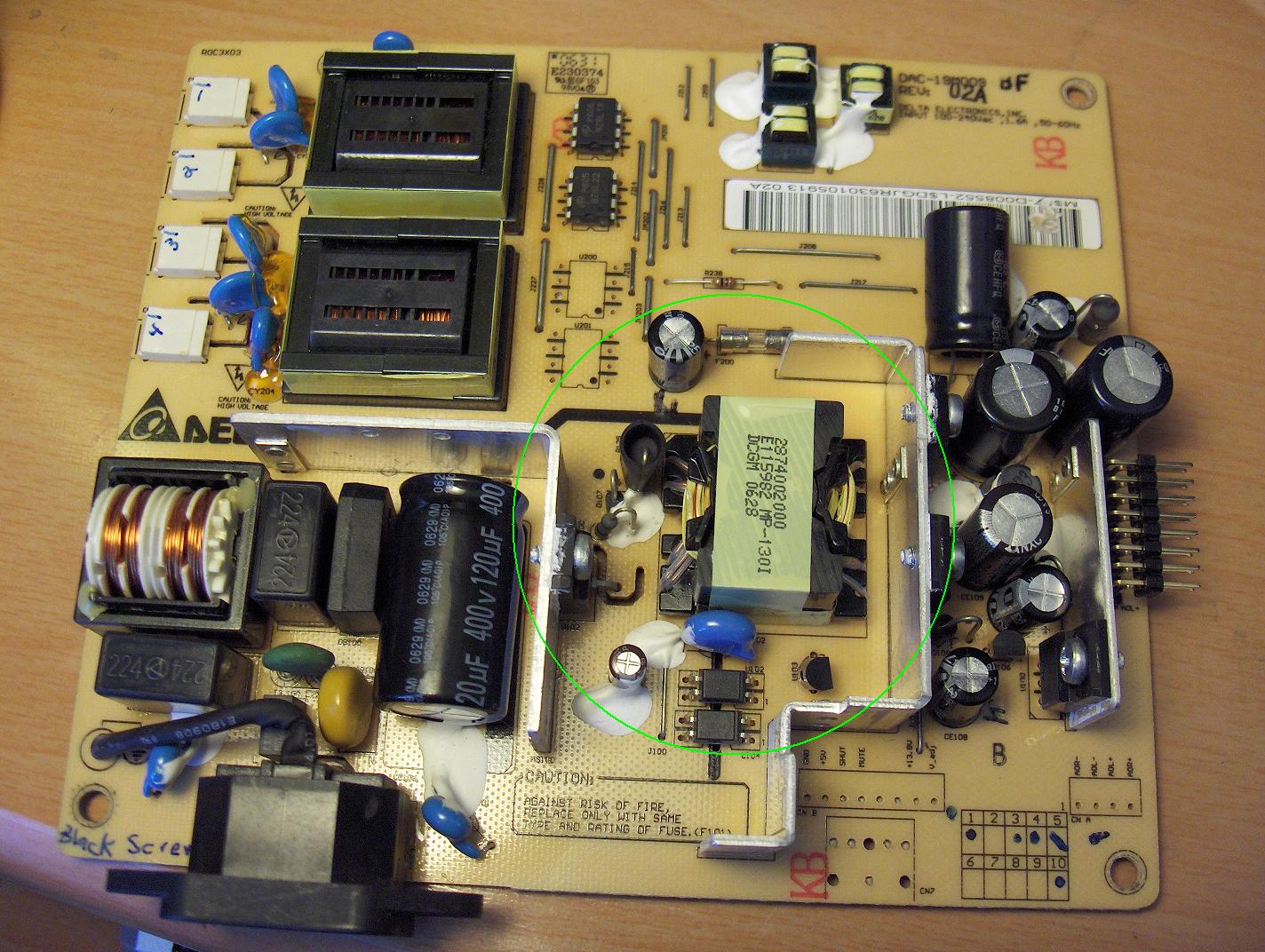

    Power board: Delta DAC-19M009
    Hello everyone, I just bought one of these on ebay that shuts off after about 5-10 seconds of being powered on, and stays turned off until I unplug it from the wall for a few mins and plug it back in again, then the problem repeats. I have checked the board's capacitors and it appears they have already been replaced with Panasonic caps.
    I haven't done anything to an LCD power board before besides replacing the caps (never tested components) so does anyone have some ideas of what to test for problems? I have a digital multimeter with ACV/DCV/DCA/Ohms/arrow-pointing-to-a-line functions.
    I also have another one of these exact same monitors that I'm using on my own computer, if comparing the two could help me troubleshoot it, but I'd prefer to not have to tear it apart if possible!
    Note: I noticed a quiet ticking sound from the area circled in green, seen in the first picture.

    I plugged it in again and took another listen, and it sounds like the ticking sound might actually be coming from the area just to the right, possibly from a transistor, but it's really difficult to tell.
    If I were to try and replace the four transistors on this board, how would I find out which ones to replace them with?

      Check the solder joints around the SMPS transformer. Also, it would be a good idea to replace the cap that the original person missed (at 7:00 in the circle). I'd suspect a bad solder joint on one of the diodes around the SMPS transformer.

        Looking around the transformer I don't see any fractures in the solder; some of the joints look more dull than others but looks normal besides that.
        I was testing the transistors and shorted one out though (it sparked - whoops!) on the left side of the green circle. On the lower two legs, the voltage was flying all over the place (-150v to 400v on my digital multi) and I can't remember the other two because one of the leads slipped and now it doesn't read anything... looks like I'll need to find a replacement :P
        How does one figure out the specs of a transistor? The markings on the one I shorted are:
        P10NK60KFP
        GK18P V6
        CHN 626
        Edit: I also checked the voltage at the big capacitor and was getting about 165V. Fuse is getting 20.5 volts.

            The PWM mosfet you shorted out is probably the one below:
            http://search.digikey.com/scripts/Dk...=497-5892-5-ND

                Are those actual pictures of your power supply in its current state?
                None of those caps are Panasonic...
                • sircanegiem
                  • Nov 2009

                    Right, so the pictures aren't of your power supply then?
                    If that is a picture of your power supply, any of those that say Panasonic are fake.
                    Panasonic capacitors always have a T style vent.
                    • sircanegiem
                      • Nov 2009
                      • 11
                      Re: Another Westinghouse LCM-22w2 (Shuts off)
                      Wow good call, didn't even think about the vents. That is the actual picture of the power supply and those are definitely fake pannys with X vents. I'll go ahead and take apart my own LCM-22w2 and recap it (again) with the exact same ones I put in mine and try my luck again after the new transistors arrive. Should be here on Saturday or so; will post then.

                            Hey everyone, just wanted to give an update. Replaced the transistors, but the power board was still shot. I ended up just buying another power board instead from someone selling an LCM-22w2 on Ebay ($30) and that fixed the problem -- but only for about 20 minutes!
                            "Uhh... what?"
                            When I first turned the screen on, the top CCFL was very pink, and then gradually cleared up after about a minute or two. After it cleared up I thought all was well, until the monitor suddenly shut off 20 minutes later; no backlight at all, and only the green power light to show it was even still getting power.
                            Turns out *another* common problem with these is that upper CCFL. When it wears out, the inverters cut the power going to both it and the bottom CCFL as a safety feature and the backlight is no more. The only fix is to get another pair of tubes, but if I did that the monitor wouldn't be worth the cost anymore.
