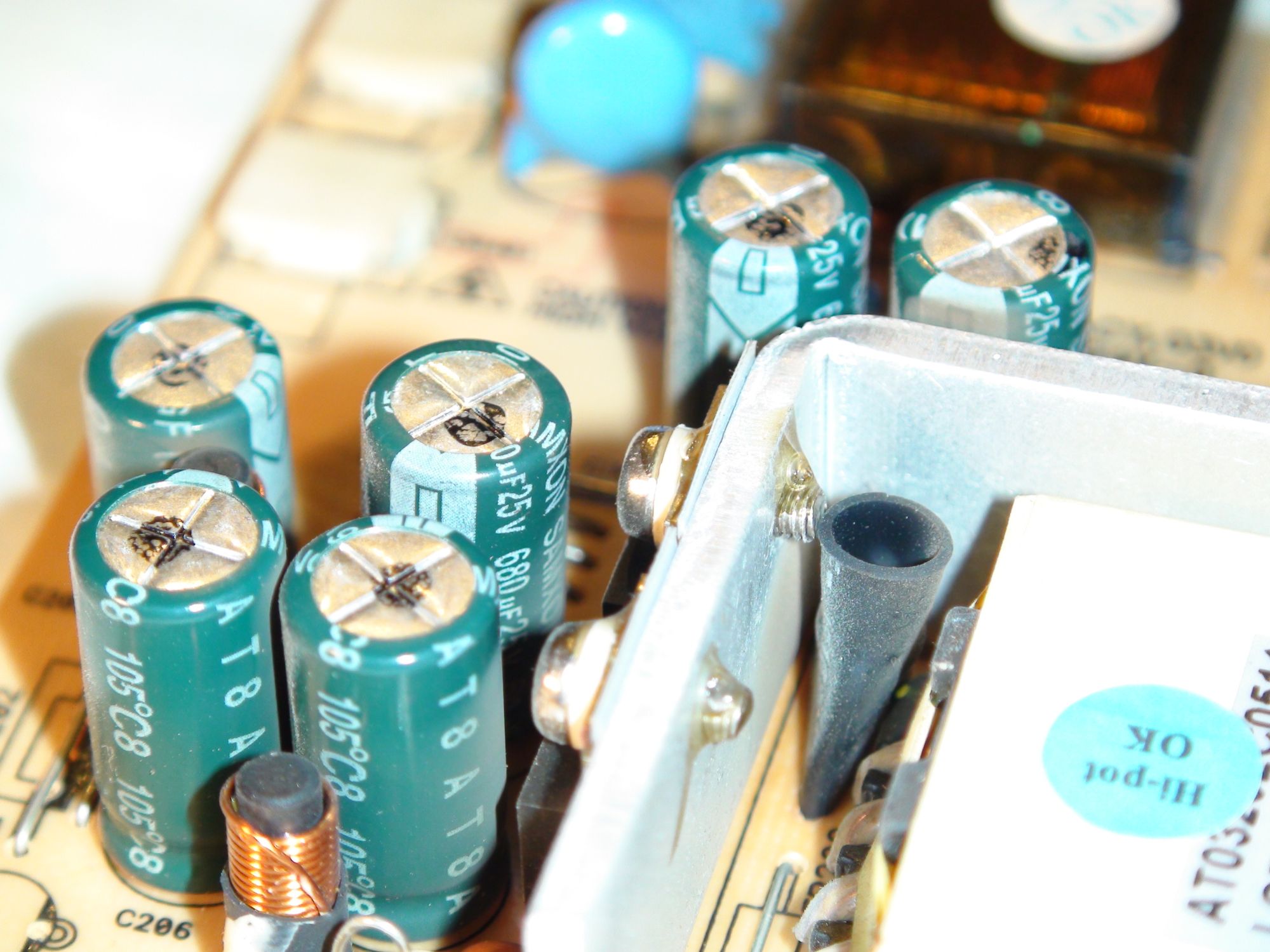

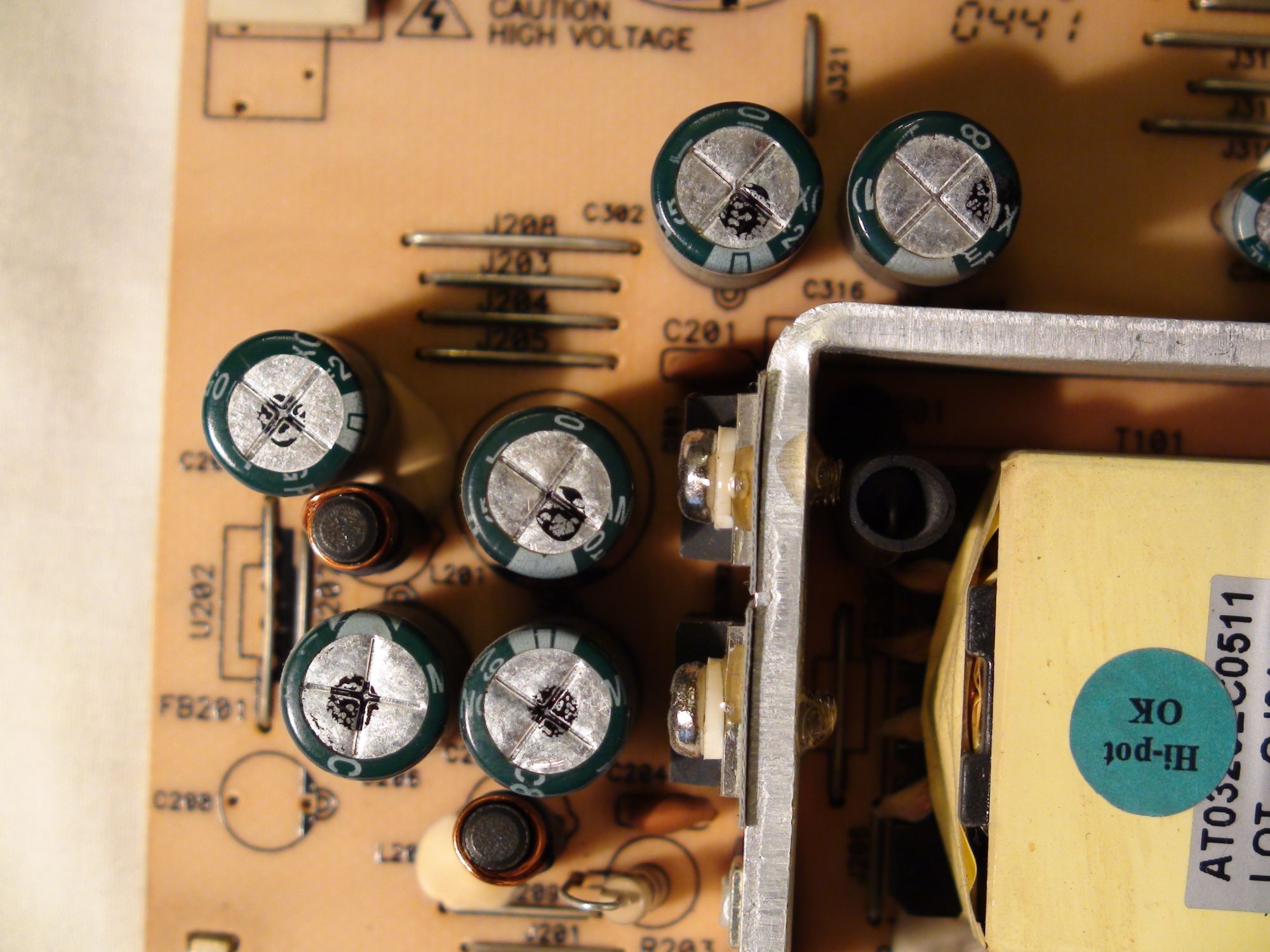

    Never done this before, but have soldering iron and solder, (with some electrical experience too)
    After 3-4 years, my monitor is playing up. For the last few weeks, ive come home to switch it on, and only get a quick flash with green light remaining on. (yes, i can see image with a torch). It took 1-2 hours of leaving it on and the monitor would usually work after a few presses. Last two days, and it refuses to play ball. Time to buy new or repair. Things are rather tight for me right now, and i dont think ive had my value out this monitor yet either. Doing some searching, im learning about capacitors being a common problem in these machines (pre- 2007?).
    I have removed the power-supply board and inspected the capacitors, but im not seeing any significant bulging or leakages (after i realised those white blobs were just glue!) They are Samxon, and i think '(M) GF (M)' might mean something to you? Anyway, the shorter capacitor looks totally flat, but the 5 larger ones seem slightly distorted but its hard to tell. I hope to attach some pics of the board now, and hope you will see if they are good or not. I have a maplins local to me (in the UK) and i'll call them tomorrow to see if they sell these caps. £140 is too much for a new monitor, so if this is cap problem, im fixing it myself!
    On viewing the side of the caps, they dont protude the top.
    Please help, many thanks indeed!

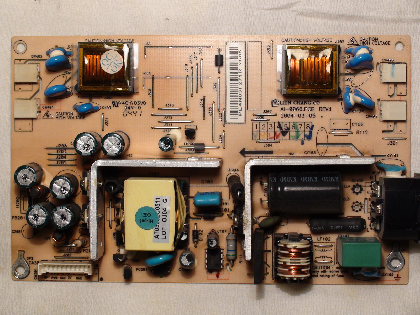

    1) Currently, if you power it on, does the LED light up?
    2) If the light is on, can you see the image using a torch or flashlight?
    3) Can we get 5 shots like the following (so we can see the entire board)? See
    https://www.badcaps.net/forum/showpo...94&postcount=1
    4) Do you have a multimeter and can you measure voltage?

      Thanks for the reply.
      1. yes it does
      2. yes i can. (as mentioned)

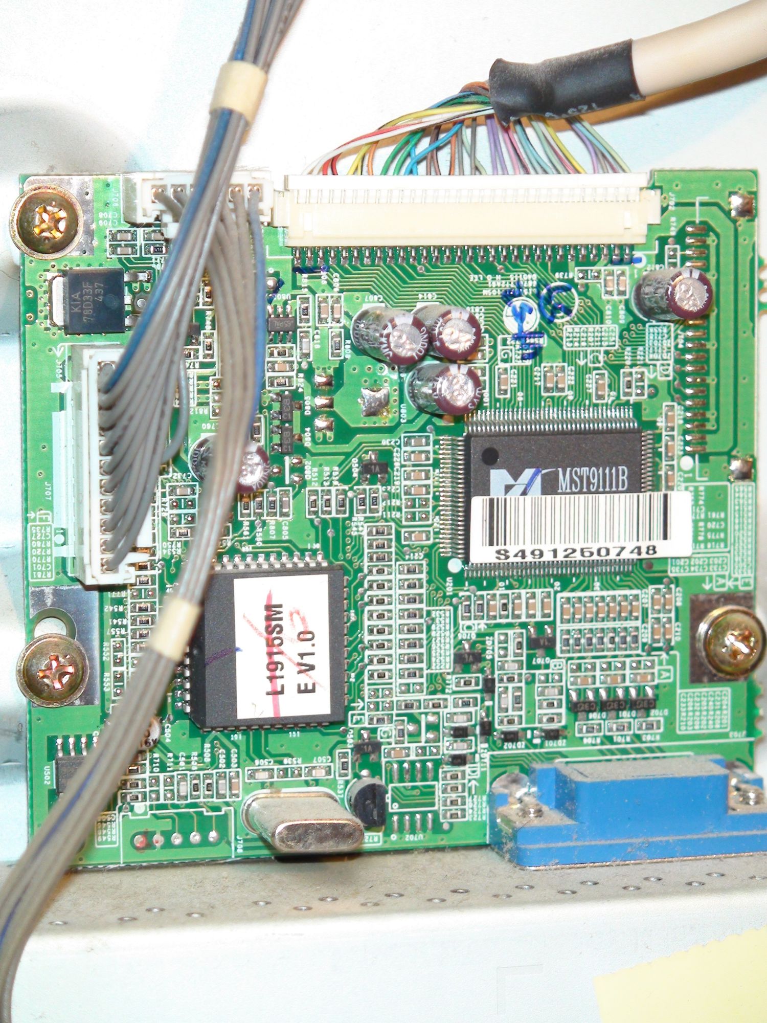

      3. The other board is fixed to the back cover, which i think is the inverter board? I can post a pic of that (birds-eye view) and another of the main board in better light. I'll do that now.
      4. i do, but not that great with them, will need new batteries too)
      Its just not that obvious to me which caps are bad, so perhaps i could replace those large 5 ones, as the shorter one looks perfect. Ofcourse, there are lots more components that could be bad, im just hoping this could be simple.
      thanks again.

        Yes, we will need a picture of the "panel" board. We also need a picture of the backside of the power and logic board.

              For the panel, we don't need a picture of the backside, just the front side. In fact, leave it for now because your answers to the following questions below will have dictate whether we need a picture or not.

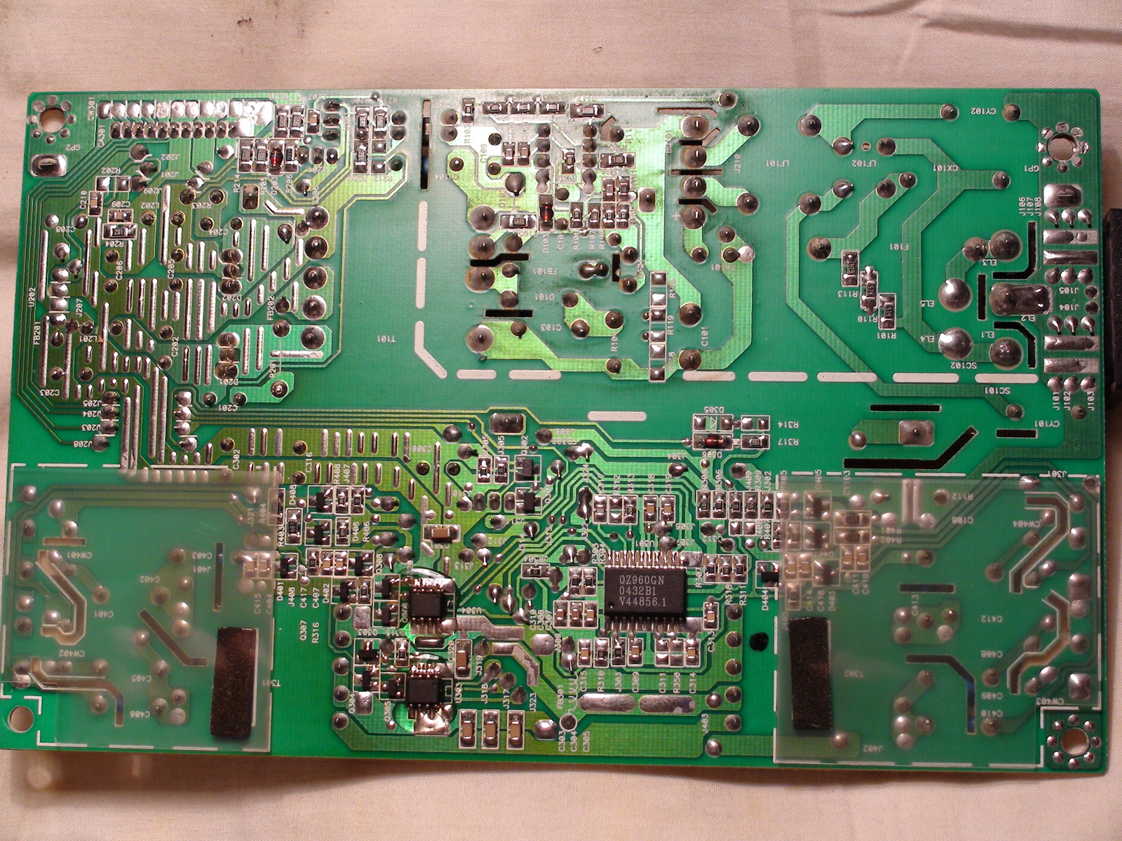

                hi, Heres the underneath of the power board (the panel board pic i attached earlier)
                The backlight comes on, but its only a flash on the screen, youd be hard-pushed to find your mouse arrow! I get the flash when i power on, or 2 or 3 when the pc boots up and goes though start-up. Sorry if im not being clear.
                I appreciate your help, no doubt about that. What would you suggest my next action?

                    What are the part numbers of U303 and U304 on the backside?

                        Re: LG1915S backlight problem
                        That was unbelievably hard to read! omg! therefore, even with magnifying glass, i may still have a digit wrong, but this was what i could make out:
                        Nikos, P2103NVGG4549841
                              Originally posted by mr.tight View Post
                              P2103NVGG4549841
                              How is actually written on the chip? Like this?
                              P2103
                              NVGG
                              4549841
                              It matters because it will help find the datasheet.

                                  I think you may have two problems here. The slow startup is usually an indication of failing capacitors. The brief flash of light is usually caused by a problem with one of the CCFLs. 'Two seconds to black' can be caused by bad capacitors. It depends on the design of the inverter; sometimes they have a very short startup time. Samxon's are not known for high quality, but I am not aware if they are known to fail without physical signs.
                                  I see two approaches. The first would be to replace every electrolytic cap on the power supply / inverter except the large 450 volt one. I count 9 caps, including the two small ones by the transformer. If you are in the USA this will cost about $10 - $12 from Digikey if you specify USPS First Class Mail shipping. DON'T buy them from Radio Shack!!
                                  The second approach is a little more daring. Reassemble the boards so you can plug in the CCFLs. Don't plug in them all, just plug in one. Now turn on the monitor. Do you see a brief flash of light? If so, unplug that CCFL and plug in another into it's connector. Again, turn on the monitor and look for a brief flash of light. Continue testing one CCFL at a time. If every CCFL gives a brief flash, order a full set of caps as in approach 1. This MIGHT be an inverter problem, but it's not worth troubleshooting until you are sure the caps are good.

                                    It's written:
                                    NIKOS
                                    P2103NVG
                                    G4549841

                                        The inverter is on the power supply board. I refer to the other board is the logic board; a more accurate term would be 'video and control board', but that's a bit much.
                                        From my point of view, the 'smoking gun' is the brief flash. That and the fact you can see a display tells me the logic card is working. The fact that the backlights flash briefly during as the computer boots confirms the problem is with the inverter. As resolution changes the logic card will momentarily switch off the backlight, then switch them back on.
                                        As far as testing the CCFLS, try each one in it's 'normal' socket. If one does not flash it could be either the inverter or the CCFL. If that happens, try switching it to the adjacent socket.
                                        There are a number of possible causes of this problem. Certainly a deteriorating cap is a possibility. Indeed, if it were in the 12V supply or the inverter that would explain the symptoms. Another possibility is a deteriorating CCFL, or a lead to a CCFL that is breaking down or arcing.
                                        The only reason I am suggesting testing before replacing caps is I have never heard of a case where there was a progressive deterioration that did not include bulging caps.
                                        By the way, Farnell is on common source of capacitors. Also, make sure they are low ESR rated for 105°C. I personally prefer Panasonic FMs, but the third link in my signature leads to a FAQ listing other brands.
                                        By the way, the Service manual is available on elektrotanya.com
