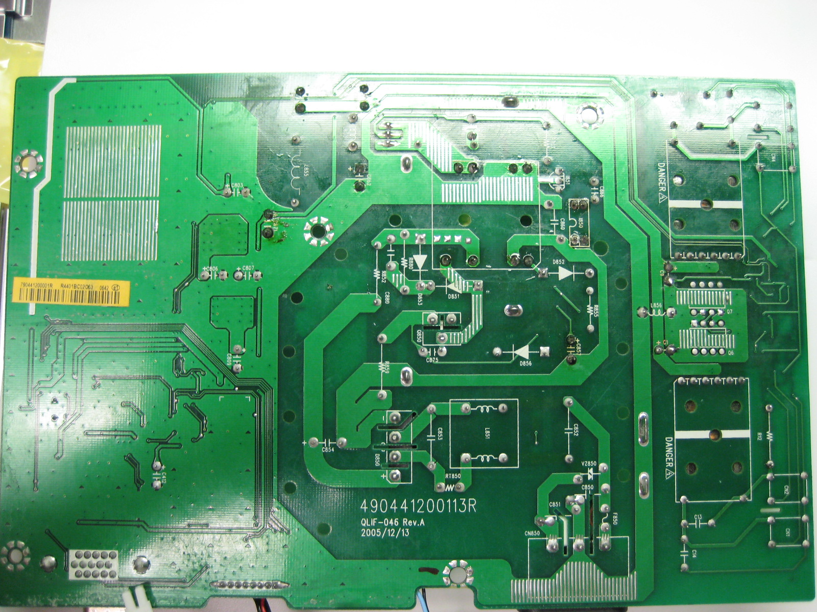

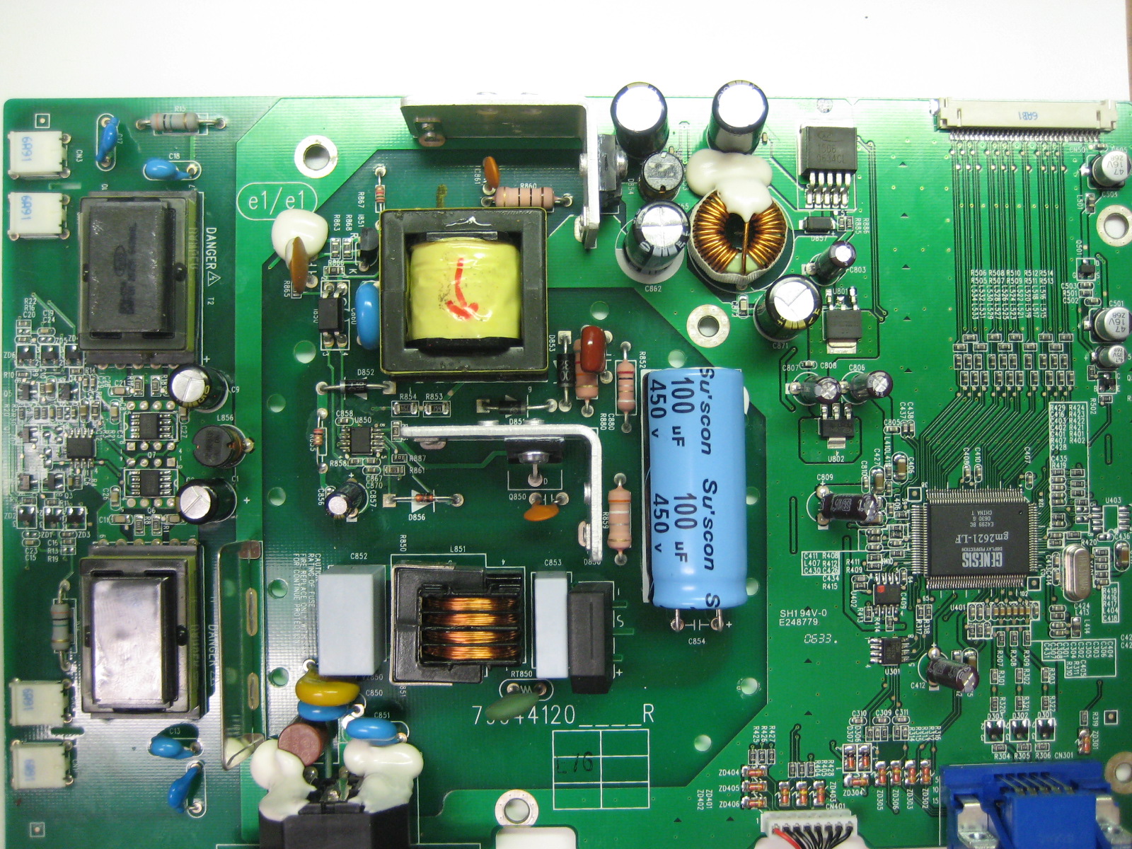

                            OK. I've decided to give up on the bluish tint monitor and try to repair board A. Here is a recap of what is and what has been done:
                            Board A... when plugged in, no LED. The transformer T850 clicks on and off... voltage at U850 pins 3 & 7 bounce all over the place (11 -16VDC).
                            Here is what I've done:
                            - Recapped entire secondary side... no changes
                            - Replaced transformer T850 from known good board (no change)
                            - Replaced I850 from known good board... did this cause I850 supplies pin 2 of U850 and wasn't getting anything out of pins 3 or 4 on I850. After swap, T850 stopped clicking. Also, U850 pins 3 and 7 now have 24.8V steady (not sure if this is high. The known good monitor had 16Vs)
                            - Decided to replace U850 from known good monitor as I found that pin 8 on U850 was only giving output of 0.25v and the known good monitor was putting out like 20v or so. This voltage goes to the gate of Q850... Q850 gate on the known good was seeing 3.58v. On the bad monitor, it was only seeing .02v... maybe not enough to turn on Q850?
                            So after swap of U850, here is where I stand:
                            Monitor wont power on. No LED, no picture, nothing. The transformer T850 clicks once or twice (sounds like it is charging up). Voltages are as follows:
                            - Filter cap: 156V
                            - U850 Pin 1- 0
                            2- 2.6V
                            3- 24.8v
                            4- 1.29v
                            5- 4.5v
                            6- 0.75v
                            7- 24.7v
                            8- 0.25v
                            - I850 pin 1- 99.4v
                            2- 98.4v
                            3- 0
                            4- 2.6v
                            - Q850 G- 0.25v
                            D- 155v
                            S- 0.008v
                            Any ideas?

                              Being this board is an "all-in-one" board with the inverter, power, and logic all on one... there is no cable between the boards... makes it hard for me to find test points. Can anyone point me in the right direction to take some measurements for the 5V, 3.3V, and 12V?

                                Re: Dell E177FPf No Power
                                1) D854 - dual diode should read 12V DC on middle pin ore slightly more (my guess)
                                2) 5 legged voltage regulator chip marked 1506 - look up datasheet and see what voltage should be
                                3) U801 voltage regulator
                                  1) D854 - seeing 25.4V on the middle leg.
                                  2) U851 Pin 1 - Voltage climbs very slowely from 0 to 0.882Vdc... and then stays there.
                                  2,3,4,5 all read 0V
                                  3) U801 All pins 0V
                                  4) U802 All pins 0V
                                  I haven't looked up the datasheet yet for Voltage reg, but I assume those readings to be bad.
                                    25.4V DC could be right for this board. If the capacitors to the right of D854 are rated for 35V, then 25.4V DC sounds right. If the caps are rated for 25V, then I believe 25.4V is too high.
                                    PS. There might be another dual diode (that is obscured by the angle of the picture - above R860). It would be facing "up" on the same heat sink as D854. If yes, that should be your 5V diode.
                                      Caps are 25V caps... And there isn't another diode on that same heat sink...
                                        I missed the comment in post #33 about the 16V DC being good in the other monitor and U850 showing 24V DC.
                                        Sounds like something wrong around that area. Will have to start with post #1 and re-read as I'm definitely getting confused with all the changes made.
                                          Check diode D856 with your multimeter in diode check function and report the results for both diode measurements.
