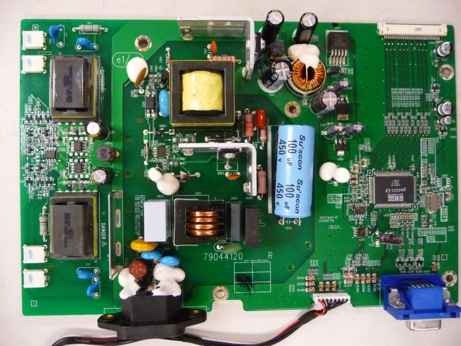

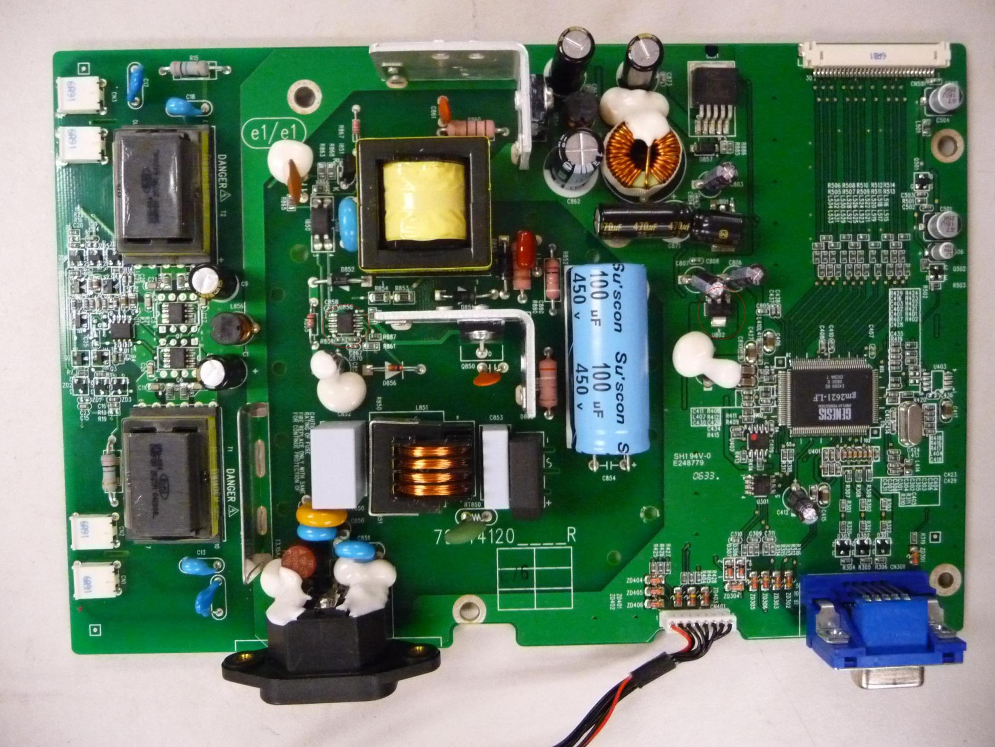

    Hello. Great Forum. I have 2 Dell E177FPf LCD Monitors. One has a damaged screen, so I'm only trying to get 1 to work. Both show same signs... appears to have no power... no LED on/off light etc...
    I'll call the monitors "A" and "B".
    I started by replacing most of the caps for both power boards (I like to do this, even if they are good. It keeps them from coming back to me later with a bad cap issue. Cheap insurance).
    Monitor "A". When plugged in, you can hear one of the transformers (I think) charging up and then ticking over and over. No display at all. No LED light at all. Pushing buttons does nothing.
    Monitor "B". When plugged in, you can hear something charge up... but no ticking. NO display at all. No LED light at all. Pushing buttons does nothing.
    Voltage checks:
    Filter Capacitor: "A" = 155VDC. "B" = 155VDC
    Supply Voltage of power IC (U850): "A" = moving from 12.3 to 16.2VDC... cycling all over the place. (I circled the Power IC in red in one of the pics of this board.) "B" = 16.6VDC steady (believe this is correct).
    Supply voltage from video section(U802): "A" = 0.69VDC steady. "B" = 3.3VDC steady (I circled this in red on same photo.)
    I only need to get one monitor working... and would like to take good parts from one board and replace them on the other... but I"m lost from here. Any help? Any other checks to see?
    Ticking suggests that the SMPS is trying to start.

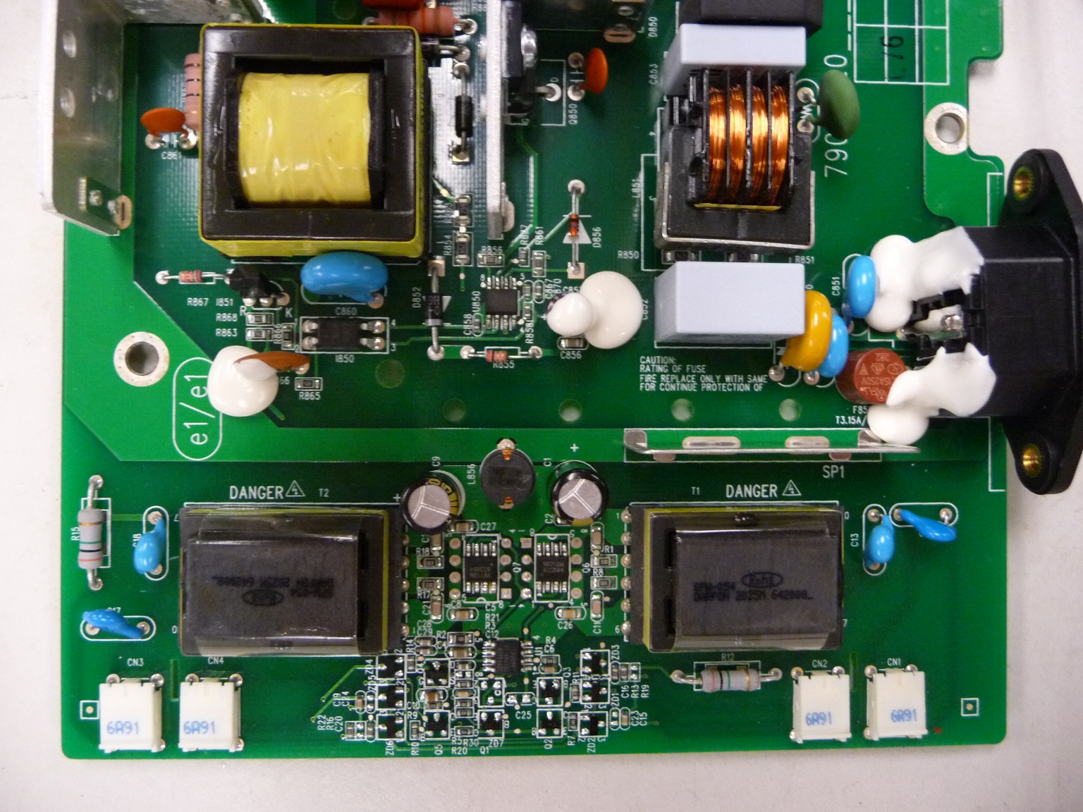

      C857 is the tall cap under glue: 10uf 50v
      C856 is the tiny surface mount
      Which did you mean?
      C852 is the large gray box cap... is this the one you mean?
      I've took a close up photo.

        Replace C857 for sure (10uF 50V). Do not replace C856 or C852. These tend to be more reliable type of capacitors versus electrolytics.
        If you don't have a spare or new 10uF 50V, take it from "B" and retest board "A".
        This is only for testing and you should get a new low ESR cap afterwards. The cap from "B" should work fine since it is providing stable voltage to the SMPS.

          On board A, you seem to have installed 2 caps together at C871... was this because you didn't have the correct capacitor?
          How have you installed them? Looks like there could be a chance the legs may be shorting on each other?

              I was also looking at those two caps. You probably were putting two caps in parallel to create a cap value you didn't have. What was the original value and what value did you use as a substitute?

                C871 was 680uf 16v. I replaced it with a Panasonic FM series 470uf25v and a Panasonic FM series 220uf25V. I've checked and double checked to see if I shorted them, and they are fine. This board (A) was having the same problem prior to replacing this cap. I did this just to test, and will be getting the proper size to replace my handy work... I started by soldering the two caps together, testing, and then attaching to the board.
