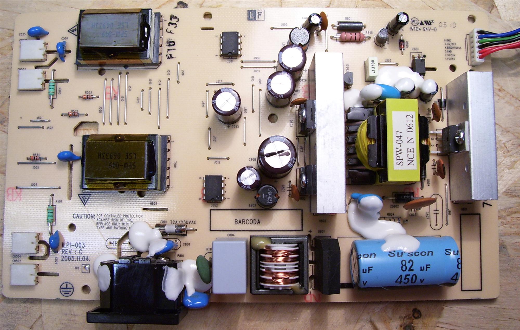

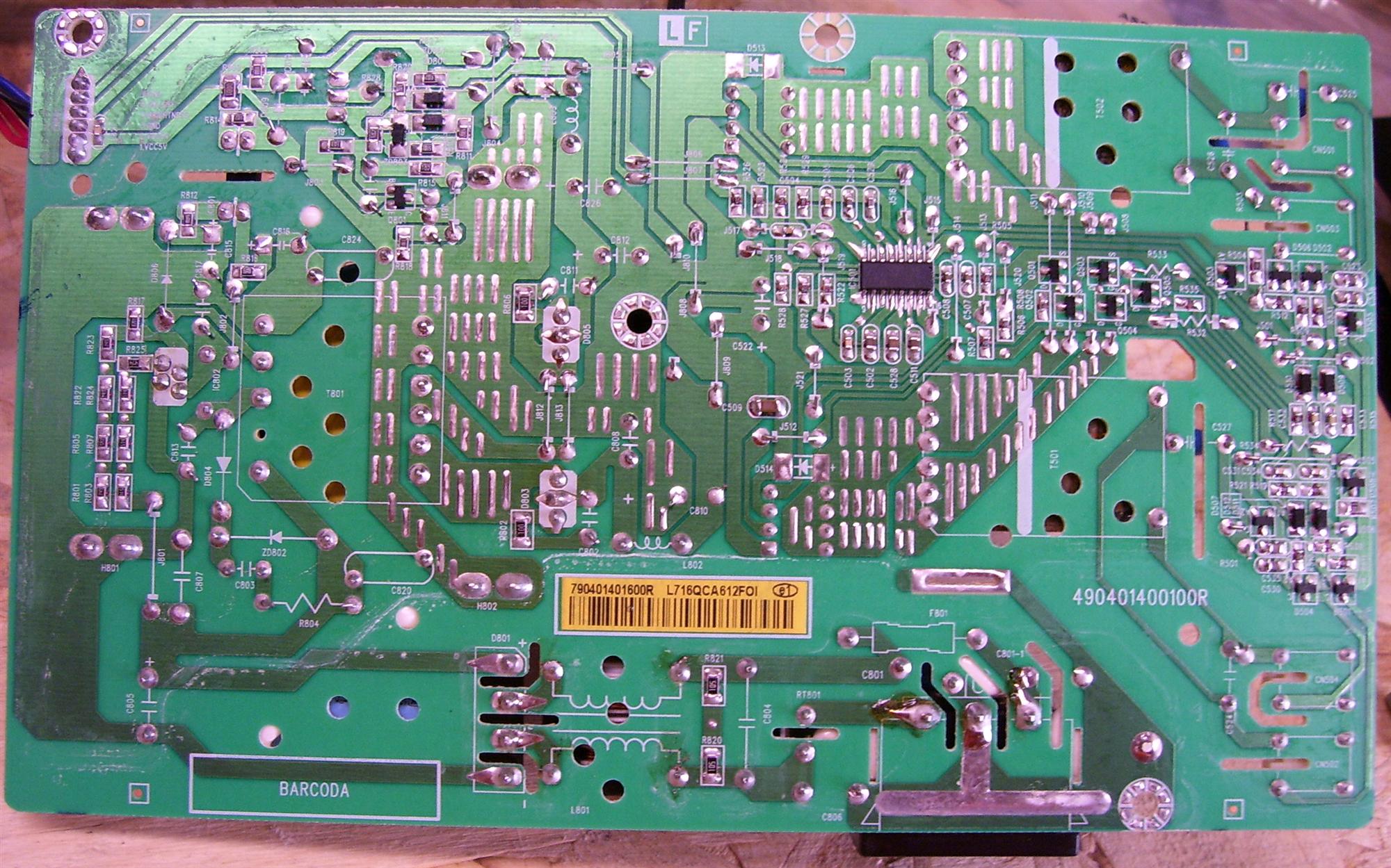

    I've got an AL1706b that's completely dead - no led, no power, nothing.
    Input fuse @ 2A/250v checks out, and all caps visually look good. No leaks, no bulges.
    This is the Rev: C board dated 2005.11.04 and was working perfectly until a couple days ago.
    I know caps can look fine and be bad, but I don't want to waste my time replacing a bunch of caps to find out it's something else. It'd be one thing if I had the assortment here already, but most of these would be custom-order, which only adds to the hassle.
    Thanks!

    It sounds like you have a multimeter. If you know how to use it, see if the secondary voltages, usually 5V DC and/or 12VDC, are present on the connector between the power board and logic board.
    If not, carefully measure the DC voltage across the main filter capacitor. It should be 1.4 * mains.

    Quick measurements show that both 5v leads going to logic board are good, doesn't look to be a 12v line, and there is minimal voltage (around 1v or so if I remember correctly - I don't know the spec though) on the other non-ground leads as well. Voltage at main cap is ~170v.
    Probably doesn't help without any more info though - I'll get to that when I return.

    Main cap voltage looks good assuming you're in the USA?
    You should have 12V because that what's required to supply the inverter. In your third photo, you have two devices mounted to the heatsink, D803? and D805. These are probably duo diode packs outputting the 5v and 12v. With your meter, measure the middle pin voltage of each device and report your findings.
      You should have 12V because that what's required to supply the inverter. In your third photo, you have two devices mounted to the heatsink, D803 (correct)? and D805. These are probably duo diode packs outputting the 5v and 12v. With your meter, measure the middle pin voltage of each device and report your findings.
      Yes, I'm in the USA.
      D805 = 5v
      D803 = 13.42v

        Good! now to check the filter caps for the 12v output. Without a schematic, you'll have to trace the middle leg of D803 to the "+" leg of the filter caps. I'm thinking C808 and the smaller one next to it (there may be others). They are probably rated at 16V or 25V? Once you determine if these are the caps, measure the voltage across them.

          Voltage across requested caps is as follows:
          C808 = 13.39v
          C810 = 13.39v

            A rule of thumb for troubleshooting monitors: If you have the proper output voltages from the power supply but even the power LED won't come on, focus your attention on the logic card.
            Understand, the power LED is controlled by the processor chip on the logic card. If the processor isn't working , no power LED.
            There are several common failures I have seen. First, note that the firmware is loaded from U106. If that is corrupt, the processor is dead.
            Second, note U102. That is a voltage regulator - 1.8 volt I think - the full part number will tell the tale. Check the voltages on it. A number of them fail high, destroying the processor. Also, check U101.
            And for the good news, there have also been cases of failures caused by dead rest controllers. What is the location code for the three terminal device just above and to the right of the 6 pin connector? If it starts with a U, that could be the reset controller.
