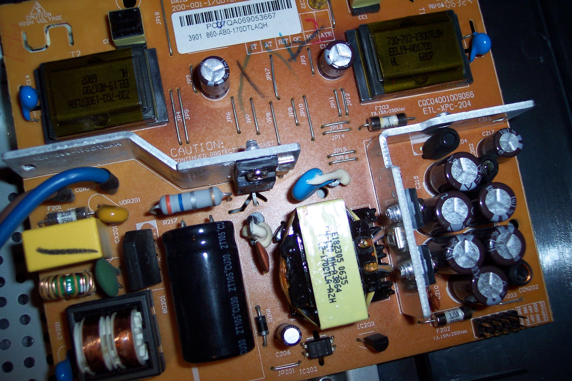

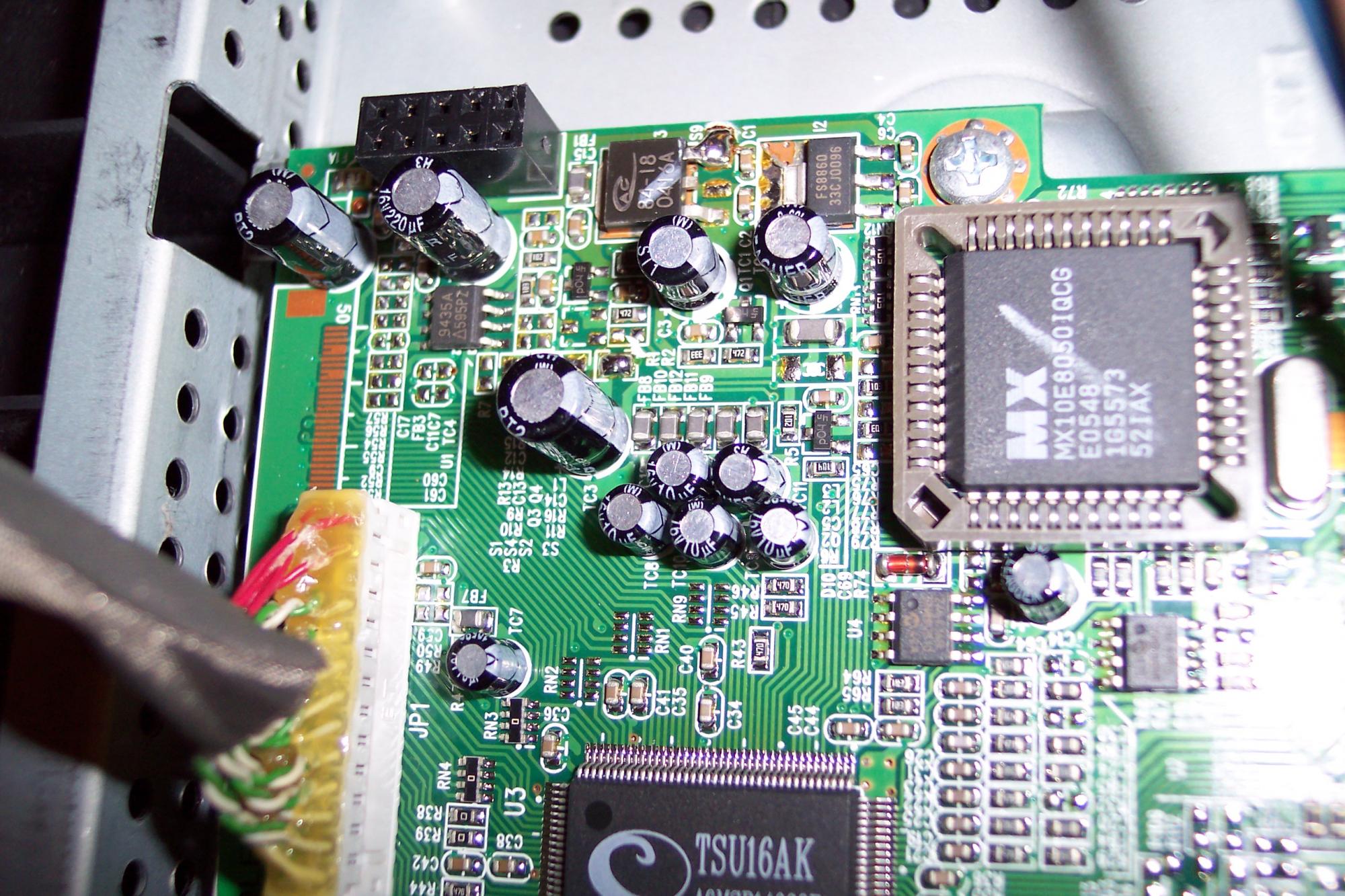

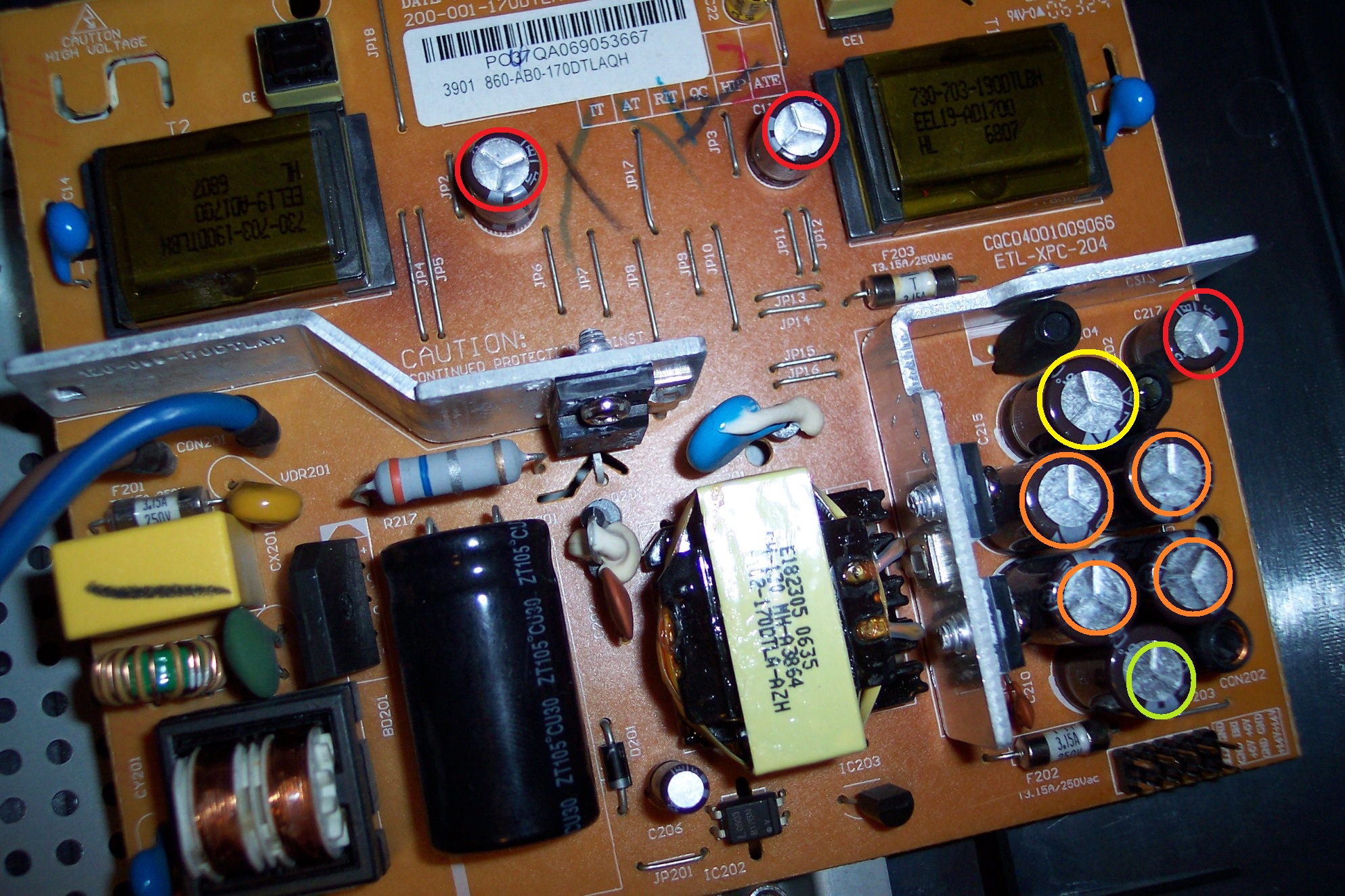

    I have a KDS k717 LCD. It will turn on and work for about 1 minute. It starts to flicker and then the screen goes black. The power light is still green. I can power off and on and the image will appear again for around 5 seconds before the backlight goes dark again. I disassembled the LCD and looked for any signs of bulging capacitors. I wasn't able to find one. I am attaching pictures of the power supply and inverter boards. I was able to repair my viewsonic thanks to the advice on this forum and was hoping to fix this one as well.
    Thank you for any help you can give.

      The PCB is very like the one used in Proview 700P and 900P monitors, as well as others.
      One of the standard faults with those, is failure of one or both of the capacitors next to the output transformers,and in all cases I have seen,although they regularly fail, they never bulge,and you must measure ESR with them out of the Board, due to where they are in the circuit.The latter would be my first task.If you do not have an ESR meter, then would change them anyway and see if that fixes your problem.

        Hello! Your board looks very similar to the board used on a Mag Innovision LT916s manufactured by Mirage Electronics. There's quite a lengthy thread here:
        https://www.badcaps.net/forum/showthread.php?t=5220
        Like Rtech said, it could be caps c10 and c11 that are causing your problem. Are they 100uf? Who are the caps made by? If they are all made by the same company you might consider replacing them all except fot the large 400-450V cap. Should cost under $10 (including shipping) if you order from digikey.com. I recommend Pansonic FM or FC series. Select USPS First Class shipping for lowest rate.

            I don't have an ESR meter. I only have a digital multimeter. I think I'll the sizes off of them when i get off work tonight and order a whole new set.

              I found all the sizes of the caps on this board. They are all HEC brand rated at 105 degrees. I saw this brand on the bad brands list on this forum. I am attaching the picture with colored circles around each. the key is as follows
              red: 25v 220 uF
              yellow: 25v 470 uF
              orange: 25v 680 uF
              what is a good ripple current value for these? I looked these specs up on digikey and i'm not sure which ripple current mA to get. Can someone point me in the right direction? (the 680 only has one choice, 1.22A but the others range from mA to A)
                red: 25v 220 uF
                yellow: 25v 470 uF
                orange: 25v 680 uF
                In order to match up ripple, you would need to provide the series of the HEC brand caps so that the specs can be looked up. Usually this is a two or three letter code on the cap itself.

                  If you really want to know more about how to compare HEC and Panasonic, see
                  https://www.badcaps.net/forum/showpo...47&postcount=3
                  Follow PlainBill's instructions on how to order caps
                  https://www.badcaps.net/forum/showpo...33&postcount=2
                  The Panasonic FM or FC series as described in the URL above will work fine with the KDS.

                    Here is all the info I was able to read off the caps. Thought i was going to have to desolder a couple at first.
                    HEC 25v 220 uF ZP 105° CU
                    HEC 25v 470 uF CU28 105°
                    HEC 25v 680 uF CU28 105°
                    Where can i find the ripple for these series so i can make sure Panasonic's FM are high enough?

                      digikey has fast shipping. i opted for the cheaper first class mail and my new panasonic caps arrived today. i will put them in when i get home from work.
                      • naterose77
                        • Jul 2010
                        • 10
                        Re: KDS K717 Turns on, flickers, then dies
                        I replaced all nine capacitors on the power supply board with panasonic CF's. the same problem still persists. it will power on initially and run fine for about a minute. then it flickers and the backlight goes out. the power light is still green. if i cycle power or plug/unplug the vga cable from the pc, the backlight comes back on for a couple of seconds before dying again.
                        any suggestions?

                          The next thing to eliminate are the Backlights themselves,and to do that you really need a spare one,to substitute in turn for your own ones in the screen.You can soon determine which if any is faulty.

                            I take it that if you let the monitor cool down for 15-30 minutes, then turn it on again, it will run for a minute, then flicker? Maybe a heat related problem? Maybe you can use a preheated blow dryer to accelerate the process to try and isolate the area that causing the shutdown. When you first turn on the monitor, blow one area continously to see if it causes problems. If not, after cool down repeat process in a different area.
                              The opposite approach is to take the cover off, shields off, and run it with a fan blowing directly across the boards and seeing if it stays on for more than 1 minute. If it stays on for 5 minutes, I would suspect the transistors on the backside of the board next to the transformers. I would resolder them.
                              You can see a bit of browning on the PCB board on the front next to the transformers. If this board is RoHS lead free, I would check all the soldering.
                              BTW, you haven't posted pictures of the backside. Some sharped eyed readers might be able to spot poor solder joints IF you provide sharp clear in focus pictures.

                                i will find the 10MP kodak tomorrow and try to get some close-ups of the solder on the back that aren't blurry. Thanks for the advice. I will have to figure out a way to extend the wires or run both the ps and inverter cards sitting on the table with the screen held above them. there's not a lot of room to work with.
