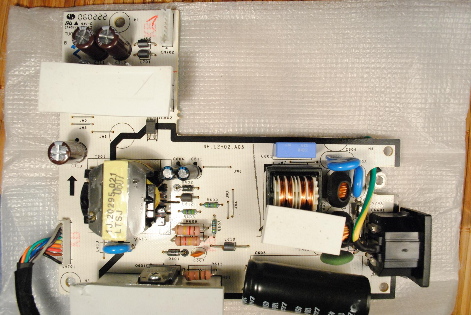

    • mabrowning
      • Aug 2010
      • 5
      Re: 2007FPb turns off after 0-3 seconds
      I snapped pictures of the front and back of the power supply board. When I listen closely, I do hear a small clicking at approximately 10Hz. The output line is holding steady at 18.9V.
      No signal is applied.
      Looking closer at the board, several inductors (L610, L612, and L701) do appear to be leaking...
        Apply a source and retest. Most monitors will turn off with "no signal" and go into sleep mode without a source. If that still fails, post a picture of all your boards (inverter, and logic).
        That could be glue used in the manufacturing process to hold the inductors in place until soldering or final assembly? It may have been white but turned brown due to age and/or heat?
          Excellent pictures.
          18.9 volts is an unusual voltage. I'd like pictures of the logic card - front and back. I'd suggest doing minimal testing; I suspect a regulator on the logic card is shutting down due to overheating.
          That's an illusion. Nothing in an inductor to leak.
