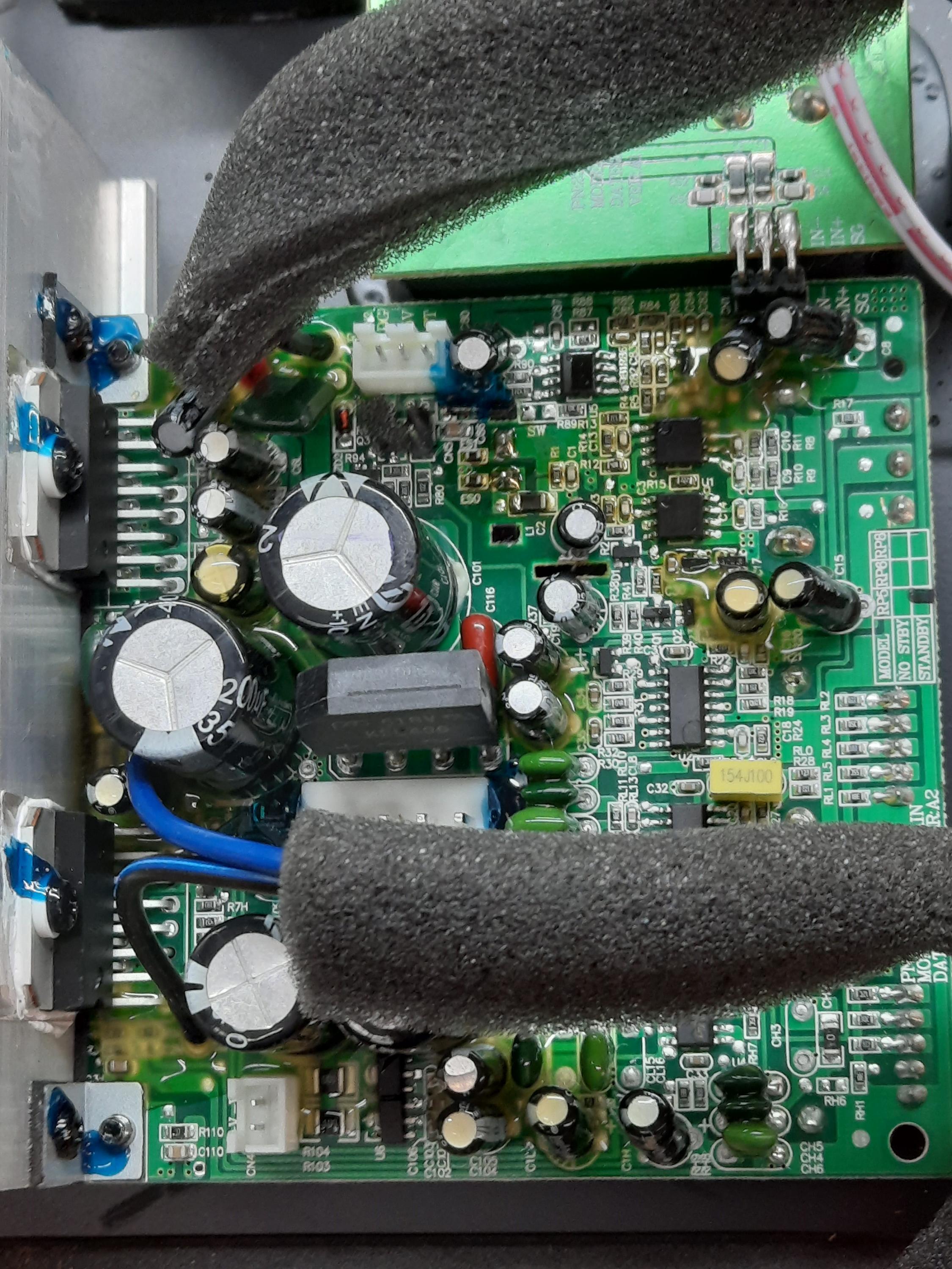

    Customer complains of losing the audio.
    Will start with my usual M.O, which is to remove all glue & check the electrolytic caps on main board.
    Anyone else experienced the int audio issue?
    Re: Rokit5, KRK speaker int no audio
    check fuses and soldering . that rectifier looks like it has bad soldering .

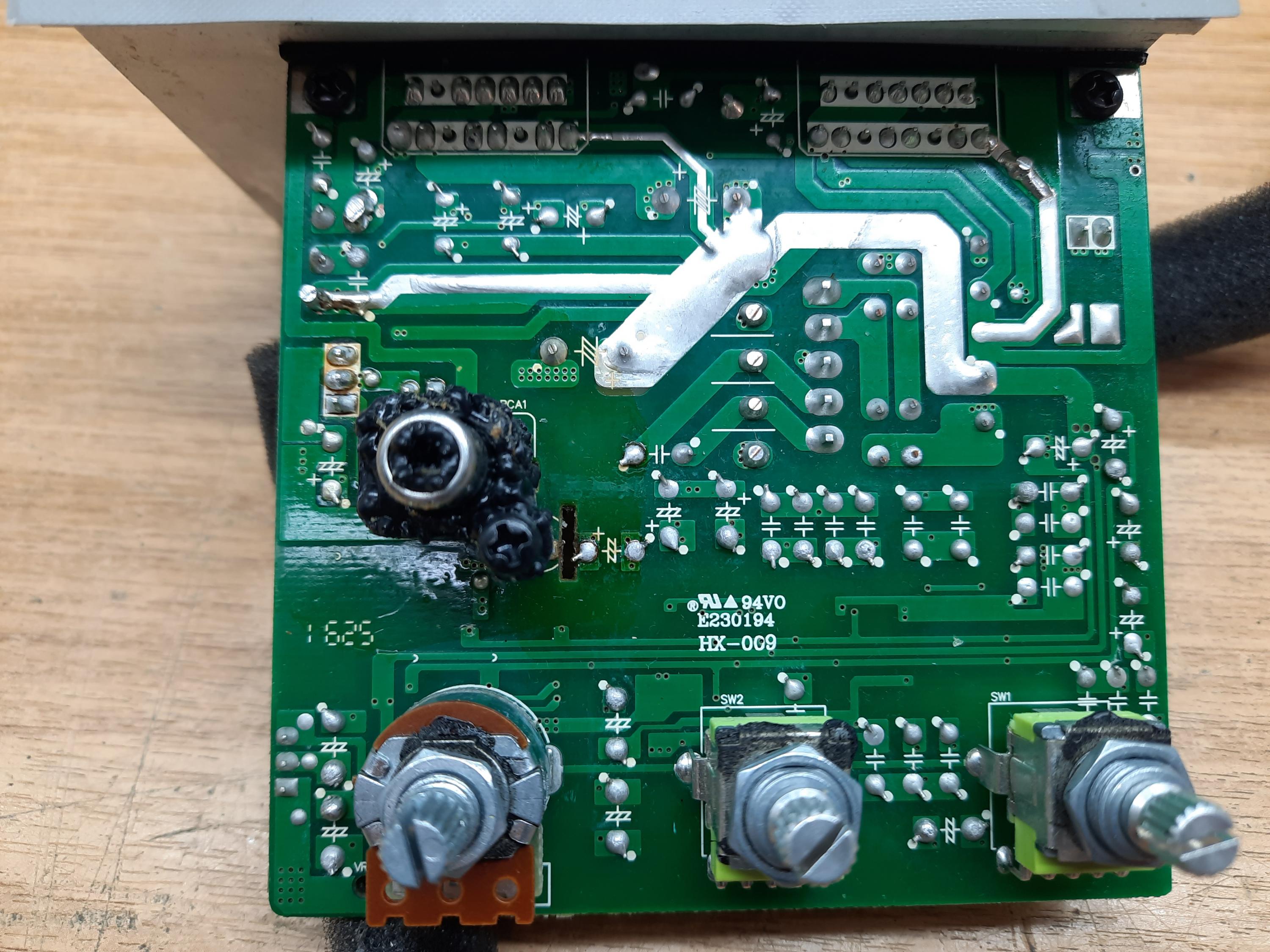

        Spent all day removing glue from this piece of crap board.
        All electrolytics checked out good, which is a surprise.
        Reflowed loads of joint, even though nothing definite found.
        Also manage to cook the RCA port, when I had board sitting on my pre-heater, but luckily had a replacement.
        Anyway, now working on test.
