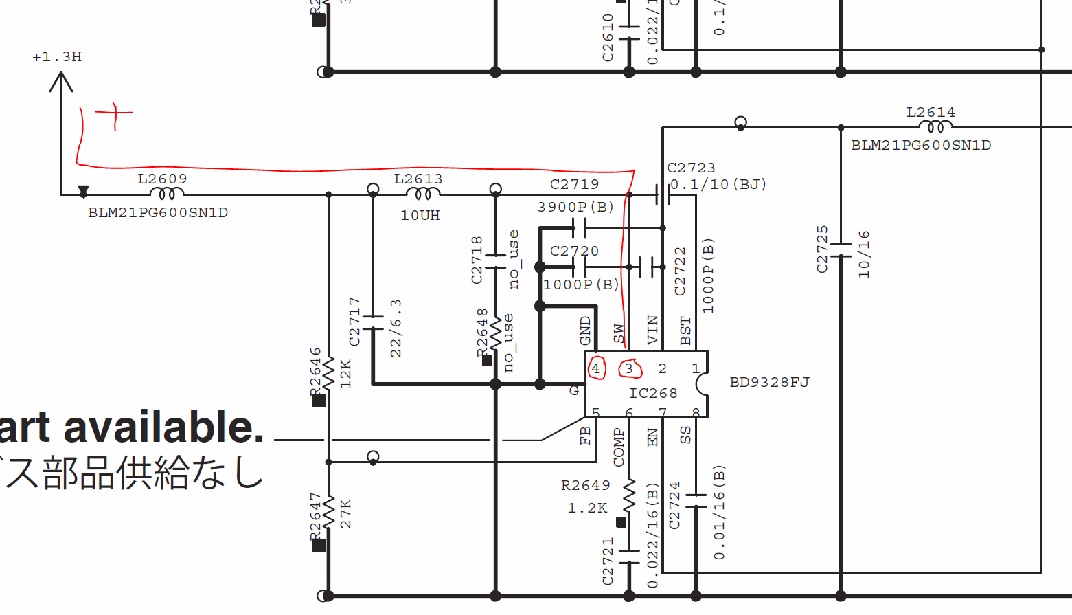

    I've a Yamaha RX-V373 which does not power up, only main relay clicks and then falls back, already checked the following:
    - DIAG or Advanced menu does not work
    - All relevant sub voltages are available (5-7-12V)
    - According to the SM,IC's 268-262 and 261 should give 1.3V, 1.2V and 3.3V but at all I measure around 7V at pin 1 (so output voltage is equal to input voltage 7V)
    - As a try I swapped IC-262 for a new one but still measuring 7V output.
    - As these 1.3,1.2 and 3.3V voltages are feeding processors (a.o. uP and DSP) I assume this is the reason why the unit doesn't start up due to the voltage errors. For now I'm stuck where to look further and am hoping that someone had the same issue and can provide some tips/guidelines. Any help is welcome.

    I suspect you are using the wrong ground to check the voltage, use the DG digital ground for these voltages. I suspect the unit is going into protection due to a faulty audio output ic.

      Hi RJ, ok I've measured between pins 1(+) and 4(ground) of the IC's but still have around 6V in stead of the 1.2V and 1.3V what it should be....

        What are you measuring? You need to measure not between 1 and 4 pins, but between 3 and 4 pins.

          Tnx, see the mistake I made, measuring between 3-4 of the IC's provides the correct voltages. Also on the UPc IC voltages are correct so it may be assumed that the start up circuit works ok. Will check if UPc sents out start PWR RY 3.2V.
          Also checked the 0.22 ohm protection resistors of the driver ic's but they all measure ok, so any reason to assume that the issue could be one of the IC's? Again I would expect in case of faulty end stage that at least unit would power up and then shuts of due to protection and you still would be able to enter DIAG menu, which is not the case. Display doesn't light up in any circumstance..tnx again for your support.

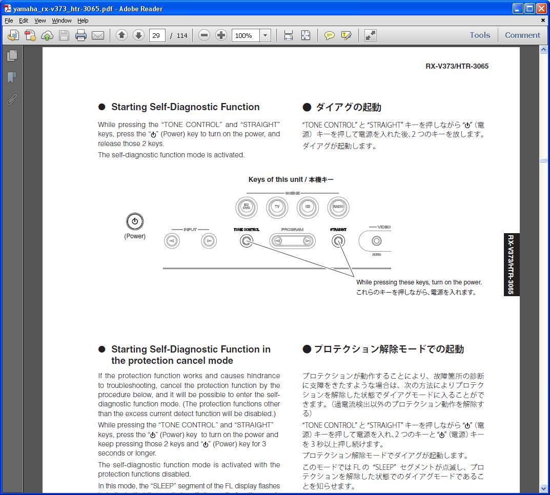

            Try this - connect to the network (220v) hold down the "TONE CONTROL" and "STRAGHT" buttons and press "POWER"

              Re: Yamaha RX-V373 not powering up
              More - Unplug the receiver
              Hold down the "TONE CONTROL" and "INFO" buttons
              Then connect the receiver to the network
              And then press the "Power" button and hold all 3 buttons for at least 3 seconds.

                Hi lotas, that's what I tried already > getting in DIAG menu (tone control + straight + power) or Advanced Setup Menu (tone control + info and connect to power outlet). In both cases receiver does not start, only main power relais comes up and falls back again, so it doesn't look that protection circuit is activated, unit simply doesn't power up.

                                  it's already quite a while ago but recently I picked up this issue again with the RX-V373 and managed to resolve it at 4 receivers: I did change the STK-433-33 but units still didn't start, also not in DIAG mode. Now the trick: for this units entering the DIAG mode is not to use Tone control & Info buttons but Tone control & Straight buttons. The the units started and I could remove the error message which prevented the units to start, even with a new STK module soldered in. Once done all units worked properly a they should.
                                  Simple but I hope this will help fellow forum members. Cheers.
                                  • R_J
                                    • Jun 2012
                                    • 9624
                                    Actually the manual for this model says for Starting Self-Diagnostic Function, While pressing the “TONE CONTROL” and “STRAIGHT”
                                    keys, press the “ ” (Power) key to turn on the power, and
                                    release those 2 keys.​

                                      Hi R_J, correct and you suggetsed earlier as well but I kept Iotas'message in mind and used tone control/info (which is used on majority of Yama devices), my bad and typical case of RTFM..... My actual point is that even with new STK's the unit stays in protection mode unless you clear the messages. I haven't seen that on other series of Yamma. Tnx for all support!
