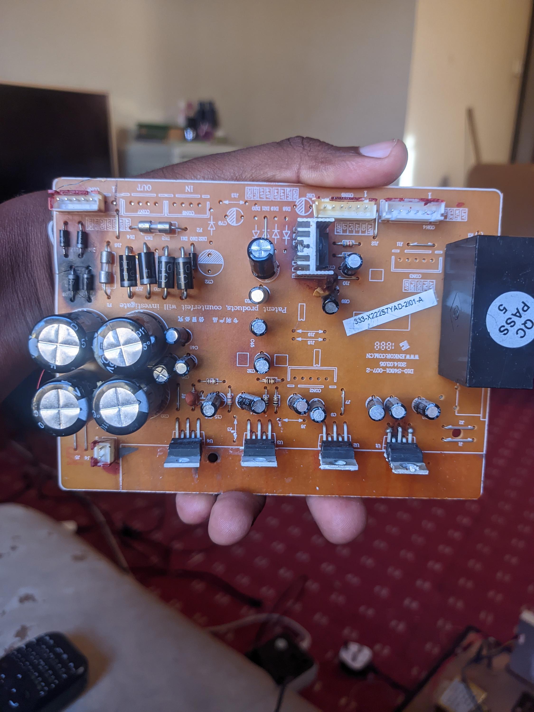

    Hello friends, how are you doing? I have a 2.1 music system that makes scratching sound when I power it up, but after like 2 minutes it comes back to normal, after some minutes of playing musics, its Bluetooth hang and I have to switch it off then on again for it to work. I have checked all the caps none has a problem, please help me out

    i would start with replacing those 1n4007 1a diodes with a 4a bridge rectifier!!!

      "Patent products, counterfeit will investigate"

        Checked the caps with what exactly?

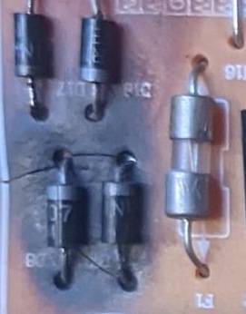

        The board is basically destroyed here, take a look on the bottom, I guess the solder is melted and you have a bad connection:
        As stj said replacing this with a proper rated bridge rectifier would be one way to go.
        Another would be to throw it in the trash where it belongs:
        Whenever I see a silly fuse like that I just know the manufacturer is trying to burn my house down!

          Re: Von Hotpoint 2.1 subwoofer
          I did, all okay now thanks 🙂
                Originally posted by sarry86
                Bro, in our developing countries, these types of gadgets are all we can afford. Please don't hurt my feelings 😢
                That's not at all what I meant.
                The device would not have been more expensive to design correctly: Use a fuse with the proper distance/length.
                And place the diodes higher off the board with proper spacing, they come with long legs from the factory for a reason...
                The fact that these companies in China makes such rookie mistakes even when they save no money by doing so just shows that they don't know how to design a safe circuit.
                Having your house burn down is no fun no matter where in the world you live!
