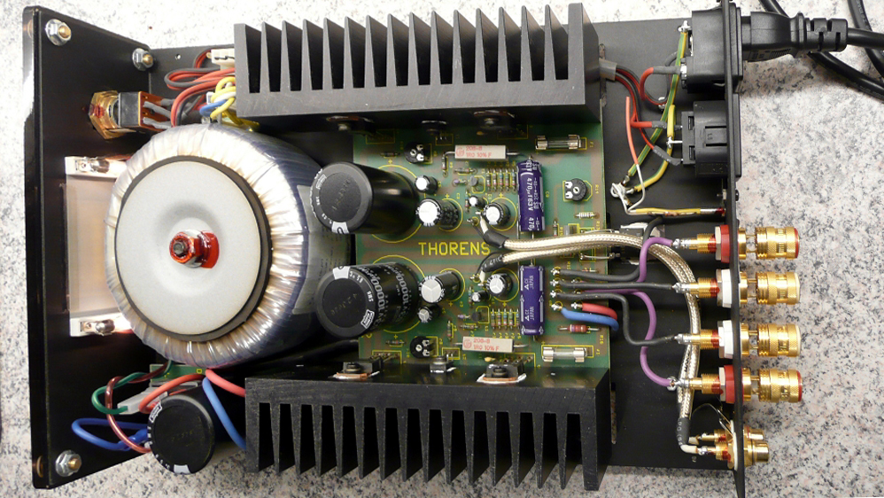

    Hi, I bought Thorens TTA-2000, but I am affraid connect speakers because DC offset between the +/- terminal are 2,5V!!! This is normal value on this "A" class amplifier or is this faulty?

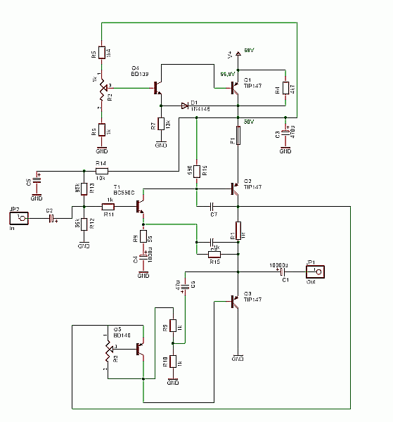

        zoldi, can you download the schematic from that forum and post here?
        Do both R, L channels have the same offset of 2.5V?
        • zoldi211
          • Feb 2016
          • 26
          • Slovakia
          Re: Thorens TTA-2000 DC offset
          Hi, schematic on german forum is incorrect. I found one in korean forum and this have only one error, R11 are before R12,R13. Some values are also incorrect, but there are only minimal differences. I measured input voltage: 71V, voltage after trimmer 53V. Voltage between R1 pins: 0,380mV. Heatsin after 30 min 60°C, but this is normal with this amplifier!

                                As others have mentioned, this amplifier is not DC-coupled to the loudspeaker. It uses a large coupling capacitor C1 10,000uF
                                So your DCV reading is likely due to small leakage currents in the big cap. In pictures this amp has a speaker protector relay board? Does it have one?
                                I did blow up an amp Dynaco ST-120 which also uses huge output-coupling caps. You have to be careful.

                                  Now that I look closer at the schematic in post 5 I see the output cap. so I guess there is no _____ adjustment.
                                  I don't think the stock unit has speaker protection.

                                      I think you need a speaker relay to stop the huge thump until the output caps charge up. Not for (shorted output transistor) protection.
                                      There are pics of TTA-2000 with and without one. It might be a mod or add-on. The old Dynaco ST-120 used to make a loud thump with woofer cone lurching out on power up, and slowly sinking back in until output cap charged up.
                                      I don't know what the trimpots are for.

                                        The test is done. With old speakers and 1A fuse, because I dont have suitable resistor. After turning on, the current disappeared. I measured only 0,04 or 0 mA.
                                        A have a version with protection board with relay (1. photo in post #19).
