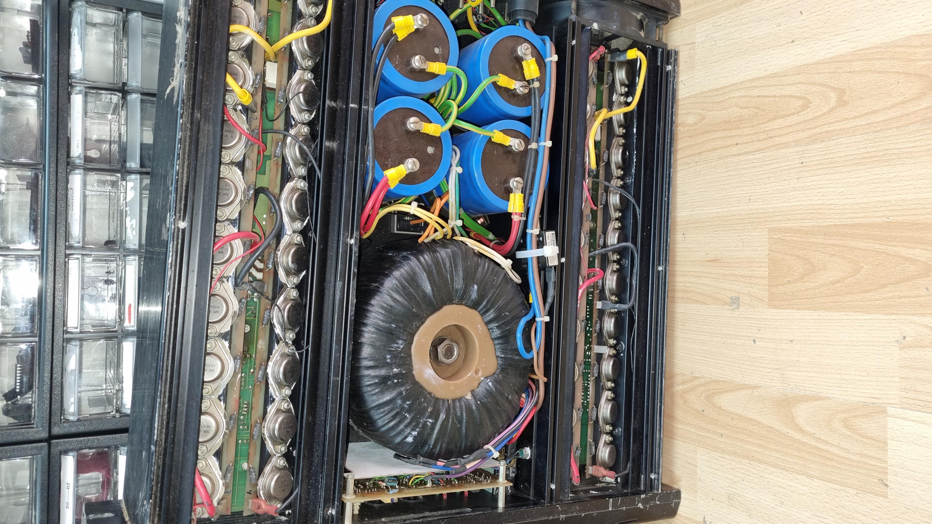

    Hi guys, this is general query really
    So I have a Hill DX3000 3KW audio amplifier here.
    It has a topology/design like a class A/B but all the banks of output transistors (10 transistors in each 'side' of the channel) are NPN.
    I was wondering what class this is. It doesn't fit the description of class A.
    It also doesn't match class A/B or B amplifiers as all the examples I see have a complimentary output stage desigs (NPN/PNP) and clearly is not G, H or D
    I looked for 'class A push pull' but that didn't tell me anything either
    Here is the schematic. So what is it?
    OOPS WRONG PIC - On moment
    thanks

    Re: What 'class' is this Hill Audio DX3000 Amplifier?
    Try this pic
      Without looking at the schematic, likely Class AB.
      AB can also be all NPN or all PNP power transistors.
      Now after looking at the schematic, it indeed has a quite unusual design, but seems to fit just as well - still has all the characteristics of an AB design.
          @eccerOr
          The manual you provided describes it on page 5 as a "Super A" sliding bias configuration. See the first paragraph in the Operation section.
            The main characteristic of class B is evident in the design however - since only half of the transistors are on during a specific half of the waveform. Yes this design leaks like a class A but not as much as so due to the half waveform design, so it's tough to classify these.
            I don't see any advantage of this over a traditional AB design, just costs more with ugly transformer coupling...
              I read an article that described it as an A+B type. The design is derived from Technics.
