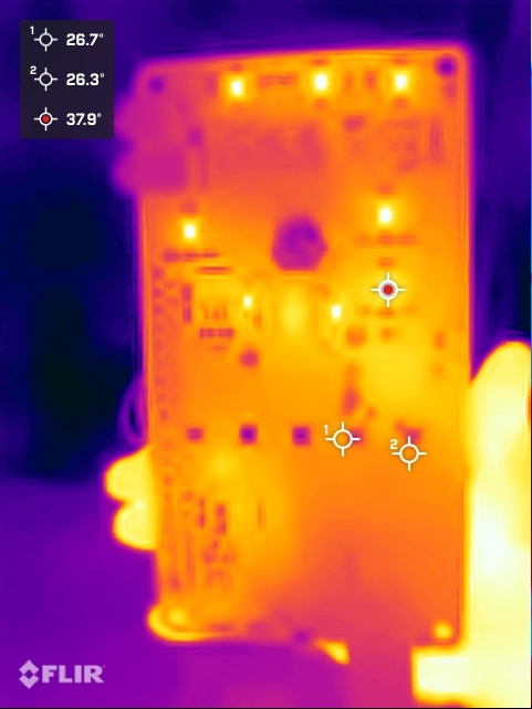

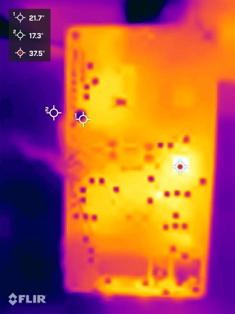

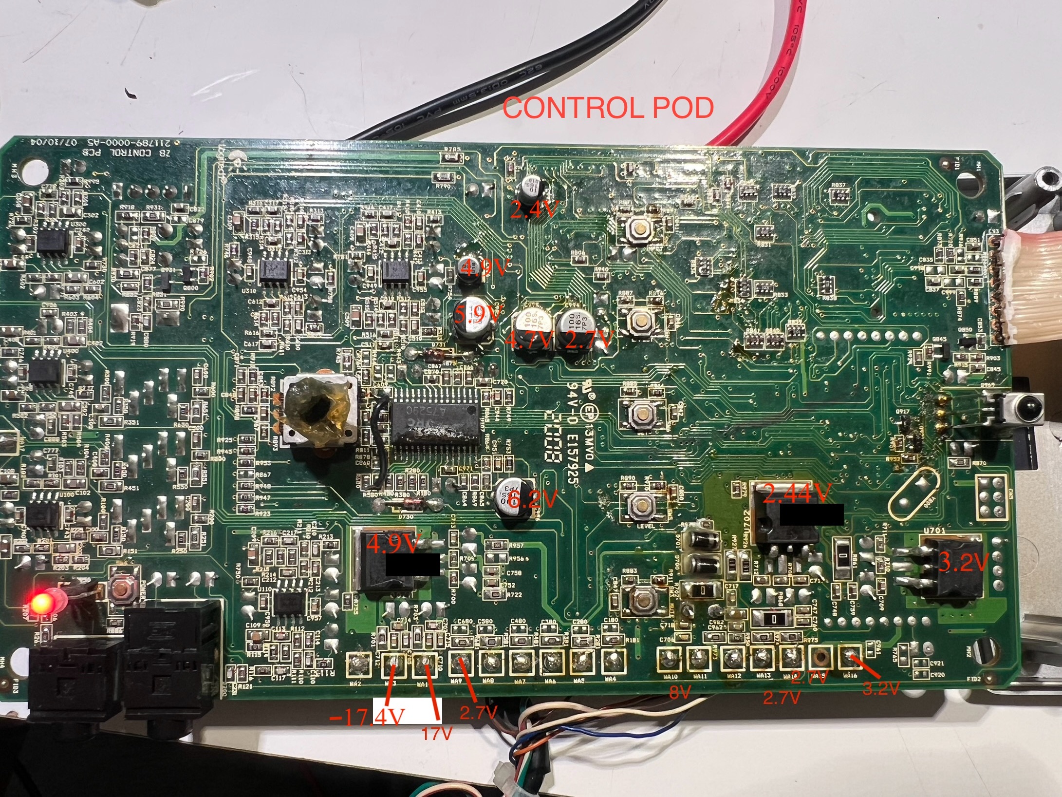

      I made an error measuring the LM317 regulators — the voltages actually look good. That makes me suspect other op-amps may be damaged.
      FYI, current power consumption is: standby 14 W, turned on 23 W, and just sub (without control pod) 5 W. Previously, when an op-amp was shorted, the unit drew 100 W.
      Standby still uses a lot of power. It makes me wonder if that are perks of an old design or some other fault?
      On the IR camera all the op-amps are heating up and the ADC appears to be operating as well.
      All pics are of control pod.
      What should I check next?
      • kuba2102
        • Jan 2020
        • 45
        • Scotland
        I’ve figured out that the reason it only works in Stereo and Optical mode (I haven’t been able to test Coaxial) is because in any other mode (Dolby PL2 Movie/Music, 6-Channel Direct, or Pink Test) it goes mute. The Control POD pulls pin 8 low, which are the MUTE pins. Now I need to figure out why it’s pulling that pin low when it shouldn’t.
