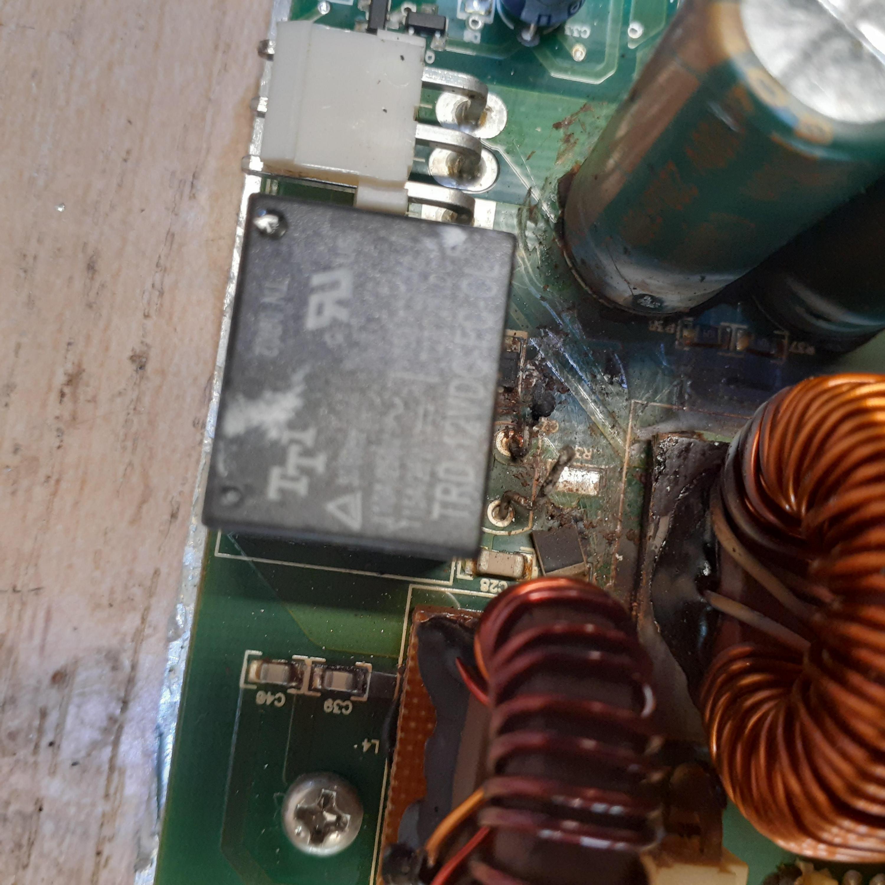

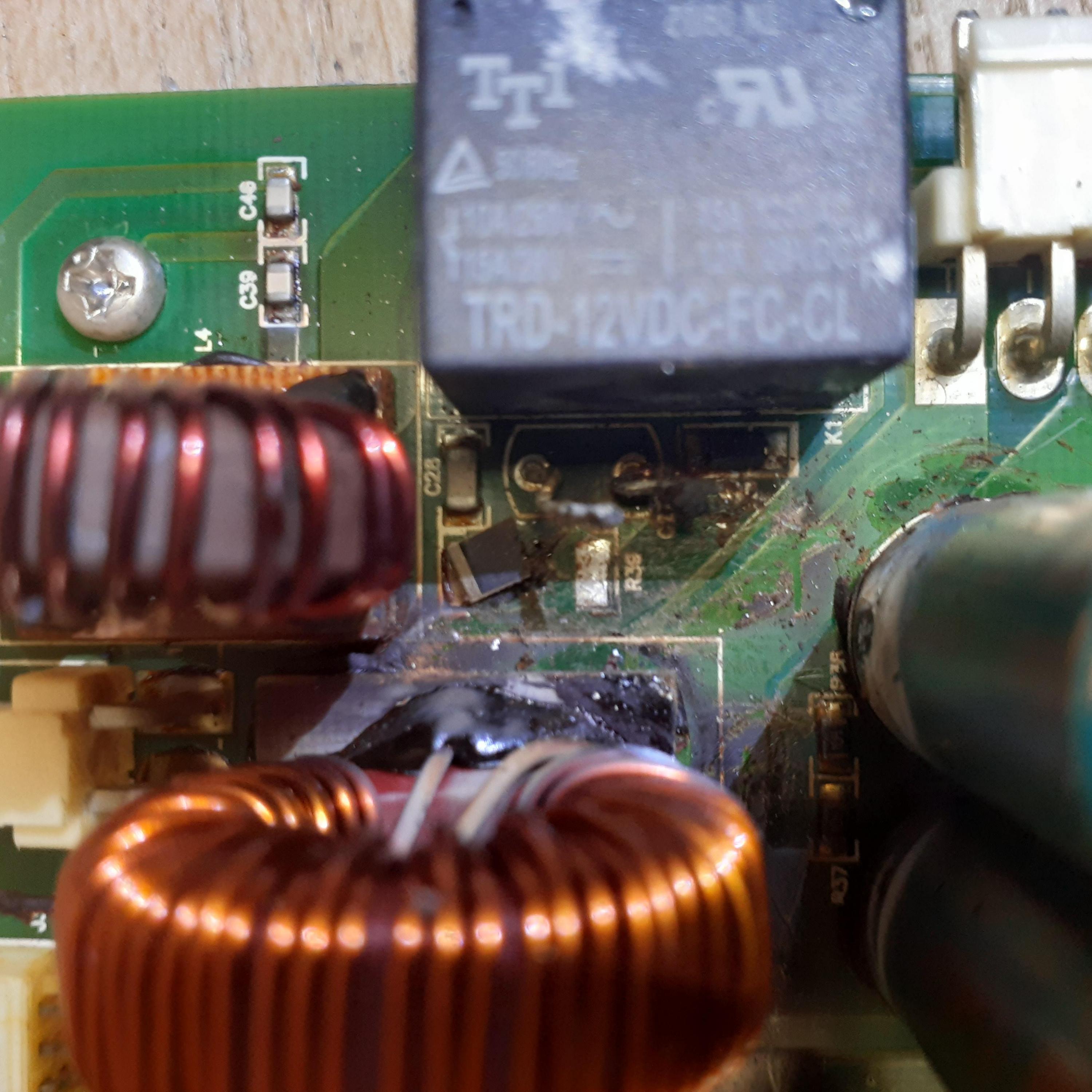

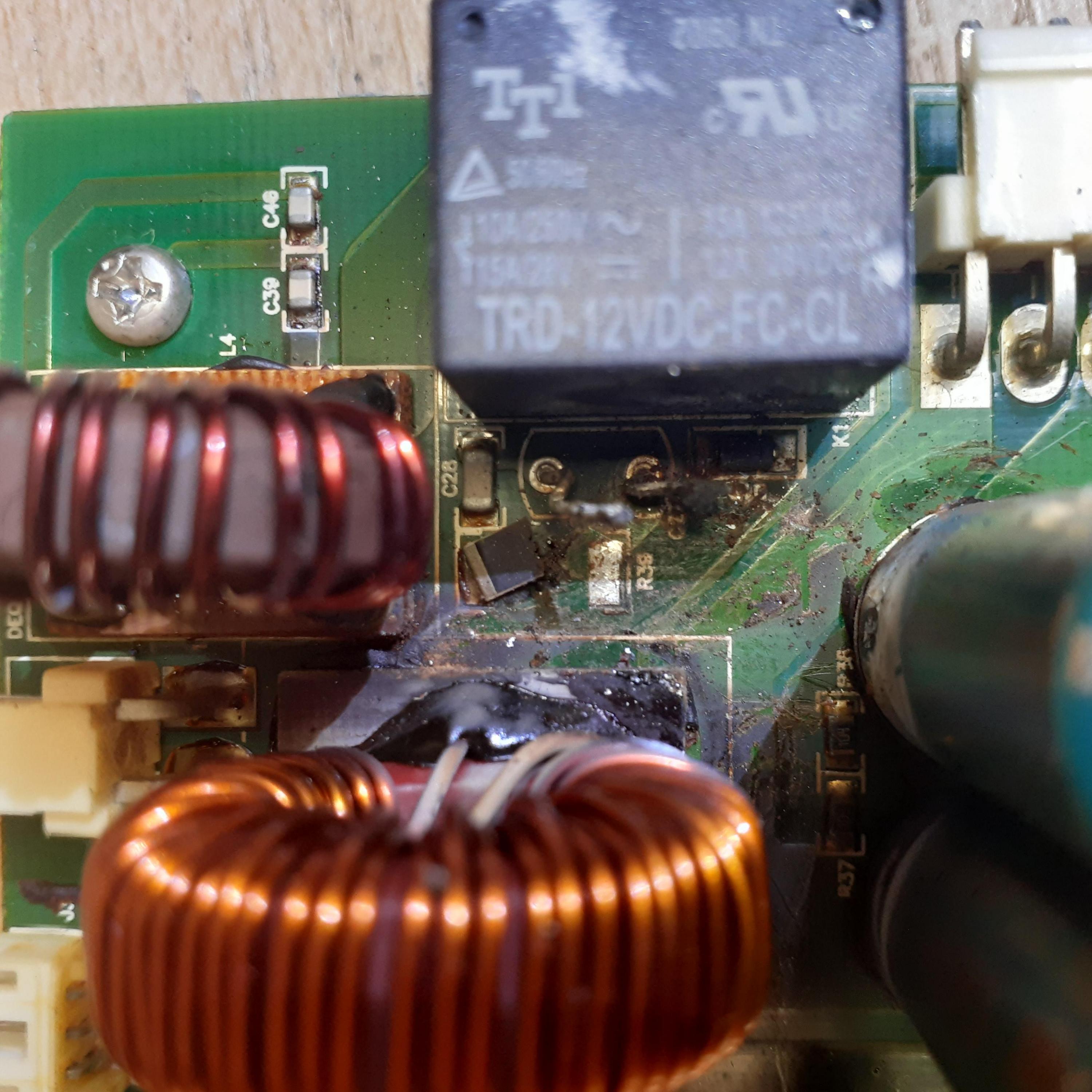

    Subwoofer VeloDyne DLS3750
    Hi, I have this subwoofer to repair , it have capacitor completly burn in board see photo, a resistor on location R39 is burn too, can someone know the value of this resistor ?
  • lotas
    • Jan 2016
    • 4938
    • Russia

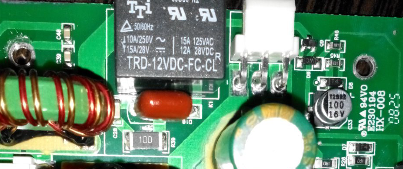

    Re: Subwoofer VeloDyne DLS3750
    R39 -10 Om
    C27 -0.47mF 100v (change to 250v polypropylene)
    C28 - smd 0.33 mF
