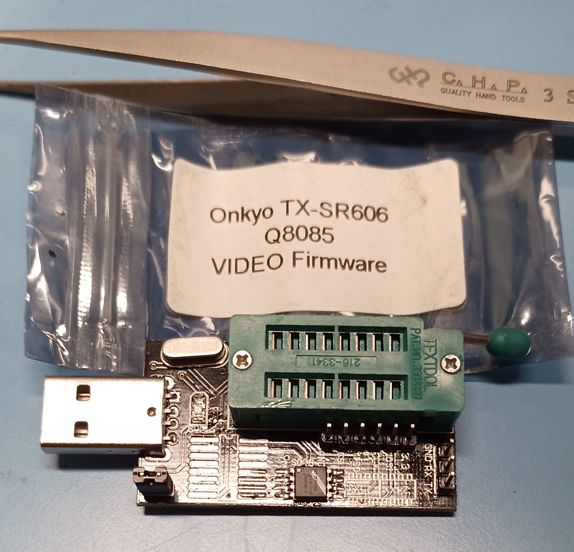

                    Re: Onkyo TX-SR606
                    I got another 606 to repair with a bad HDMI board. But it still had a working videoprocessor so i could make a copy of the firmware in Q8085
                    So if you need it see the attachment

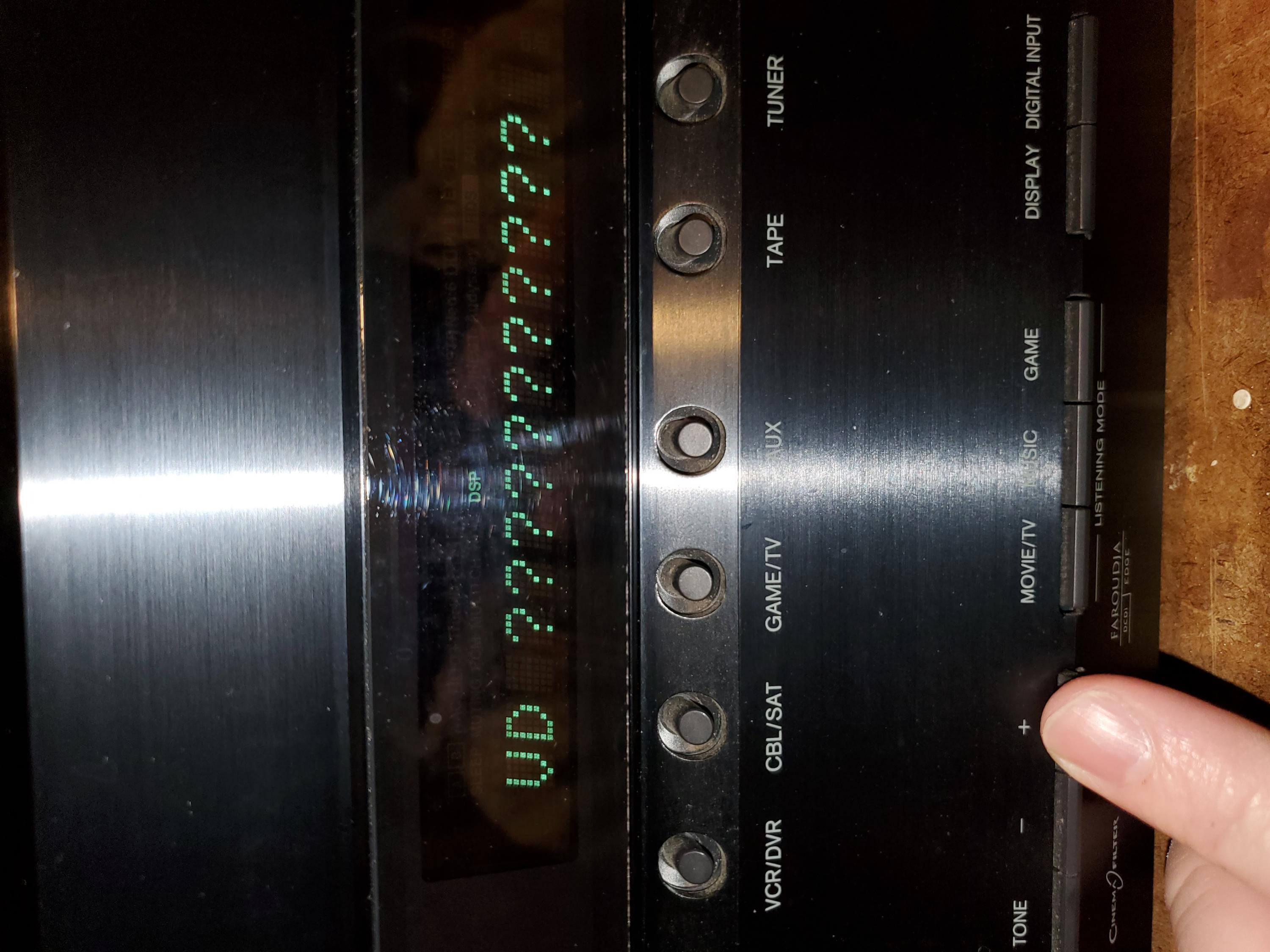

                      Re: Onkyo TX-SR606
                      Thanks for the firmware debruina. I got the rca video inputs and OSD working again on my SR606. HDMI itself was working ok.The VD displayed ????????? and the Q8085 was indeed blank. I replaced all the 100uF 4V caps too. The sr606 q8085 firmware did not work first time but the sr607 firmware did, although OSD only had three options. I then reflashed your SR606 Q8085 firmware and works perfect. I used a ch341a and had to take chip off with hot air as could not get sop8 clip working.

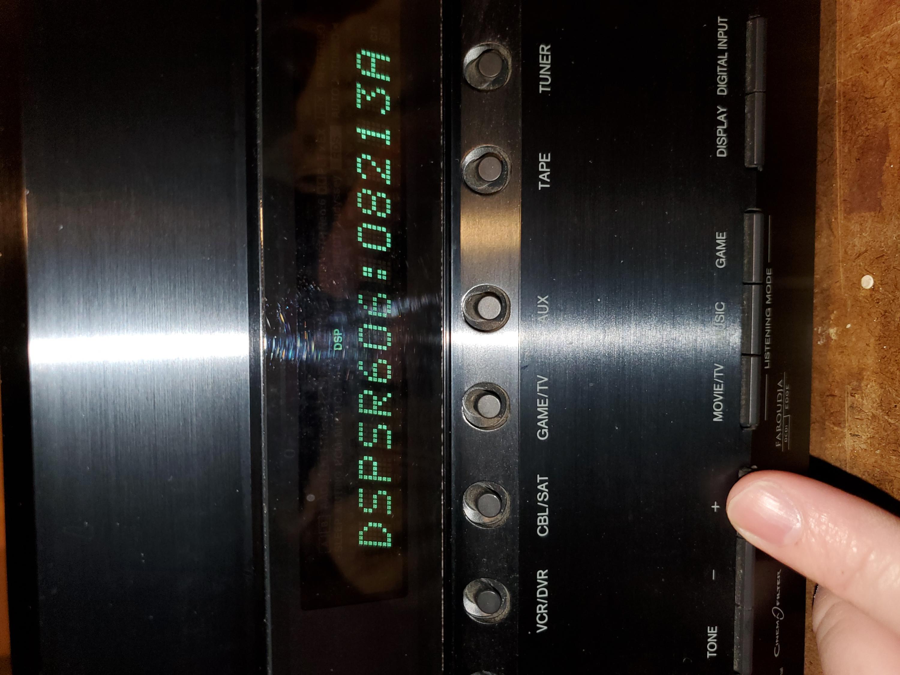

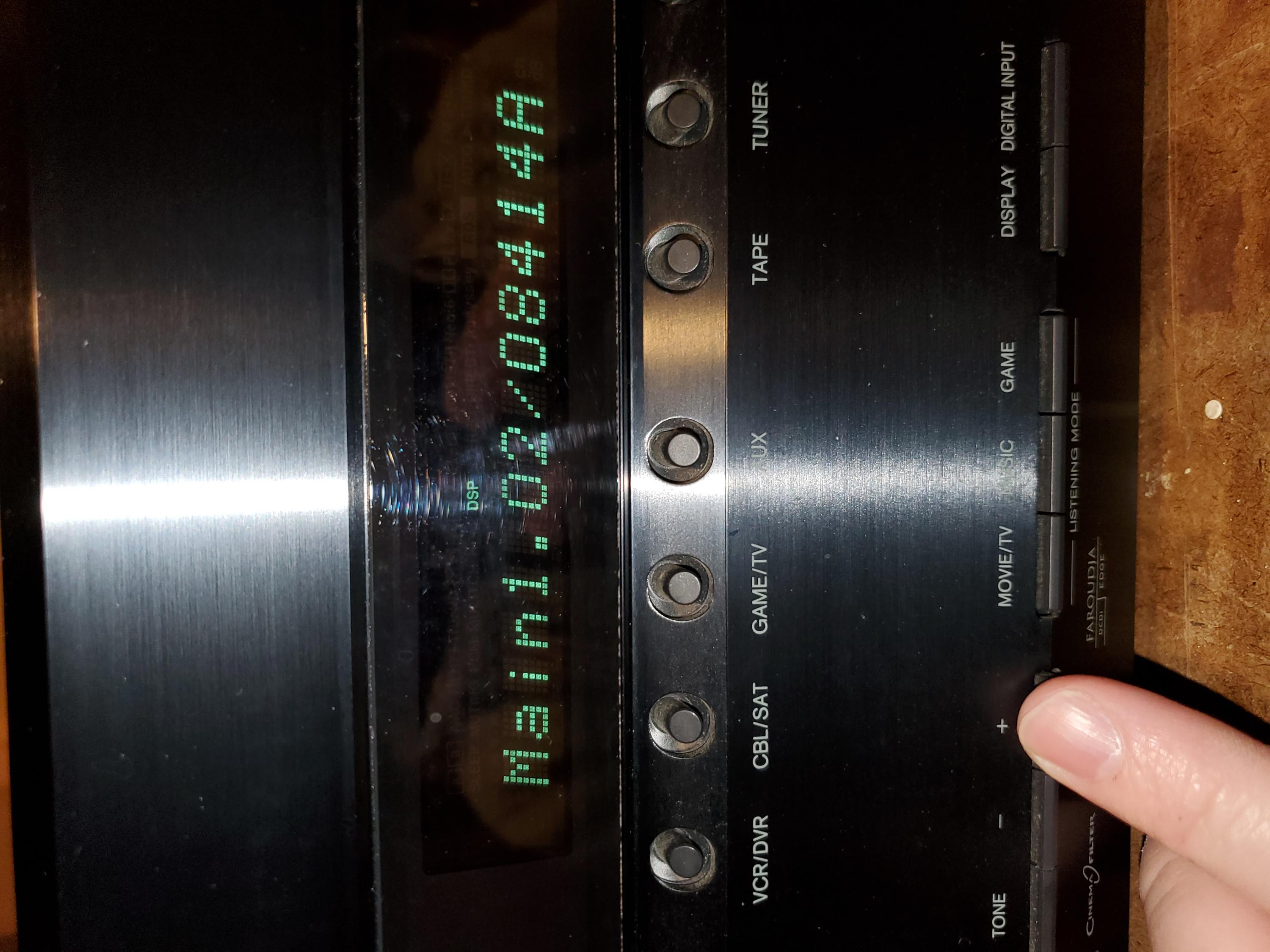

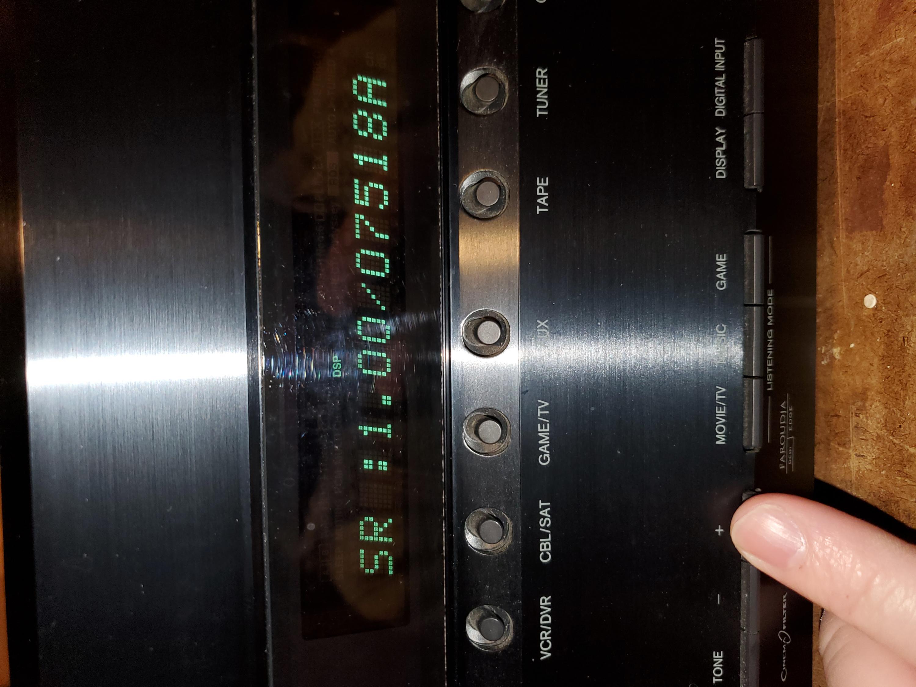

                      • ExplodingSidewalk
                        • Jan 2023
                        Re: Onkyo TX-SR606
                        Debruina,
                        Would you happen to have the latest firmware for the following Onkyo TX-SR606:
                        Main / DSP / SR / VID
                        Thanks for your help.
