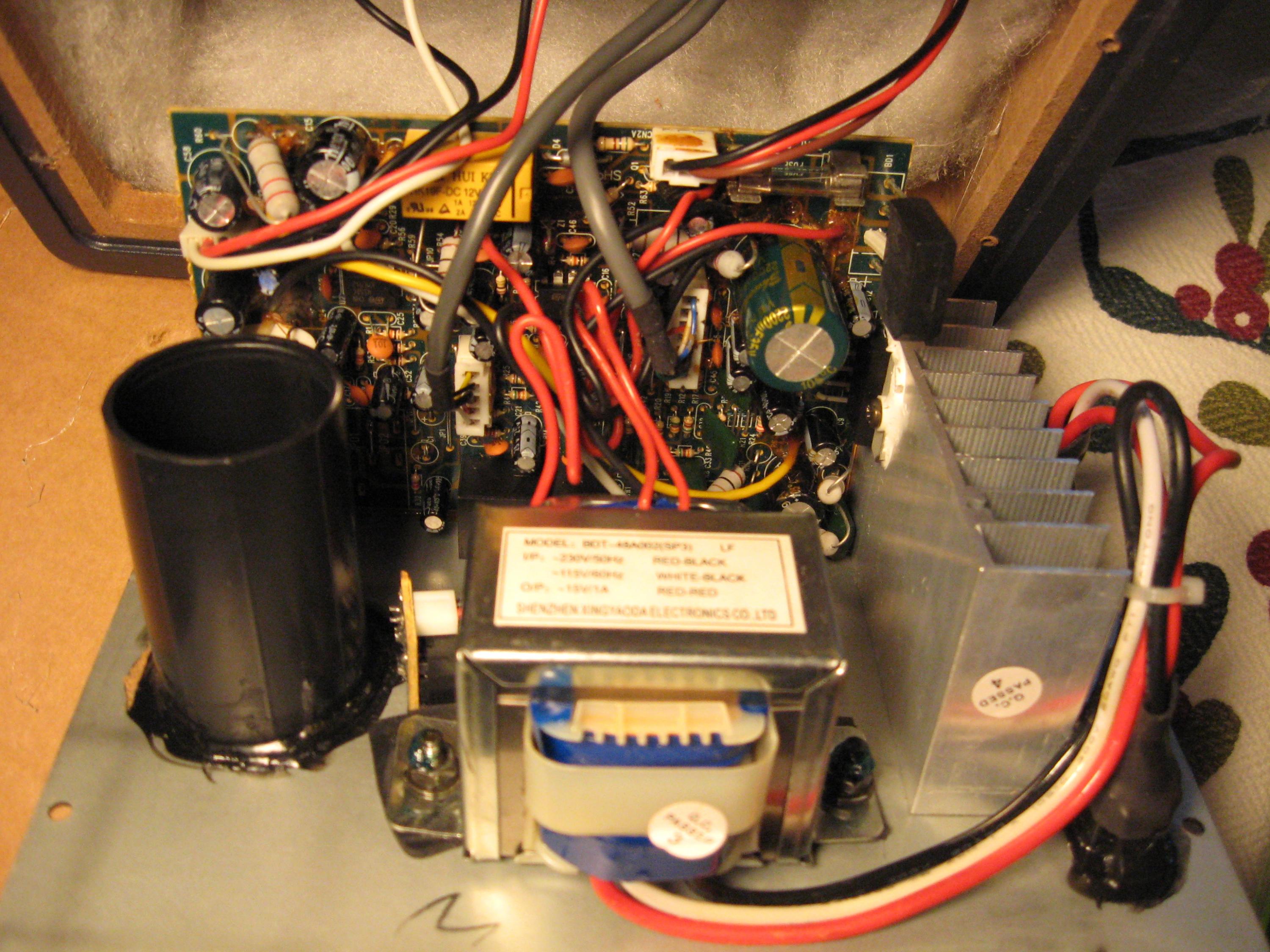

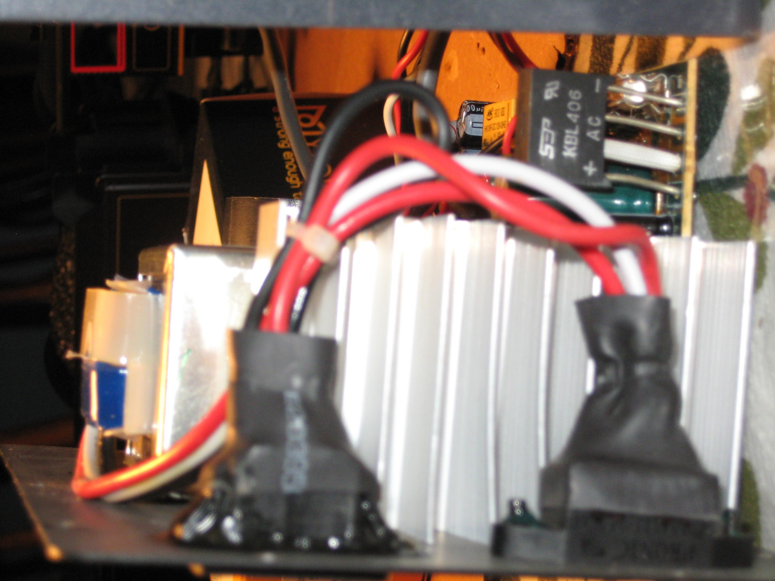

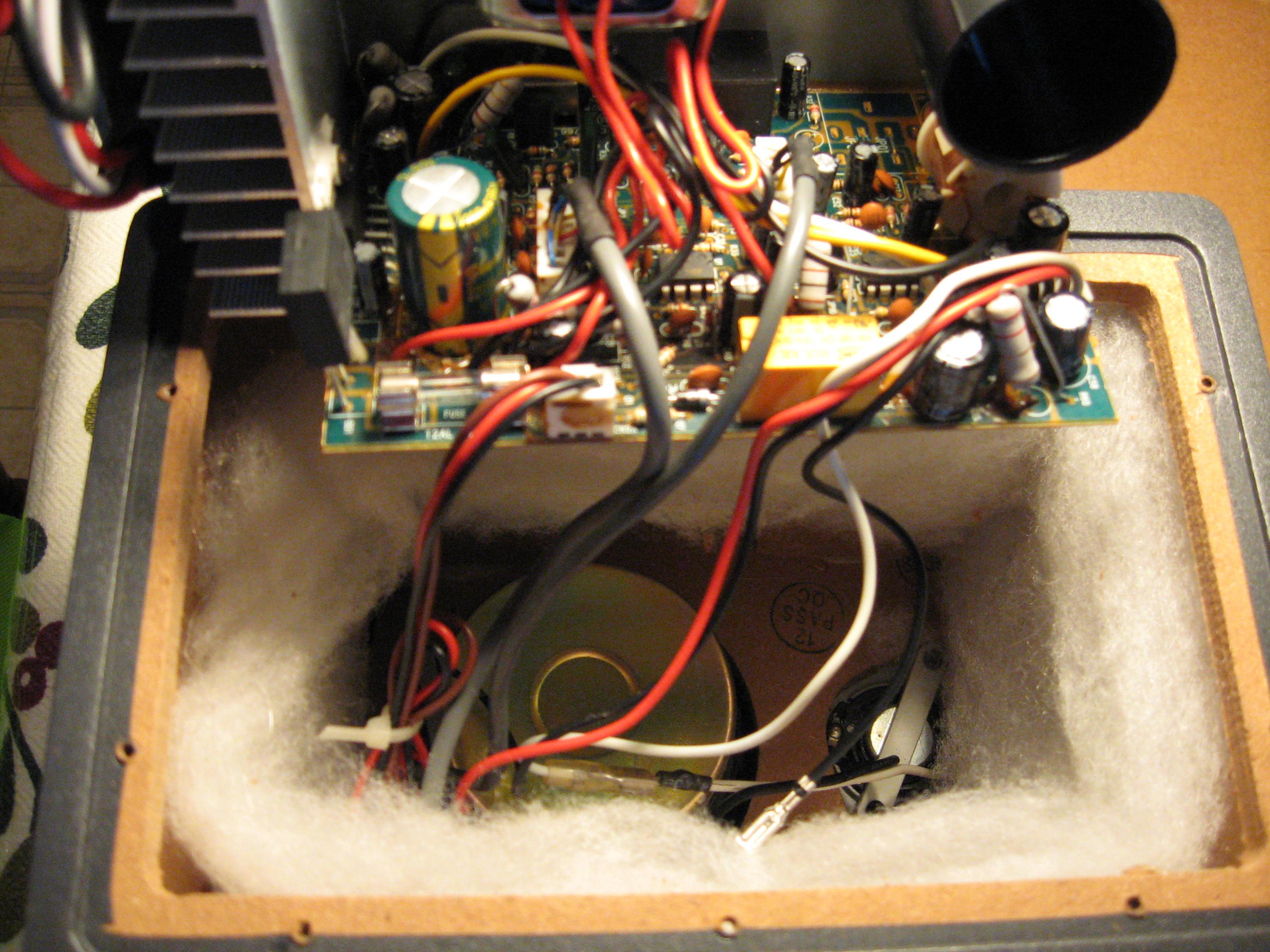

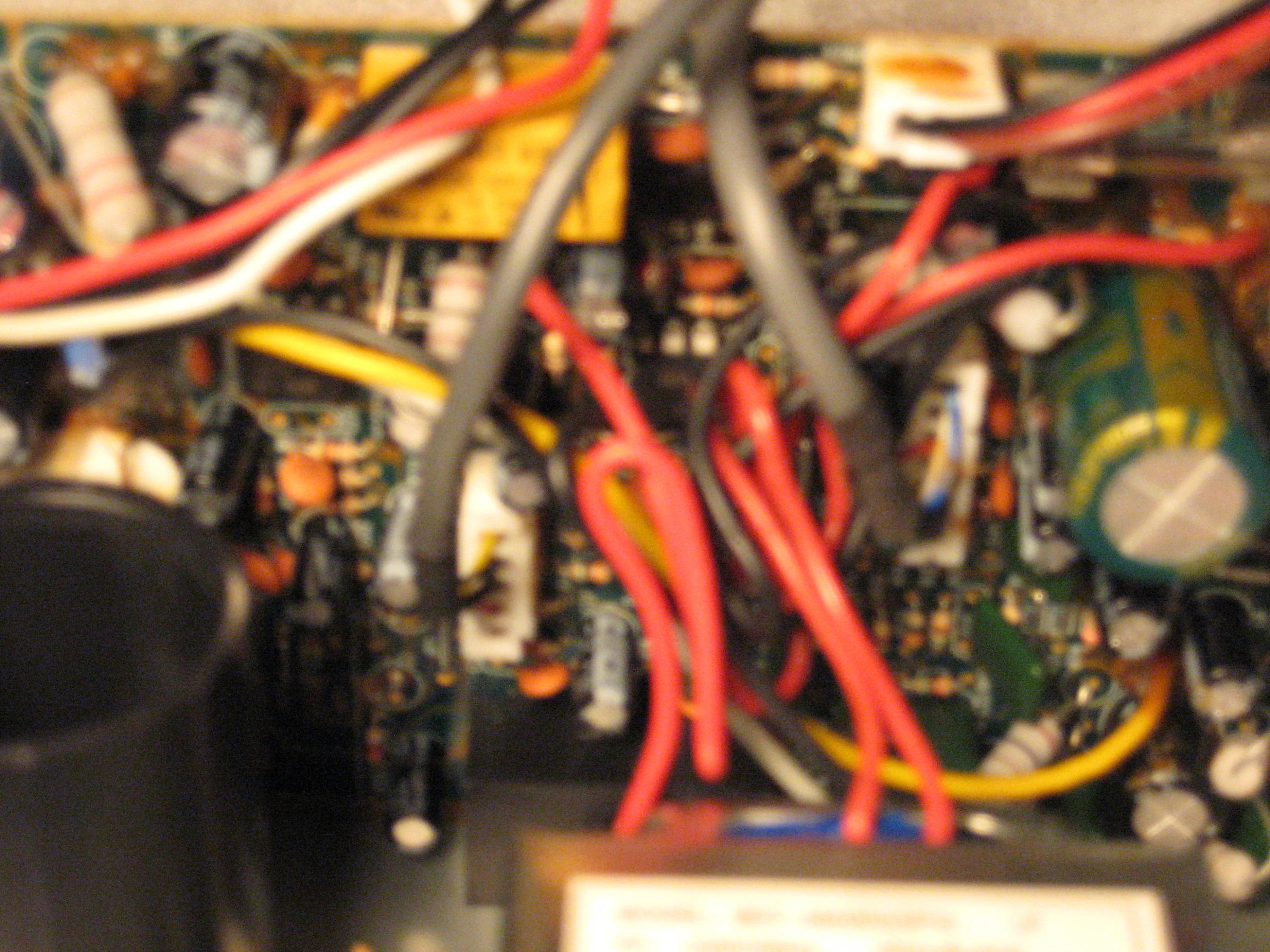

      Here is the PCB (Note: the red wire is a mod the guy who wrote the article did to bypass the amp to make then passive}
      https://blog.jonandtina.net/uploads/IMG_0301.png
      External view:
      https://media.guitarcenter.com/is/im...00-500x500.jpg
      My photos: (NOTE: The only large cap is the one I replaced that wasn't blown) None of the caps look like they are bulged or leaking. The brown smears are phenolic glue.
        • 31103
        Re: Powered Speaker Hum When Plugged In
        that's terrible, it could even be radiating between the nest of wires!!

          Actually, when I was experimenting to find the cause I disconnected the wires and separated the chassis from the speakers, then ran them to their jacks and the hum was still there. I kind of thought it was the transformer or the transistor (IC) mounted on the heatsink.
            check the rectifier
              check the rectifier
              DMM set to Diode:
              Blk lead of DMM to + of Bridge Rectifier
              Red lead to each AC leg of Bridge Rectifier
              Both read .486 V
              Red lead of DMM to - of Bridge Rectifier
              Blk lead to each AC leg of Bridge Rectifier
              Both read .488 V
              My understanding is that between .4v and .6v are OK
              John
