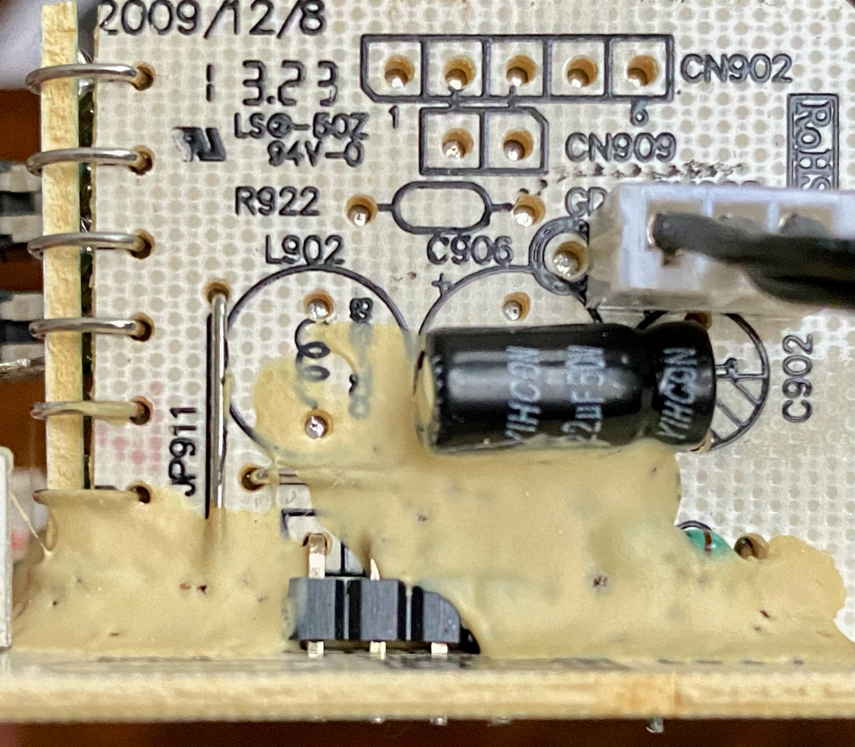

    I opened the sub, not being able to exactly pin point the source. I also didnt see any bulged caps, everything looks normal and smells new.
    Fun fact; Im pretty sure the sound dropped dramatically for a period when sub was upside down, being opened up.
    I have basic knowledge and repair skills like changing dead caps.
    Question is: Will I be fine with "drowning" the coils (I see at least 2) with eg. hot glue as a start?

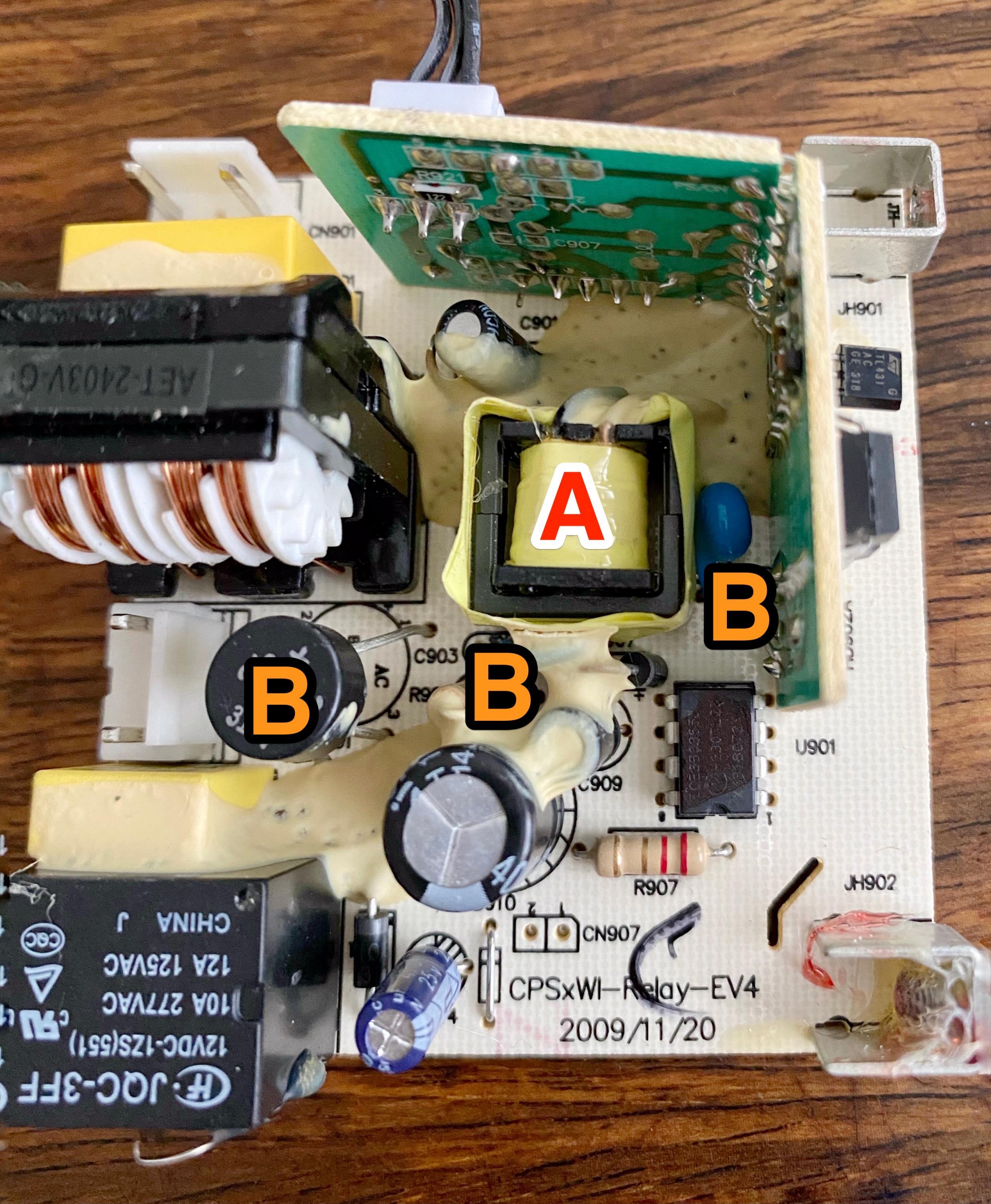

              The culprit is the coil wrapped in yellow paper or tape.
              This is to already reduce noise, correct? Its also covered in some guey but hard compound, I think that's called conformal coating. Even so its making an audible squeaky whine.
              Im pretty sure this is 230V in, and also the board that relays the sub in standby mode after a few minutes with no input. I have a suspicion whine is getting higher under load/after some time/warm, and worst when the unit then goes into stand by mode.
              When I press point A the sound wanishes or at least lowers a lot. When I press or poke points B the sound changes a bit but not as much as point A.
              Would it be enough to cover the ferrit with nail polish?
              I don't really have any RTV silikone or conformal coating. Just regular house hold stuff.

                Re: Boston Acoustics Soundware 5.1 SUB: Agonizing coil whine!
                oh, a transformer.
                it could be the ferite frame vibrating against the plastic inner part.
                  Phenolic/SRPB circuit board?
                  Awful tan glue on everything?
                  I think the power supply is a victim of "cost optimisation"
                  Could be noisy from cheaply made & loose transformer, or a cheap circuit design that runs noisy anyway (?) But as mentioned, you'd need a schematic to begin trying to figure that out.
                  I'd go with putting some kind of epoxy etc in the transformer to hopefully stop it vibrating - I'm sure stj has some good ideas about that.
                  I'd personally also get rid of all that factory glue if you want the thing to last any appreciable time. (It goes corrosive/conductive over time and destroys electronics, God knows why they still use it. Oh right, planned obsolescence.)
                      The ferrite on that transformer is not aligned well, that might be the issue.
                      But I would be really careful about realigning it as it could crack, and then it is game over.
                      Easiest might be to try to poke something under it, like a straw (sugrör) maybe that could work?

                            Thanks for your kind reply. There wasn't enough space around the transformer to get a straw in, so I choose another route:
                            I took some red varnish made specifically for coloring light bulbs, and gave the transformer a thick coating. After letting it drip and harden 24 hours, I also covered the transformer and the whole area in hot glue.
                            (SO FAR) the high pitched squeaking is completely gone and I am VERY happy!

                                I celebrated too soon. After only 6 hours of use the squeaky tone is back. Less than before but still noticeable.
                                Im probably gonna swap the unit for another 2. hand sub, but the repair was worth a shot.

                                  I wonder if the varnish/glue melted from heat and loosened up.
                                  Can you try something that has a higher melting point than hot glue?
                                  Perhaps desolder the transformer and dip it in a high temperature varnish or epoxy.
