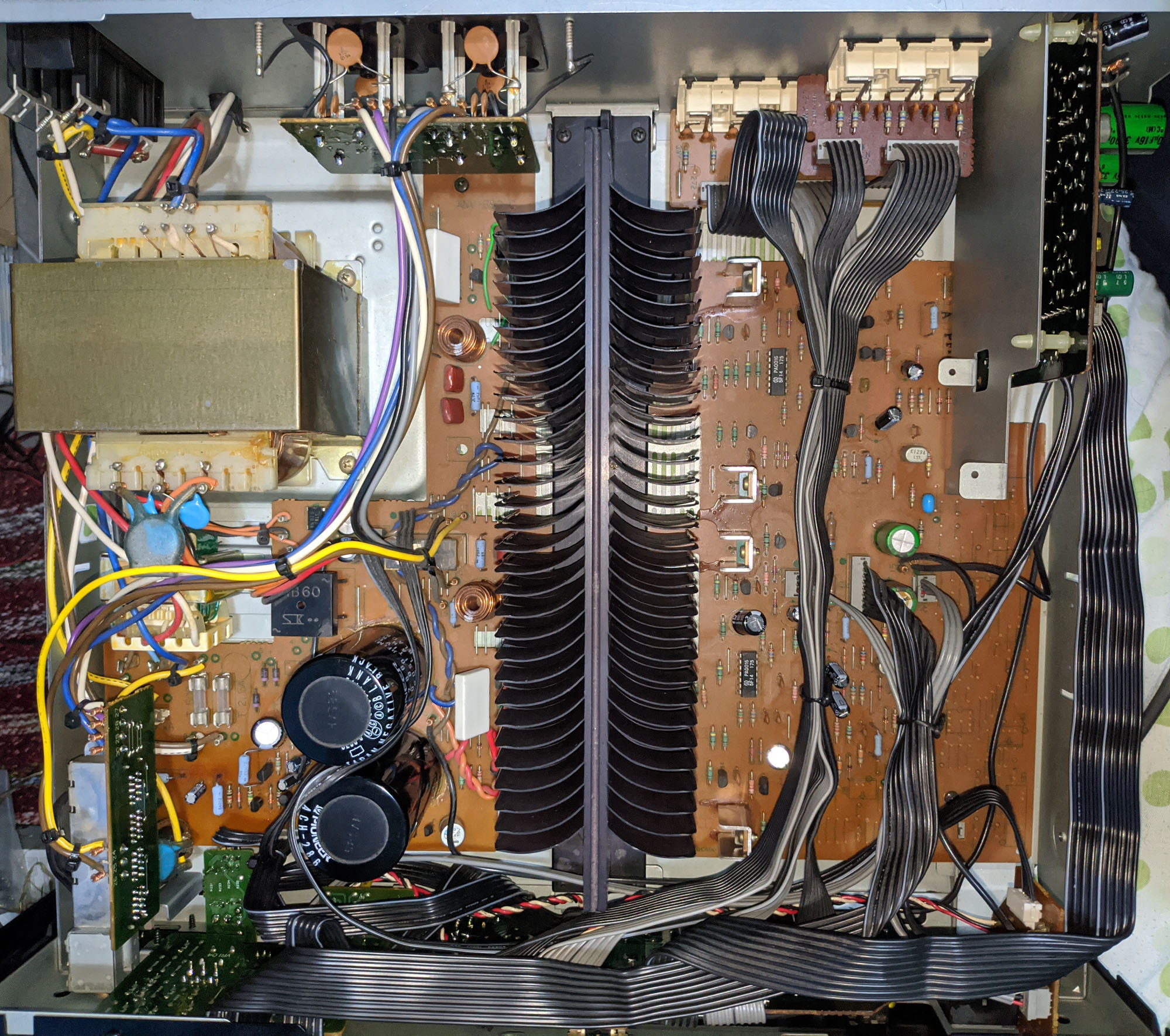

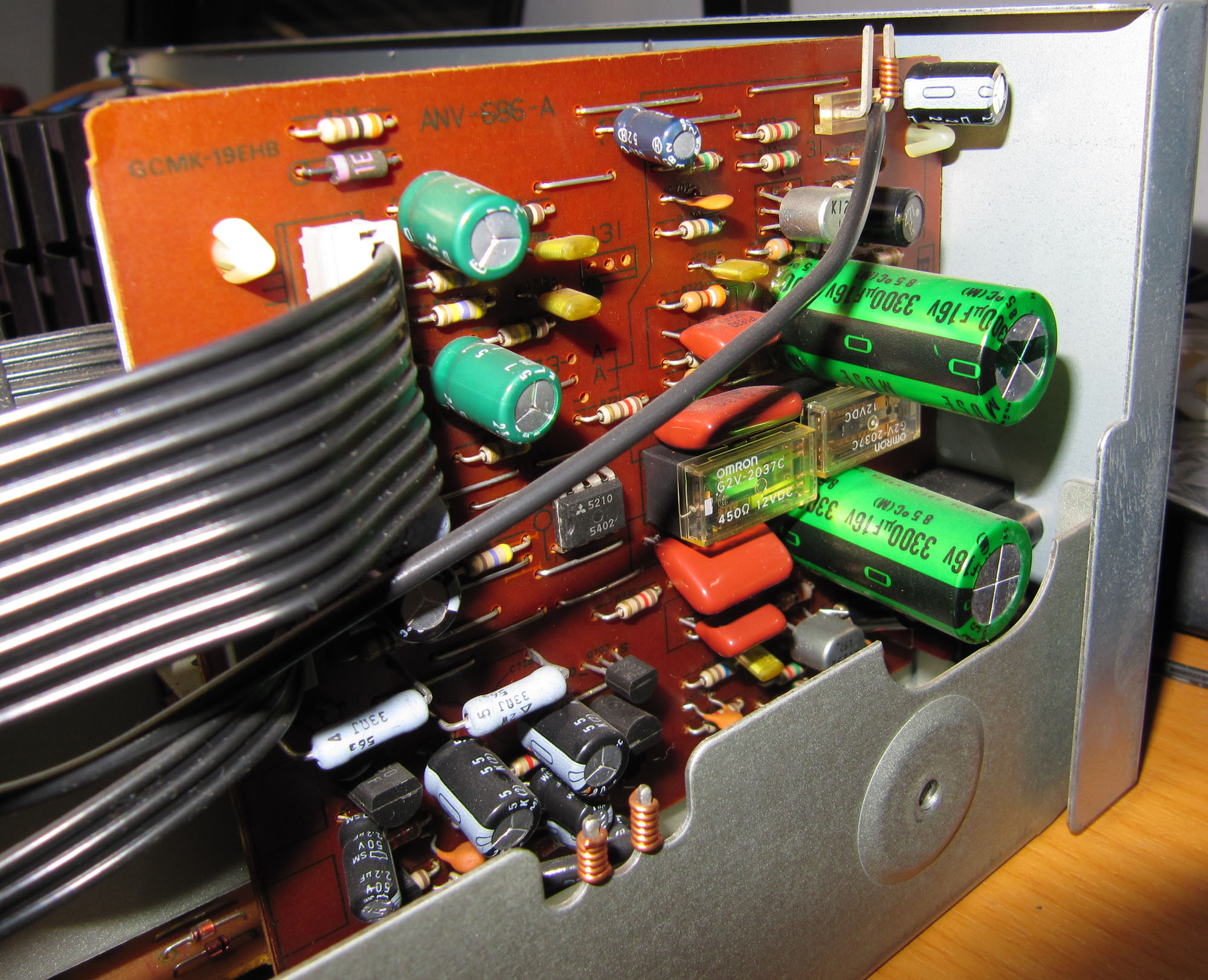

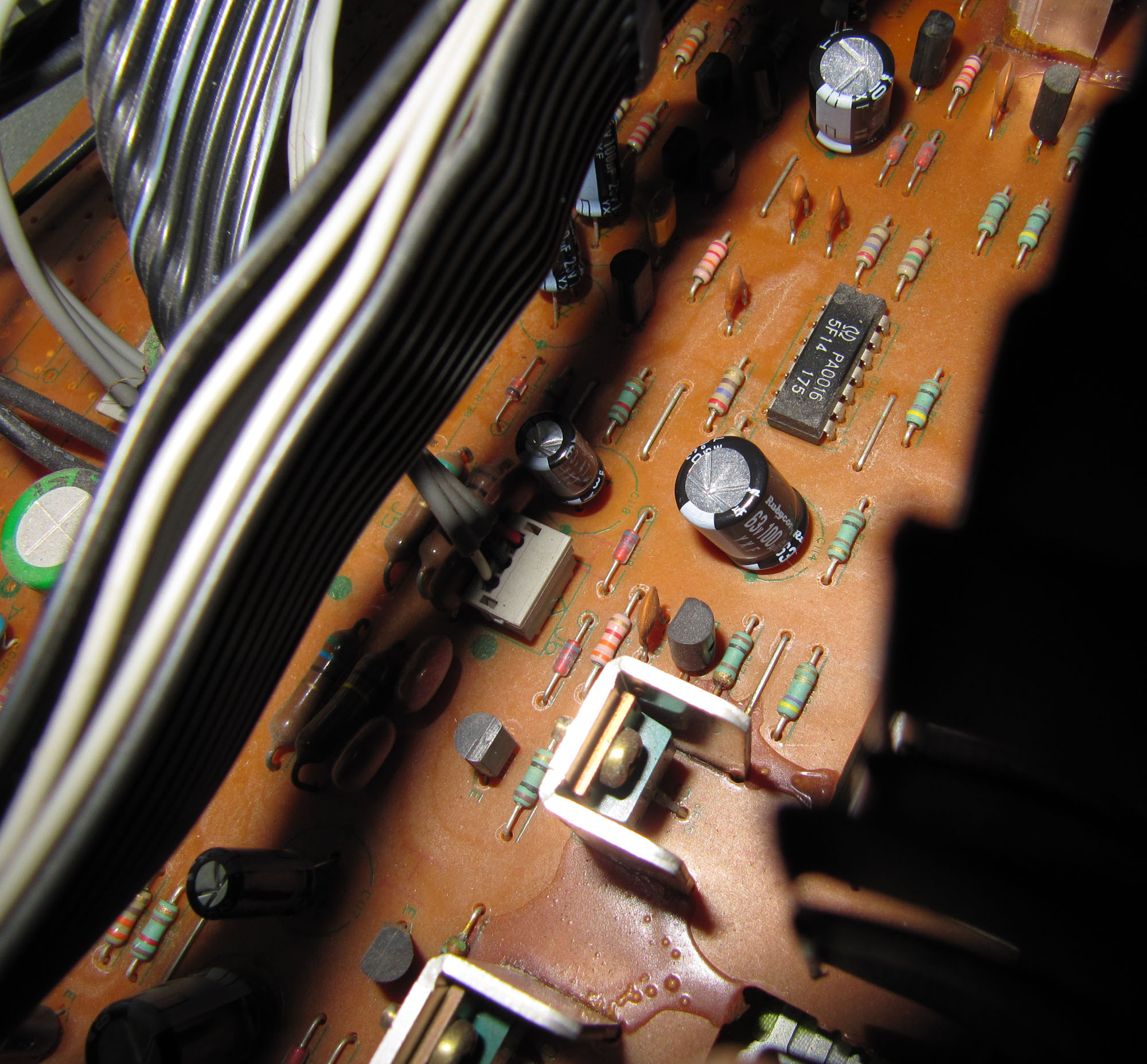

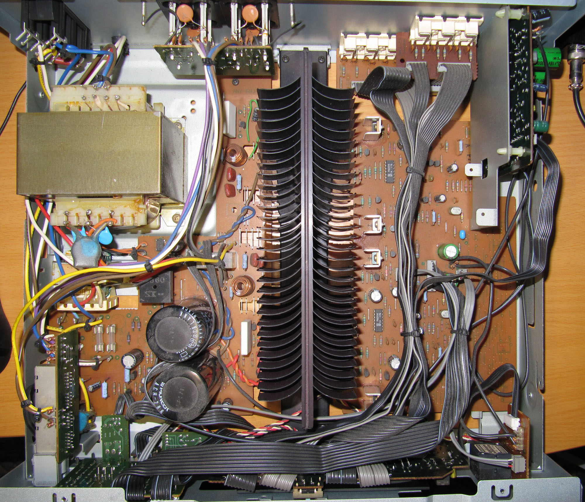

    I bought this vintage amp 2 years ago for 60€

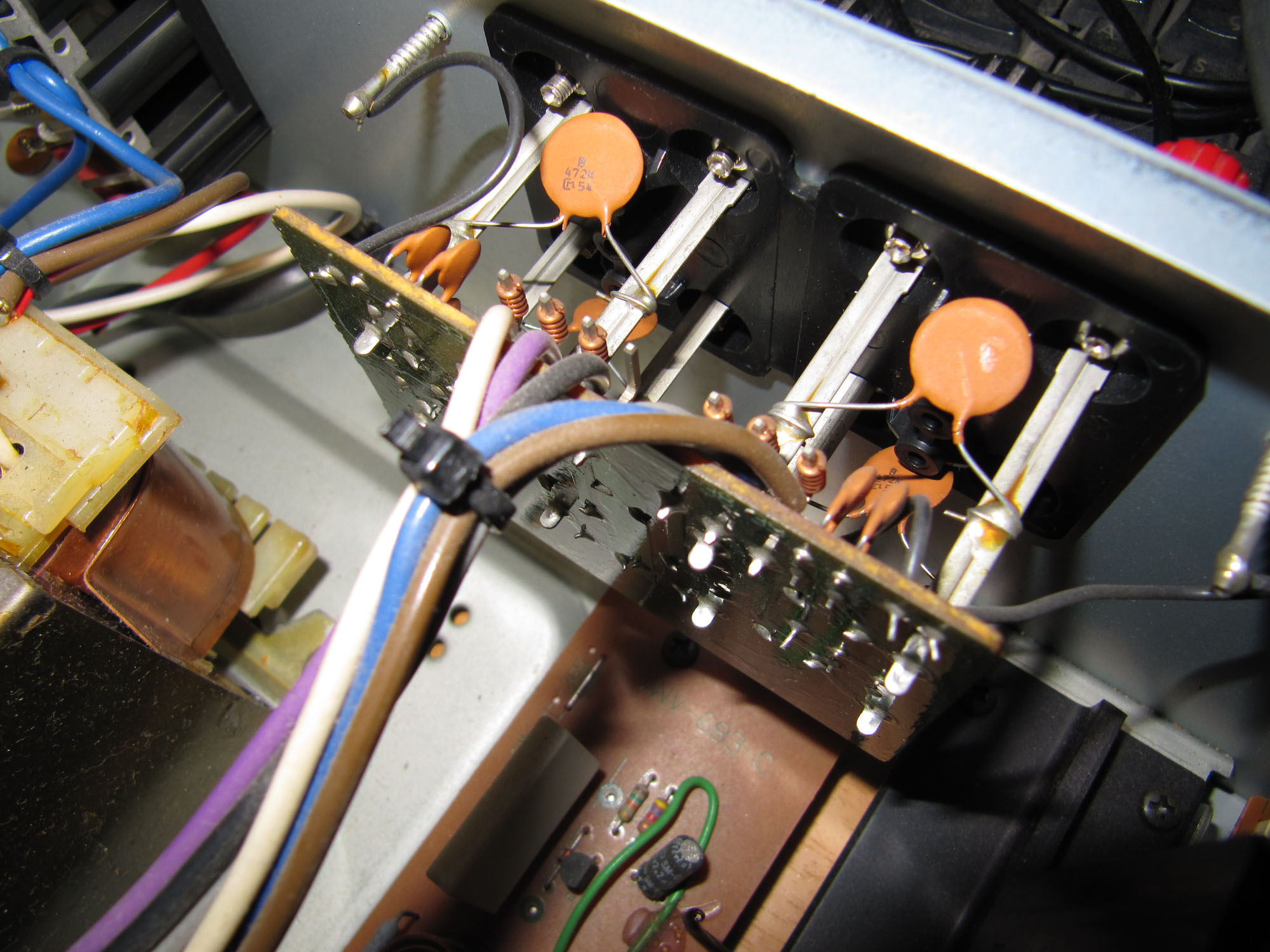

    It worked but the source selector buttons needed maintenance/restore.
    When I selected a source, one of the 2 channels was more silent than the other, some times while I was listening to music, one channel would start to disappear and I also noticed that if I turned up the volume both left and right channels would return, but in low volume there would be some noise and would loose a channel like a bad contact issue.
    I figured that after 35 years of life the contacts of the buttons and the potentiometers would get dusty/oxidized and need maintenance.

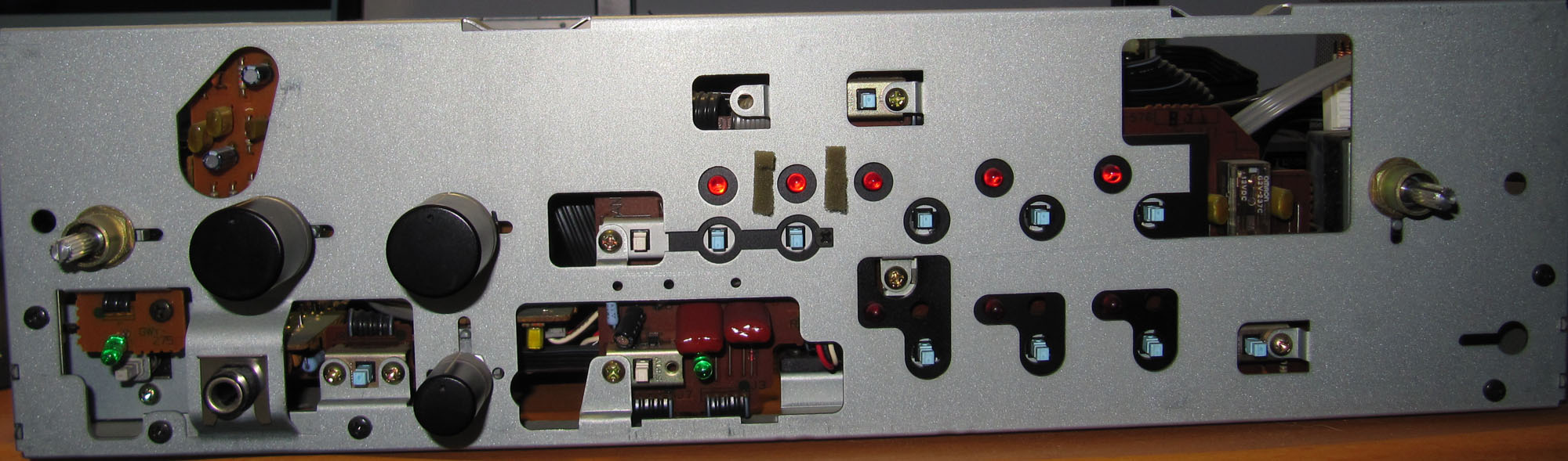

    So, I finally found the time during second lock down due to Covid to remove both the upper cover and the bottom cover of this thing and take a look. I also removed the front cover revealing some lights and switches.

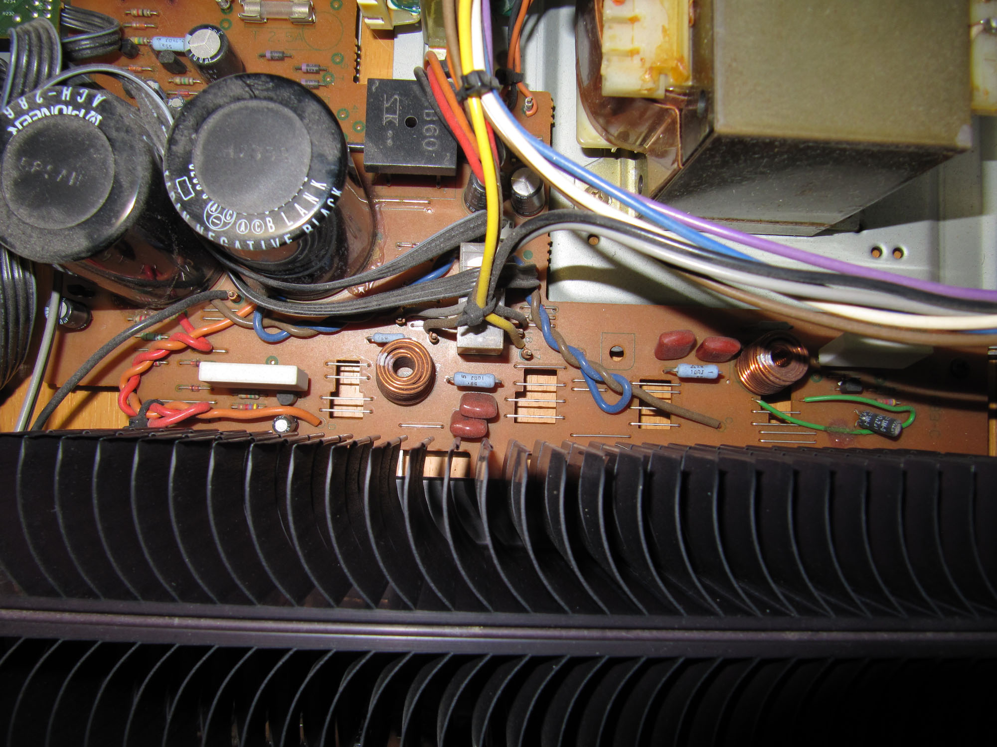

    Looks to me to be a high quality unit and everything is designed to be easily accessed and serviced.

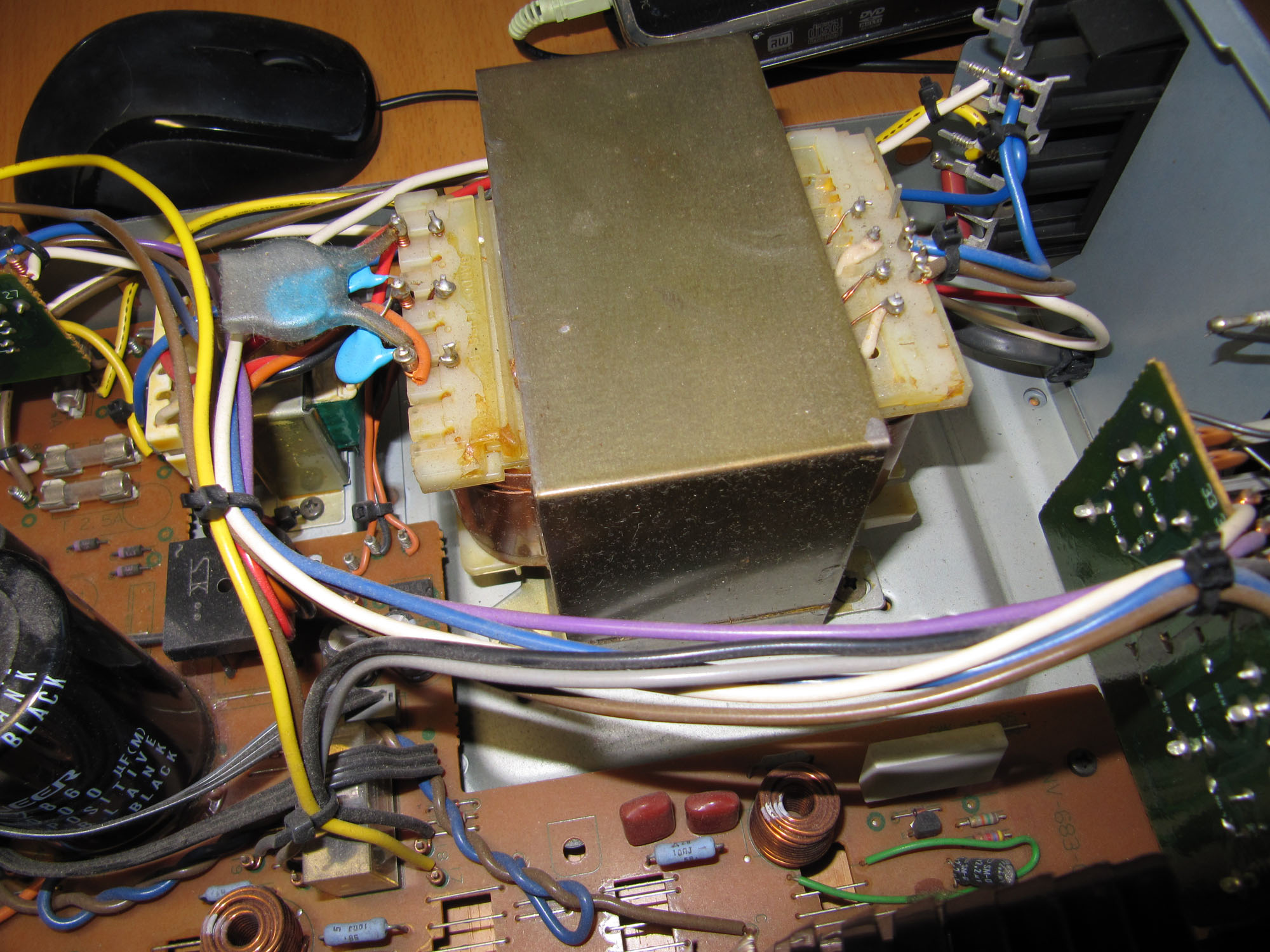

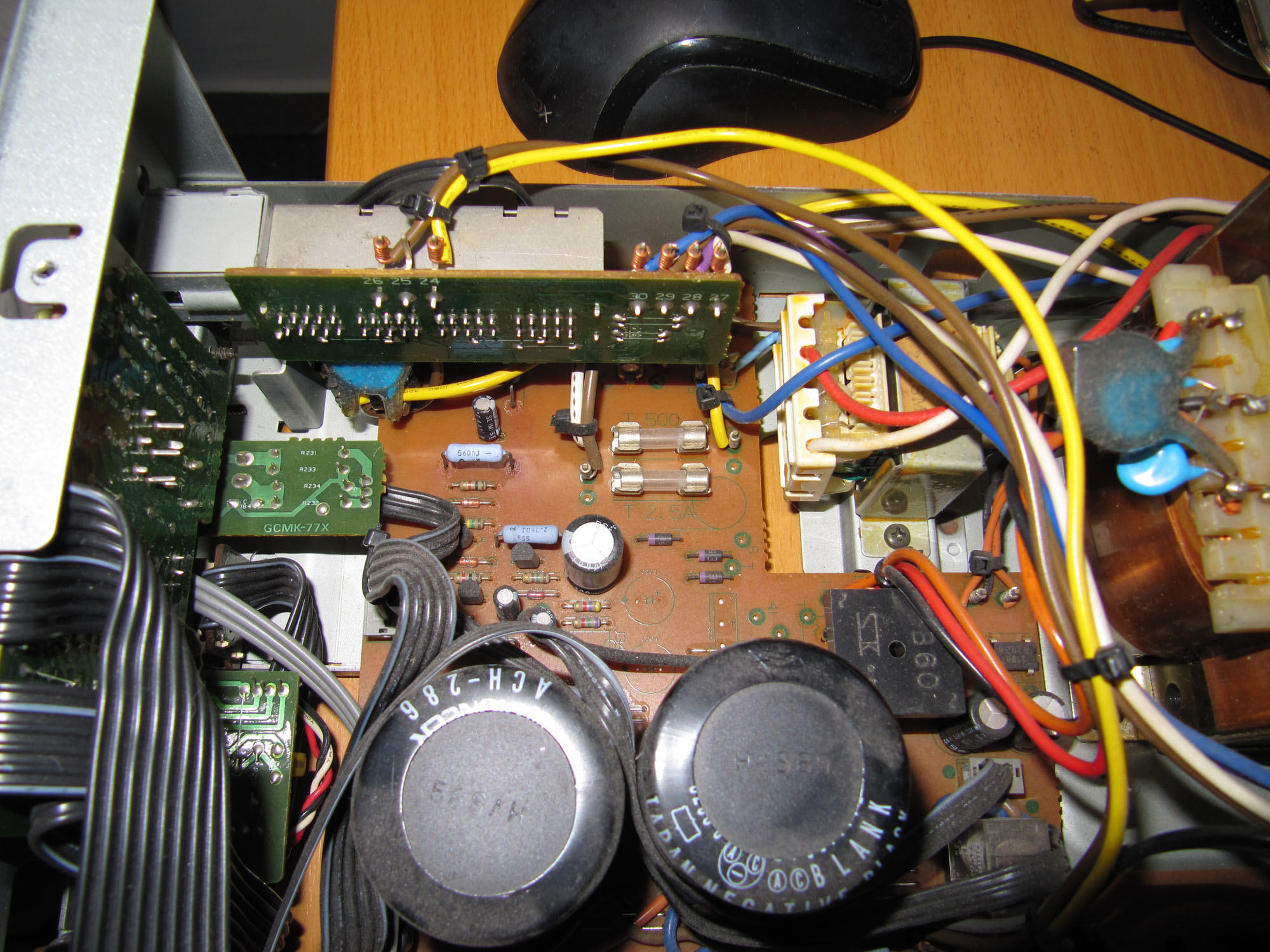

    I really like that the capacitors are safely distanced from the hot parts, compare this to modern devices where the capacitor is nearly touching the heatsink of the voltage regulator / transistor.

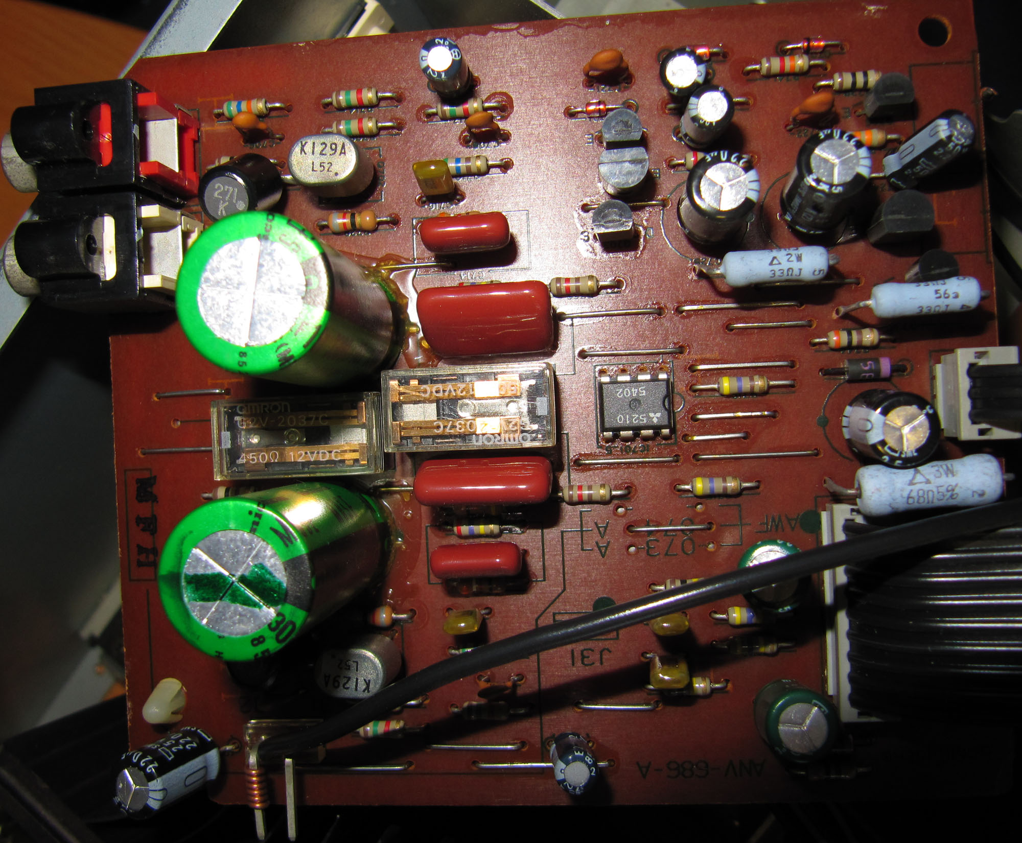

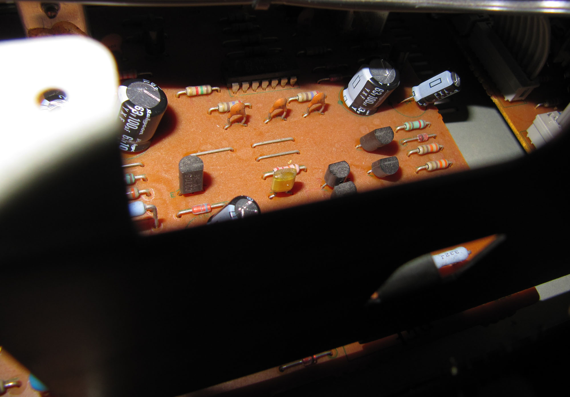

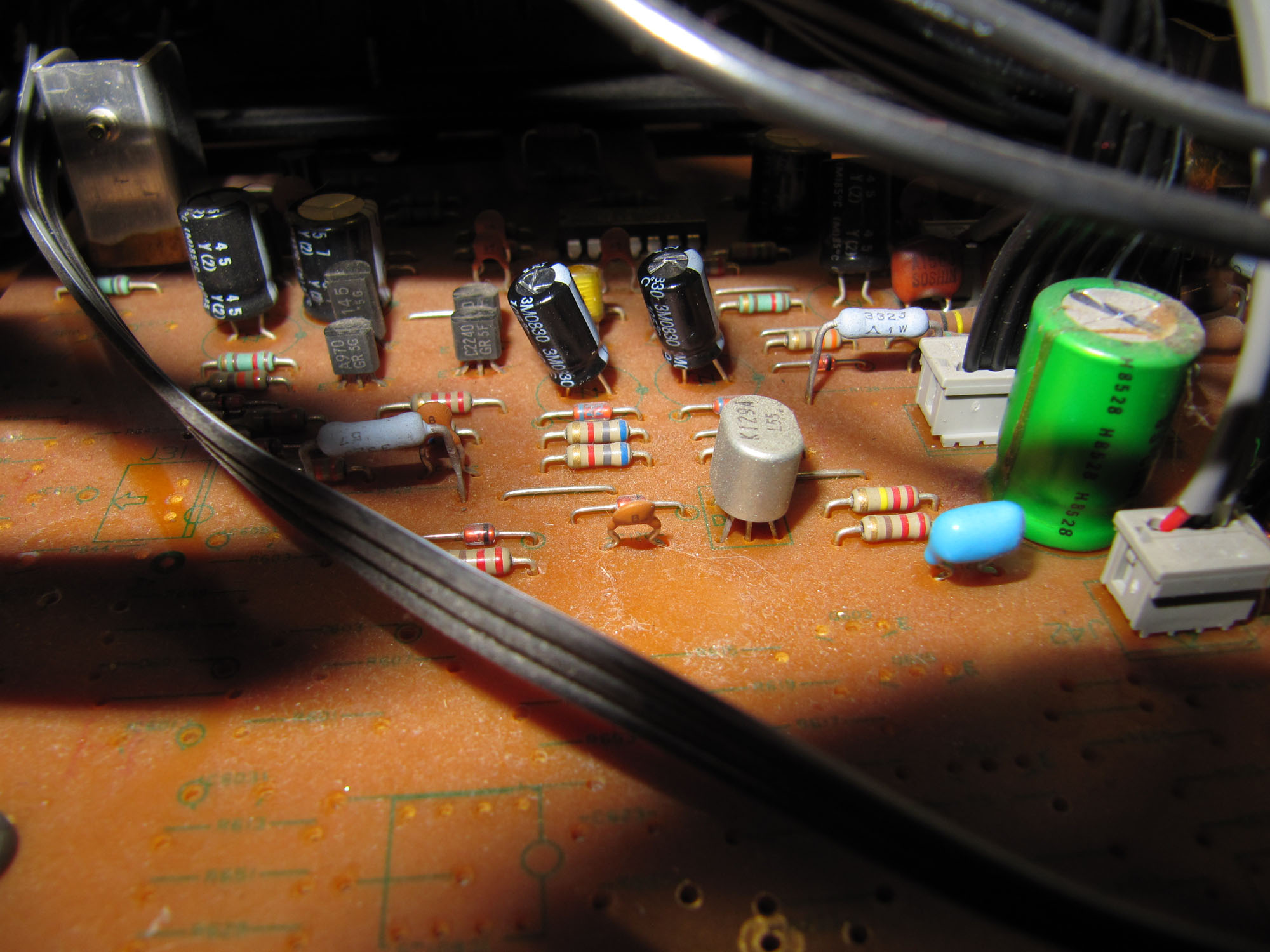

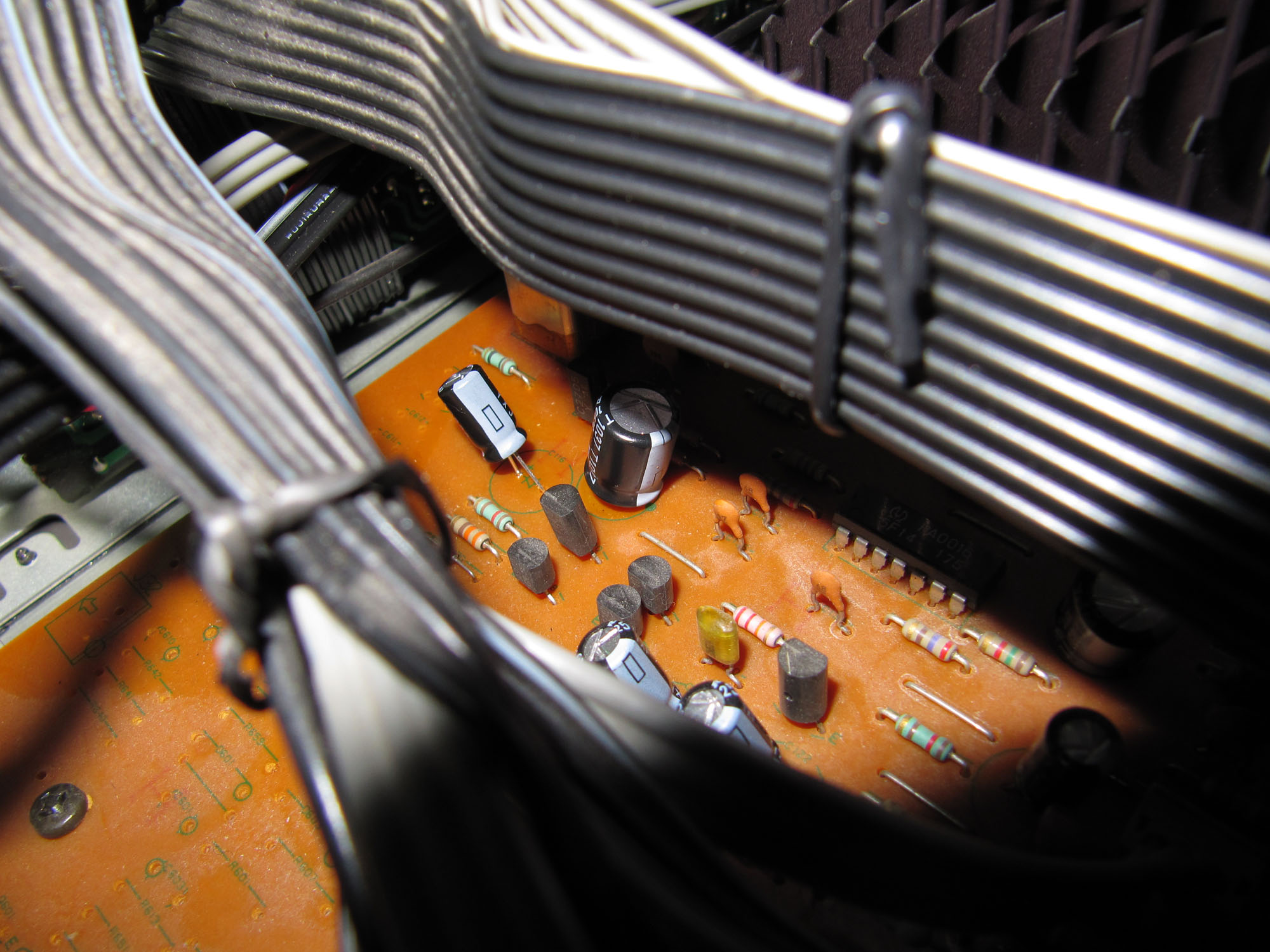

    The phono preamp is located on an add on board and looks impressive. The green caps are Nichicon Muse audiophile capacitors of that age. I checked all the caps, some of them out of circuit and replaced 4 caps with Rubycon YXF.
    I am also thinking of replacing the 2 12000uF primary caps with 2x 15000uF ones to help the amp have even better dynamic response to load.
    I also cleaned the contacts of the buttons and the pots, I would like your opinion if I did a mistake. I first used CRC QD-Contact Cleaner to clean the dust/dirt/deoxidize contacts and then apllied CRC 2-26 to preserve good contact.
    CRC 2-26 leaves residue where it is sprayed. Do you think this might have been wrong?

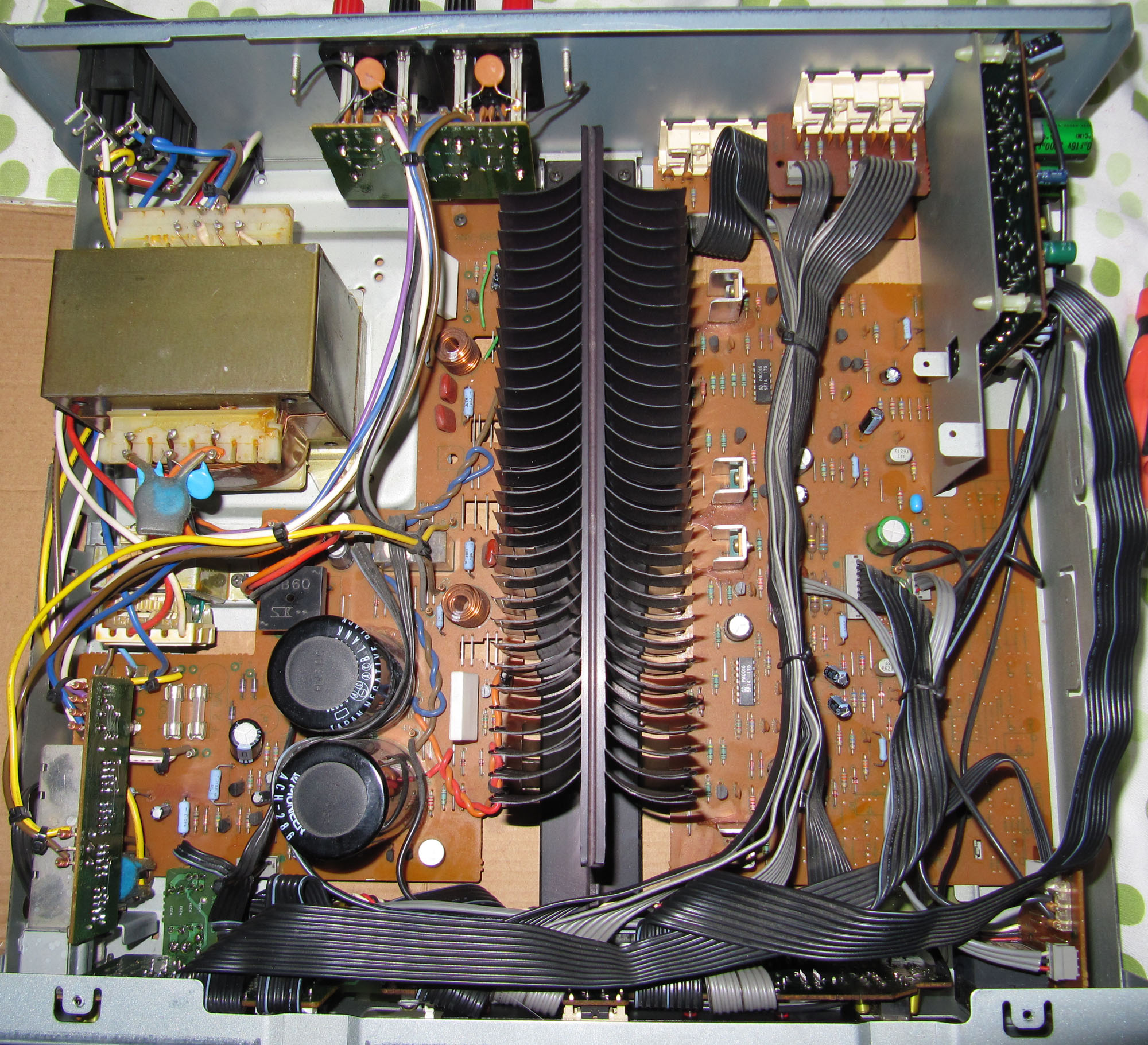

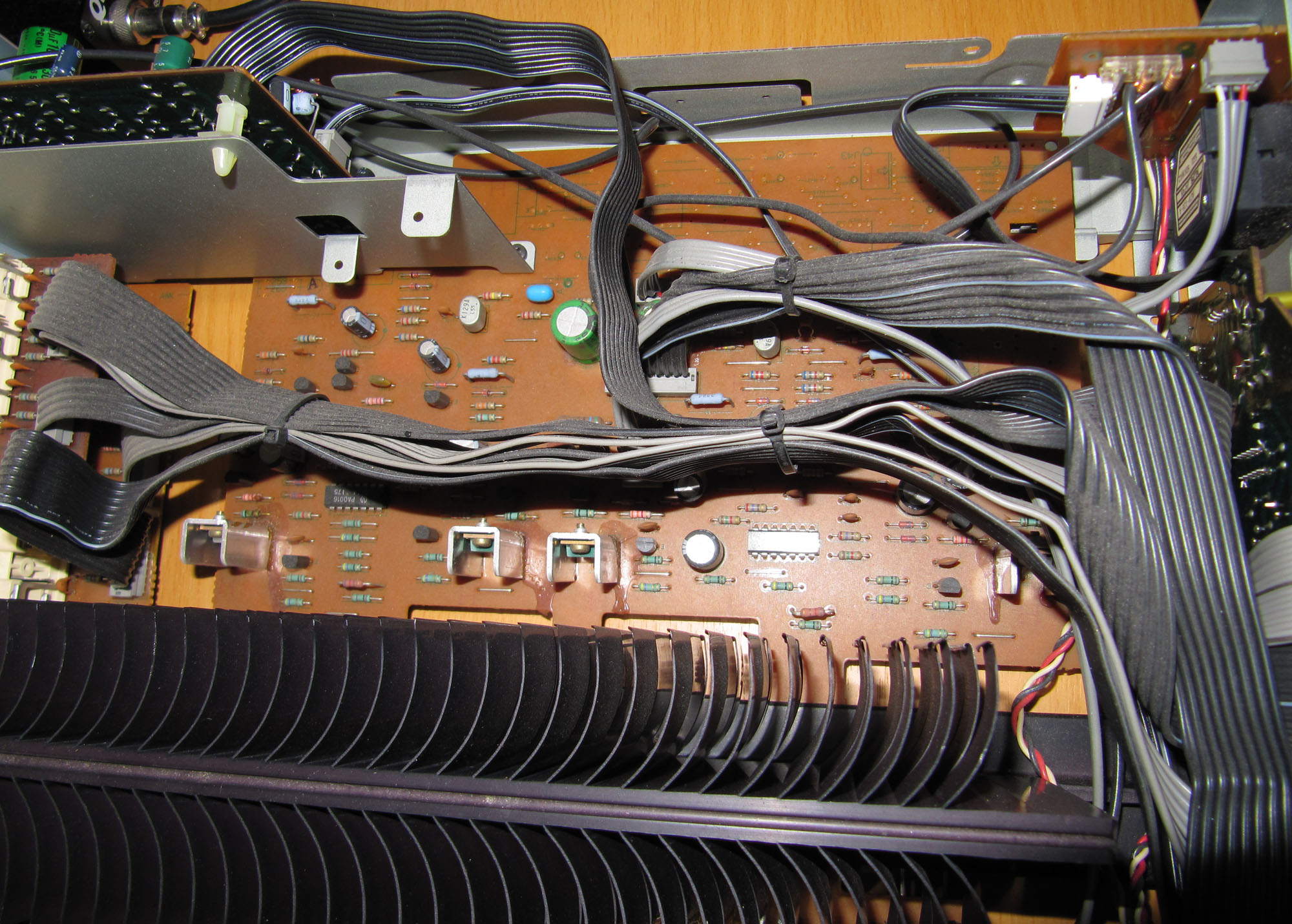

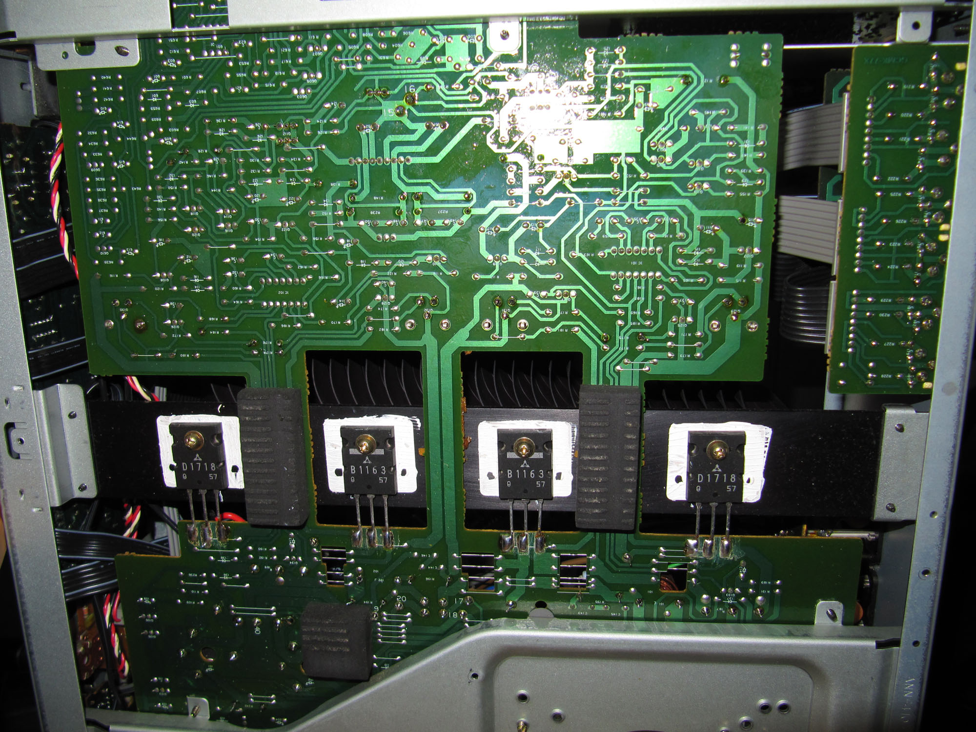

    Btw I attach 10 pics before recapping the amp

    Re: Pioneer-A66X recap and restore
    hi change all caps small and big ones.crc 2-26 is ok but dont throw to much i do all this to my 30 years old technics amp and radio all so to a maranz eq and they sound like new for the next 30 years.

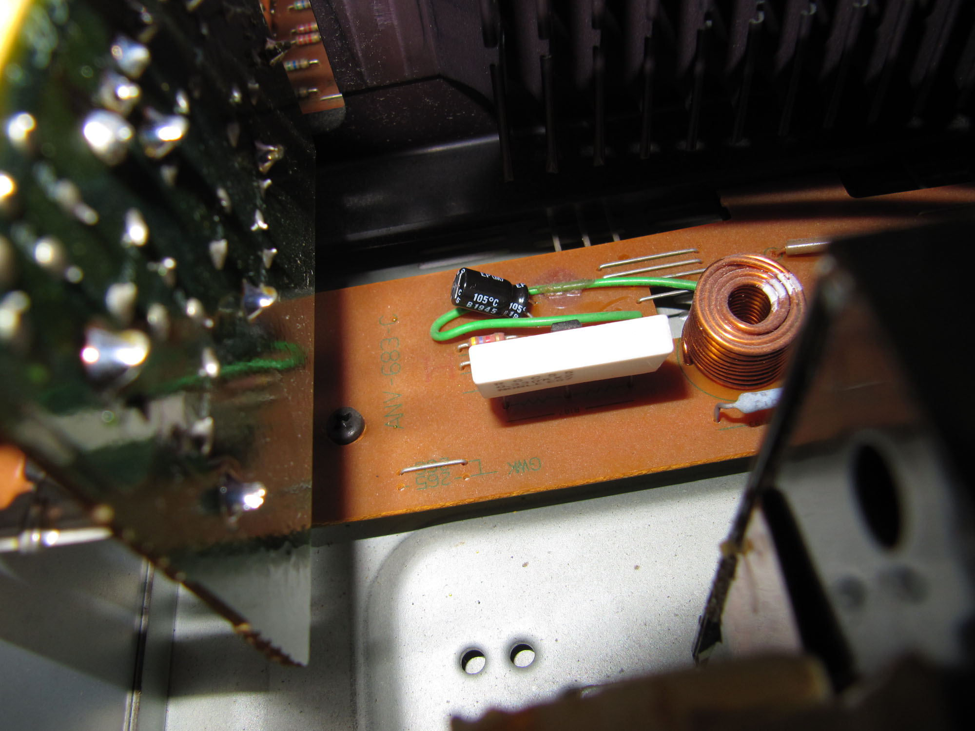

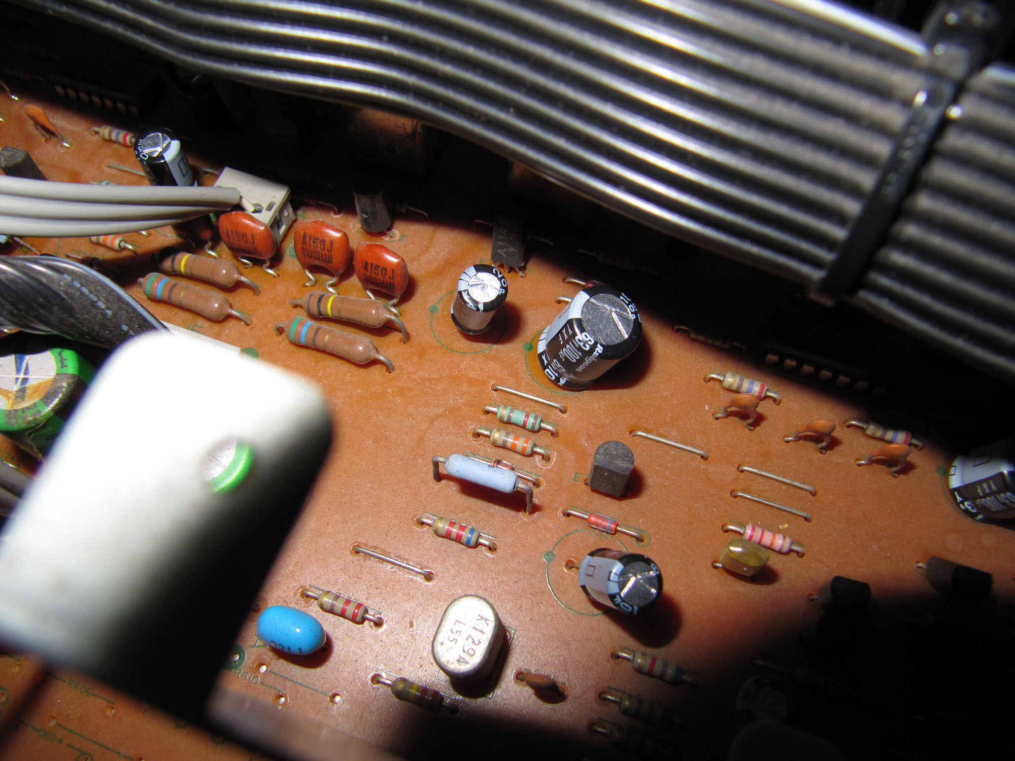

      The reason I did a partial recap and didn't change all the capacitors on this amp is mainly that I was out of stock on several values that this amp used.
      Sure, my stock always has been based on power supplies and especially ATX psus and only just recently I started playing with hi fi stuff (vintage stereo amps, multichannel AV amps, active sub-woofers, dj mixer consoles, turntables, etc).
      Another reason is that the 36 year old capacitors looked fine and I proceeded to even test them one by one in circuit and some of those out of circuit and they all were fine, normal ESR for their specs, close to nominal capacitance and low leakage current.
      I now attach pics after the partial recap.
      Unfortunately, I think I applied too much 2-26. I couldn't access the internals of the buttons and the buttons had serious contact issues, so I got curried away and spilled too much.
      I tried then to wipe the excessive oil that was left over.
      The amp works and the sound is just wonderful. I noticed that if it runs for several hours at normal levels of sound, I can smell the oil from the areas that the amp gets hot during operation. I hope it is not cooking oil now

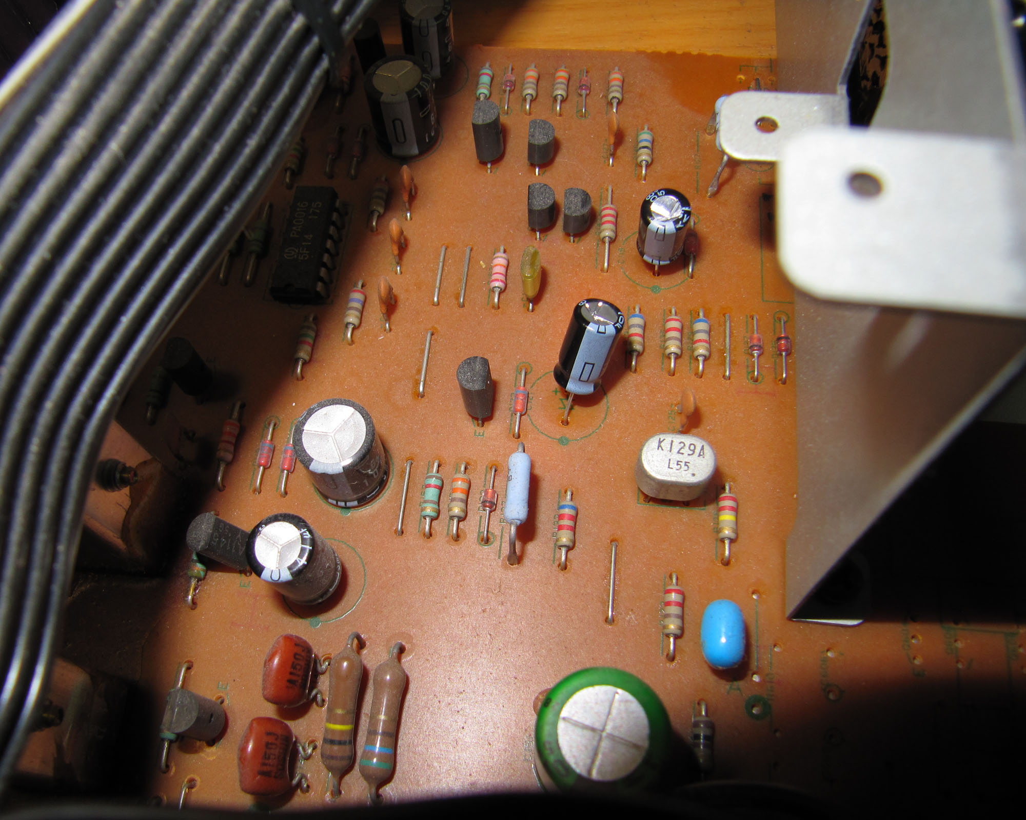

        I revisited the internals of this amplifier and went on and replaced more caps with 105C good brand caps entry level esr. Pics after recap attached

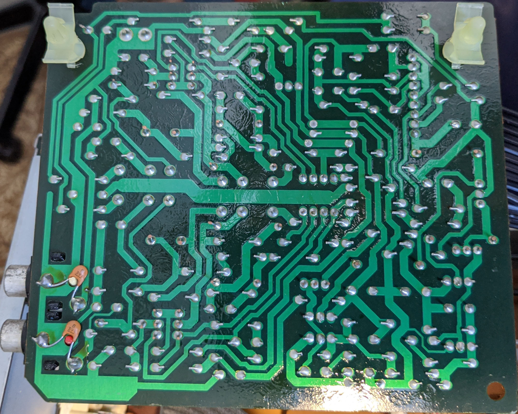

        I removed face plate and then another cover hiding the input selector switches, unscrewed several pots and switches and then very carefully cleaned with cotton buds, cotton and paper the excess 2.26 I had spilled on it. I also used again CRC Contact cleaner to remove it from spots that were otherwise unreachable to me.

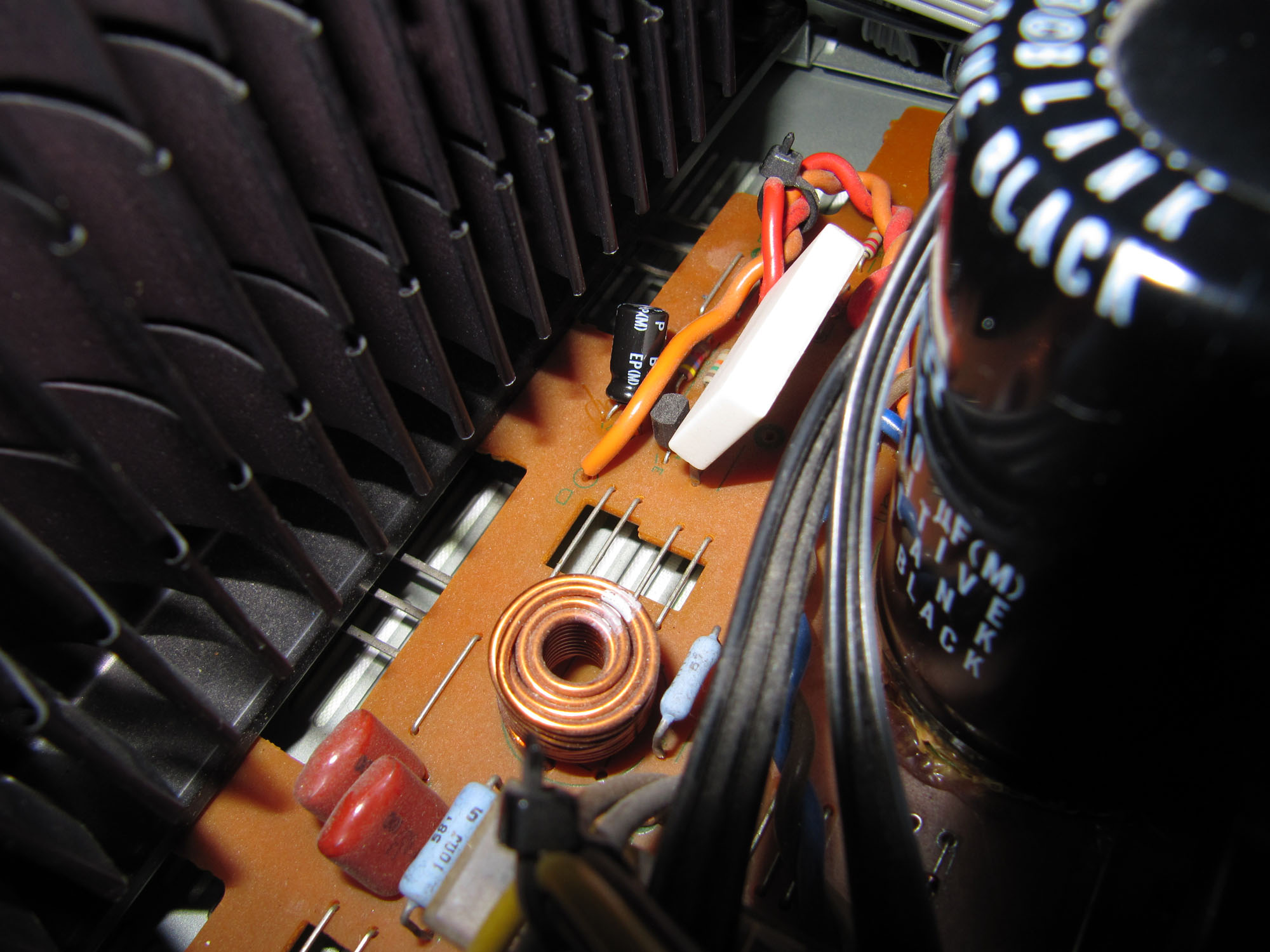

        This didn't go very well. Before ordering the caps, I measured the height and the widths of the original ones but failed to measure lead spacing.
        Turns out the new caps have vastly different lead spacing and the only way to fit them there would be to drill holes to the PCB and I didn't want to go that far with that kind of vintage gear...
        The new caps have also 2 legs per cap while the original caps have 4 legs, 2 legs are connected to electrolyte and 2 not connected to anywhere.
        So, I decided to leave unchanged the original 2x12000uF caps. But first I measured them both, out of circuit and they were totally fine in terms of capacitance, ESR and leakage current.
