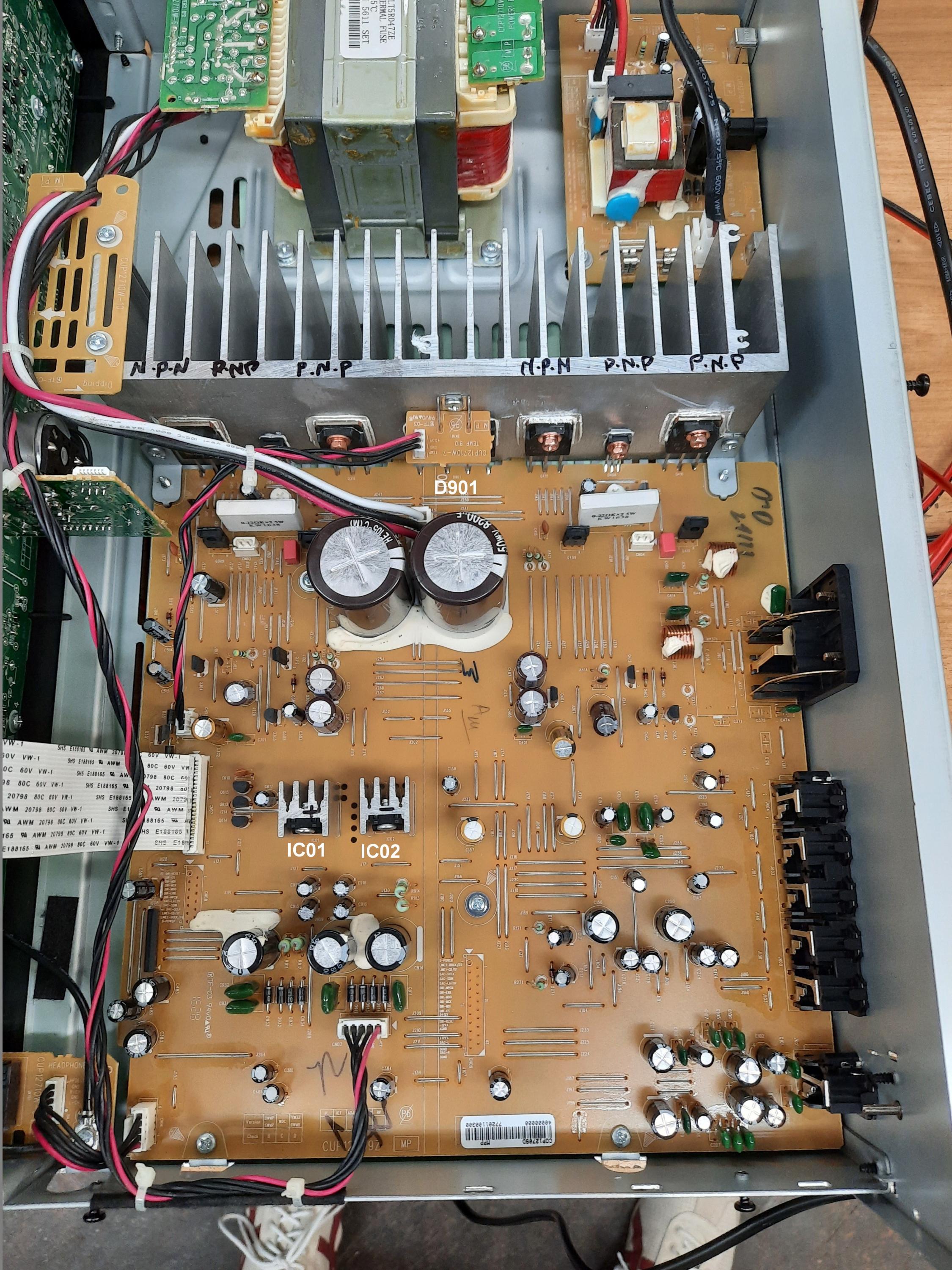

    Hi all
    This amp has no audio .
    Output transistors check out good .
    No DC getting to speaker terminals .
    80 V measured across bridge rectifier D 901 , therefore assume the + & - 40 V also present .
    + & - 12 V supplies at I C 01 & I C 02 respectively , also present .
    No speaker protection relays on this model .
    Audio present when taken from line out port , then through another amp , therefore assume at least part of the
    p r e amp circuitry is working , depending on circuit layout .

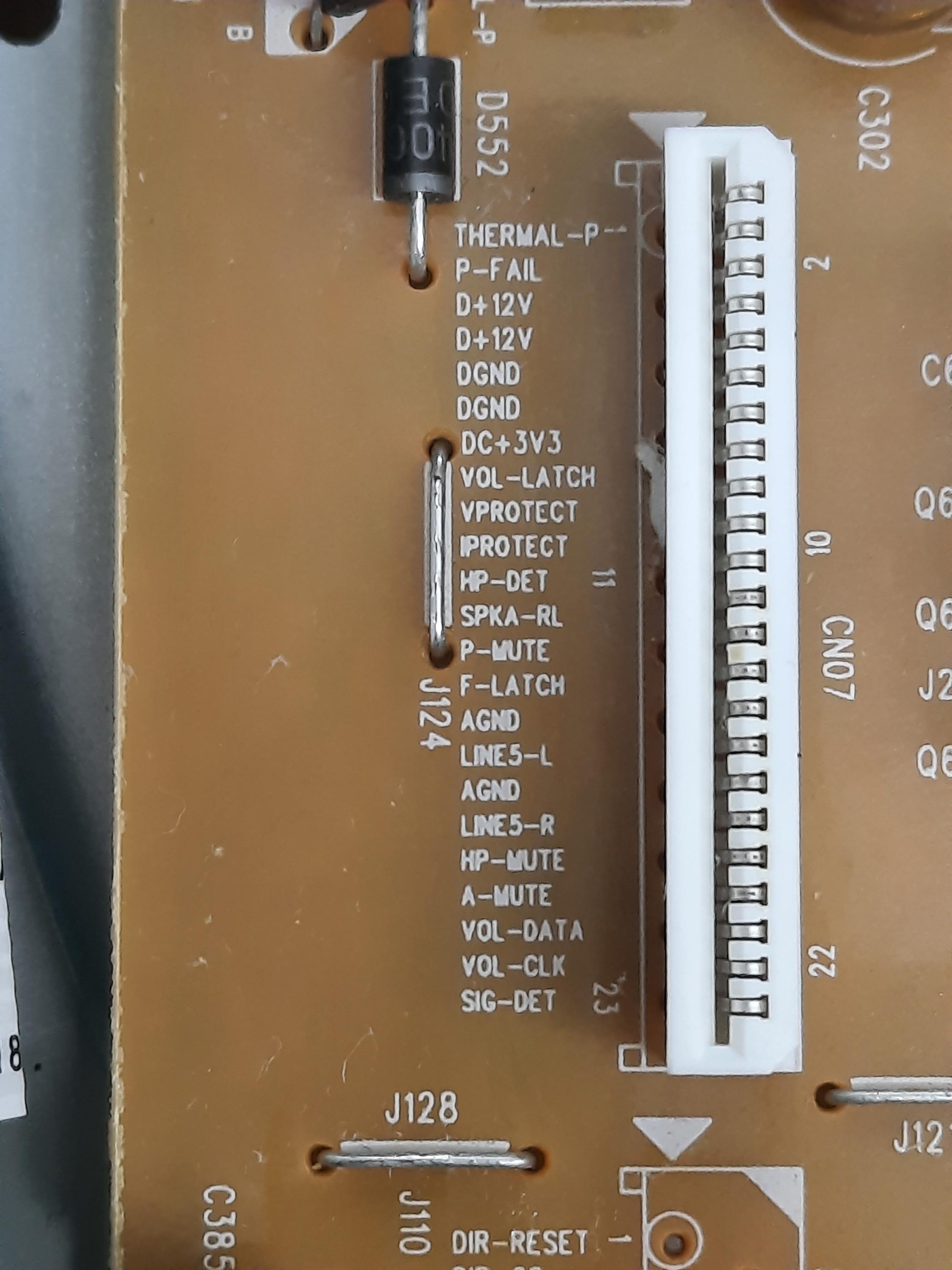

      Re: A 9010 o n k y o amp , schematics & help please
      Hi & thanks
      No audio via headphones .
      Checked pins at CONNECTOR 07 , which is a ribbon type from main to front panel .
      Not sure how to extrapolate some of the reading . Maybe someone could help .
      THERMAL - P = 2.7 V
      P - FAIL = 3.2 V
      D 12 V = SLIGHTLY HIGH AT 15 V
      DC 3.3 V = OK
      VOL - LATCH = 2.7 V ALWAYS , REGARDLESS OF VOLUME ADJUSTMENT .
      V PROTECT = 0 V
      I PROTECT = 0 V
      HP - DETECT = 0 V WITHOUT HEADPHONES CONNECTED & 3.2 V , WITH HEADPHONES IN
      S P K A - R L = STANDBY 3.3 V , ON = 0 V
      P - MUTE = 3.2 V
      F - LATCH = 3.3 V
      LINE 5 - L = APPROXIMATELY 2 VOLTS PEAK TO PEAK AUDIO SIGNAL . AMPLITUDE DOESN'T ALTER WITH VOLUME ADJUSTMENT .
      LINE 5 -R = SAME AS ABOVE .
      Note LINE 5 port is at front of unit , therefore i'm scoping audio from front unit coming back onto the main board .
      HP MUTE = MINUS 10.8 V regardless of whether headphones connected or not .
      A - MUTE = PLUS 4.2 V IN STANDBY , MINUS 10.8 V WITH UNIT ON
      VOL - DATA = 2.7 V , but nothing via scope , except a slight jump if source changed
      VOL - CLOCK = same as above .
      SIGNAL - DETECT = VARIES 1.6 V TO 2.3 V

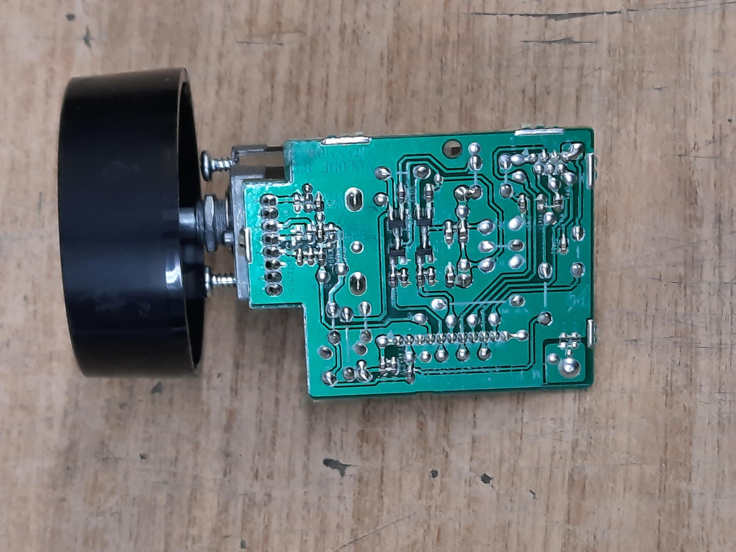

        Not sure why i tried this but glad i did .
        Disconnected the volume control board , powered on and now have audio .
        Might be control itself , or one of the surface mount components on the underside .
            Hi , thanks
            That's IC04 & i did check , but seems ok .
            I suspect it may be that useless grease that's used within the volume encoders.
            Had it before on other units , but never like this , with no volume at all.
            Will strip it down tomorrow & give it a clean .

                  • zen
                    • 511
                    Yes your correct .
                    Stripped volume control , which is analogue type , to clean track , but same results .
                    Checked all surface mount components on audio board , but found no issues .
                    If i disconnect the volume in on pin 4 of connector on audio board , sound returns , obviously set to one level .
                    I'm now convinced there's a logic issue on the front board somewhere .
                    Also notice a small non volatile memory chip , & wondering if data has corrupted .
                    Also with volume module disconnected , if i try to measure or scope volume in test point on front board , the sound level reduce to zero .
                    Also reset unit to default settings with following procedure , but same results .
                    While the unit is on, press and hold the DIRECT button
                    and press the ON/STANDBY button.
