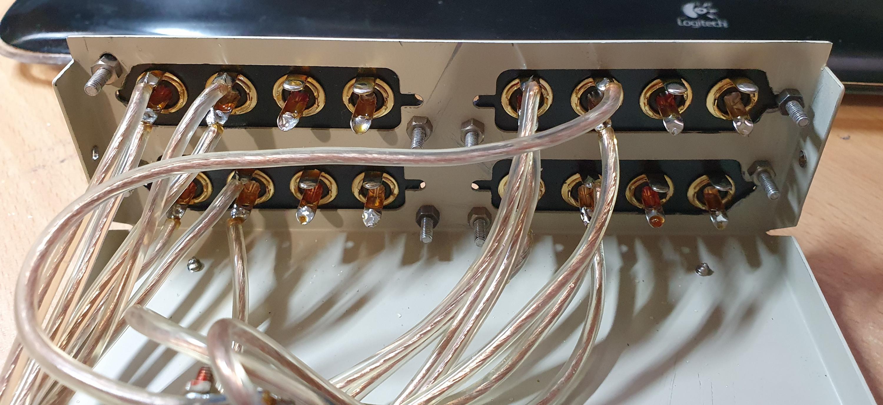

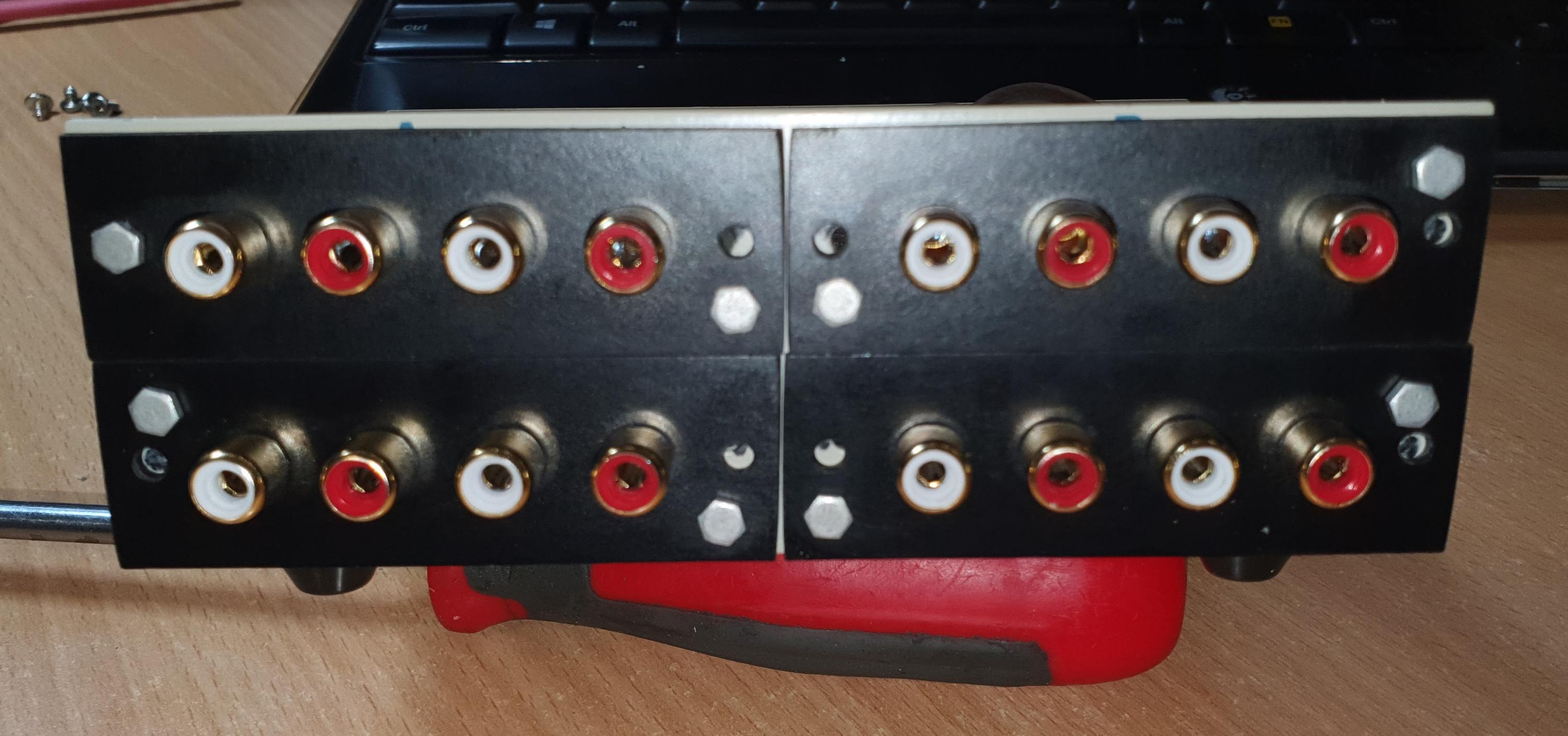

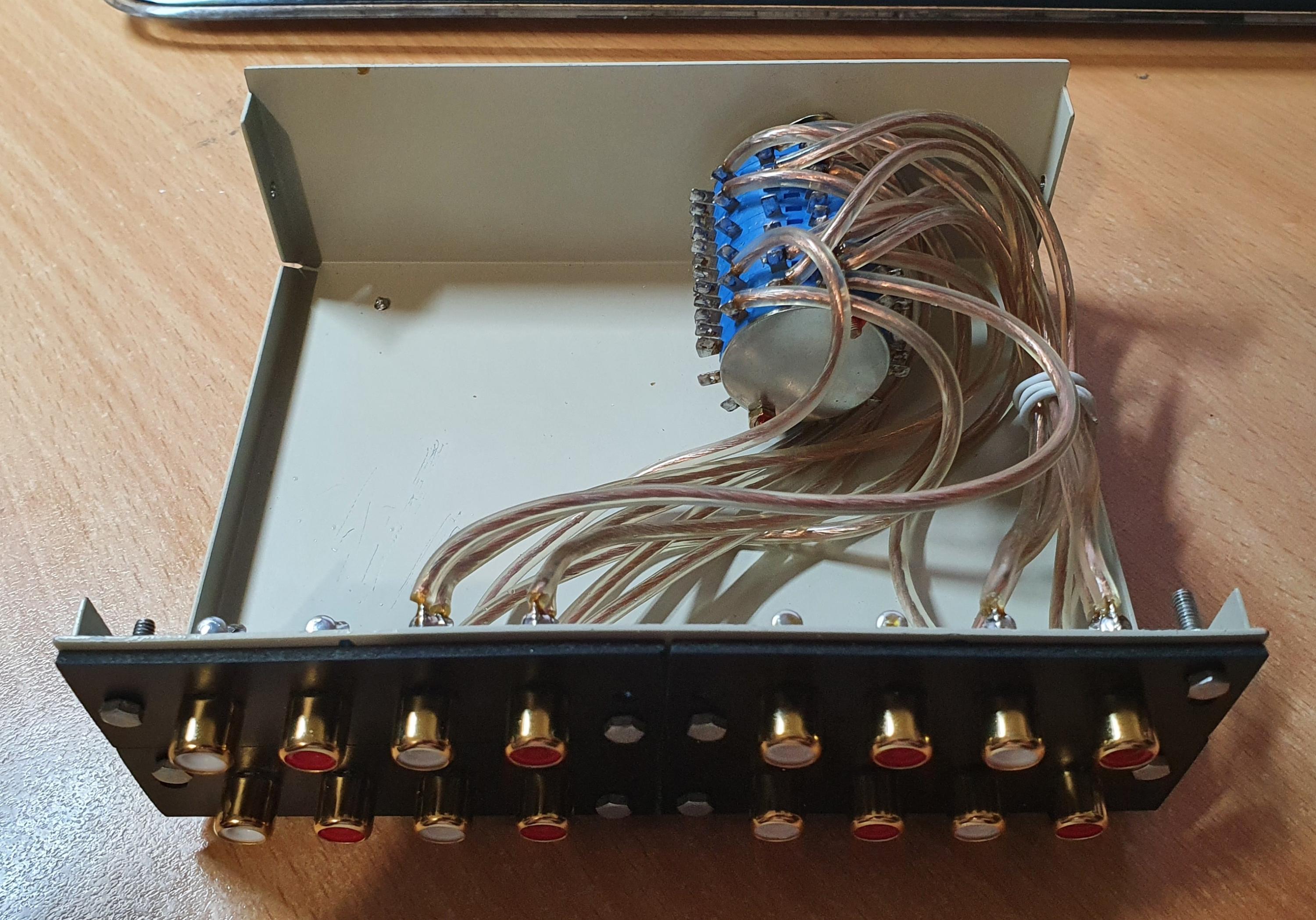

    I have a project that is an audio switch box I have used an old PC parallel switch box which is 3 inputs with 1 output, I have stereo RCA jacks for the 3 inputs and 1 output and its working well using the original rotary switch but now I need to add another rotary switch for another 3 audio inputs and 1 output but I dont know what type of rotary switch to get. It needs to have the ability to select 1 of 3 positions for the three audio devices and then have 1 output and be able to handle left/right/ground for the stereo RCA.

        Hi eccerrOr I think I need line level, the switch box at the moment has 3 in 1 out as:
        3x MIDI sound modules going to the switch box then 1 out to a stereo mixer then main out from mixer to powered speakers, I need the new rotary switch to have:
        3x PC's sound card out (line) to switch box then 1 out to stereo mixer then main out on mixer to powered speakers
        Im using a switch box because I ran out of inputs on my mixer and if I bought a bigger mixer it was to large for the desk and a waste of money

          Build your own, though it looks like this is the only wafer needed, just need the shaft and panel mount assembly.

                So you just want simple passive audio (line level) source selector, Newark sells those wafer switches so just choose what you need.

                  Re: Help to Choose Rotary Switch for Audio Switch Box
                  Ok all things above considered ill look for a switch from your recommended sources, I switched the ground as I thought singularly would have less noise from the other two channels, if there is a pop I don't mind that because I always turn down the main out on the mixer to zero volume to safely switch between devices, this was said in the manual to not damage the mixer and speakers
