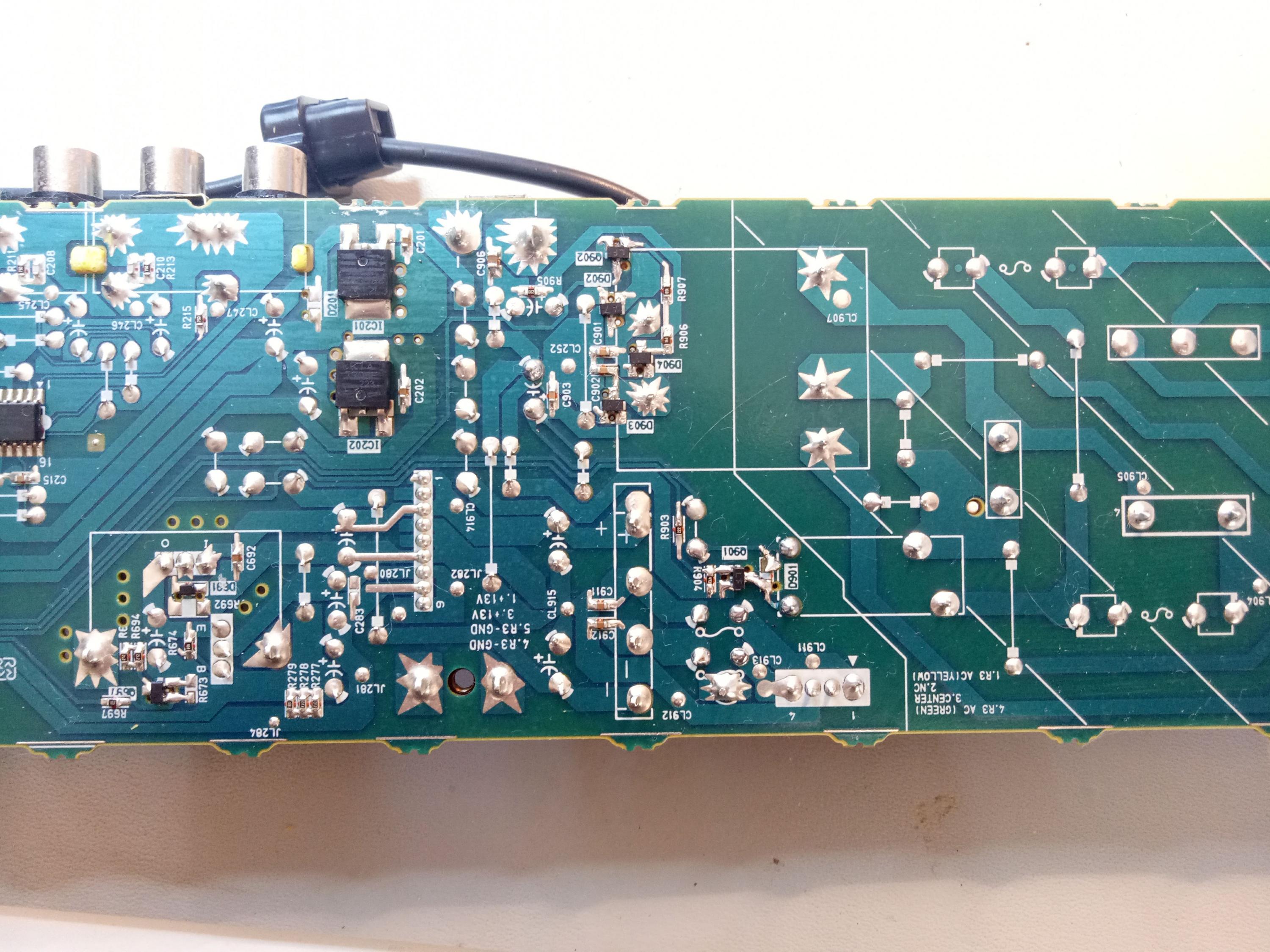

    So I have a Sony STR-KM7 with mains power - confirmed 240v - has no standby.
    The relay RY901 - standby relay for allowing 240v to main transformer is not switching. No clicking sounds at all when mains power is supplied. No display and no illumination of any LED lights - nothing completely dead.
    I have tested mains power circuit at mains connector on power avideo board - which is where the mains power comes into this unit and this tests good.
    Tested Secondary side of T902 Power Transformer (sub) across terminals - 10.5v
    Tested each secondary winding to ground is 5.25v.
    Tested D904 on diode mode with DMM - .566v
    Tested out of circuit - Q902 - B to E .725v - B to C .725v
    Tested out of circuit - Q901 - B to E .725v - B to C .725v
    Tested RY901 DC coil - 5v - with external power supply - working.
    Now I am completely out of my depth as I cant seem to move forward from here as I believe all these tests are ok. Does anyone know of the operating startup proceedure that can help or even where I should check next.

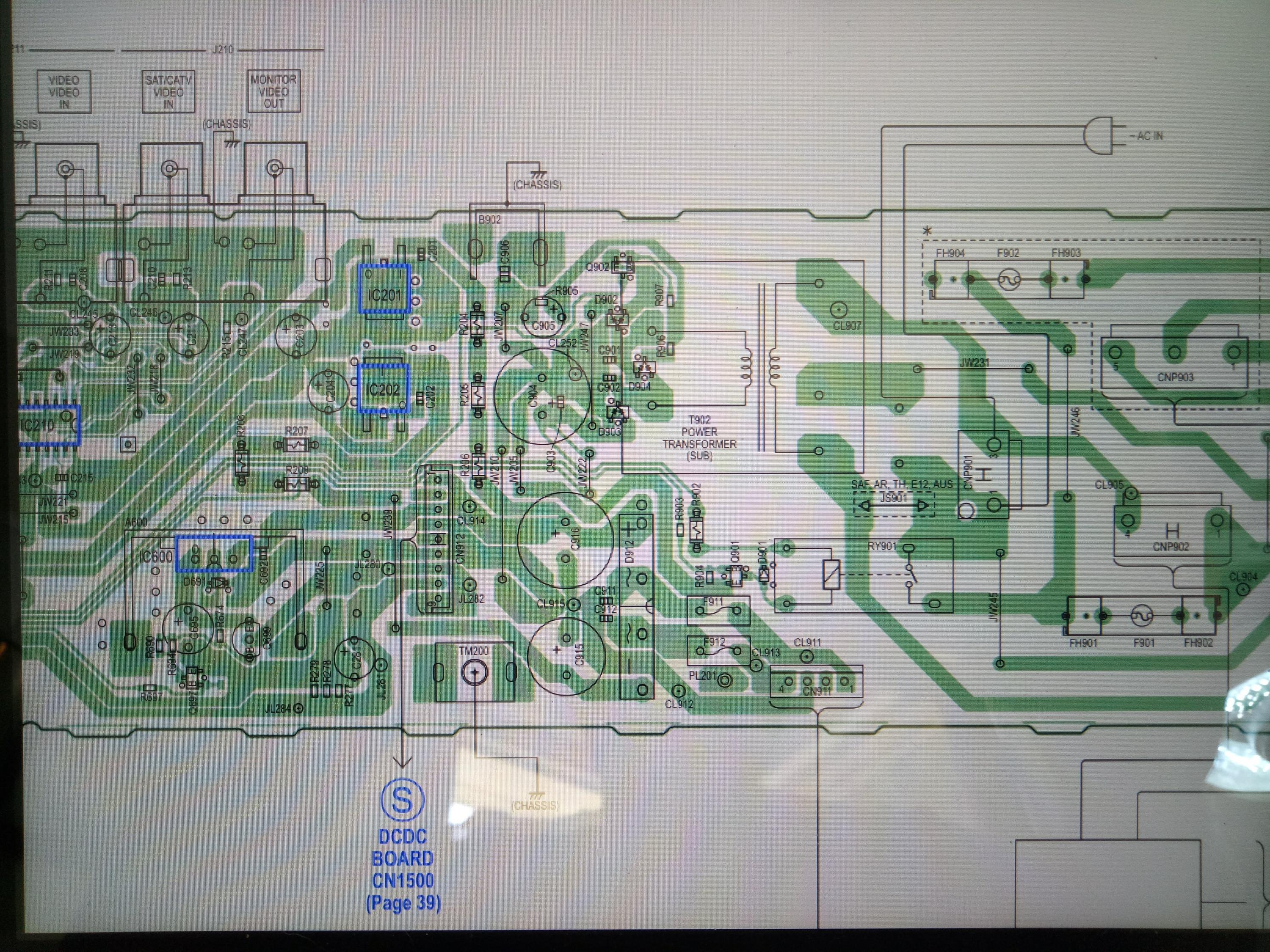

    I have attached a photo of the power avideo board and the schematic I am usng for reference.

    Can you please upload the service manual/schematic?

      You should have standby voltage on CN271 pin 5, or across C904, Is it there?

        Here is the full schematic Budm.

          I will check those R J and get back to you.
              I have 13.2 v across C904
              and 12.7 v at CL214 (pin 5 on CN271).
              Any ideas?
              • Purge98
                • Aug 2023
                • 3
                Re: Sony STR-KM7 Not Powering On
                Any ideas?
                UPDATE.................................
                I shorted out the relay RY901 output terminals and it works.
                There must be a problem with the signal to the base of transistor Q901 which drives the relay coil. I couldn't be bothered to find out what it was.
