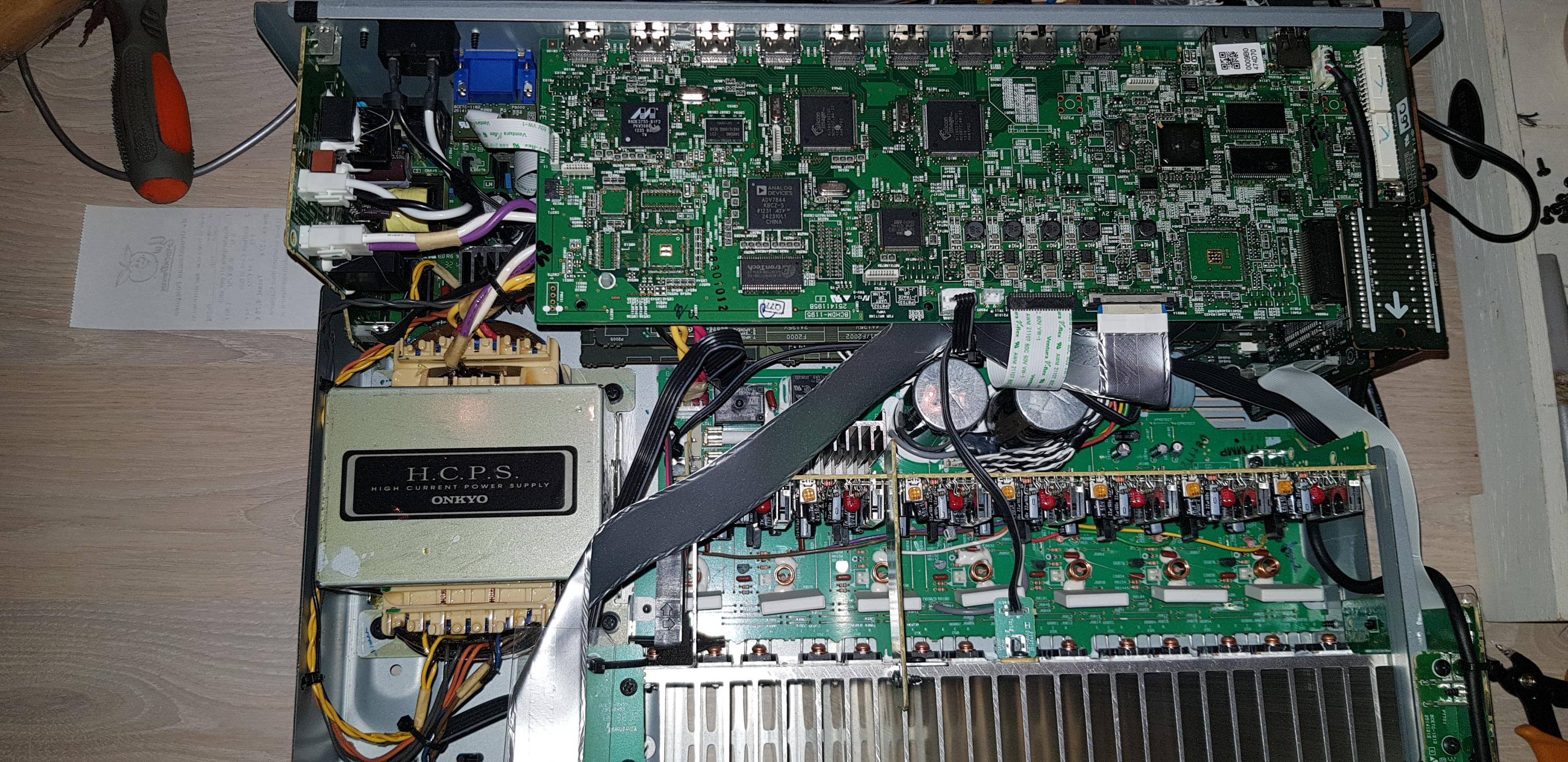

    Hey guys ,
    Trying to repair this receiver for a friend.
    Symptoms were that he had to turn the receiver on/off a few times to get sound and after a while there was no sound at all.
    I already reflowed the DTS chip with flux and hot air but i still dont get any sound. Have to say i hooked up my Samsung S8 to "PC" input....maybe the receiver dont detect the S8 input and it needs a tv/PS4 or something?
    Will post some pictures and the service manual tomorrow when i got more time but i was hoping for a quick fix as this seems a common problem with these sets.
    Thanks!

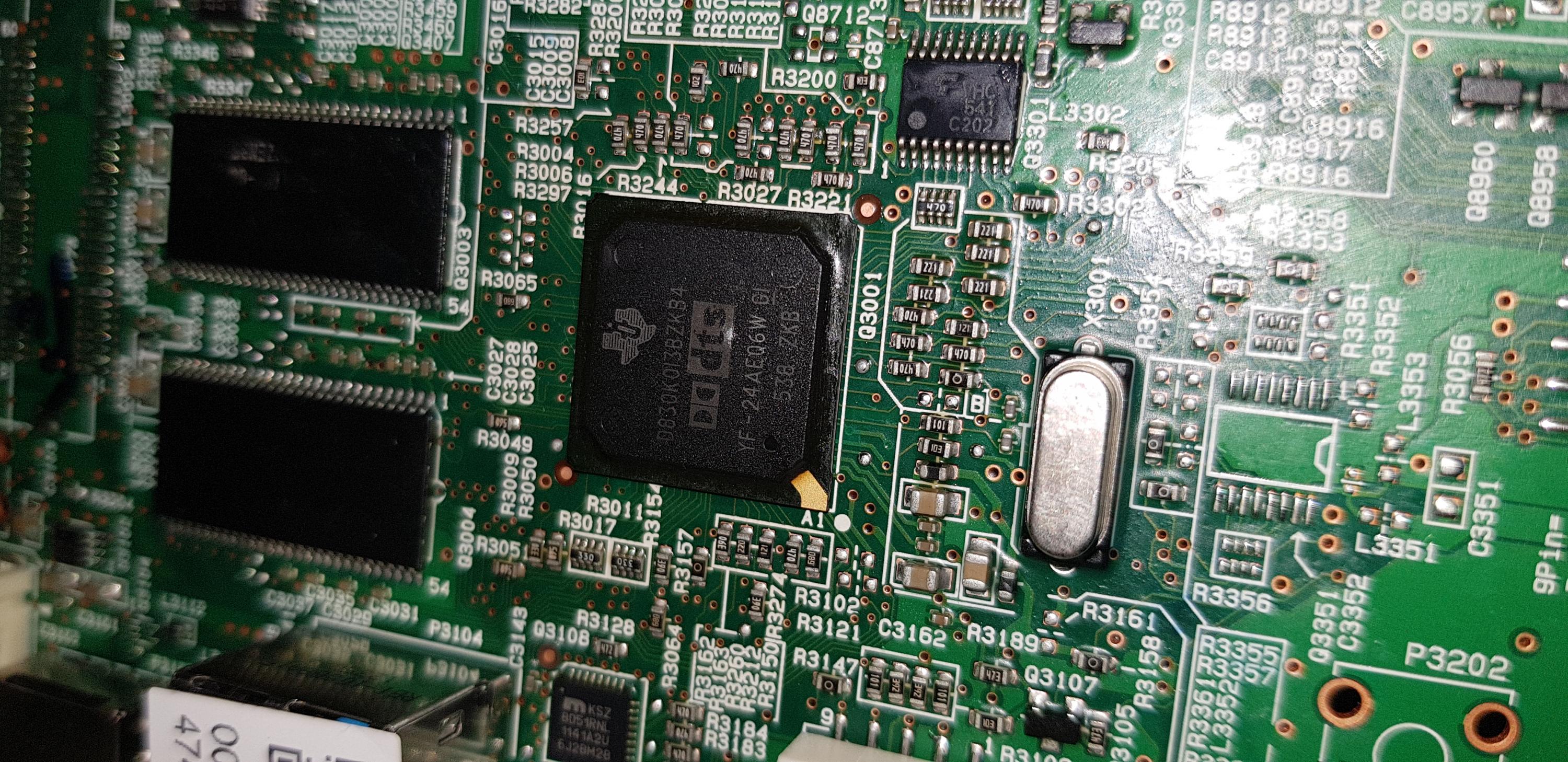

    Re: Onkyo TX-NR717 No sound.
    The DTS chip is dead.
    Check if this particular receiver is covered by the onkyo's extended warranty ( the notorious "no sound, no video, no net issue" ).
      Ok , so it is absolutely dead? Maybe reflow again? It was never reflowed before.
      A new chip would be a option but that chip needs programming right?

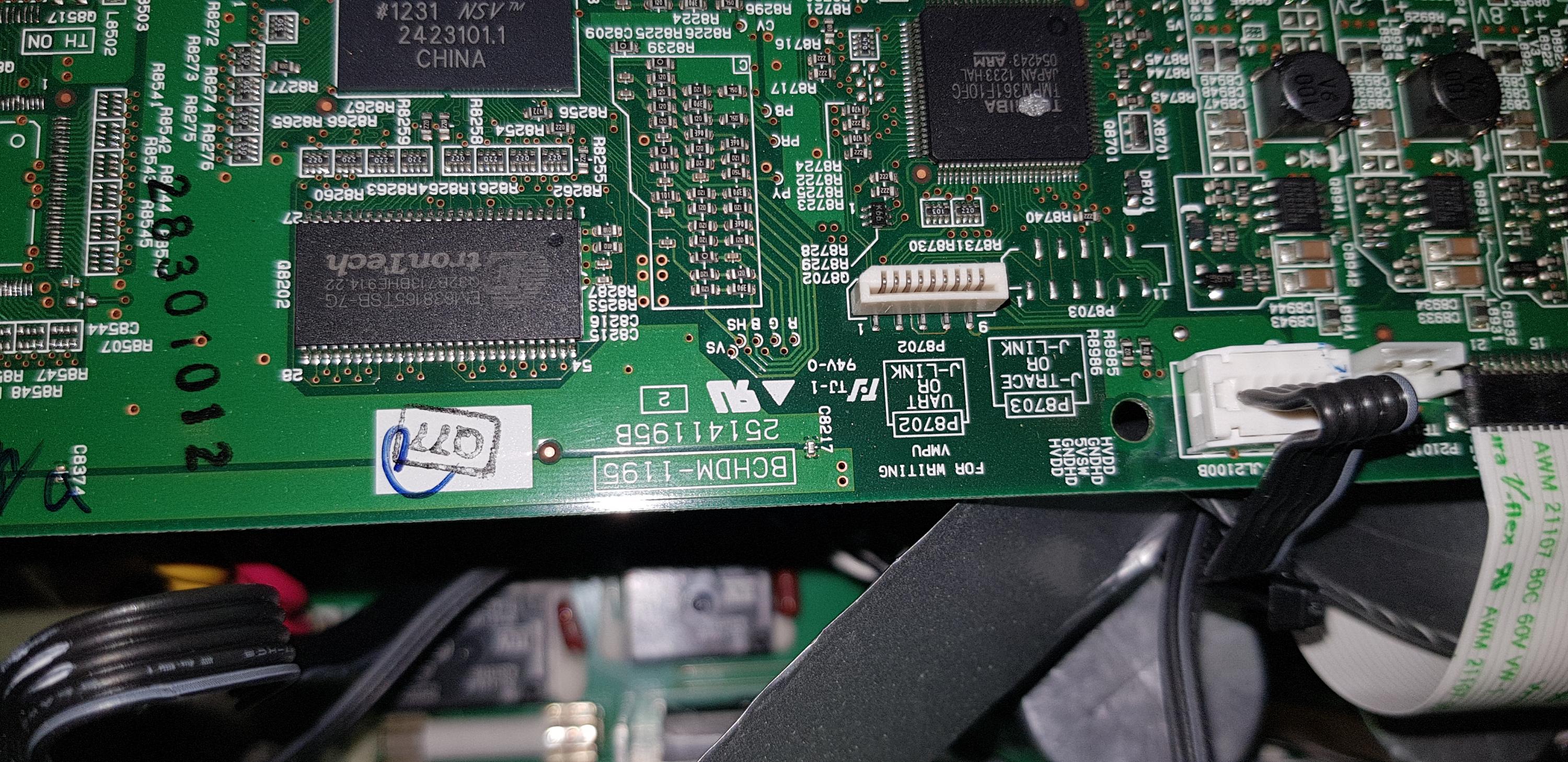

              I attached some pictures of the receiver but i dont have any caps on the hdmi board?
              Can this be a power issue? That the hdmi board does not get any power at all?
              Hope i can still repair this receiver. So i would need a new dts chip and eeprom + firmware?

                Read this - https://cdn.badcaps-static.com/pdfs/...12b2bc512f.pdf
                That's the list with the defective TI DTS chips.
                " Symptoms were that he had to turn the receiver on/off a few times to get sound and after a while there was no sound at all. " - that's a standard symptom of a dying DTS. Still it will not hurt to check the IC's power supply. The caps should be on the other side of the board. If I remember correctly, under that board is the power supply board, so there is a really good chance the caps ( probably smd ) to be fried.
                Again - the best thing you can do is to contact onkyo and ask for the extended DTS warranty. You do not need an invoice or any other documents. They also accept units which have been previously repaired by not onkyo repair shops.

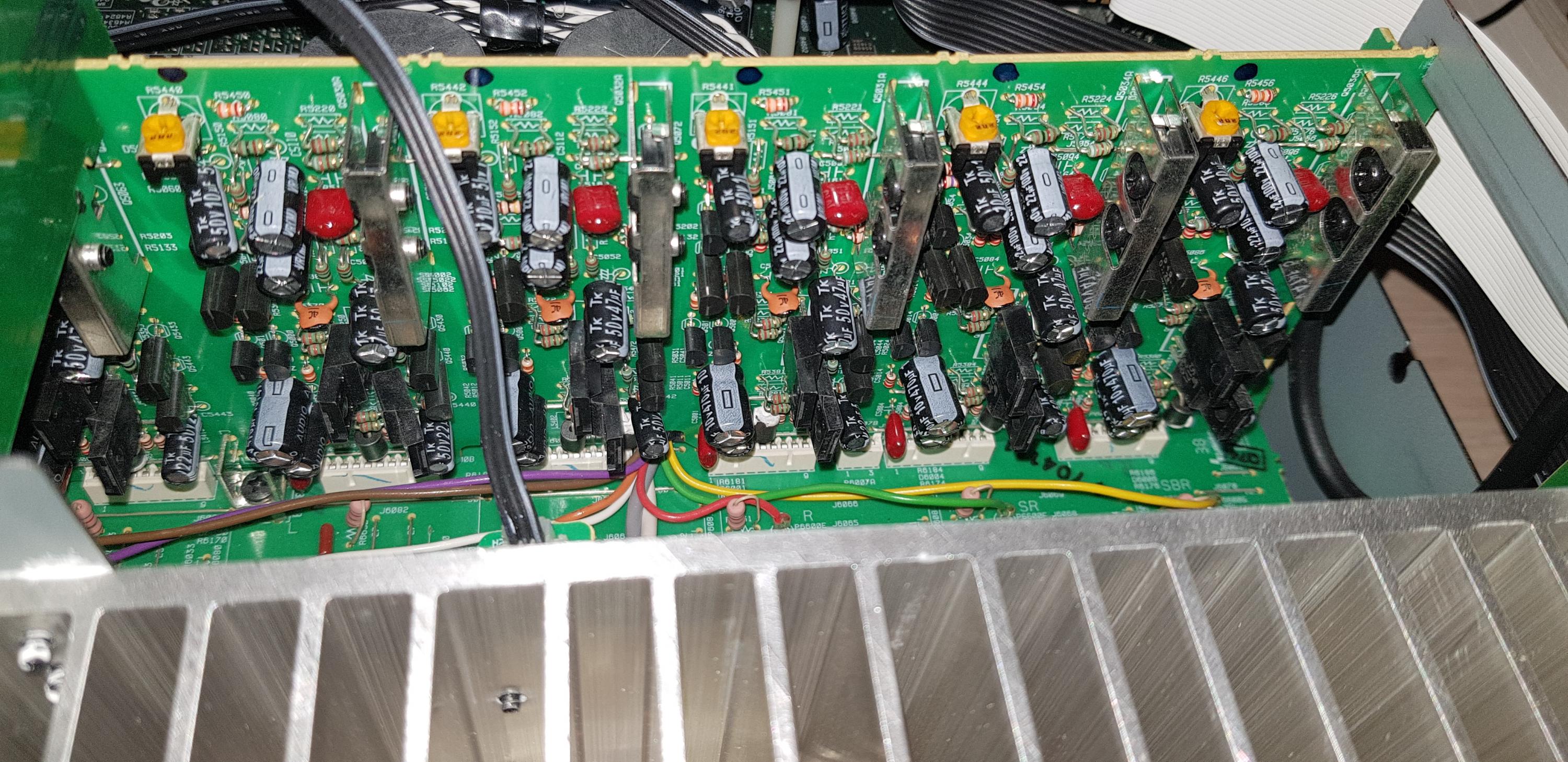

                  There are no caps on the other site either! ( No caps at all on the hdmi board ).
                  There are caps on the board below the HDMI board , they visually look ok.
